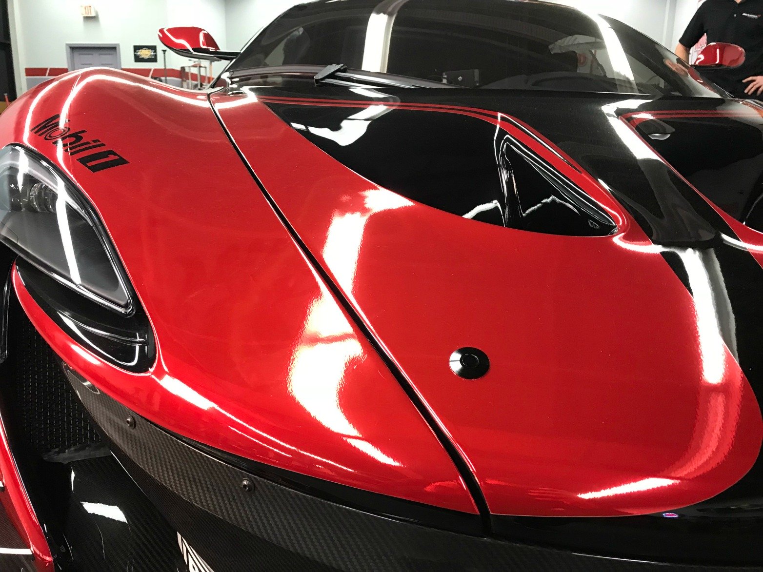

THE new McLaren uses quick latch. McLaren used them without even telling Quick latch it was to be THE fastener of choice. What I gather from that is both no "deals" or marketing and that McLaren felt it the best trade off of quality, size and strength. If McLaren felt it was quality, then I'll let that trump my pocket engineering.

here is a simple example
I recall seeing them remove the bonnets in a video. Usage case may be very different between the slc and McLaren; depending on how your front end is designed there may be significant blow off loads. I think in the case of the McLaren I’m sure all airflow is ducted and there are very little blow off loads on their bodywork.
