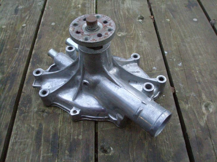

Hi Robin,
do you mean one of these:
Andy

I am thinking that is the wrong way round.
I am looking for the main pipe to be on the left hand side looking at the engine from the front.
I dont think I have much room on the right but will check tonight .

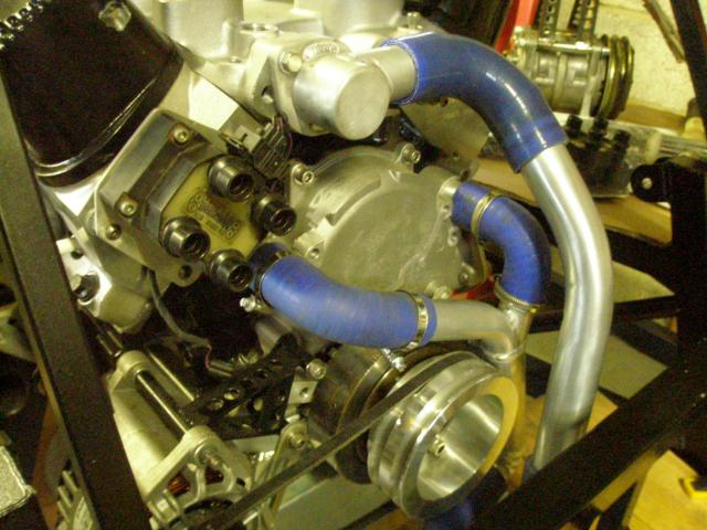

Robin,
ditch the waterpump completey and modifiy the timing cover to take the coolant stub pipes directly, minimising the potential number of leak paths. The attached is what I did on mine
Rgds,
Andy
Brett
What you have done was the other option my only issue was that i was struggling to get a pipe that was at least equivelent to half the volume of the original inlet pipe the fit in the space between the bolt holes therefore not ceating any flow issues.
