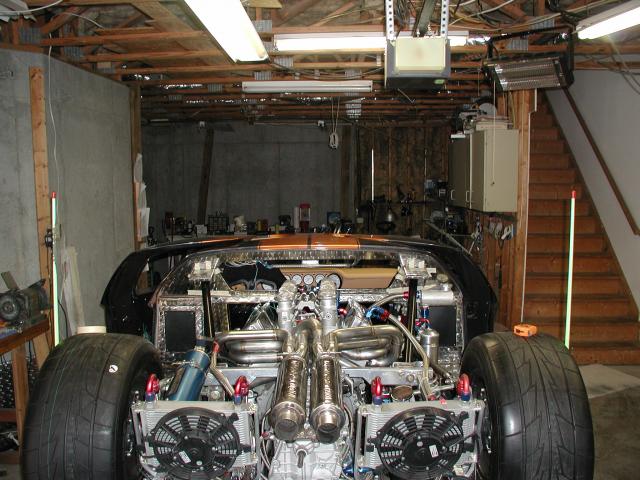

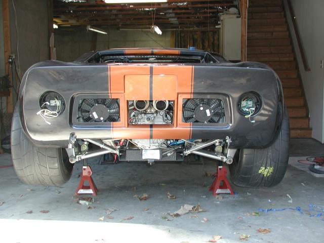

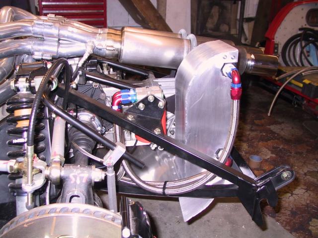

FWIW, engine oil cooler (lft) and trans oil cooler (rt).
At speed, my engine oil is, conservatively, 15 deg F cooler with the fan on. I personally don't believe there is much airflow where I have the coolers positioned. I could probably make a shroud that could pick up air from under the chassis which I have seen on originals at the historic races.
I think better airflow for the cooler exist through the side intake of the rear clip and a fan would not be necessary.

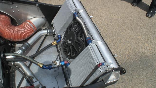

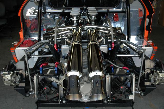

I, like Tim have the rear coolers. My thoughts are that it is an out of the way location, that doesn't hinder any other equipment or the view when the rear clip is open. The area is a low pressure area and almost surely would require a fan(puller) to gain any real benefit from the cooler. Mine will be set by thermostat and override switch.

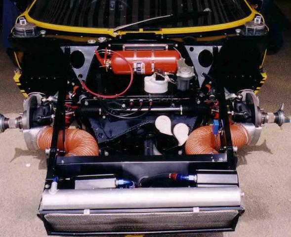

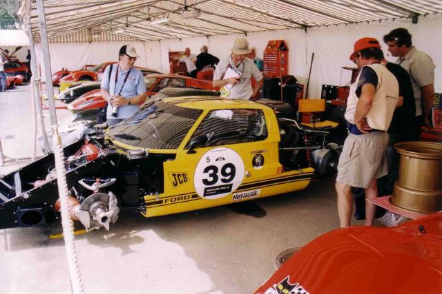

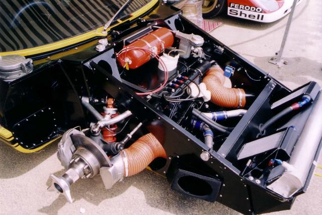

I knew I had pictures somewhere
From Le Mans classic 2004
This car had this set up

You reminded me of the 66 Road Car that I posted some time ago. The oil line that went to the front was huge. Either a 12 or 16- line. Don't remember the pump that was used.

Remember that those cars with the coolers in front (911 included) were Dry-sump cars that use external oil pumps of unknown specification. It's a whole new game with dry-sumps...

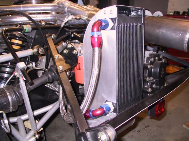

I just got through taking the oil coolers off to turn them around and have the entry and exit ports on the bottom. I realized as soon as I placed one on the car that it just was not going to work that way. The rear clip support bars are way too close to the bottom of the cooler and would require grinding notches into their structure and weakening them. Since they are already ceramic coated, they will stay that way. For those that might wonder which way is best, the answer is both. I was originally concerned with the path the oil would take with the entry/exit on the bottom. It seemed most of the oil would be in the bottom and wouldn't achieve much cooling. It winds up that with the Canton coolers and most others as well, the resistance to flow is greater in the fin area. So the fill tubes would do just that before any flow traversed the fins. On exit, it wouldn't matter. The only thing that does is the placement of the pump. It needs to be pumping into the cooler and about the level of the trans so you don't get a vapor lock. The top fill would of course fill the cooler full expelling all the air. The only saving is the length of the lines. After a while that cost begins to add up. The bottom fill arrangement has a little neater appearance as well.
A note to you all, and that is to be sure to add a vent to the trans. One racer didn't and blew the front seals out from the expansion due to heat.

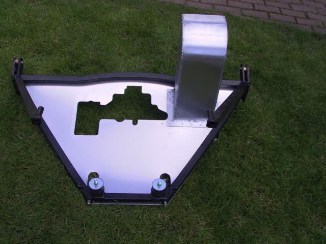

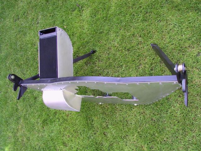

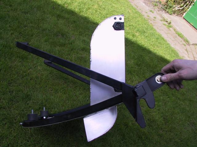

We did the prototype design, fabrication and install on the first RHD SPF in the UK, which has now become the standard factory oil cooler unit for these cars, Frank

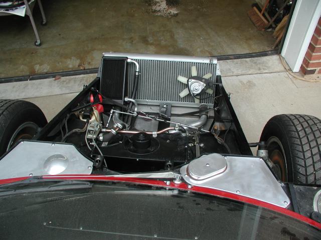

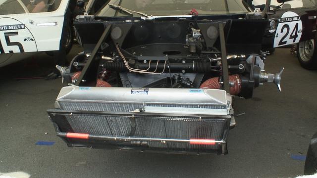

Here are a couple pictures of MkI oil cooler locations on original cars that I saw at LM Classis. I think they are modern adaptations rather than original.

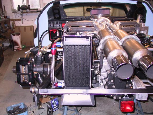

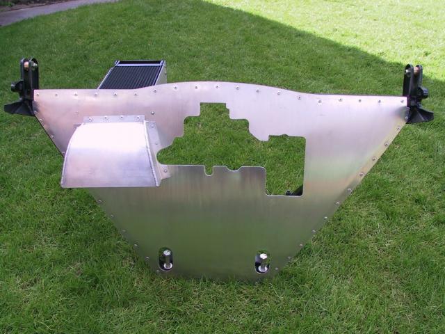

Here's my chosen location taking air directly from the side vents. I have the ducting inside to channel it correctly into the box.
Martin
