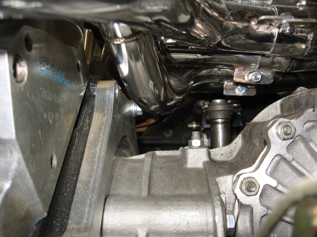

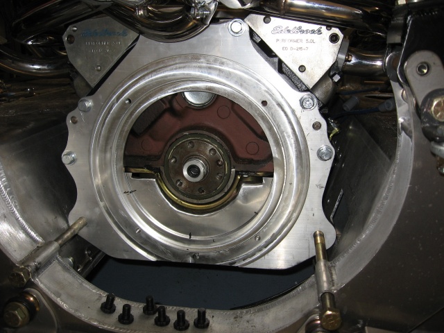

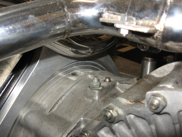

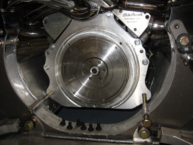

Well things have calmed down with travel, sickness, and other family events and a bit of Lola work was done. We removed the transaxle today and put on the proper adapter plate that RCR supplied to replace the old one. Also put on the flywheel and so as soon as I can round up clutch parts we'll be ready to bolt the transmission back on and move on with stuff.
Also spent time routing water pipes, replacing all the header bolts with good stuff, and replacing all the suspension bolt hardware with some high quality standard hex head bits. The allen bolts were fine, but I could see me getting into a situation and not having a proper tool or proper access.

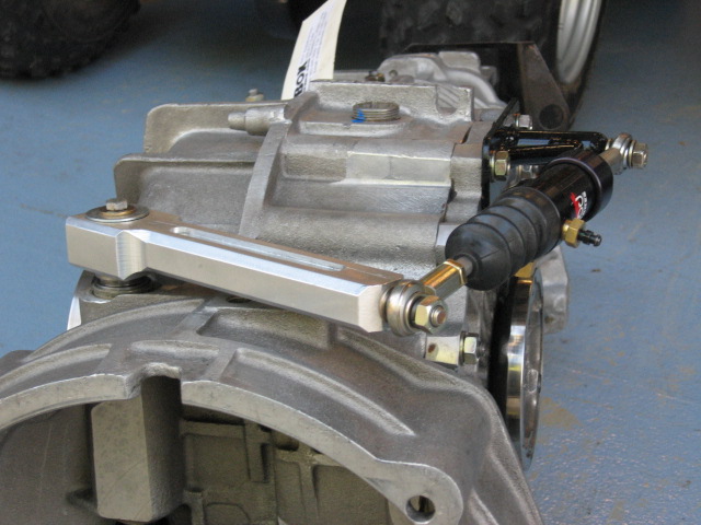

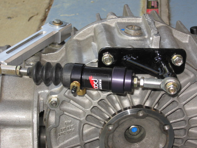

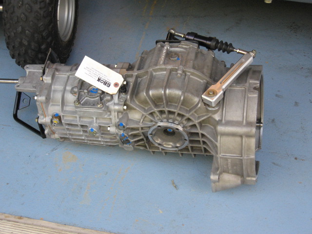

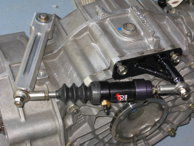

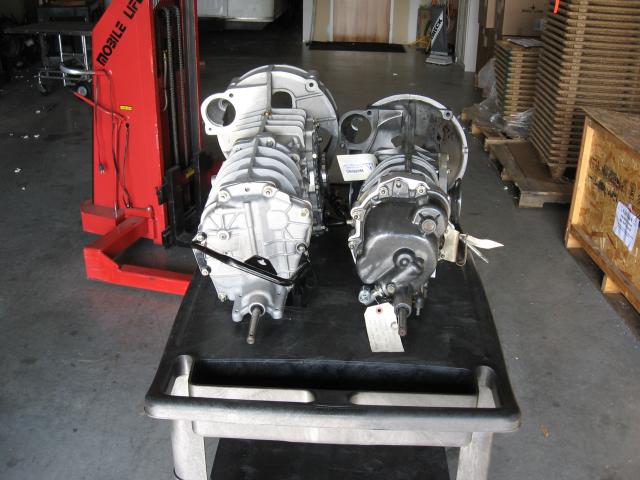

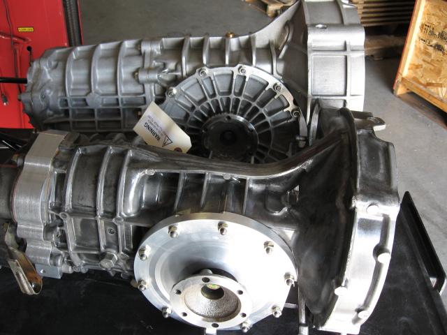

I’ve recently received my 930 box back from Gbox. Gboxweb.com specializes in Porsche boxes and their vendor representative on GT40s.com, Ryan Zielinski, is a frequent poster on the site.
The main reason I sent it to Gbox was for a robust slave cylinder conversion. But, while it was there they disassembled the box completely, inspected it, replaced a few bits, and gave it a clean bill of health. This particular box has the rare 8:41 R&P, or 5.12 ratio, that is highly desirable for a racing standpoint. I was impressed with Gbox’s service on my 930 as the box came with a full report of the inspection and procedures performed. The box ended up to be in good shape with some wear on the 2/3 synchros, so, they were replaced when they were in there.
Gbox also rebuilt my buddy Ed's 915 box, in fact, both went to and from Gbox at the same time. Ed’s 911S box needed a complete rebuild from about 100k miles of hard street use and Gbox performed that service as well. Man is that box small compared to a 930, but looking good now1
The slave cylinder conversion is shown below in the pictures and is a nice piece. It has a billet arm and a pull slave arrangement mounted on heim joints along with a reinforced anchor point. Looks like it’ll do the job and I think Gbox will be offering this as a kit since it requires no real machine work to the box itself. Thanks for the work Ryan, quite impressive!

Looks great Ron!
That Clutch Release arm looks stout as all get-out..
Now that you have the starter issue figured out and your transmission is ready to go - You should be ready to race in no time!
What else do you need or need to sort out on this car?

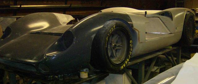

Looking very nice ron.:thumbsup: One question ...What model is your Lola? I ask because it looks a little diiferent than my car. It looks smaller IMHO

Hey Ron, just check out your thread and saw the clutch lever stuff that Ryan did, looks really nice. I have the slave bolted to the case but that looks much more robust.

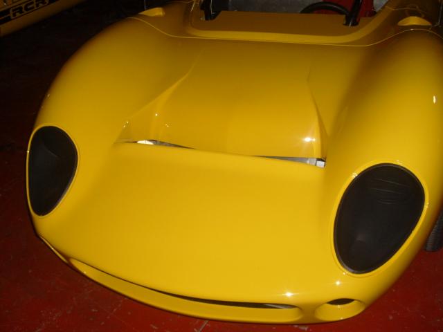

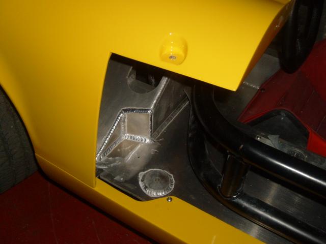

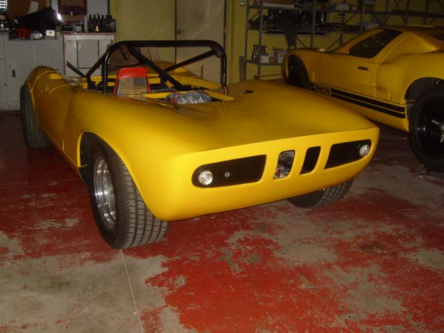

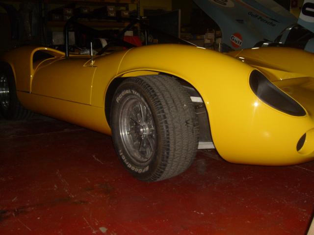

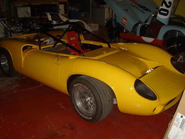

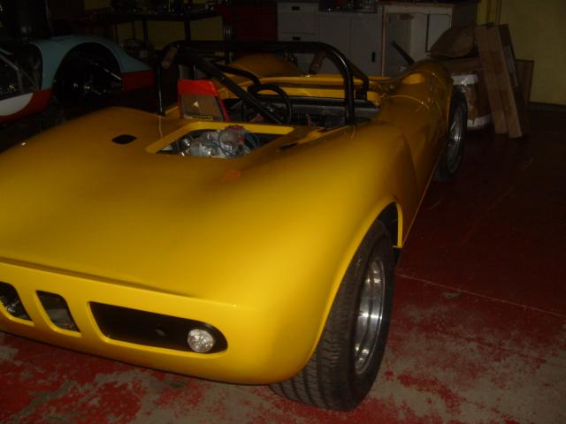

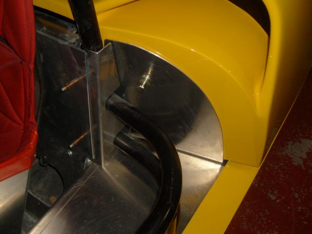

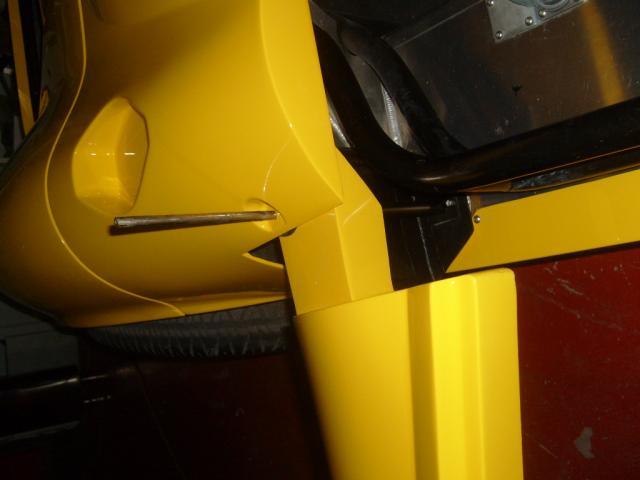

I thought I'd share some progress on the Lola with some pictures that I just got from RCR last night. RCR has the Lola in their shop and are fixing it up for the 13 Hour Charge of the Headlight Brigade Enduro at VIR on Oct 31st and having a street legal car. The car is just back from the paint shop and is looking good in bare yellow!
The wiring is finished up on the car and now RCR is moving on to the fuel system and finishing up the cockpit. Some interesting tidbits of detail:
  • Car will have a 25 gallon bolt in cell for race use and will retain sponson tanks for street use. Switchover will simply involve a fuel valve and pulling the tank/tank bulkhead out.
  • The fuel cell will have a NASCAR type dry break fueling system. We can't be putting 25 gallons of fuel in the car with a funnel and bottle. It'd just take too long.
  • The car will have street lighting but an aux light pod with 4 PIAA HID lights will attached with quick pins for use in the enduro.
  • Pedals are fully adjustable with a pull of a quick pin so that different drivers can be accomidated easily. Similar to the way the Nemesis system worked and it did work well.
  • Doors are pinned with a rod/hinge but the rod can be removed with the quick pin so the entire door can be removed to help with ingress or for repair.
We've assembled a strong team of drivers for the 13 Hour. All of them are regional SCCA drivers with years of experience at VIR and multiple wins between them. As long as we can keep the car intact and a steady pace we'll be good to go. It sure does look tiny beside that GT40 though!
I'm excited about the car and think it looks great in yellow. Quite naturally it'll look fantastic in stripes and race trim but looks to be a nice start!
