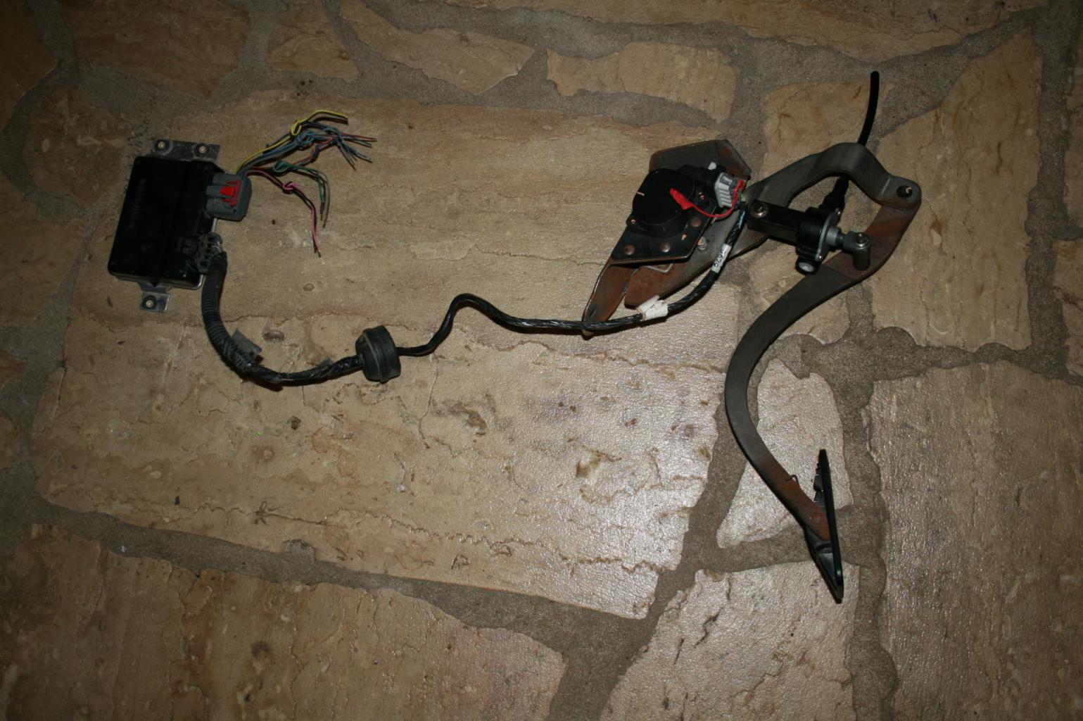

Mike Trusty suggested years ago a cam type linkage, when I get the intake off I'll investigate that option Jim but really would like drive by wire as then you can add traction and cruise control. :) I bought a GM unit to experiment with.

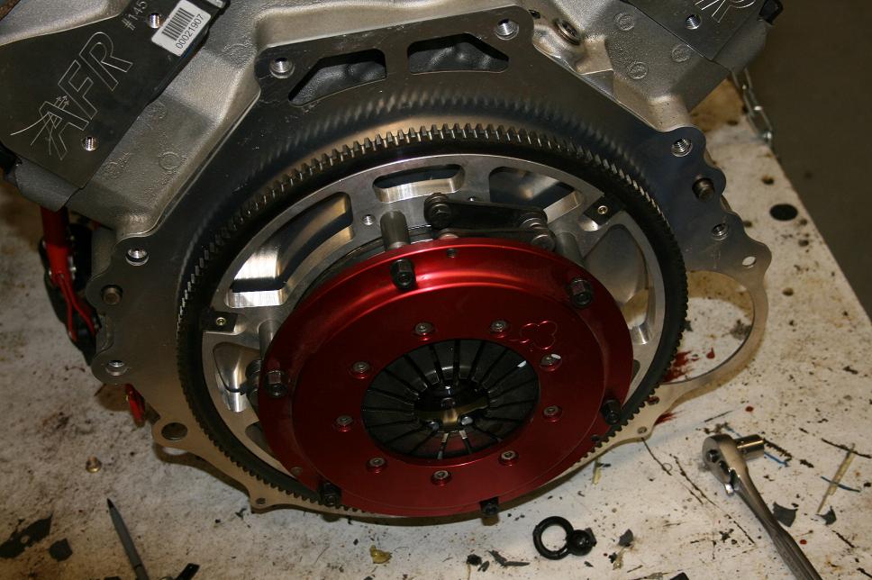

Yes Jim you are correct, although overheating (the car) has not been a problem. The pressure plate will be one of the first things on the list.

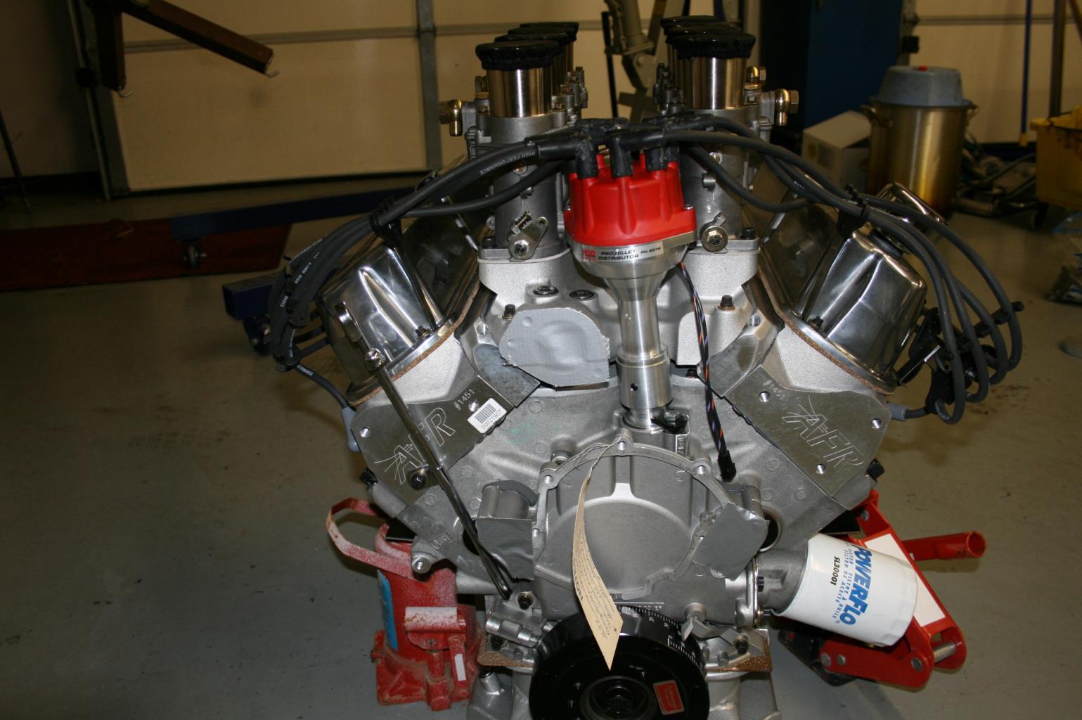

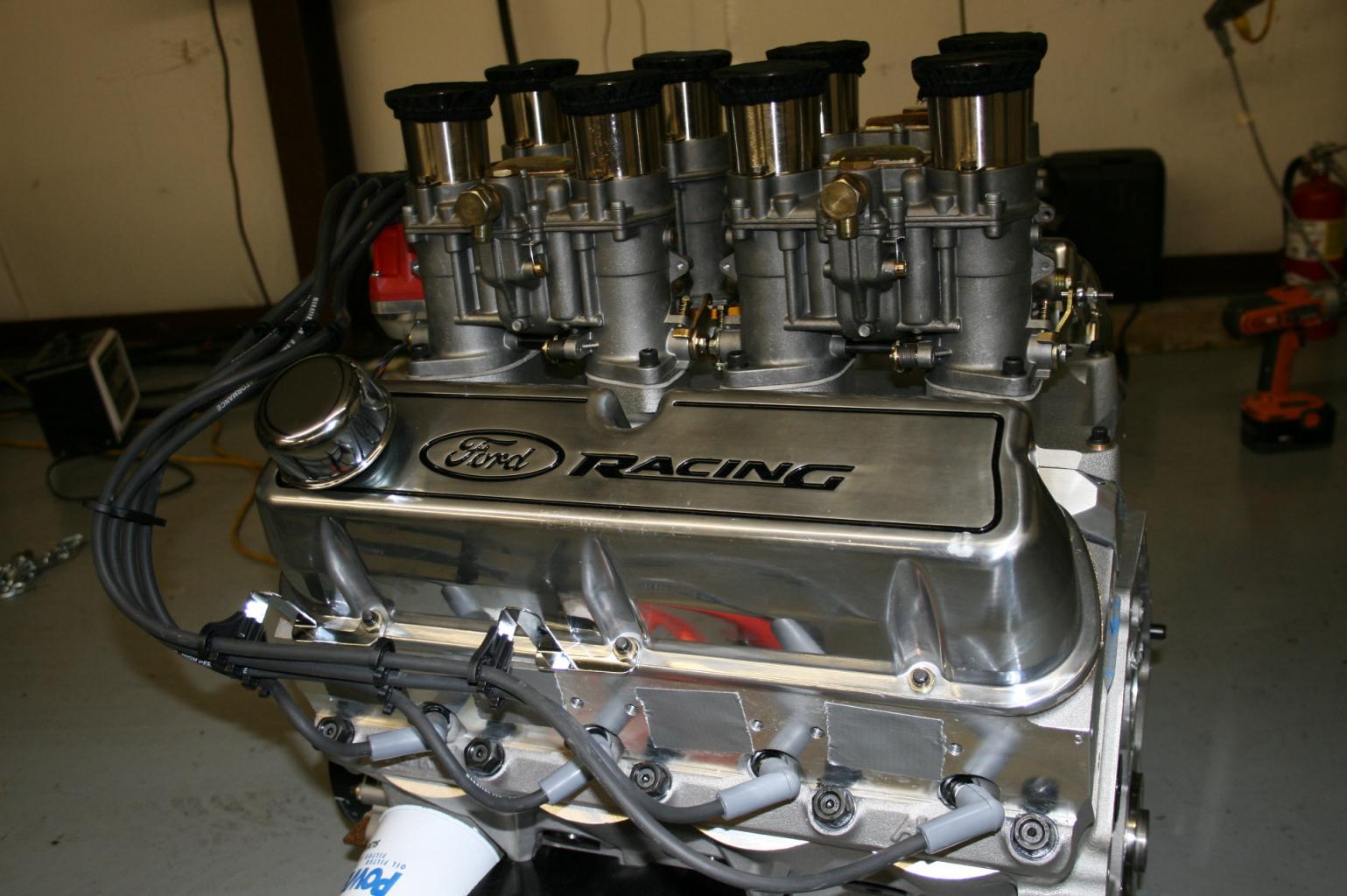

Sean the motor is beautiful to look at, after waiting over half a year to have it built, it arrived! A friend and I sat in the garage and had a few beers just looking at it, to me it was the Mona Lisa. :laugh:
