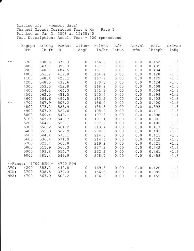

Rick, in 08 we discussed this, I was frustrated as the car was new and uncontrollable for me and far to scary to drive on the street, he told be before I do anything buy avons and he was correct, the tires quit skipping at 95 MPH. In my note I asked options, he will get back with me.

If any of your are running a short block w 289-302-331 what ever and have a torque hp dyno sheet, please share here if you don't mind. It will be interesting to see what others have.

Jack you are dealing with a mismatch of parts more than anyhting. You gearing is for a short stroke high rev motor, and you motor is a stroker for max hp and torque.
What is chewing your tires is the torque mutiplied by the gearing. If youre going the 302 route so be it, but I really think the destroked 351 would work well. you have most of the bits and the efi will work here. If you go 302 its everything new.
On the 302 331 front. It seems these motors easily get 475hp when built right. You can also go for a 3.25 stroke 4.125 bore 302. This nets what is known as a big bore 347, as opposed to most 347's which have a 3.4 stroke and are more drag racers.
Some do a 3.4 stroke and the 4.125 bore for a 363, I have seen a number of mustangs on the track running abasic ford crate motor with this combo, and there is an Oz GT40 running this too.

Really worked 302's with stock stroke can go well over 500hp but you are reving in the 7-8k range and need a 13.1 compression ratio.
I personaly think the sweetspot is a 3.25 stroke 4.125 bore. If you run good pistons and 5.4 rods then the rod ratio is really good, and its all about rod ratios in terms of smoothness and longevity. The benefit here is that you still have that low down tactability, although maybe with your short gearing its irrelevant, except that you still need to be able to drive in 5th on the highway.

Bill my engine is Dart aluminum block internally balanced also just 427, do you have a dyno sheet on your engine?
If the MkIIs of yesteryear were making 500 HP and 470 torque with a higher ring and pinion gear, even they had to be more street-able than what I have and they were race cars driven by professional race car drivers. This engine makes 100 more ft lbs of torque and 200 lbs lighter and driven by an old guy.

Thanks Mick, I think my choices are sell, destroke, or trade on my engine. My thought was by changing the lift and duration this would decrease the torque as not as much fuel air would be entering an engine during the event but guess I was wrong to some degree, stroke and bore is my problem I suppose. I like the idea of traction control, works very well in all my normal cars and was fantastic in the acura nsx, and ford lightning I had. With this engine and the current ring and pinion ratio it would be working its ass off and that might become annoying. It all boils down to my choice of engine and lack of knowledge during the build process. After riding in Richards car it was night and day, his choice of smaller displacement and higher ratio final drive provided the car he wanted and my choice also.
Here is a dyno sheet for a hopped up 302. Less power/torque than the strokers but still building power up to 7500 + rpm , the strokers HP is falling off after 5600 rpm which will have you grabbing the next gear. The screaming 302 will lengthen each gear by the best part of 2000 rpm which will make it feel far more flexible.

For a road smoker the stroker is king but for a track day the tuned 302 or 331 will have its day.
