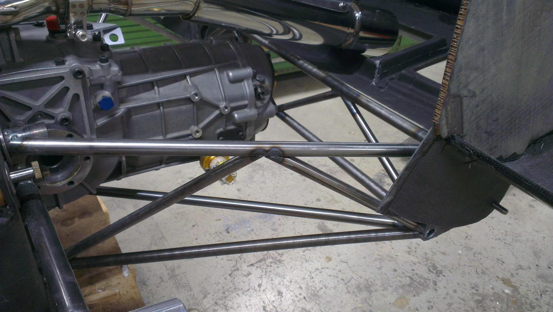

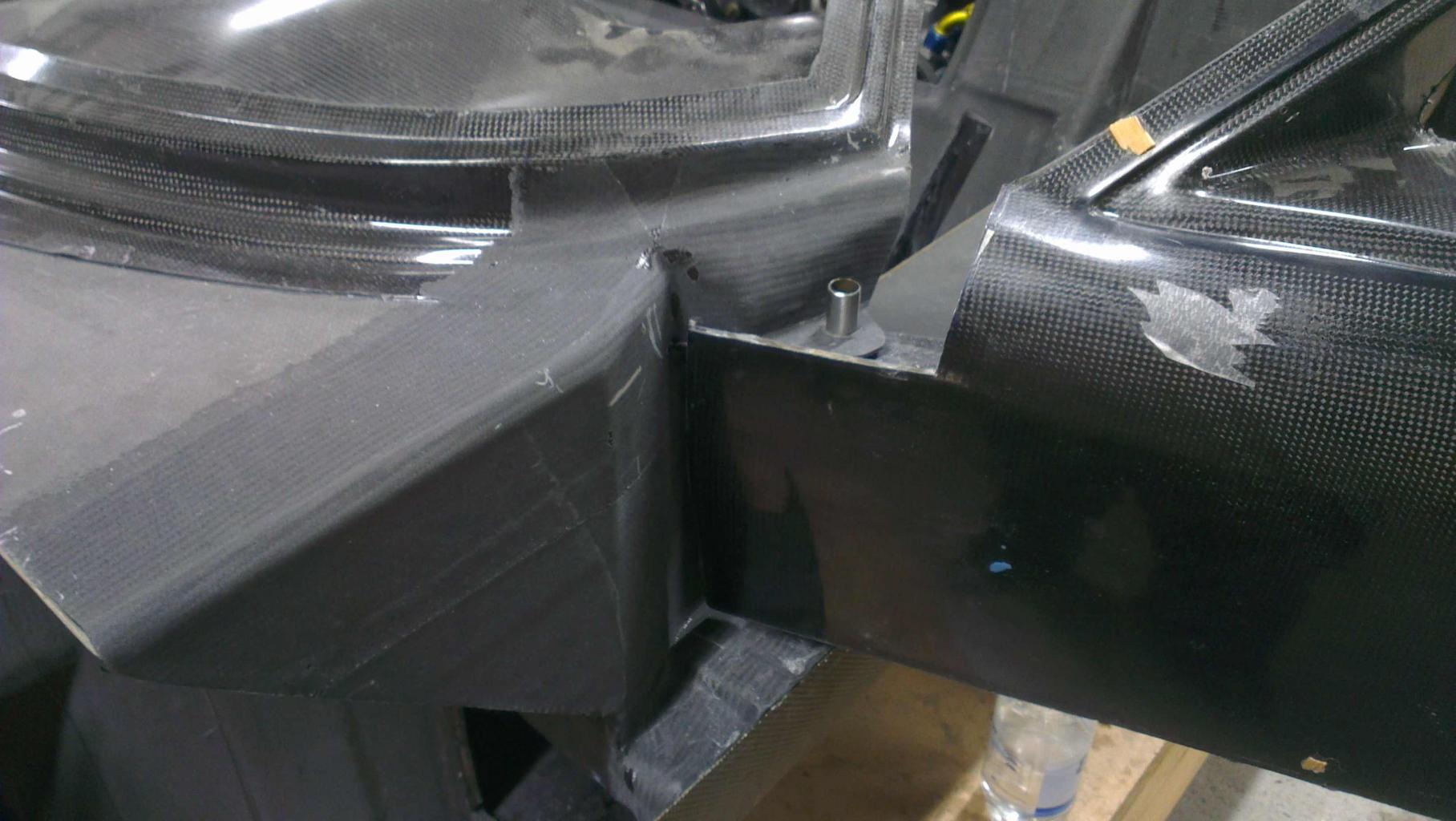

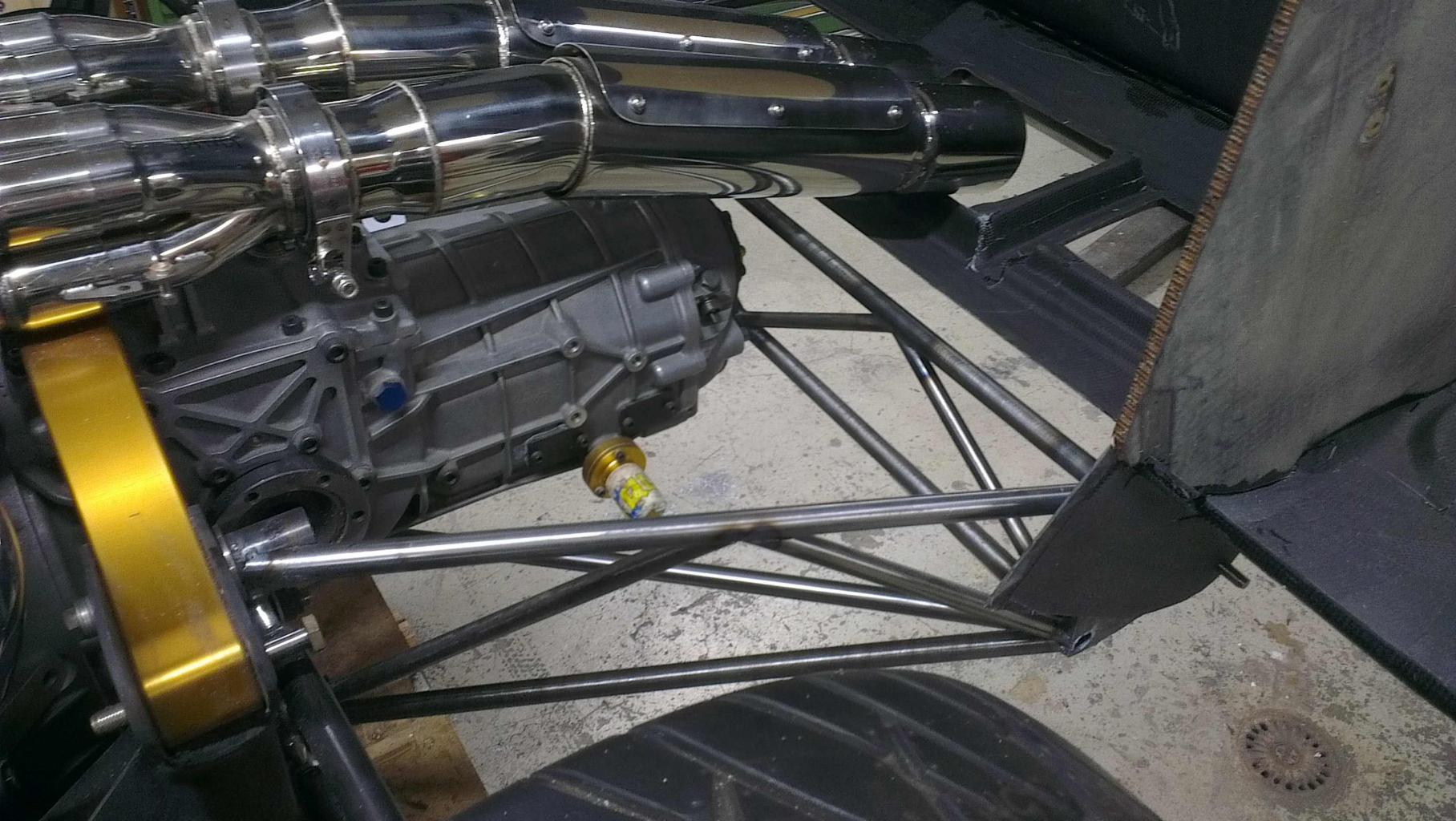

Here some new pictures of the rear construction and the door hinges.

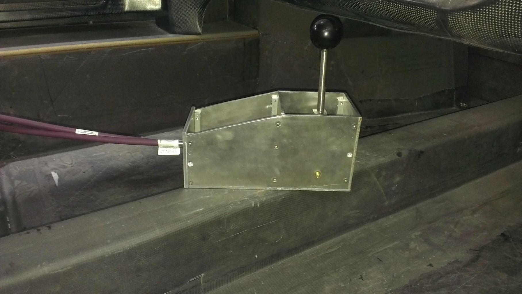

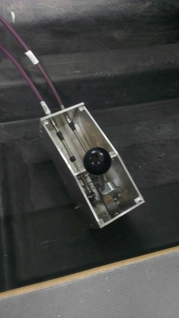

Now we get the gear shifter working :)
It s builded with machined and welded parts in a magnesium Box.
Works fine. Only sanding and painting is to do on the box.
here some pictures.
Urs

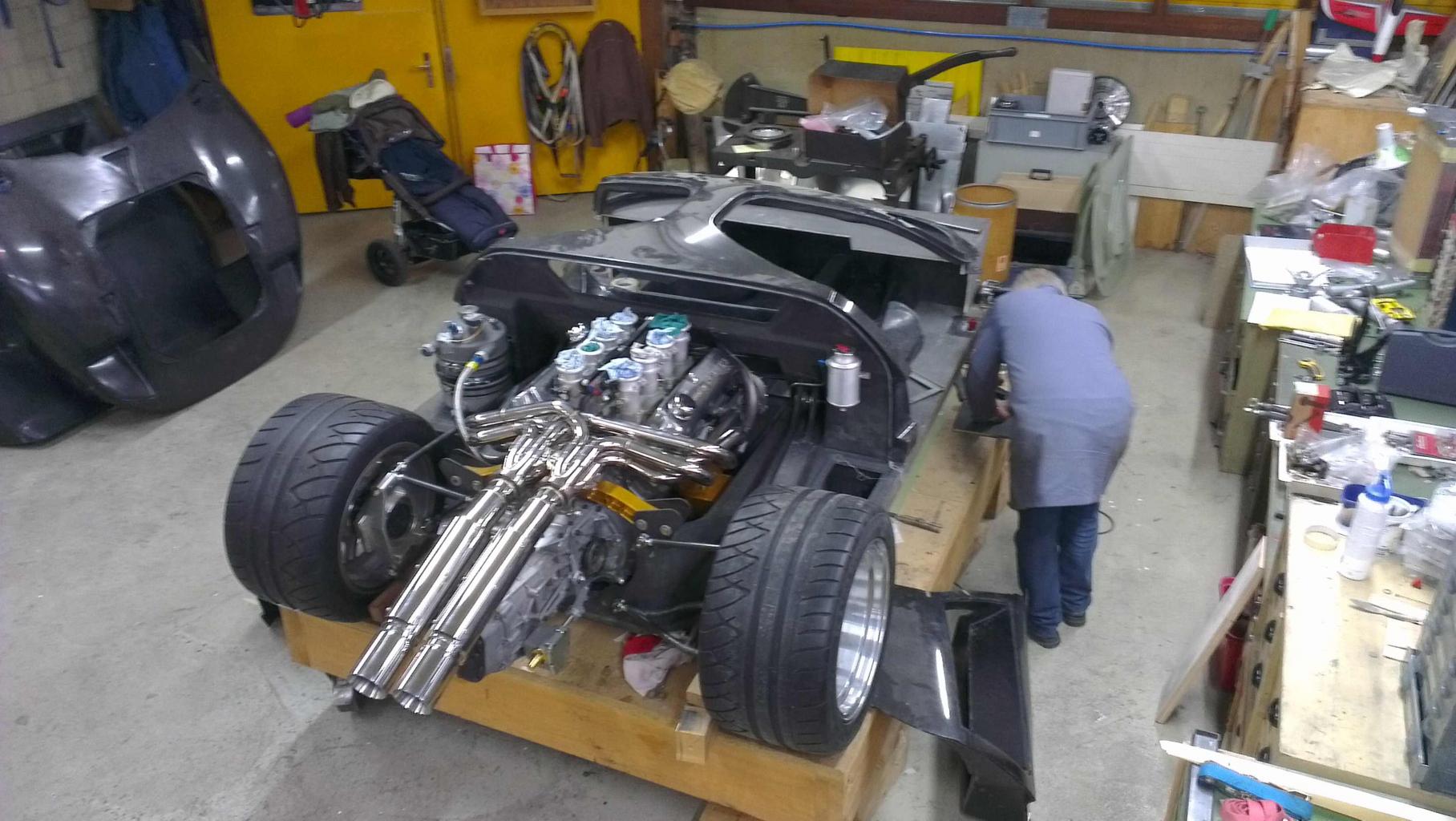

My father wants to drive this year ;) he works really a lot now on the car, also my mother helps me with laminating the carbon parts.

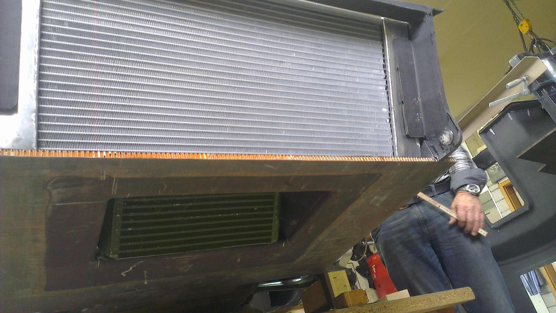

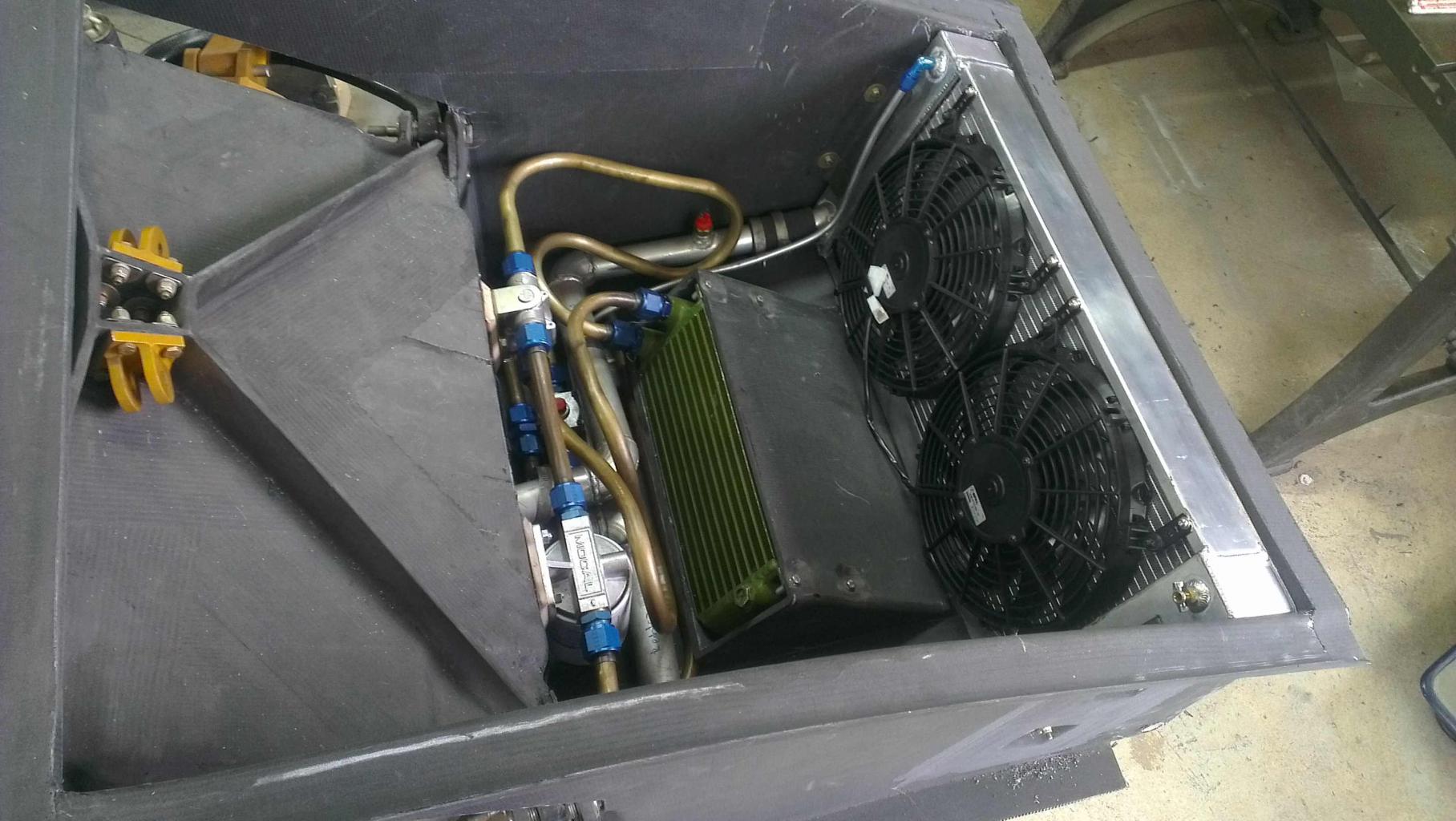

The Carbon 40 takes form :) :)
Some pictures of front section with oil thermostat ,Oil cooler, Oil filter, and water cooling and the oil cooler intake.
Urs

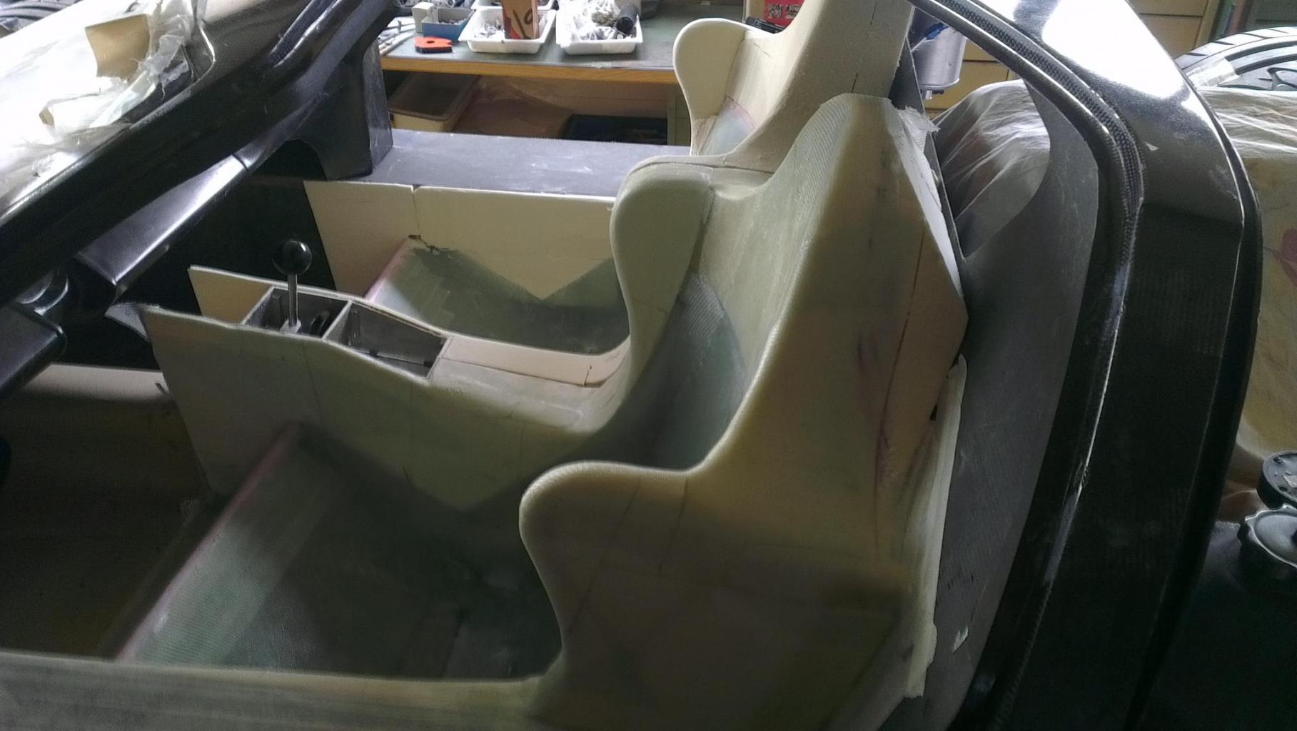

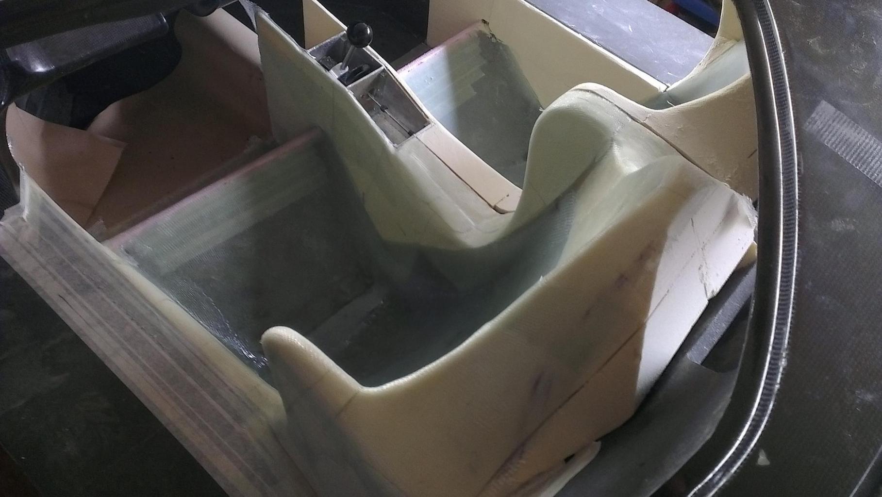

Seats are taking form :)
I have been building bodyparts in composite for years an I can just take of my hat and tell you that this is a fantastik pice of work and skill.:builder::builder:
