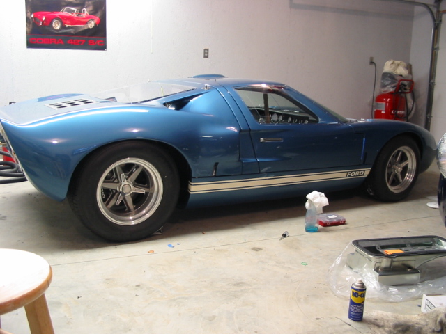

Build Status, Friday, Sept 19.

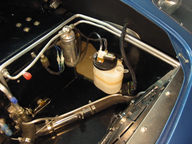

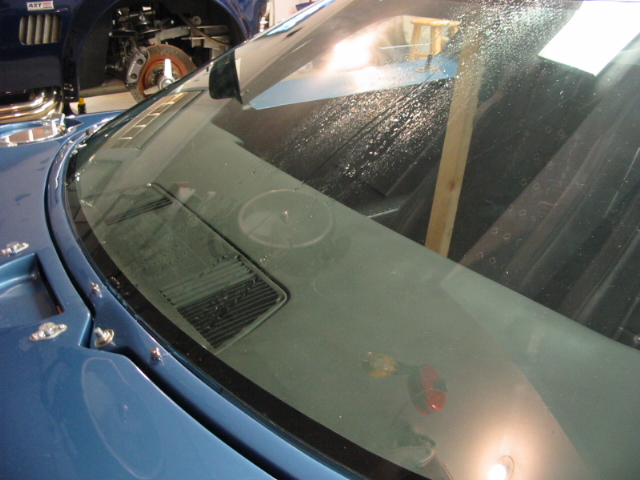

Windshield Washer
Ryan’s comment: “you got to be kidding.” Most that read this post will likely agree with Ryan. But the originals were so equipped, so why not? The Lucas unit we used came from Finish Line and looks like the original. Lucas makes a momentary contact toggle switch for thus function, which we located next to the wiper switch. The two nozzles were located on either side of the wiper. This washer puts out an impressive spray, almost enough to wash the entire car.
Check it out: http://www.youtube.com/watch?v=I5tPeUwTh1w

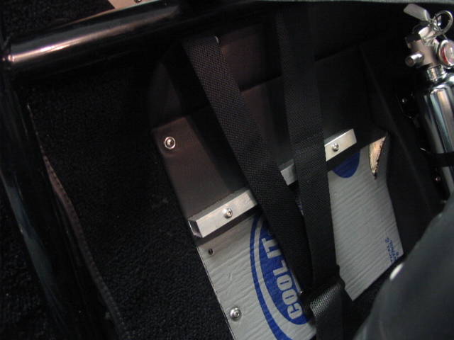

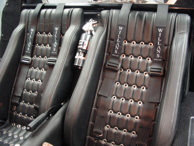

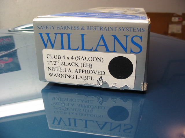

Seatbelts
Willans 2” “Club 4 x 4” seatbelts were selected, part number 2C44B. We obtained them from Bethania Garage, Inc., [email protected] . They are made in England. The quality is impressive. The 2” size works well in this car, where space is tight.
The GT-40 has the anchor points already in place. The belts come with the appropriate eye bolt. Both lap and shoulder belts fasten to the same eye bolt, although we added a couple of marine shackles about an inch and a half long on each side for each belt since it was a bit too tight getting both belts on a single eye bolt and keeping everything straight. The shackle also extend the lap belt out an inch making it a bit easier to reach the adjusting cleat. Although the shackles look small, they are made from stainless and are rated well over a thousand pounds, designed for holding up sail boat rigging, so their strength should be more than sufficient.
One inch square aluminum spacer tubes on the fire wall keep the seat back away from the fire wall by that distance. This is needed so one does not thump his head on the roll bar. The spacer tubes are secured with two quarter inch button head screws. This creates about an eighth inch gap through which the shoulder harness can pass without resistance.
The seat belts were run inside rather than outside the seat backs. On the passenger side there is just no room – the seat is too tight within the body. Adjusting the seat belts needs to be done before getting in, after which one can tighten them up.

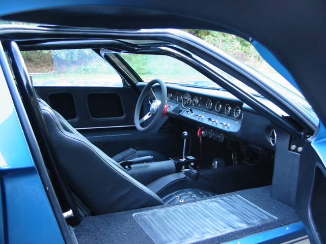

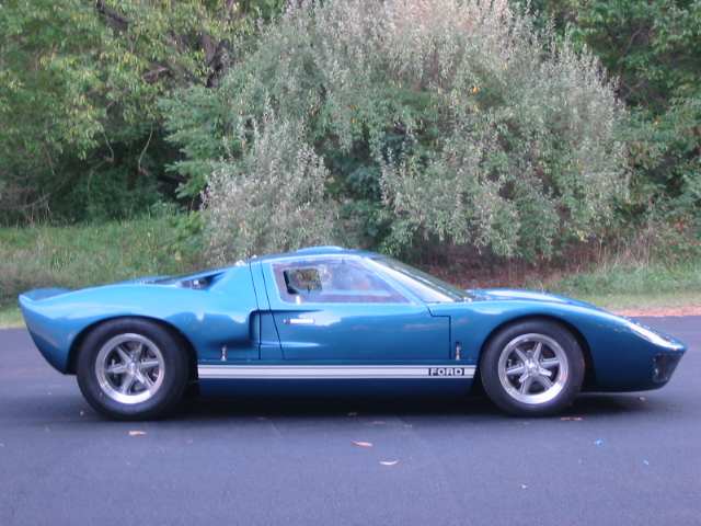

95% Done.
