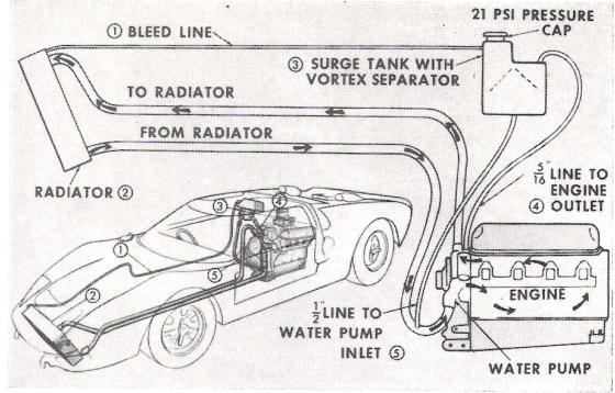

Here's some cheap advice. Don't build a mid-engine car without a good working self bleed system. Run a 1/4 id inch hose from the top of the radiator to the expansion tank. Also, run a similar size hose from the best location on your type motor that will vent the hottest spot on both heads back to the expansion tank.
Now, most understood piece of the pie. The expansion tank must be fed from the lowest pressure point in the coolant system. This will always be the closest point in the system in distance from the face of the pump impeller. Right at the pump input coming back from the radiator is the spot. Do not compromise this point.
I have two completely different mid-engined prototypes, SBF GT40 and a SBC SLC that are done this way and they both work perfectly. Neither ever need bleeding of any sort. Just fill er up with coolant and the air all comes out by itself back to the expansion tank.

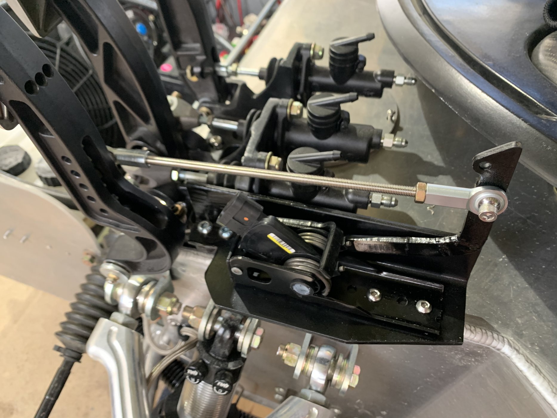

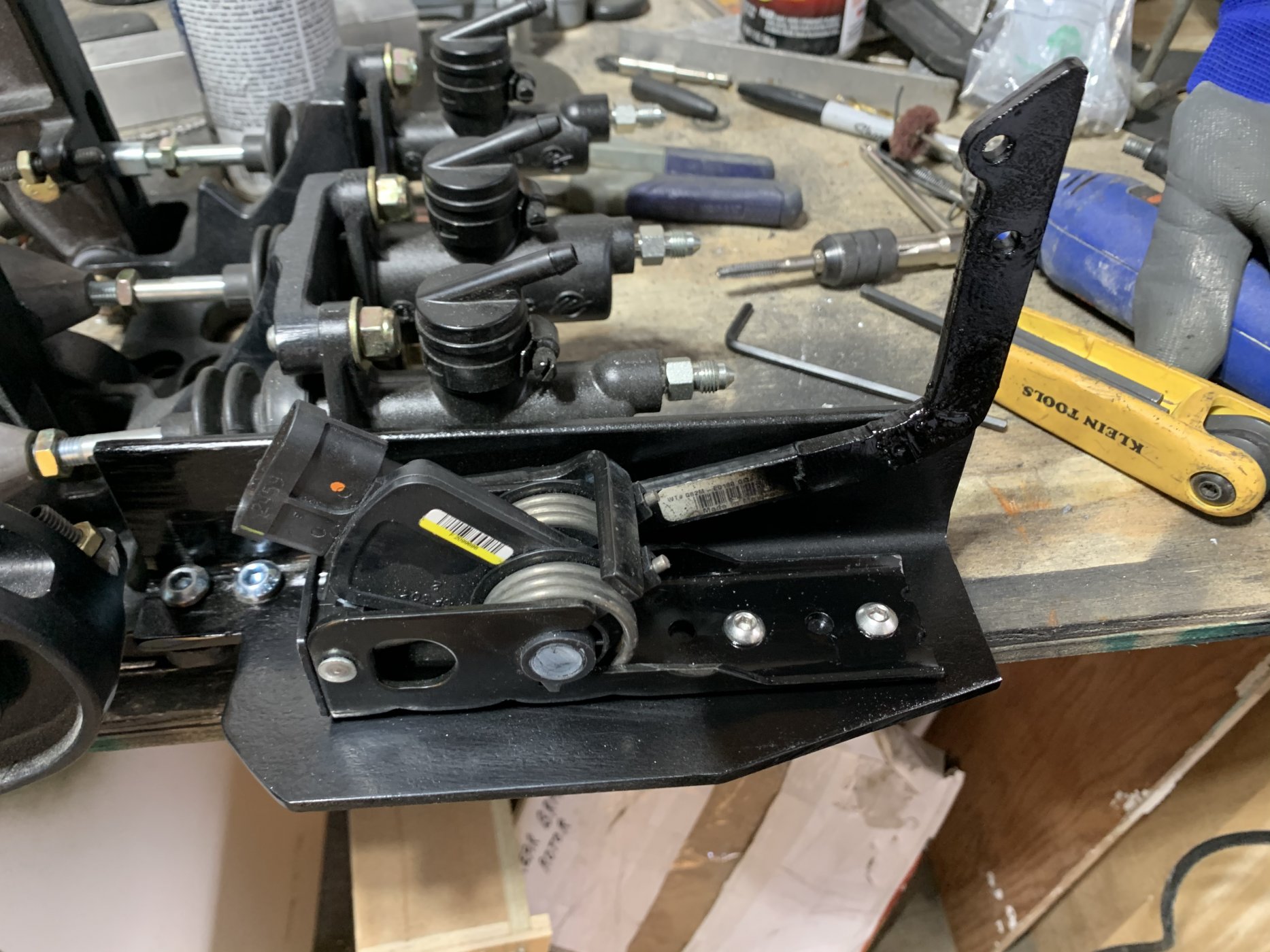

Fabricated up this simple bracket to hold my DBW pedal, the cable will just barely reach it. I’ll attach some threaded ball ends when I get a chance.

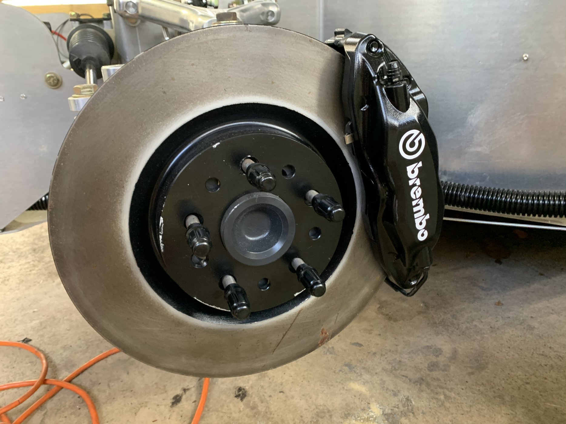

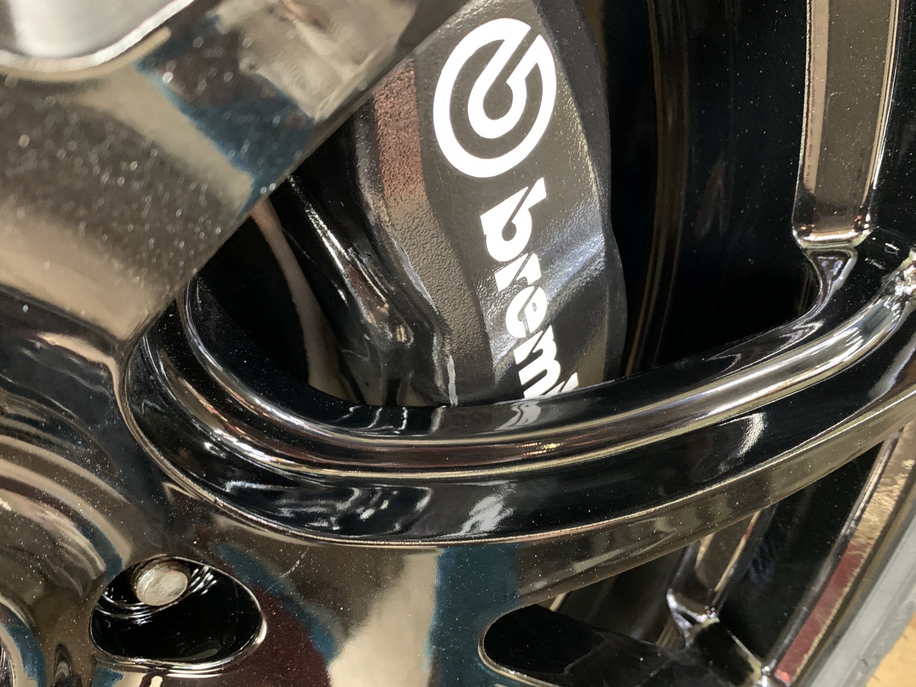

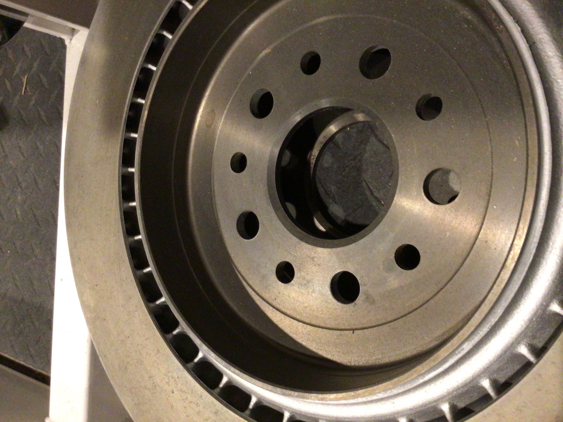

I also got my tires mounted. I’m not sure if I have the rotors backwards, but the front rotor just barely scrapes the inner side of the wheel. I have the big rotors on front and small ones in back.

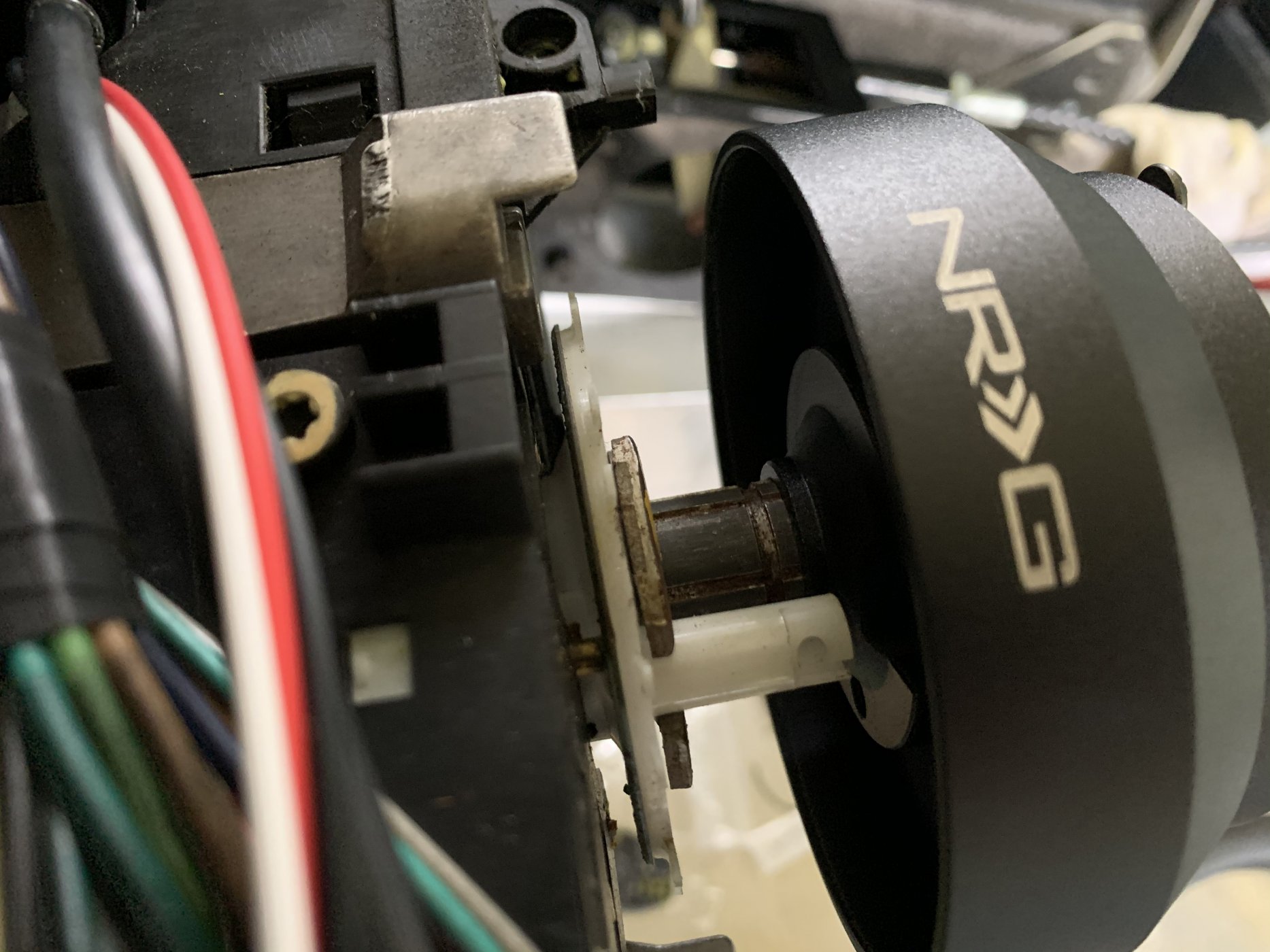

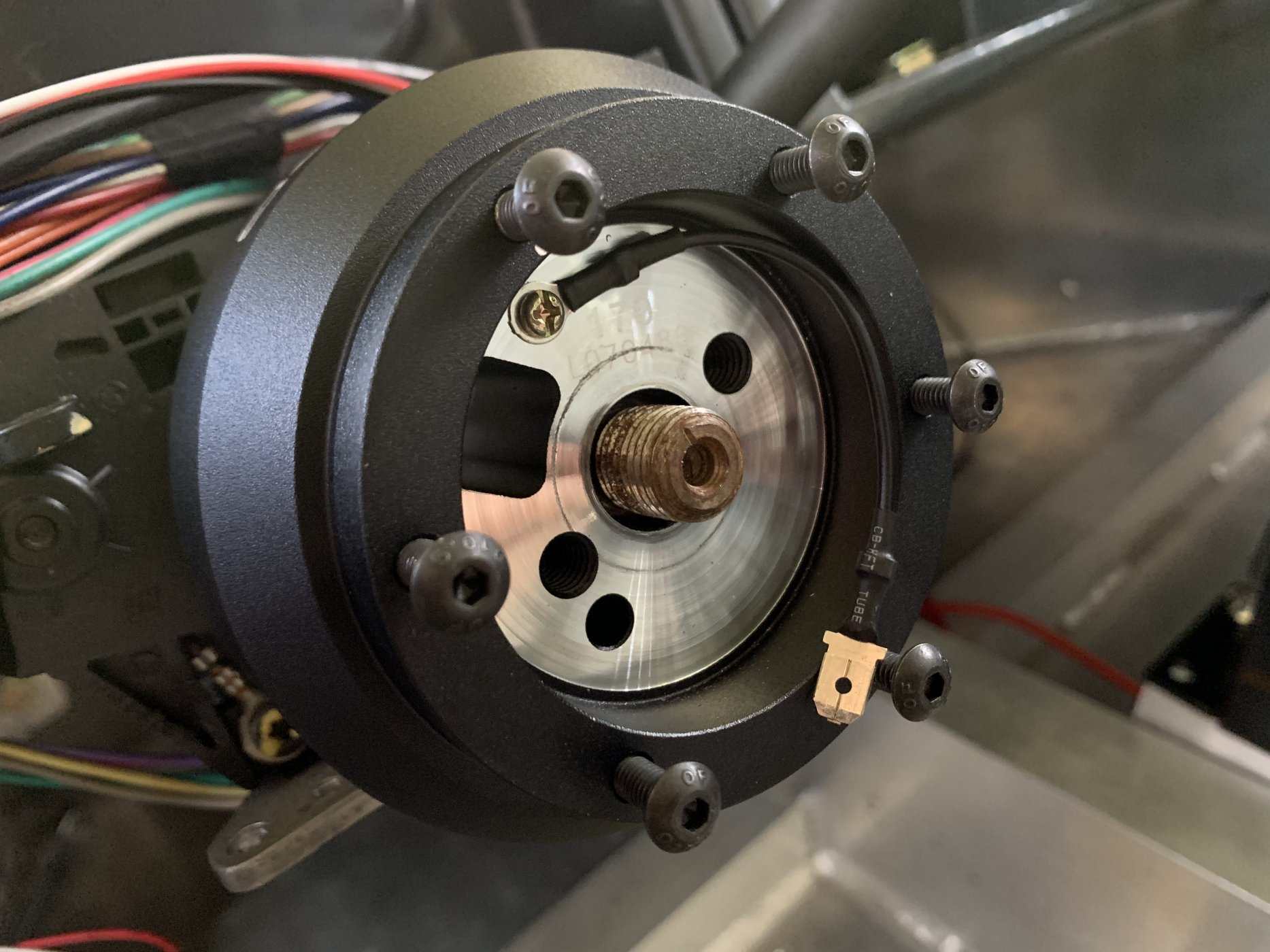

I have the NRG quick connect steering wheel, does it press all the way into the column until the nut cant go in more?

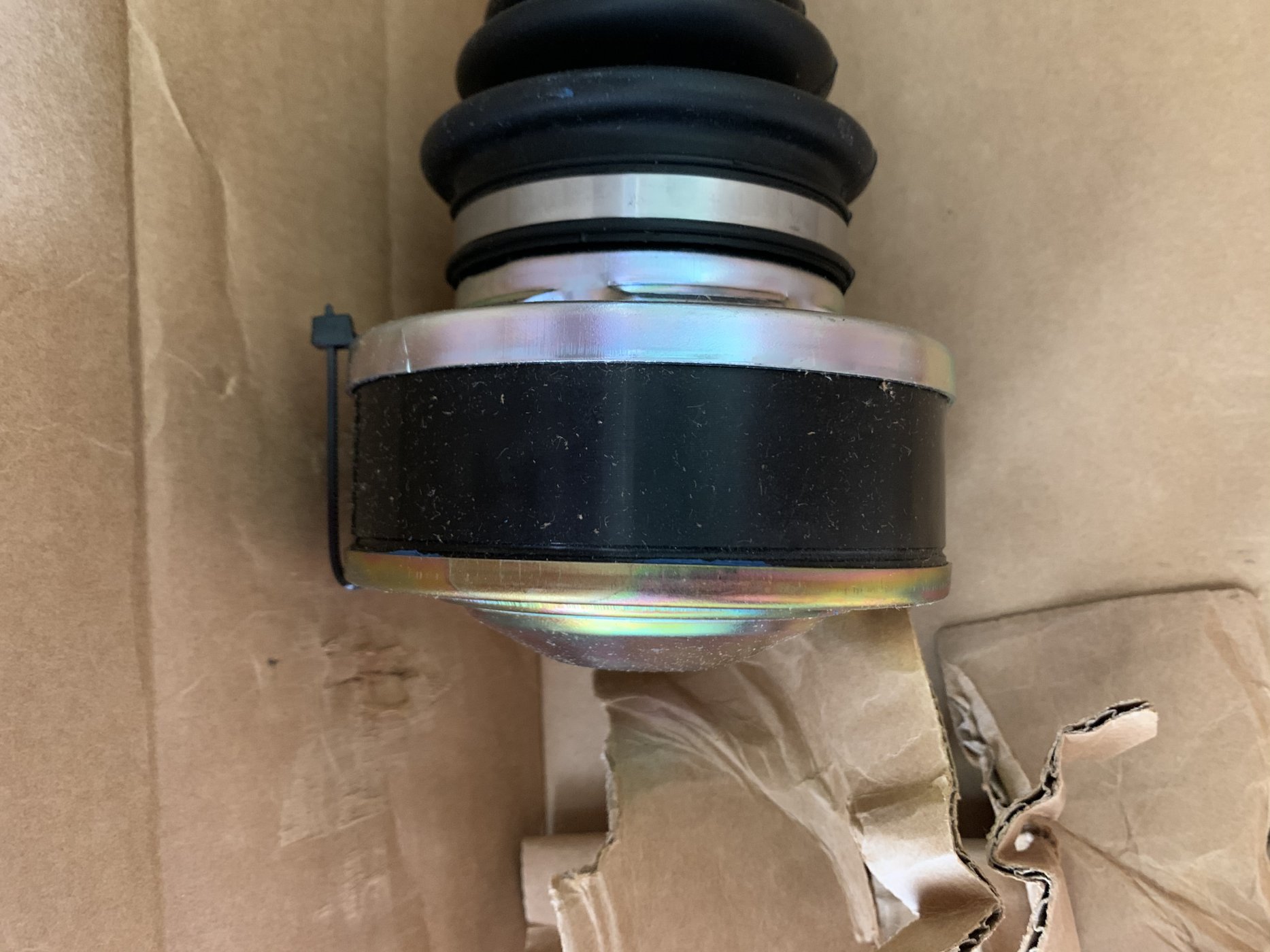

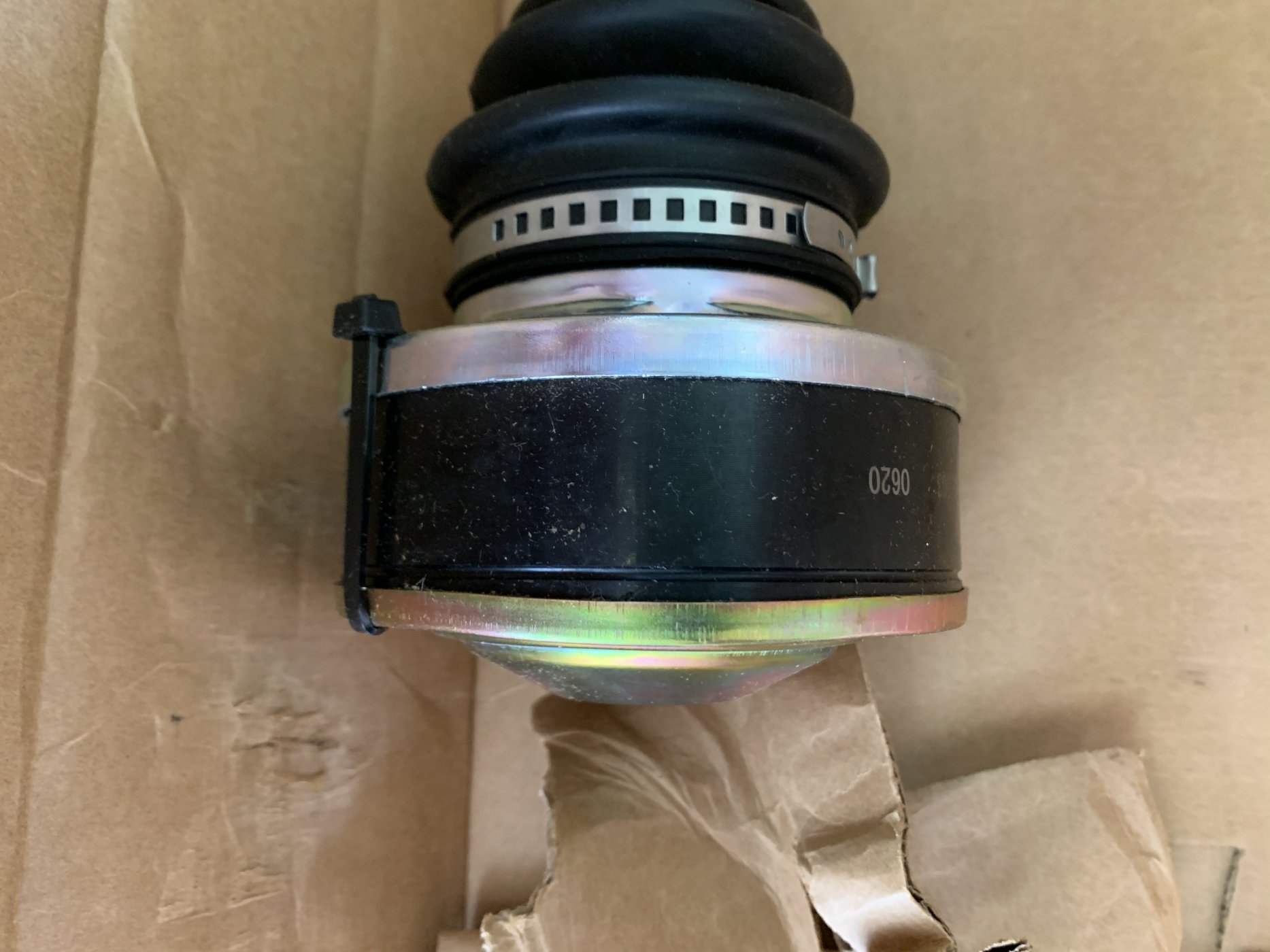

Also received my shafts from the driveshaft shop. Were anyone else’s brass colored plates a little “off”. I’m assuming once bolted to the hubs they will flatten?
The larger diameter rotors go in the rear.
I’ve heard that some folks with the CF5V wheel option need to run spacers in the front to avoid rubbing on the caliper.
Kyle
GT40s Sponsor
Ok so the calipers are correct then, just like a regular car. I’ll call the factory tomorrow and verify, I can’t be the only one.
I've read the larger rotors are for the rear and smaller ones are for the fronts. Not sure where I read this, but think it may have been on here.
My front calipers are very close to the spokes of the wheels, enough so I'm unsure if a CTS-V caliper would clear without spacers. On my car, I don't think I could run some spacers....at least not without trimming the fender lips on the inside a bit more.
Joel K
That is my understanding as well.
The GM part# for the rear rotor is #92245929 and front rotor is #92245928
If you look these part numbers up on summit racing you can see the dimensions listed
Rear Diameter:14.3”
Front Diameter:13.9”

So I realized in my original post I said rotors and not calipers, come to find out the calipers can only go one way, big ones in front. They do hit my wheels y maybe a mm, I have 3mm spacers that will be here Wednesday and already have extended lug nuts, hopefully that will be enough.

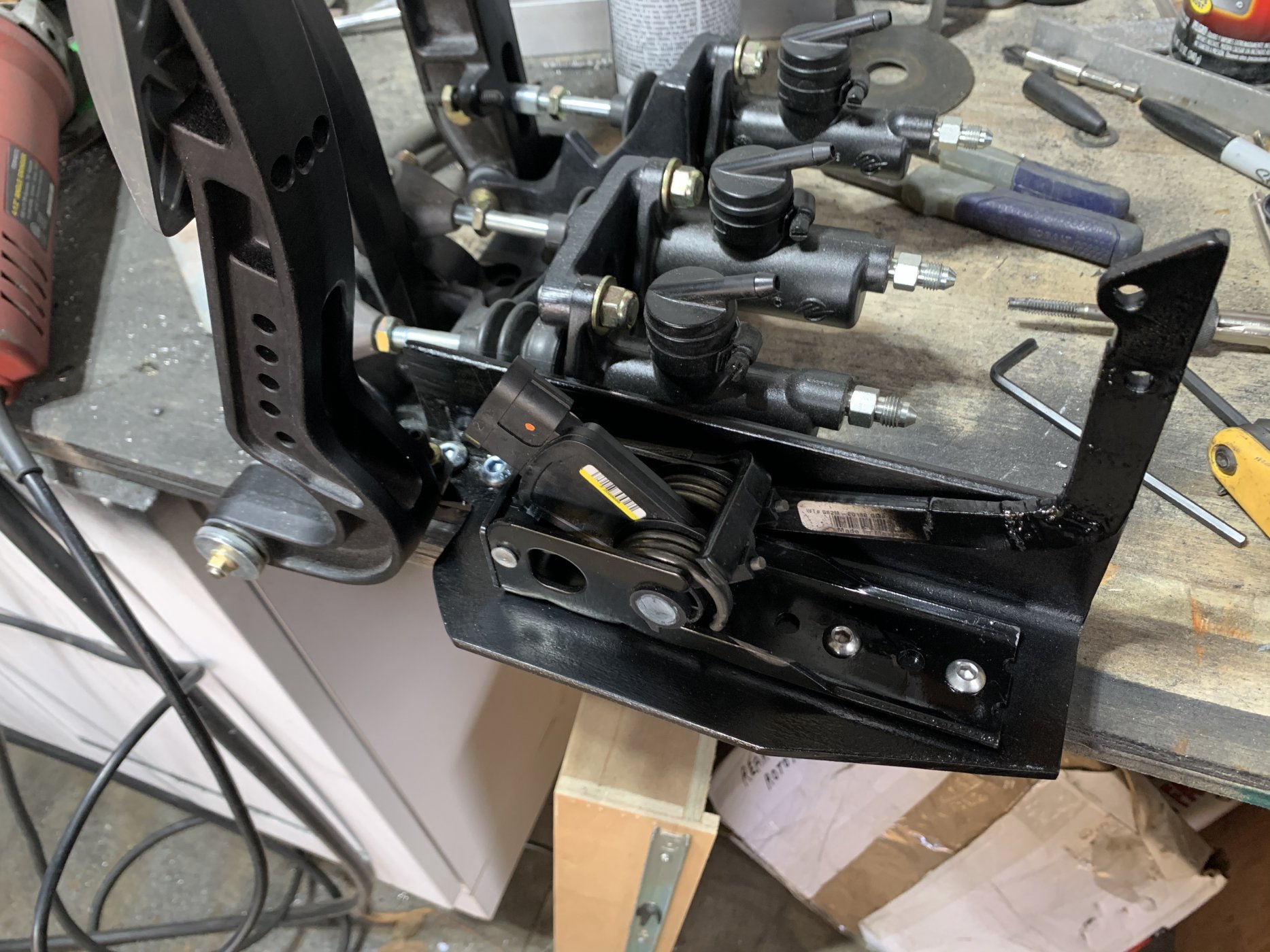

I finished the throttle and pedal assembly, works perfectly. Not sure how much travel the throttle pedal should have, it has maybe 1.5in of travel. Regardless, the actual DBW module is extending fully.

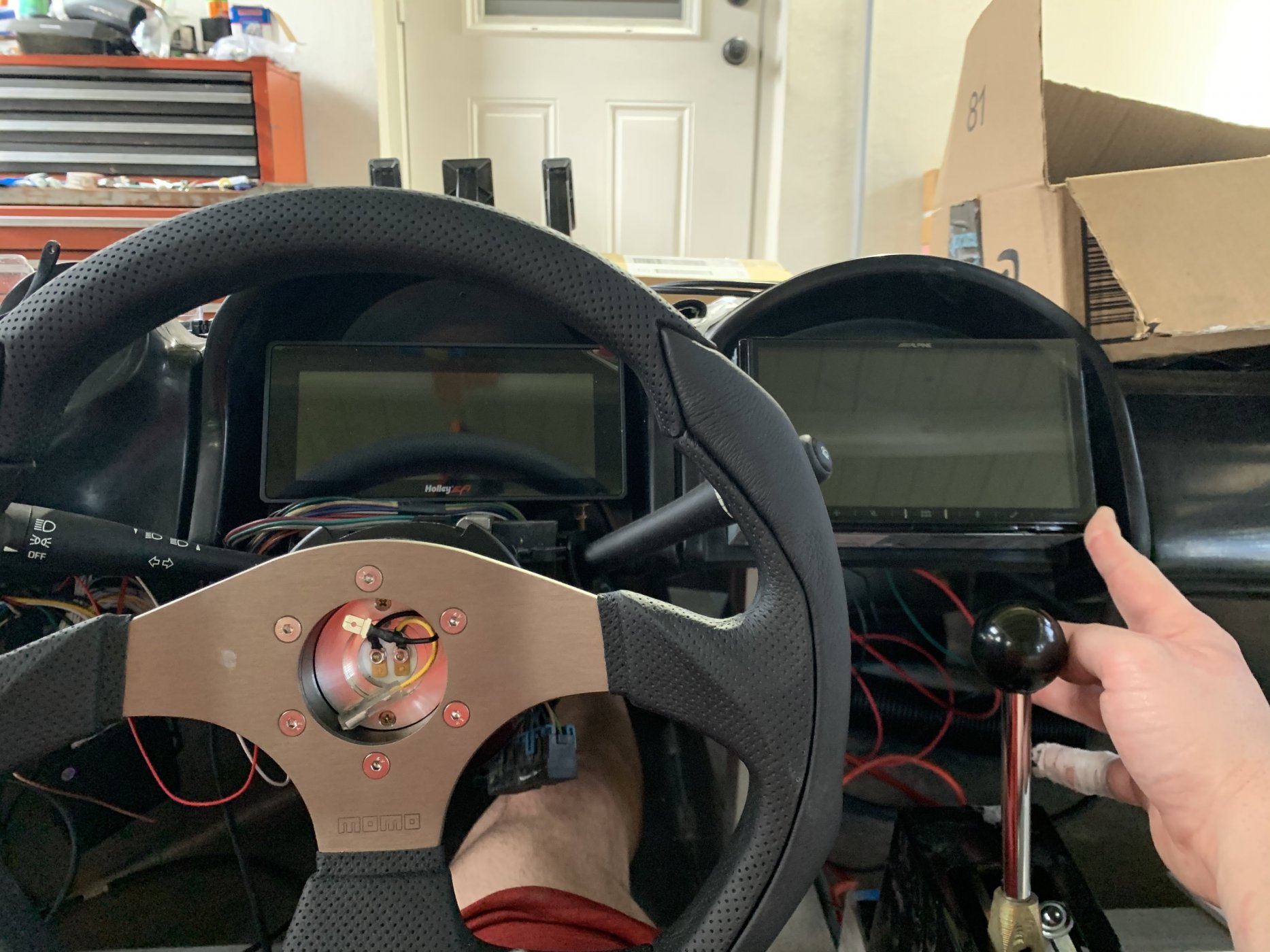

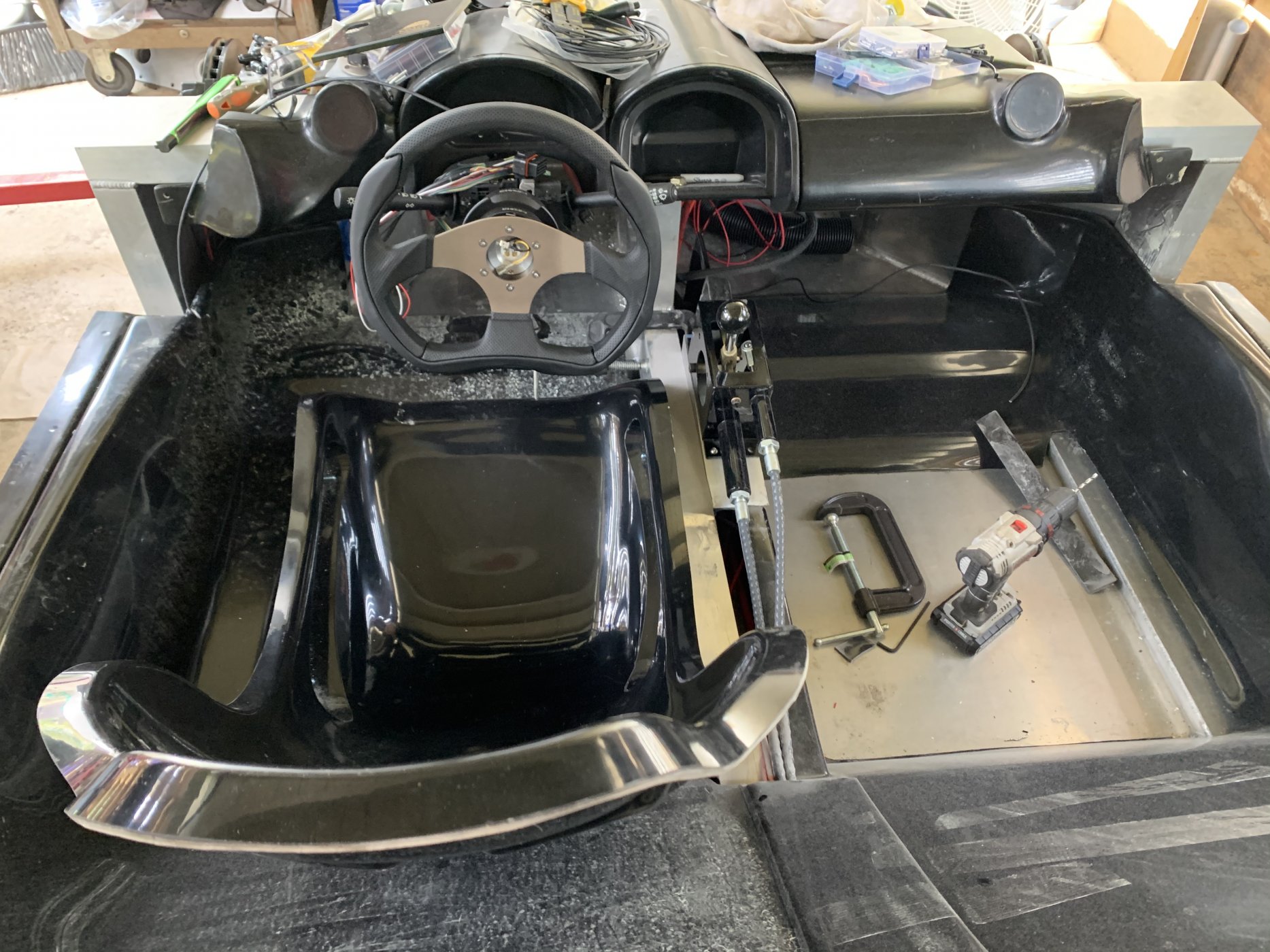

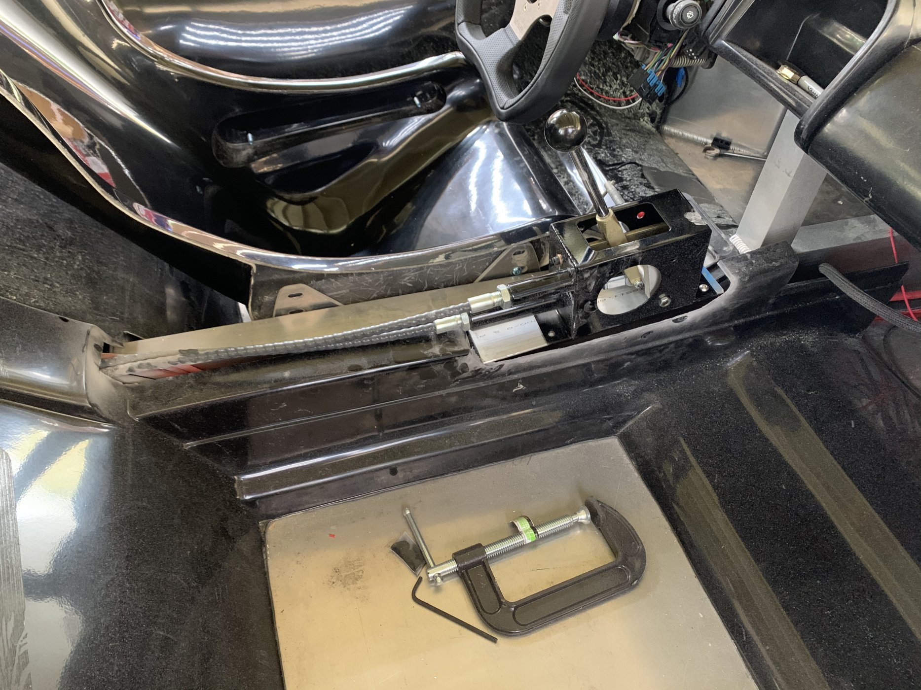

In the last few pics you can see I was able to get everything lined up fairly well, the center console fabrication is going to be a chore seeing as how the seat is so close.

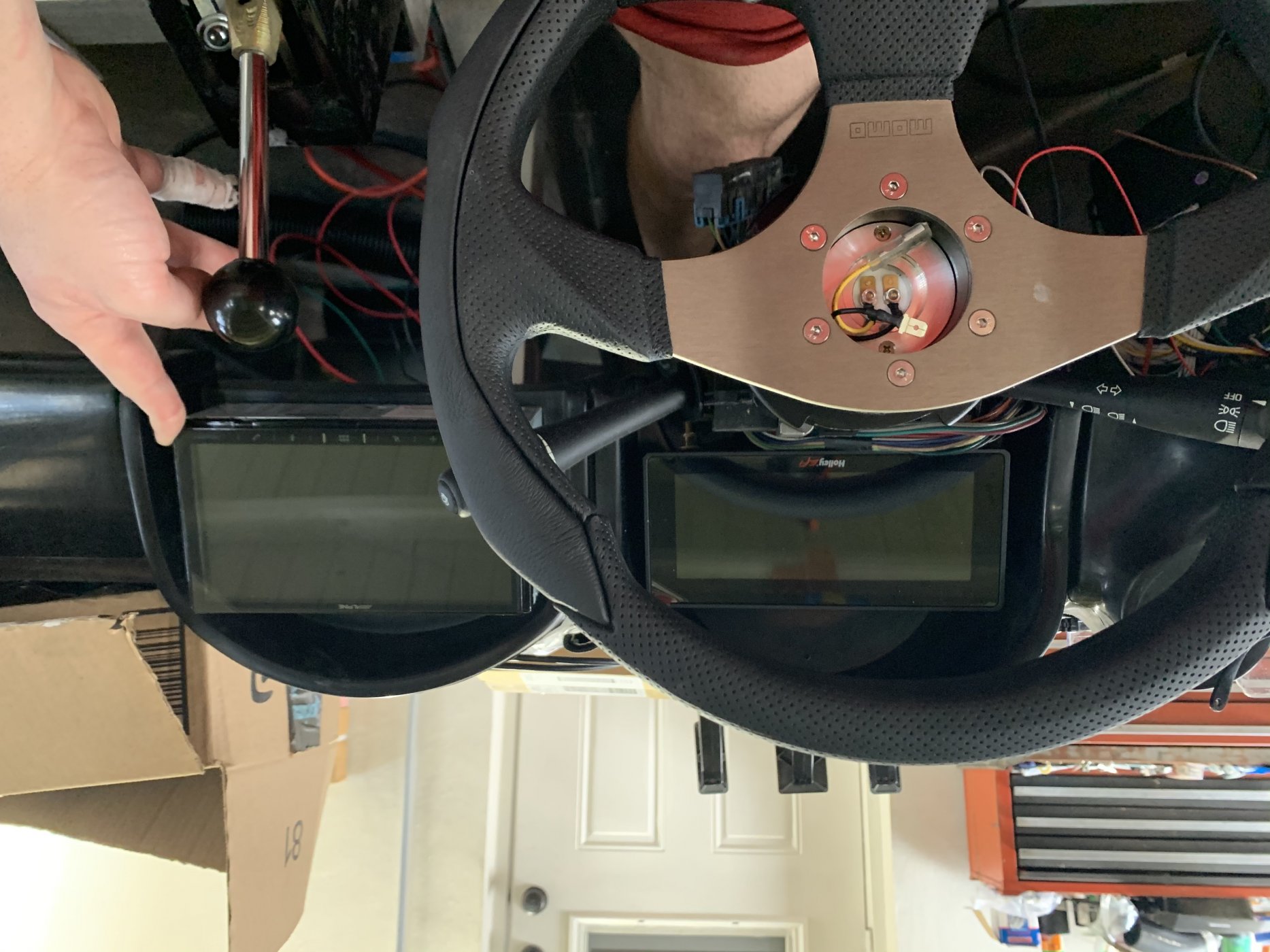

In this last picture you can see how nice the Holley dash and stereo will fit, basically just two touchscreens and maybe a couple of buttons below the stereo.

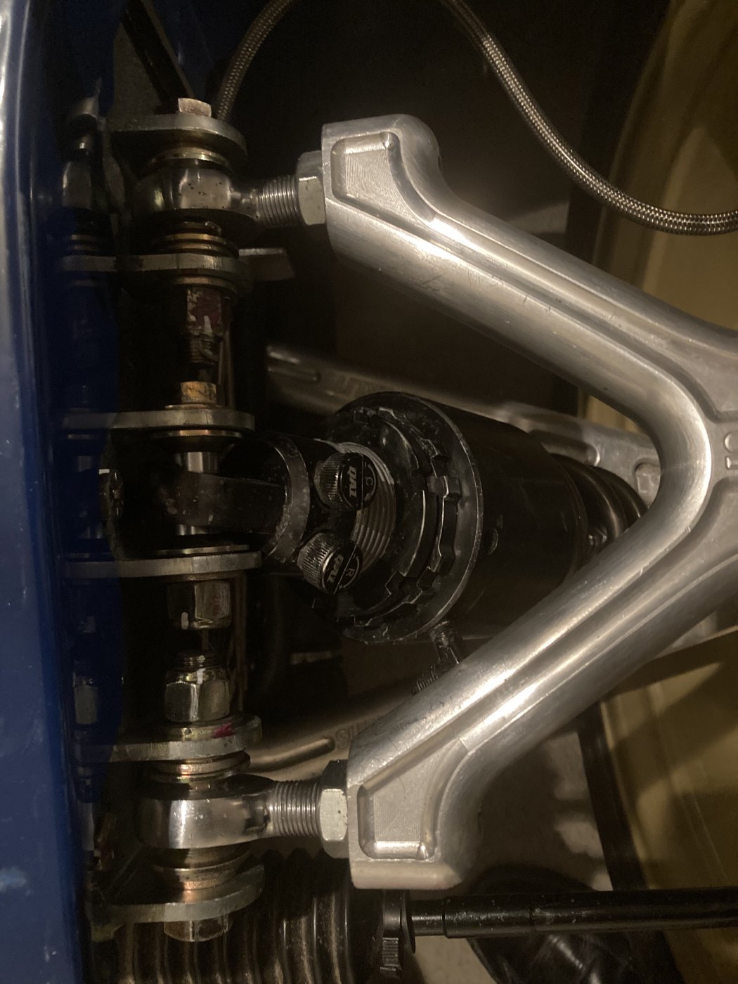

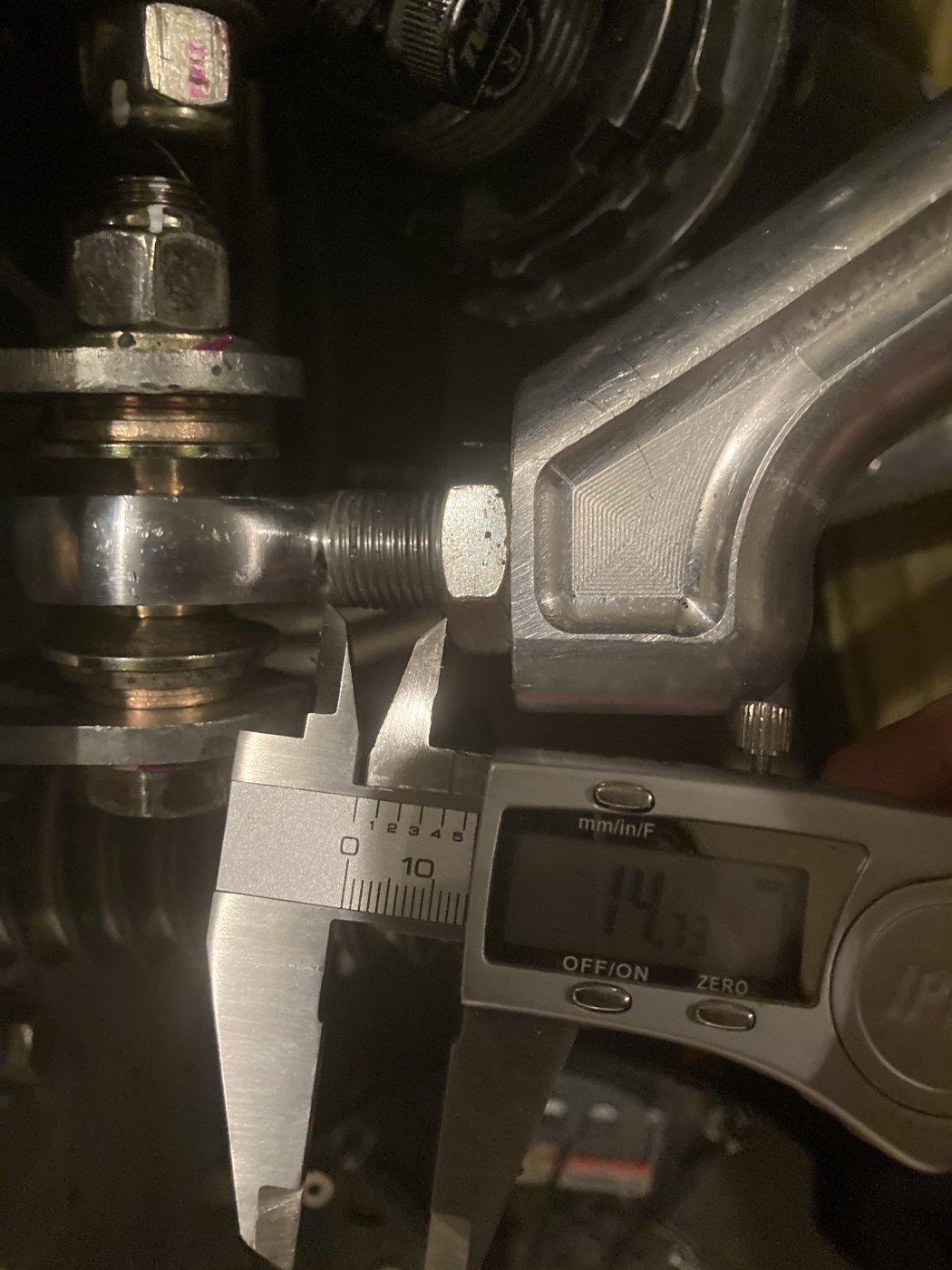

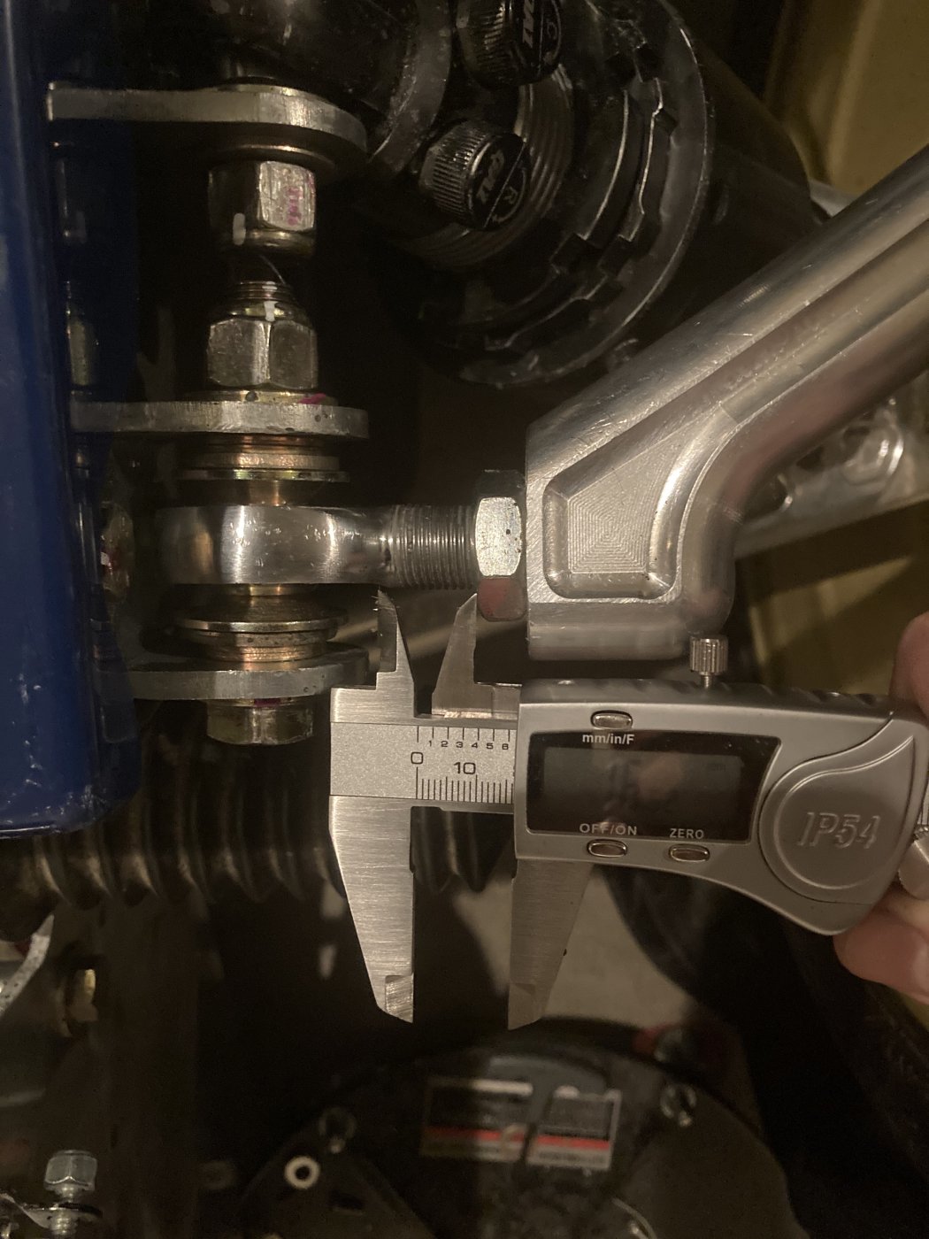

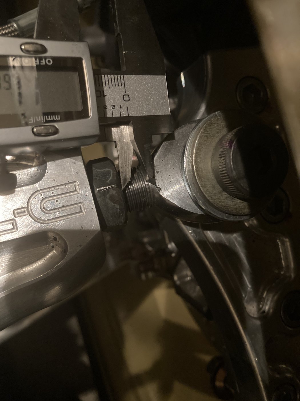

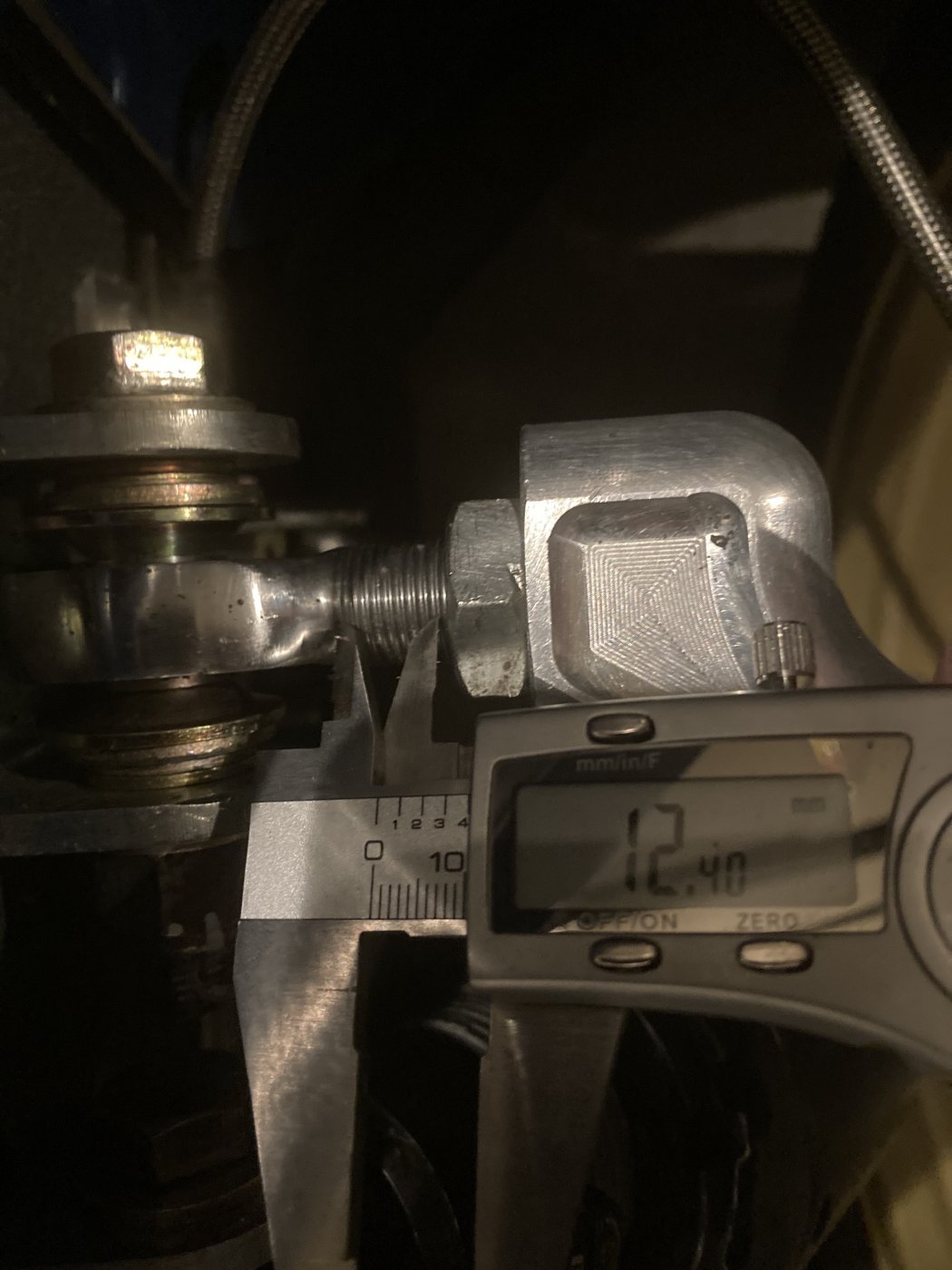

Does anyone have crude measurements for the front and rear suspension? Specifically MM measurements at the suspension adjustment points? I’m going to go back and look at cams blog, I thought I saw some in there. With these frames being damn near perfect, all of our starting measurements for the suspension should be fairly close assuming going with stock ride heights etc. I just want to get something close to start the alignment and then go from there. Hector? Kurt?

Hector
Here you go. Hope pictures are helpful

Howard Jones

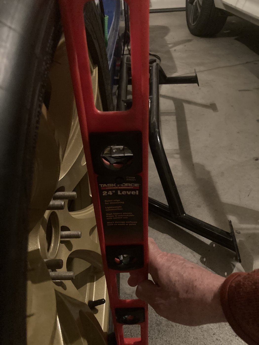

The goal is to have no tire to bodywork interference. That means a narrower rather than a wider track. Start with all four lower A-Arms as short as practical with the rod ends screwed nearly all the way in. Bottom them and screw back out a couple of turns. Now install upper A-Arms the same way.
Check Camber. If you have Neg 2-3 degrees, that's great. Now you have that much adjustability. If necessary you can screw out the lowers BUT you give up tire clearance if you do so avoid it if possible and minimize it if necessary. You can now set camber by only changing the upper A-arms rod end length. Hopefully only with the single outboard rod end that is attached to the upright.
In any final setup, the inboard rod ends on the A arms should always be the same number of turns in or out as compared to its mate on the other side. That means at the rear the two lowers are the same and the two tops are the same as compared to the other bottom or top. At the front, again the lowers are the same and the tops are the same. Do not set toe with them.
That's the end goal. Place the A-arms so that the camber can be adjusted with only the outboard rod ends on the upper A-arms. For a street car, your final setting will be neg 1/2 - 3/4 degree. Track only cars will run neg 1 to 2 1/2.
Now that you have the adjustment range accounted for, set camber to 0 on all four corners with 0 toe. Leave the car setup this way until you finish the bodywork and are SURE you have no body to tire interference.
Note: RCR told me that the washers on either side of the A-arms inboard side rodends within U mounts should be centered to get the correct caster, That's how my car is set and it seems fine to me even though I have never measured caster.

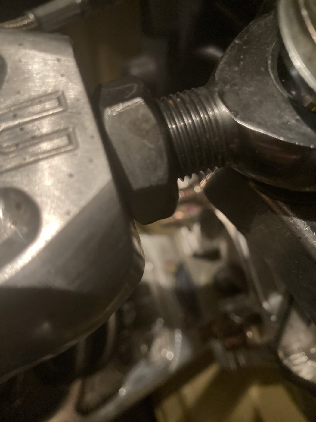

BIG ASS NOTE!!!!!! Always adjust a rod end so that when done with adjustment at LEAST 50% of the threads are screwed into the parent part (A-arm in this case). This does not include jam nut. Measure from outboard face of jam nut to end of threads = 50% of total thread length. In our case given we are working with aluminum, I have made that 60% for peace of mind. This can be a difficult rule to follow. Do it anyway.
This process can be time-consuming and a bit frustrating but if you set up the suspension this way AND THEN place bodywork at least you won't do it the other way around and find you have body to tire issues and not enough suspension adjustment to fix it AFTER you think you have finished body mounting. THAT will be frustrating!

I received some 3mm front wheel spacers which give me just barely enough wheel to caliper clearance.
