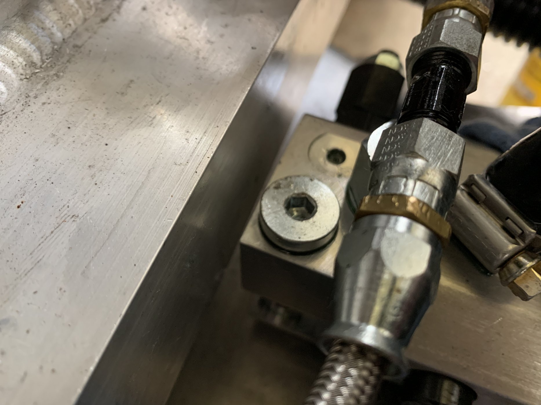

I just checked my tool, you’re right I did a 45 double flare.It should be 45 degree double flare. Bubble flares are for metric fittings and altogether different.

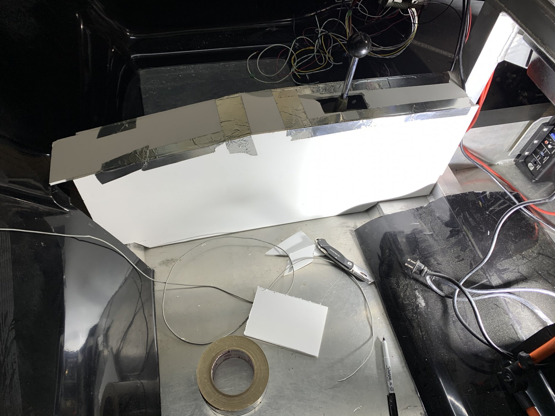

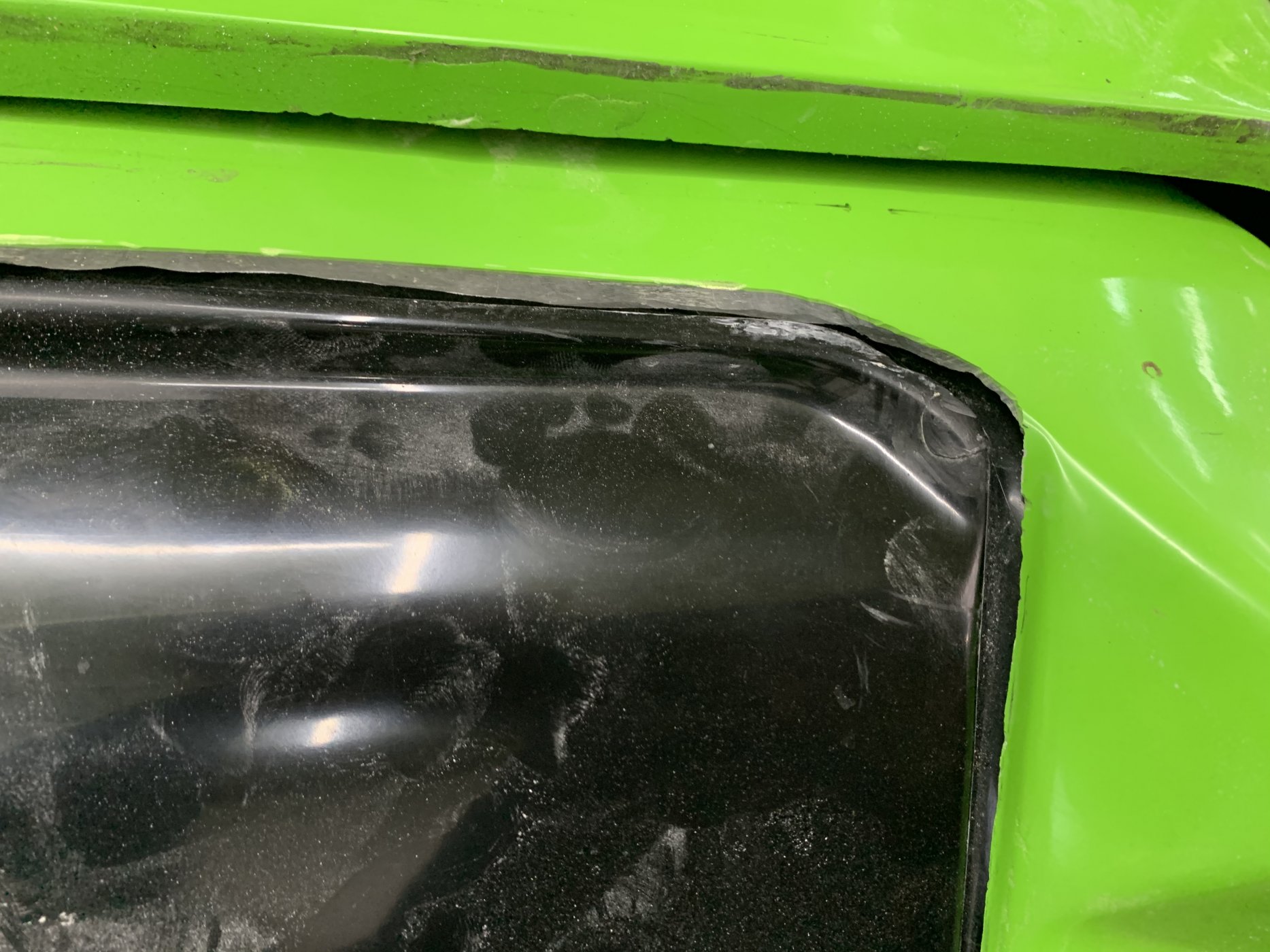

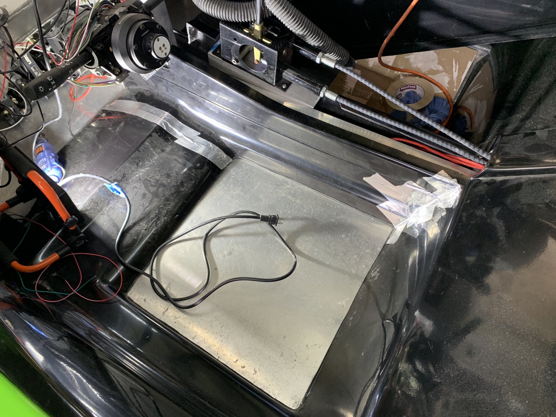

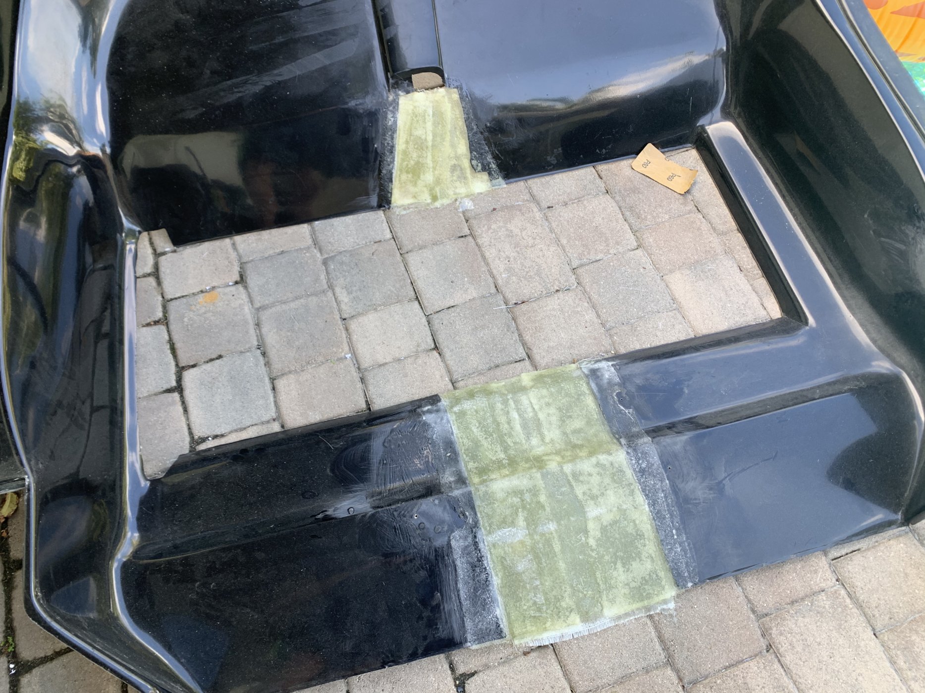

Thanks Joel, I’m definitely going to put insulation on the tub. I’m more so wondering if everyone is putting insulation on the floor boards where the tub and frame meet. These kind of details or up close pictures tend to be lacking. I haven’t quite decided if I’m going to cover the tub in carpet, paint it, or skin it in carbon fiber. Either way, the transition where tub meets floor always seems to be an undocumented area.Kyle,
Cam did a nice write up on this and you can see where he placed the sound deadening on the tub.

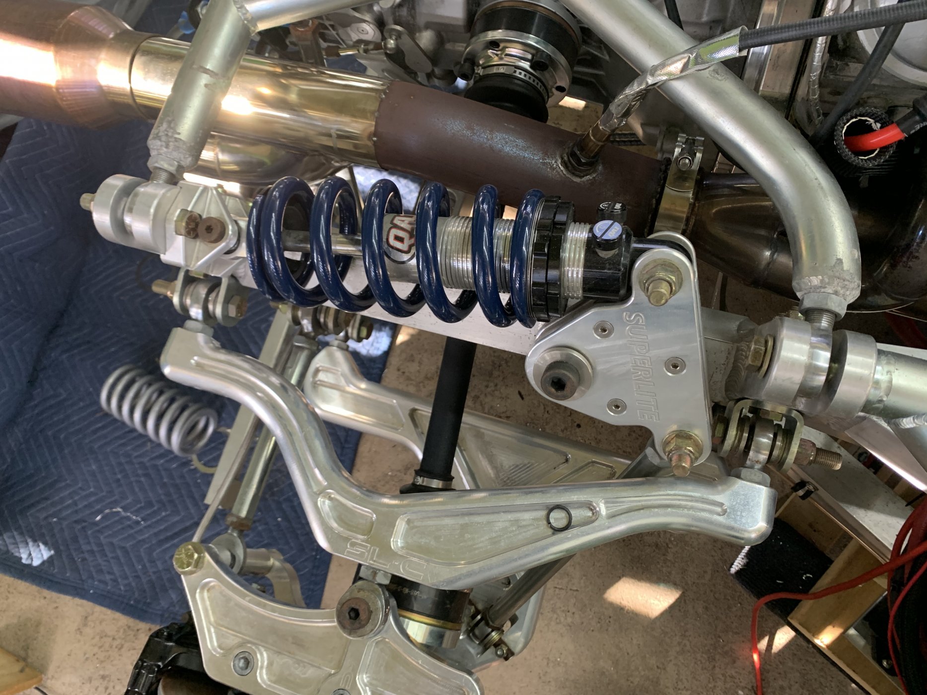

Did a few things today. Installed 8in 850 springs. I have another 80lbs with an iron block. Probably comparable to everyone else who has a Graz, super chargers, oil coolers etc, but just wanted a little extra spring.

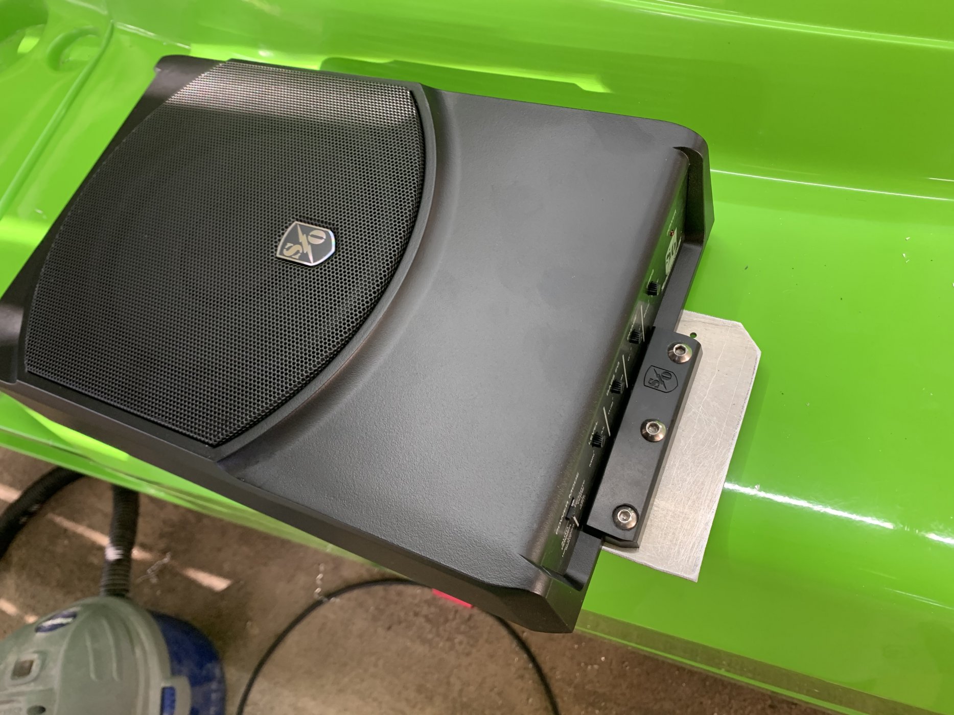

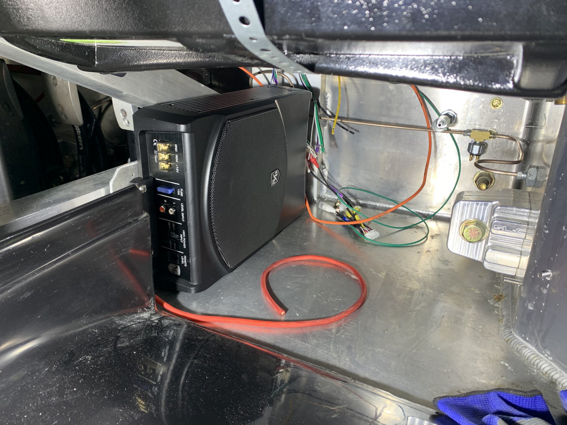

Mounted and set a location for the powered sub. Practically no room in this area.
View attachment 113233View attachment 113234

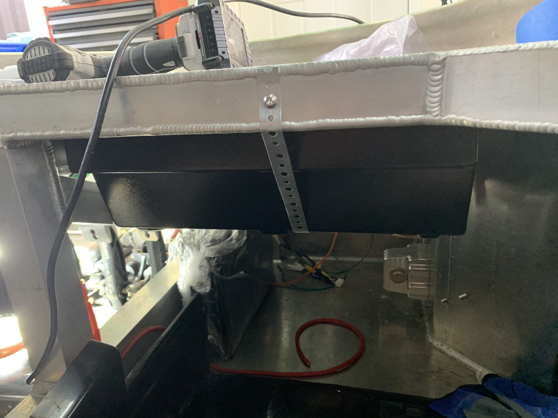

Mounted the evaporator. I just used a single metal strap. It goes up the back in between the housing and motor, then around the front. Not the prettiest now but it is rock solid and only one bolt to remove. Just need to add foam tape up top for some cushion and a little extra hold.

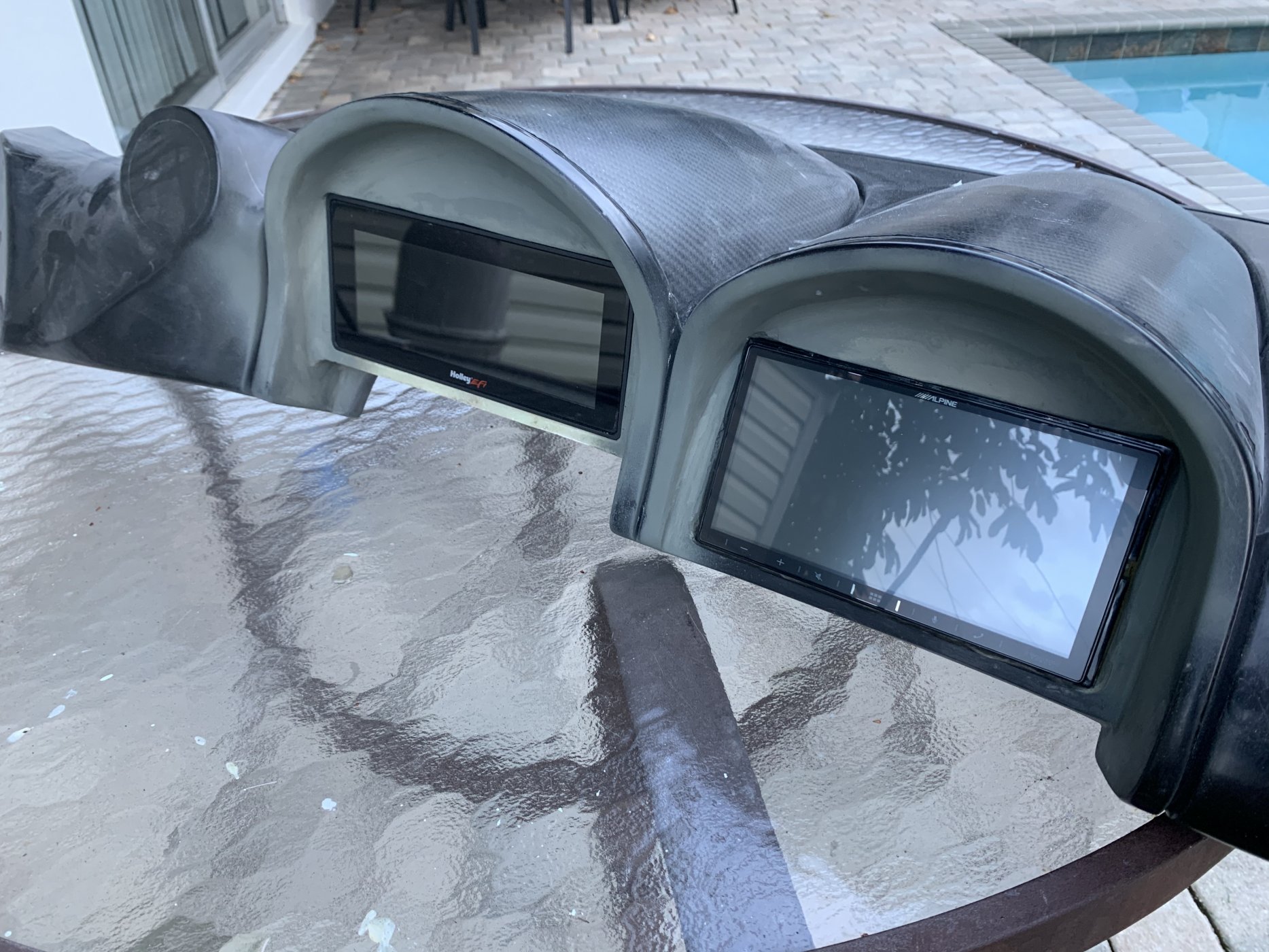

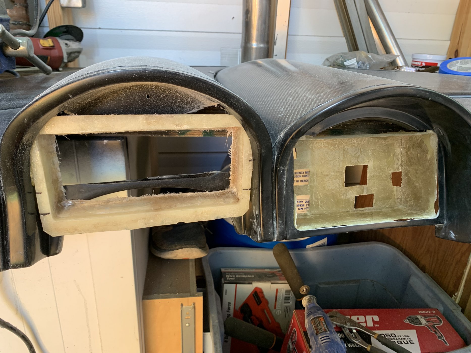

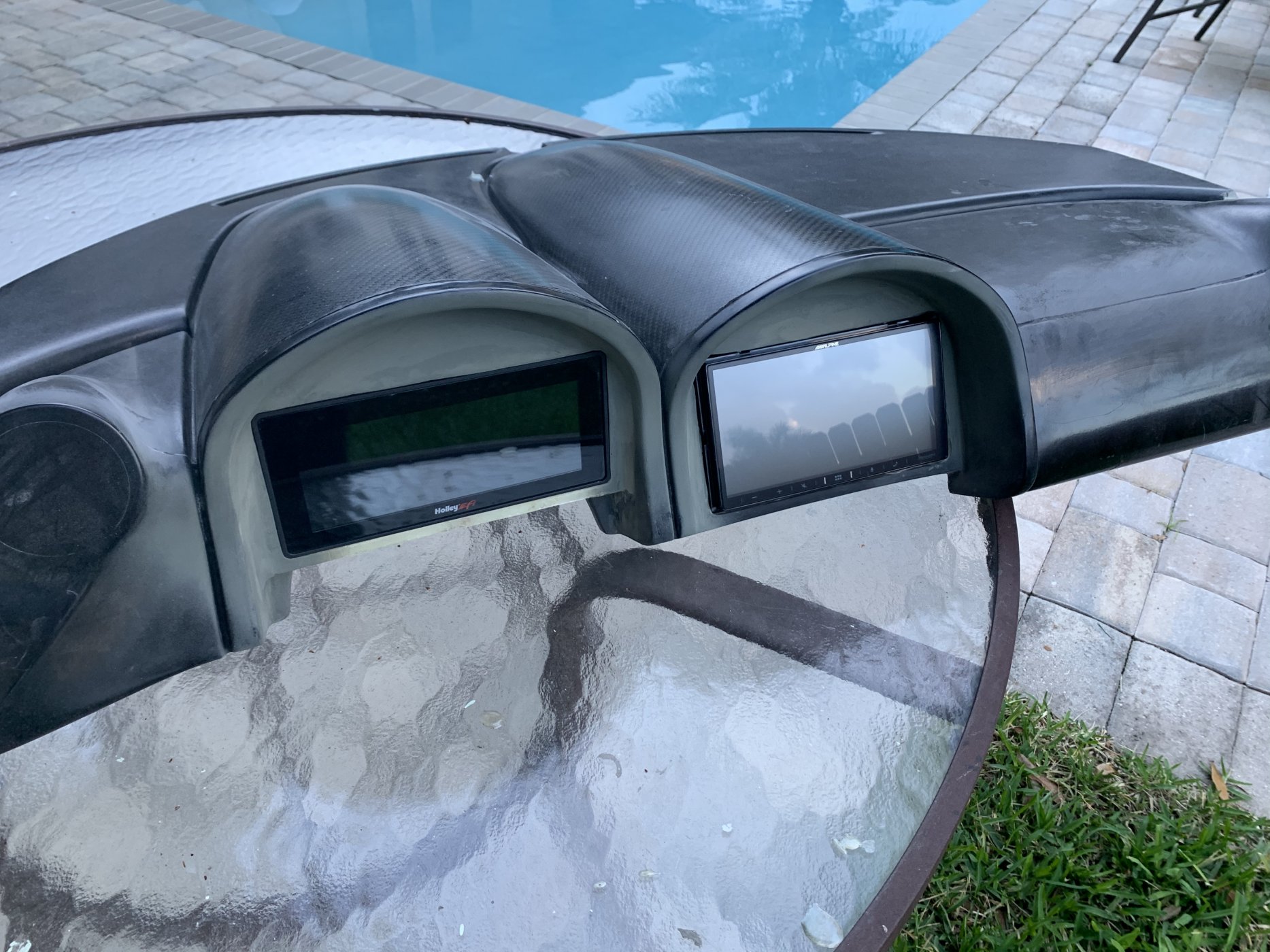

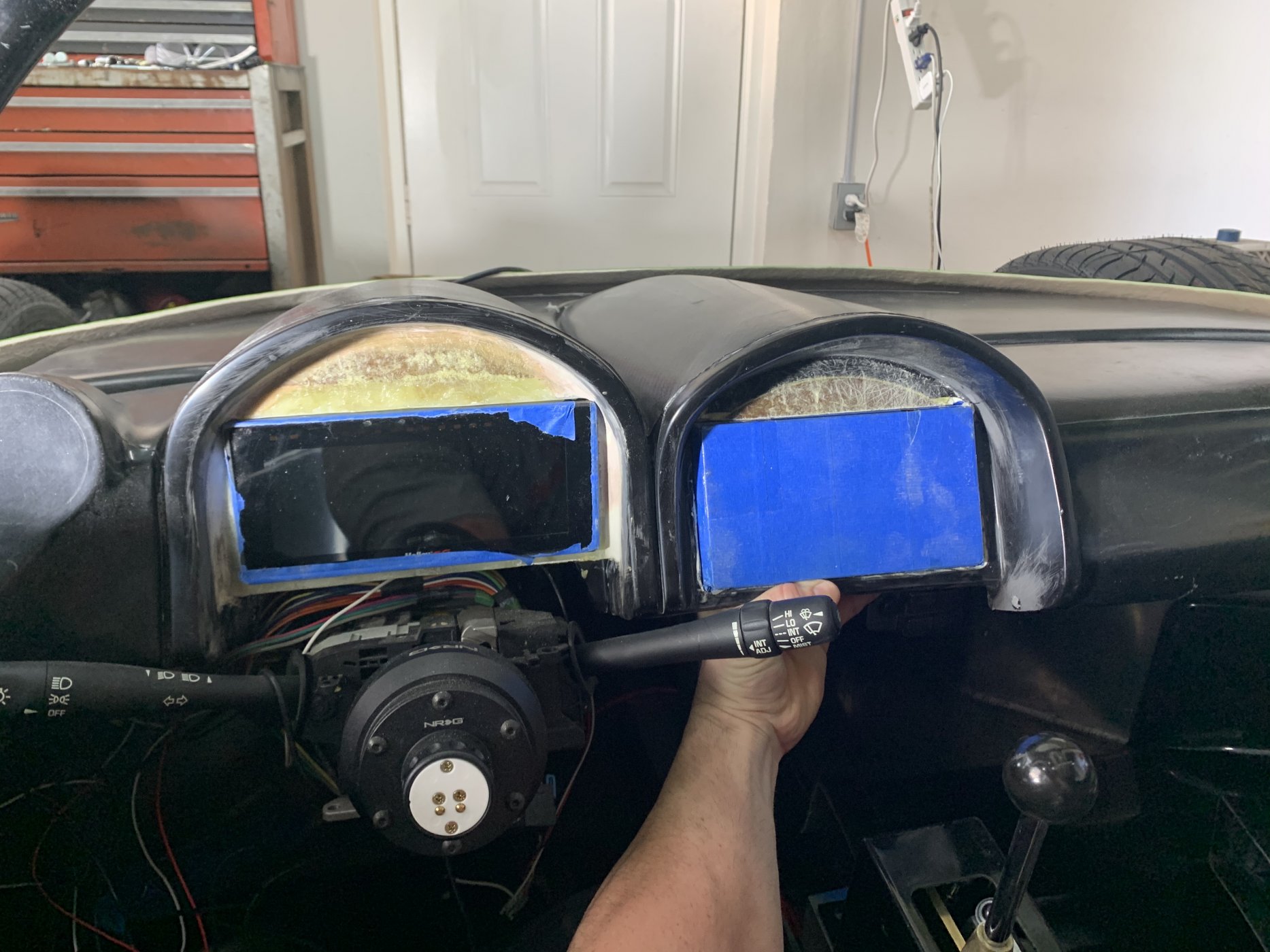

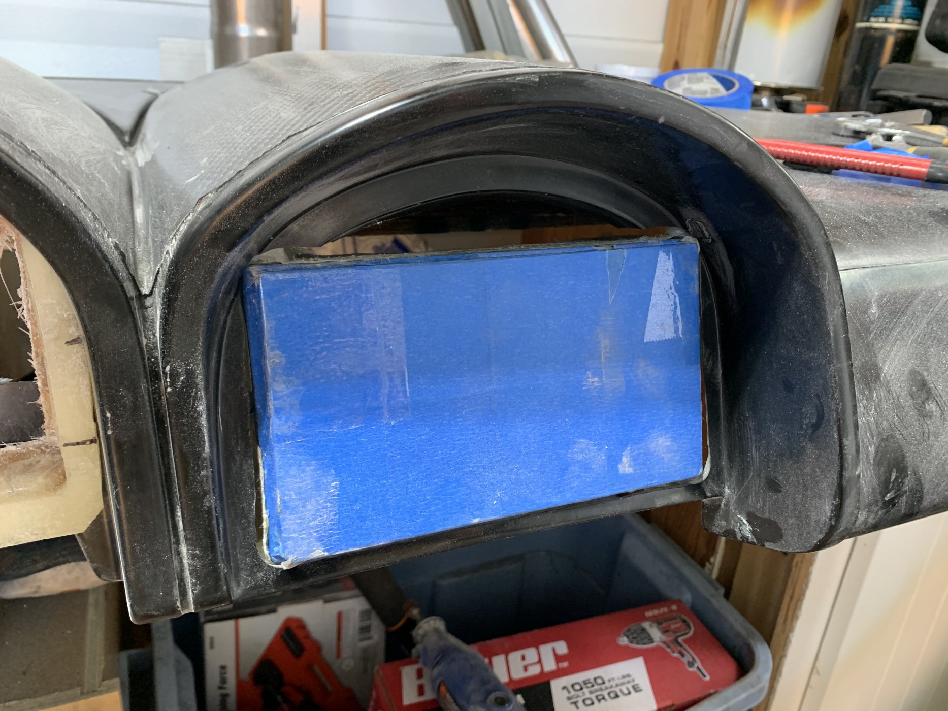

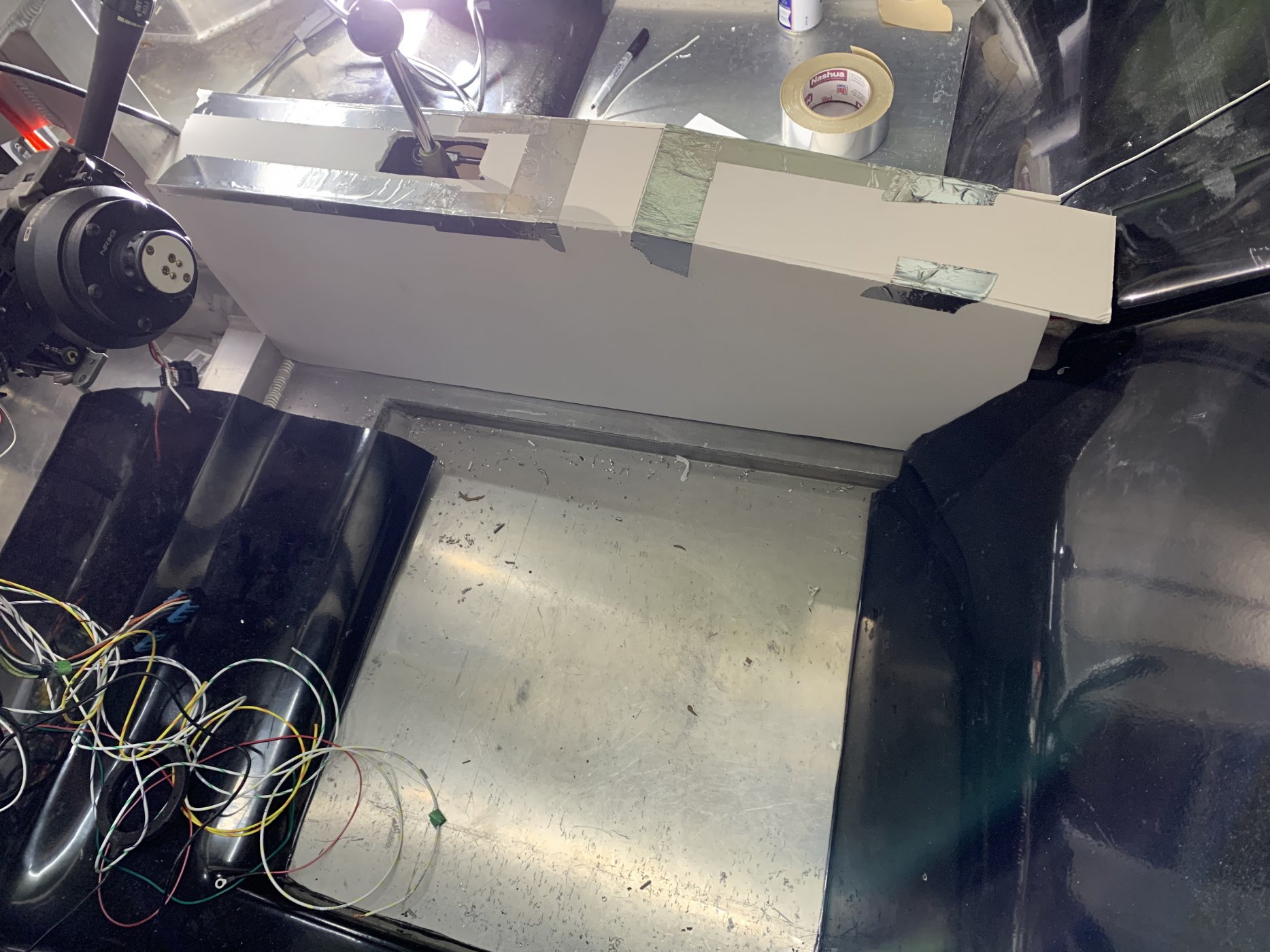

Finally epoxied and cutout the areas in the dash for the Holley and stereo. Both should now just slide into the fiberglass surrounds with no bolts etc. I will need to do extensive fiberglass work to fill in the areas I had to chop out.
View attachment 113236View attachment 113237View attachment 113238

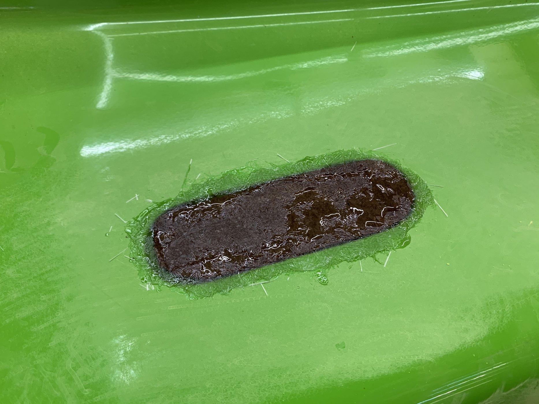

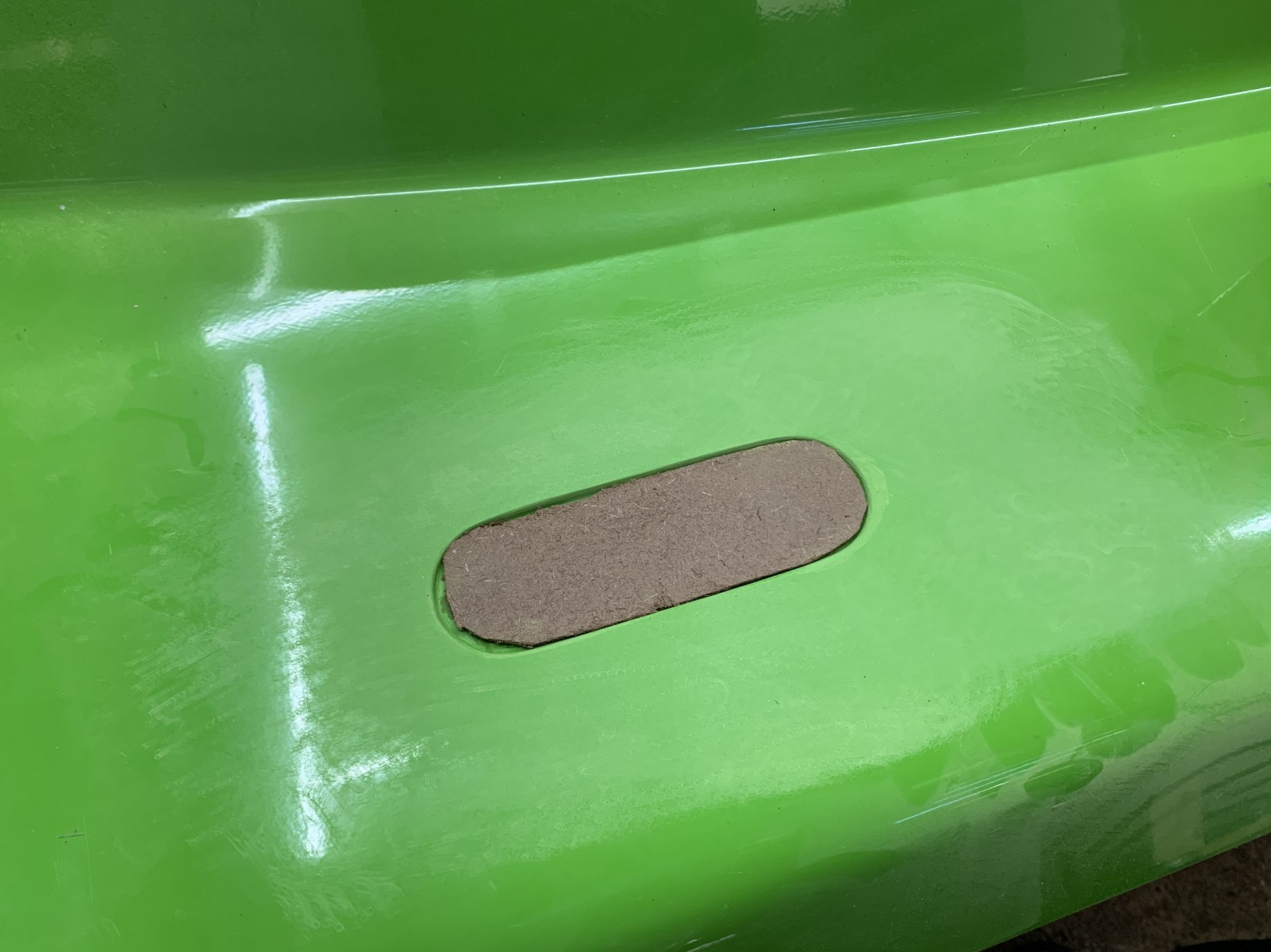

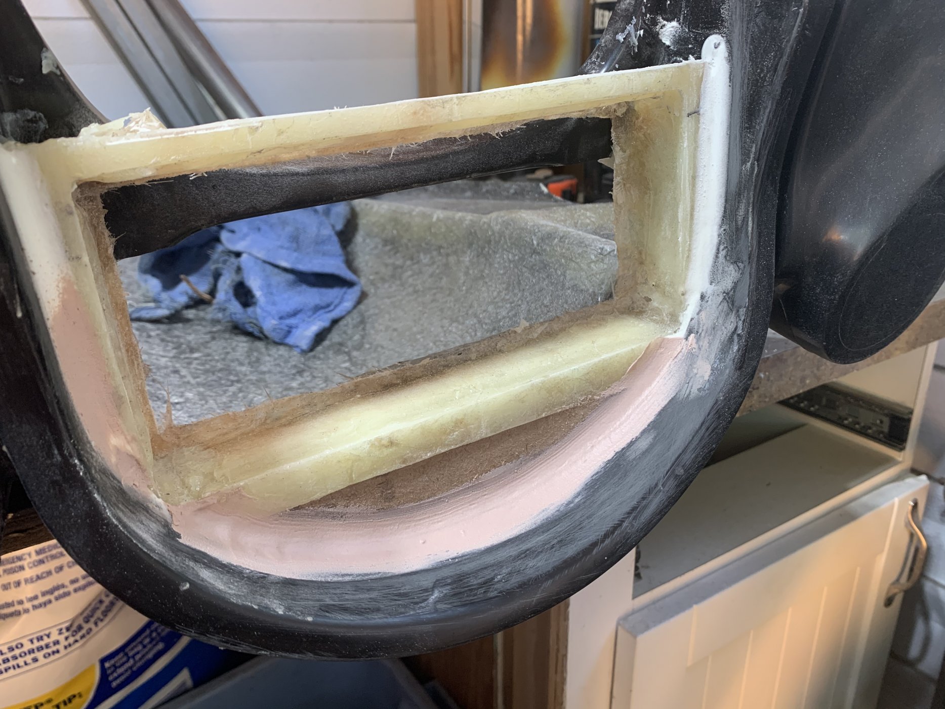

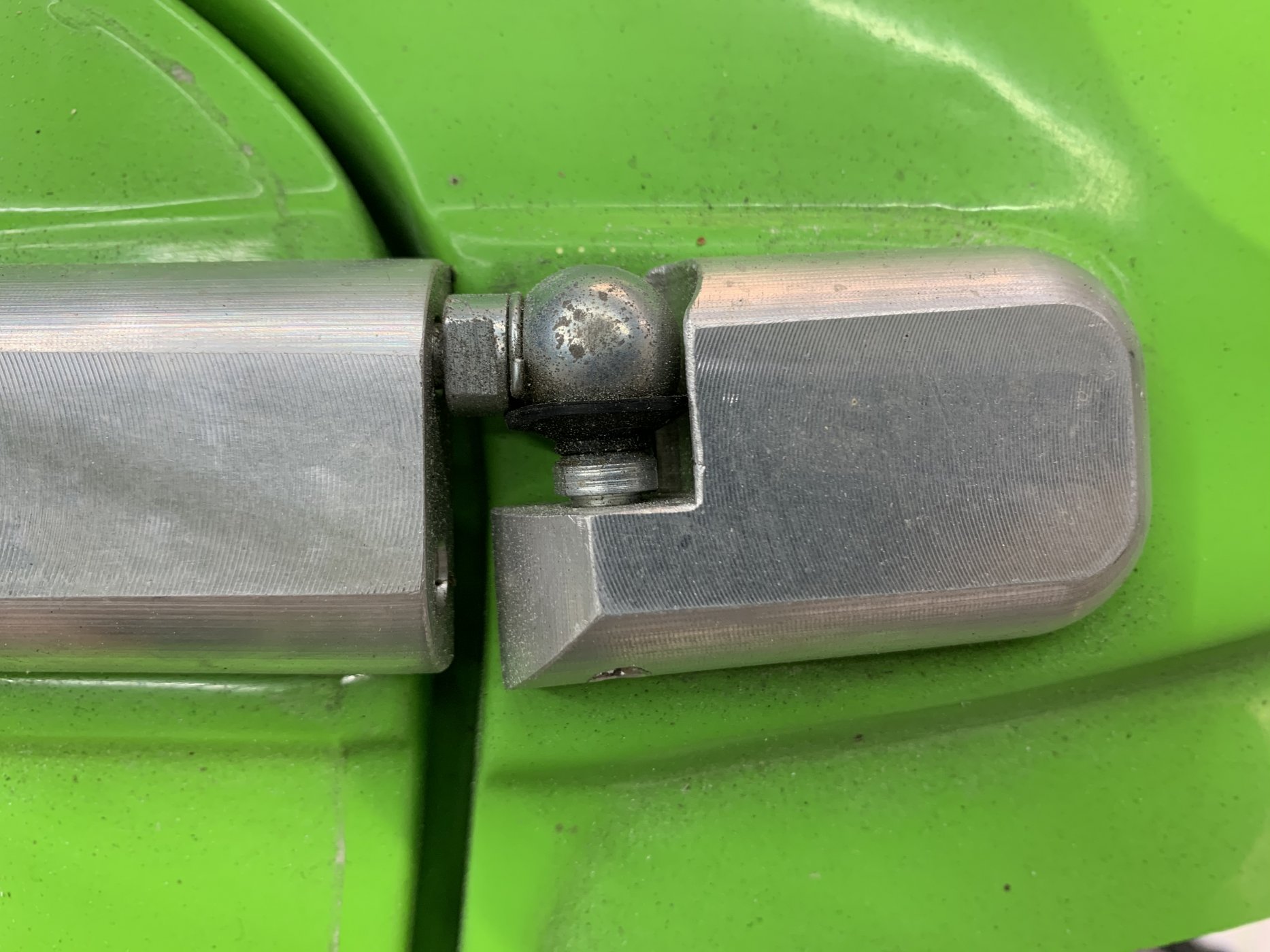

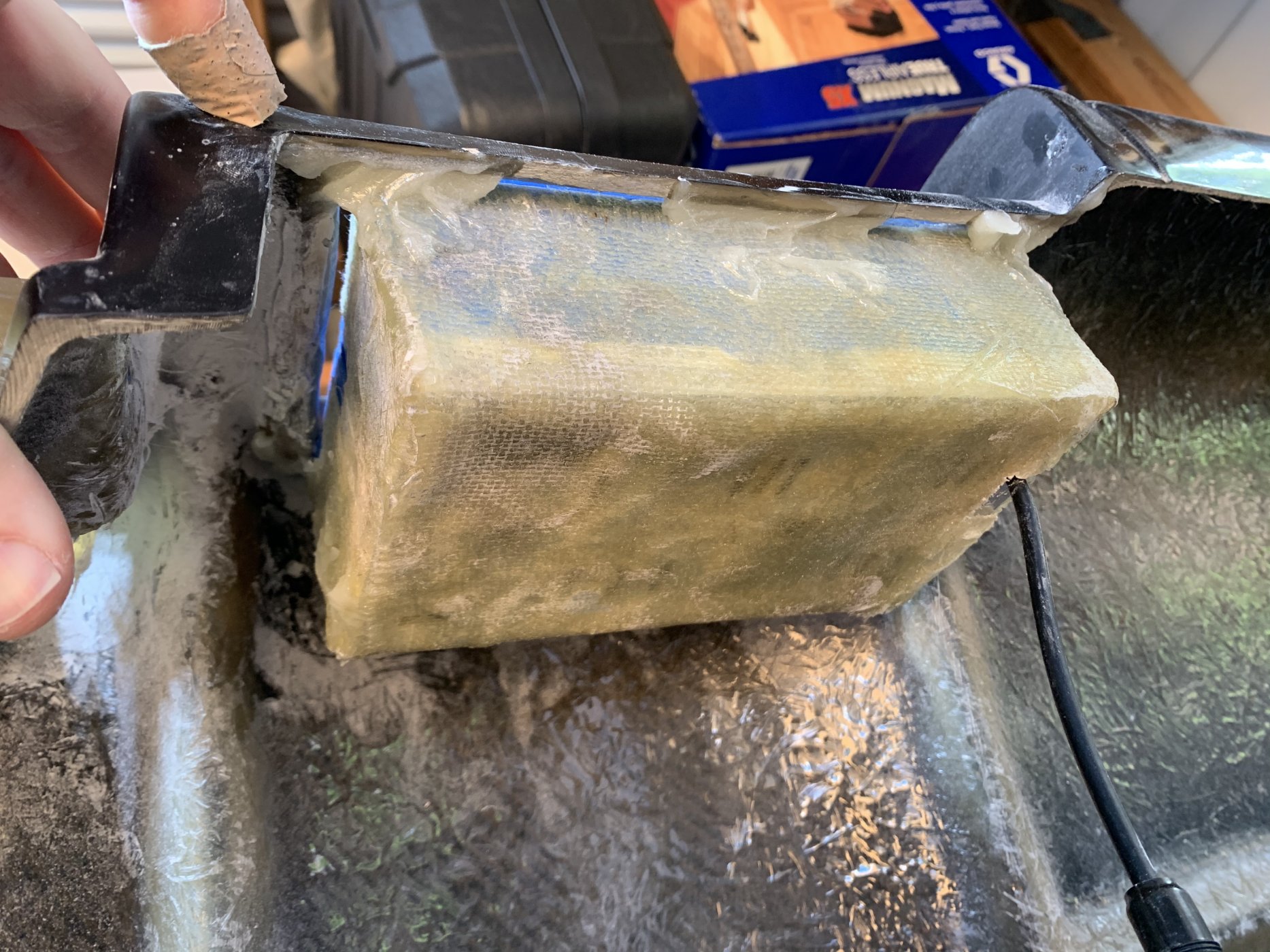

Last, I started to glass in the door handles areas since I will be using the actuators.View attachment 113239View attachment 113240View attachment 113241
Just some thin plywood with about two layers of glass mat.What material did you used for filling in the door handles before fiberglassing.
