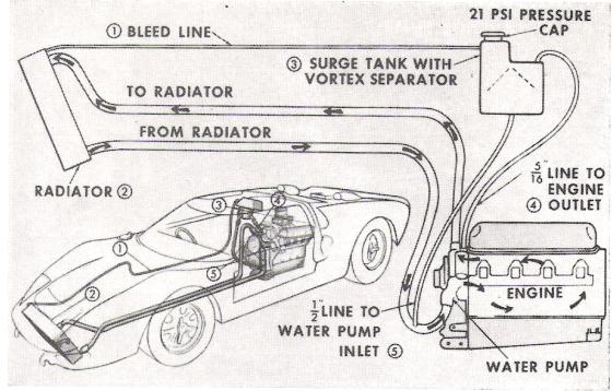

Also read up on coolant system air bleed systems. Done correctly they will solve air in the system problems permanently. They are especially necessary in mid engine cars.

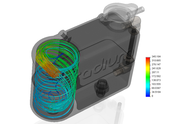

Howard, interesting diagram. Do you have any insight into the vortex separator? I was thinking about incorporating one when I have my expansion coolant tank made, but I haven't been able to find much information on how they're designed.
The most information that I've found is for Radium's product. According to their website:
Hot pressurized coolant from the cylinder head is sent into the vortex chamber's inlet tangentially and accelerated to a high rate of rotation. This is to help aid in deaerating the system.
