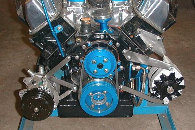

My distributor has been cut down and an aluminum top put on it. I'ts purpose in life is to drive the oil pump.
