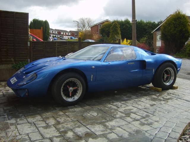

I am in the process of getting my Dax 40 back on the road after going through a number of personal and financial disasters over the last 3 years. Thankfully, I have managed to hang on to a number of things very close to my heart, one of which is my Dax 40. I purchased my Dax 40 direct from DJ Sportscars in 1991. It was registered in 1994. My web site, http://www.champagnieres.net, details a bit of this. I am currently attempting to get the car back on the road so that I can make the Kit Car Show at Stoneleigh, Warwickshire, England in May.

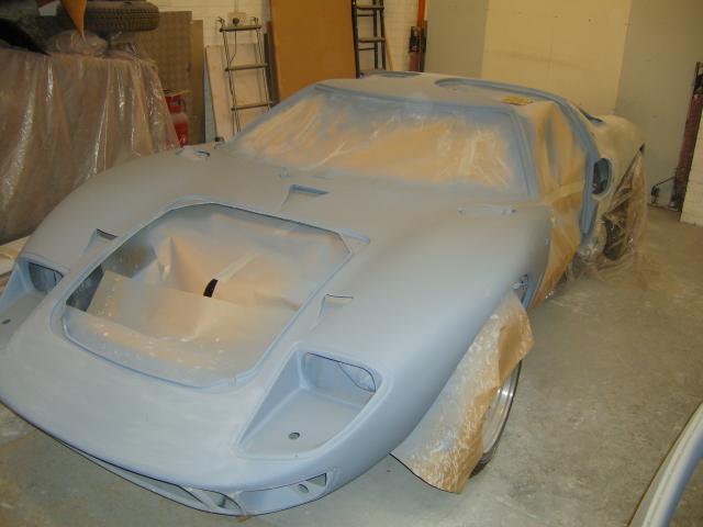

The car is currently being resprayed. I have included a number of photographs.

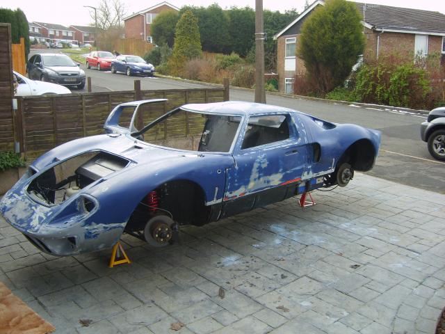

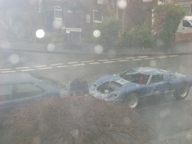

I am also convinced that all this bad weather we have experienced is my fault. One result of my situation is that I no longer have a workshop / garage at home, which I can keep the car in. The car has been kept at a location about 10 miles away from my home, at the friend of a friend who has a double garage he doesn't use !! Anyway, I decided I wanted to get the car repainted, so towed it to my home, where it had to reside on the drive. I have attached a number of photos depicting it on the drive, being towed to the painters, and currently in primer.

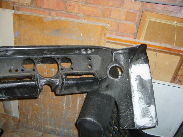

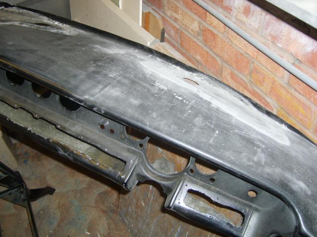

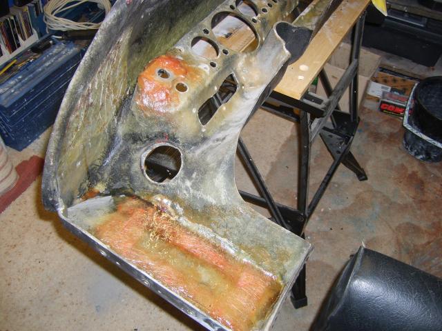

Well, while the car is at the sprayers, I am tackling the dashboard. This was removed prior to taking the car, so as least I've got something to do while the car is away. When the car was initially being built, I decided not to have the dash covered, but to use "crinkle" finish paint. This seemed to work very well on the aluminium plates, that take the switches, but not too well on the dashboard itself. You may be able to see some of this in the attached photos. I have decided therefore to get the dash covered in leather.
I am in the process of rubbing it down and making a few "slight" amendments. I was under the impression that the Dax originally took the moulds from a KVA, and was then modified somewhat. Does the dashboard from the KVA allow for the fitting of the Ford Zodiac demister panel ? The Dax certainly does not. Again, hopefully by reference to the photos, you will see 2 round holes cut in the top of the dashboard. There were fibreglass covers over these holes with slits in them for the air to come through. I have removed these as they were catching on the windscreen moulding !! I plan to fill these holes and make 2 slits in the top of the dashboard and put covers on, once the dash is recovered.
The other thing I did when initially building the car was to make a small "glove" box in either side of the dash, as some form of secret drawer. These could only be opened when the doors were open. I have since decided that this may make the dash even more difficult to cover, so have fibreglassed them back up.

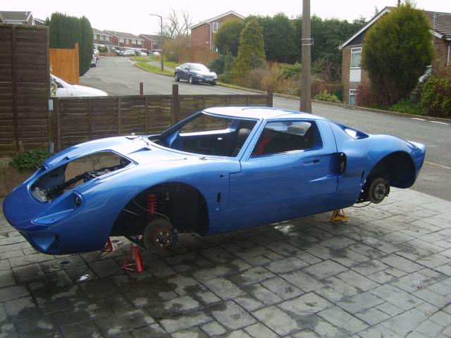

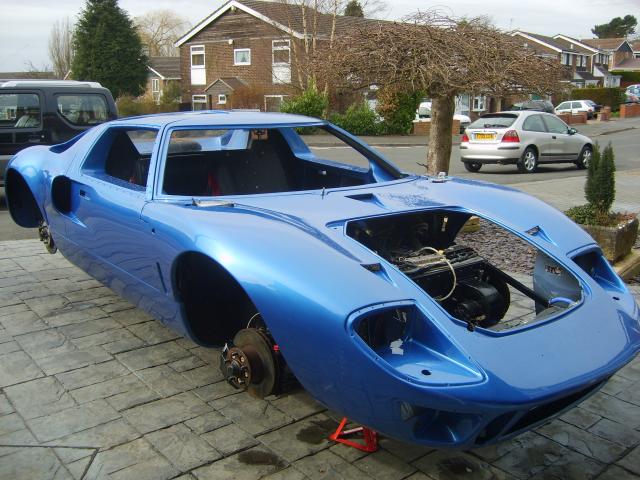

Picked the car up on Friday afternoon. I am absolutely amazed at the difference in the cars looks. Have posted some photos so you can compare "before" and "after". Unfortunately scratched the front towing it back, but at least it should not be too difficult to repair.
Whilst writing, does anyone have any idea what the spring rates on the front of the Dax should be ? Unfortunately, the ones I have on, originally supplied by DJ's, do not say. I am not 100 percent happy with how the car sits. To me, it appears slightly nose up, even though I have measured the distance from the front of the chassis to the ground and the rear of the chassis to the ground and the distance is equal. I would like to drop the nose slightly, but don't want to affect things too much as the ride height is OK. I have tried various springs with different rates in the past, and couldn't get it sorted. The original ones fitted still seem the best of a bad lot. I have tried adjusting the tightness on the shock absorbers, but I can't really adjust any more without the springs being loose !

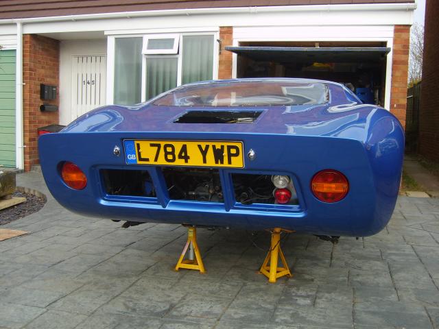

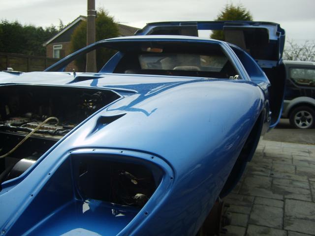

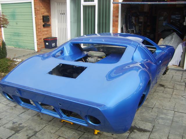

Starting to take shape again. Rear end almost complete. Story of my life, - "almost". Picture herewith.
Hi Stephen,
The car is looking really good. Credit to you.
I noticed the holes in the headlight recess, presumably for indicators. When you have them mounted I'd be interested to see how they look. I haven't completely finalised my choice in that area yet.
Martin

Don't know if it's the lighting or lens filter but that is an uncommon but beautiful blue!
I've always been a sucker for that end of the rainbow!! :)
You're making good progress.. Must soldier on!!!
