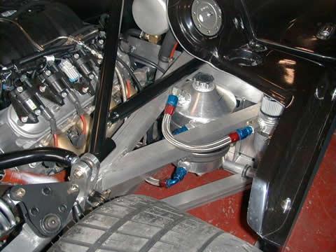

My 2c is a dry sump is also necessary on a high winding motor as you typically would be using the oil as a coolant on the valvetrain. But you need the room for the big oil tank, 2.5 gal and that will be a trick. My ls7 is stock with a dry sump and my brain is rotting from trying to find the room for the damn tank.

Marc,
Do you have the same space on the passenger side as the SLC?
