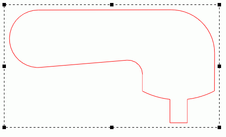

Ok, not sure what happened to Richard, but I have the fobs cad all done as per the original (as close as I can do it). The local water jetter is quoting about 2.75 for each plus ship for Qth 100. So figure about $3 per fob.
I will hit this up my self if some interest still exist, otherwise I'll just make a few by hand... well a plasma cutter and a grinder ;)
I anyone is interested send me a message either here or by PM and as long as a few folks have interest I'll do the order asap. (Bob you are still on for a couple of sets as discussed).
The last question is thickness of the material (4130 sheet). They have EITHER 0.063" or 0.080 (+/- 0.009"). This is really the only question other then do you want one. I am more inclined to go with the 0.080" and do a bit of grinding if needed but the 0.063 would be fine if strong enough to resist bending.
As soon as I get some feedback I'll let you know what's up.
Sandy

Yes, that is my preferred size as well (14g), but the place stocks the 0.063 and the 0.080 material. I can get the material shipped if it is important to get that size, but as I recall the slots for the 2 common fastners sizes (5/6) are either 0.062 or 0.081 from dscif's site. I can't find the old DZUS brand specs for the (EHF6) but that's what I know. Bob is it a problem for you if they are .080"?

My experience with material thickness is that it's never much above the minimum spec. A "nominal" .080" will come in right around .075"
