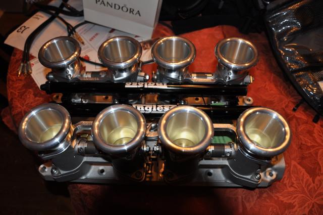

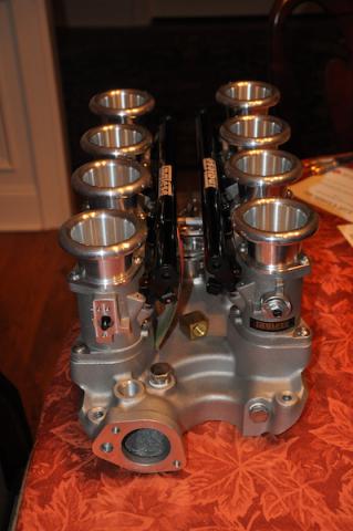

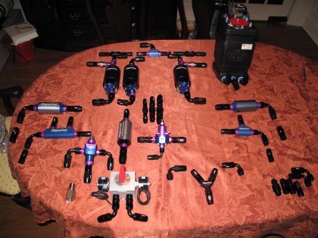

A couple of pics of the Inglese EFI solution. And what is on my dining room table waiting for a motor from a fuel system standpoint.
I went with a "surge tank" as opposed to a swirl pot.
