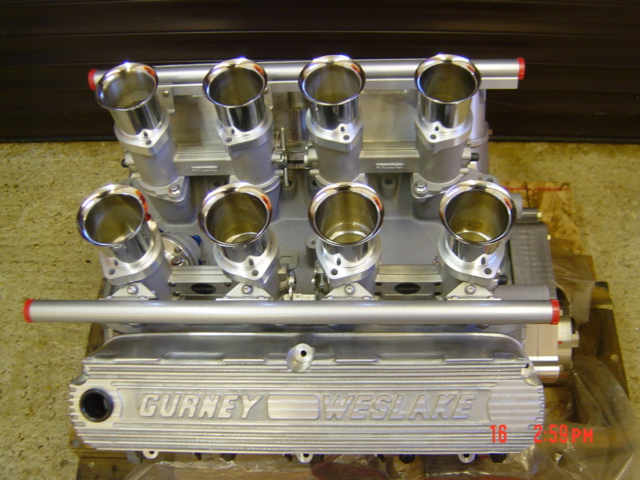

Here's a picture of the manifold for you.
I have not decided which injectors to go with but they will be Lucas specifcation and geometry as they have to fit this agglomoration of different parts, but probably Kinsler as I like the people there.
I built this thing to give me the impression of the old Weber set up without the hitches.
Jenvey throttle bodies
Kinsler fuel rails
Weber Horns
Plus all my workshop sticking plasters to keep it together.

Looking good there Jim! /ubbthreads/images/graemlins/smile.gif
Which Motec system are going to use? and what size Jenvey's are you running? /ubbthreads/images/graemlins/smile.gif

JimmyMac
Paul,
Those Jenveys are 48mm.
The horns are 52mm so there is a nice little ledge inside to fit tapered cartridge filters which I have also made up.
As to the Motech, I open to suggestions and will ask Mark to set it up.
