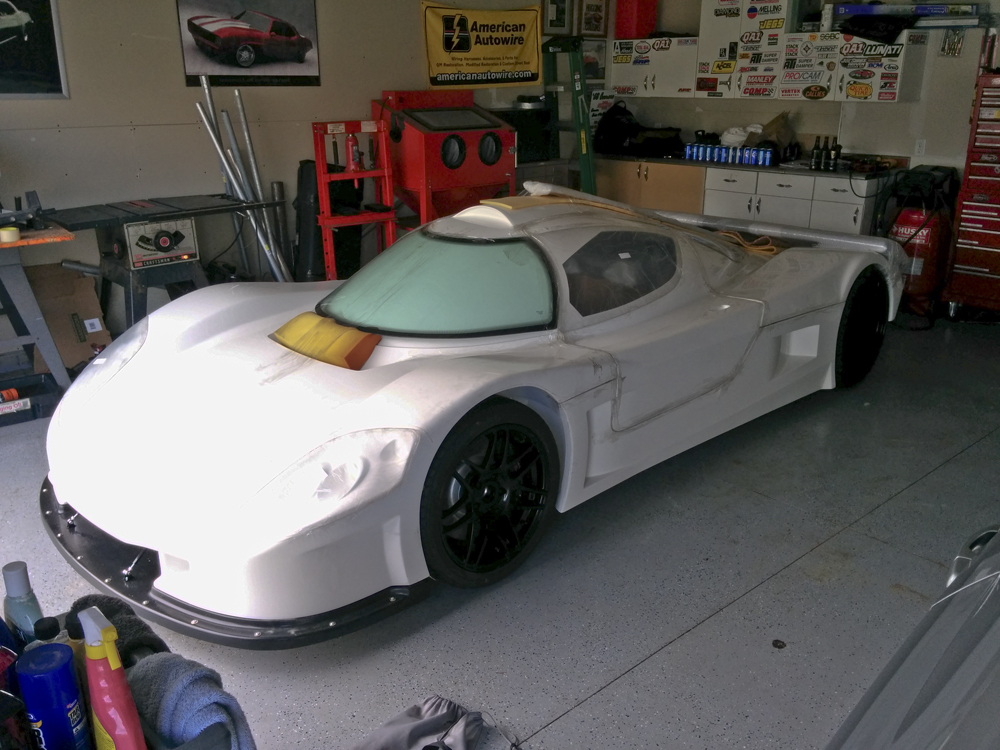

I'm super pumped to have the car here. It certainly brought a lot of people out of the neighborhood asking all sorts of questions and taking pics. It does draw a crowd!

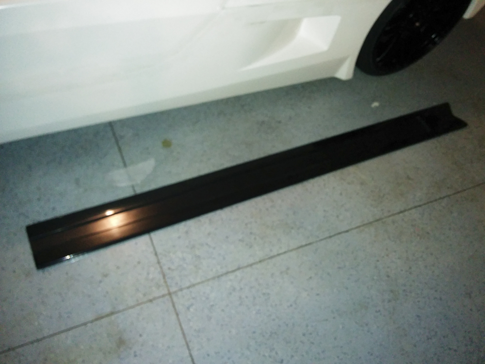

Soooo.... I honestly have no clue... is what I have the 'race splitter'? It's hard to tell from the pics online of the other cars. Also, this long black fiberglass piece... I assume it's the side skirts that need to be cut in half? Yes?

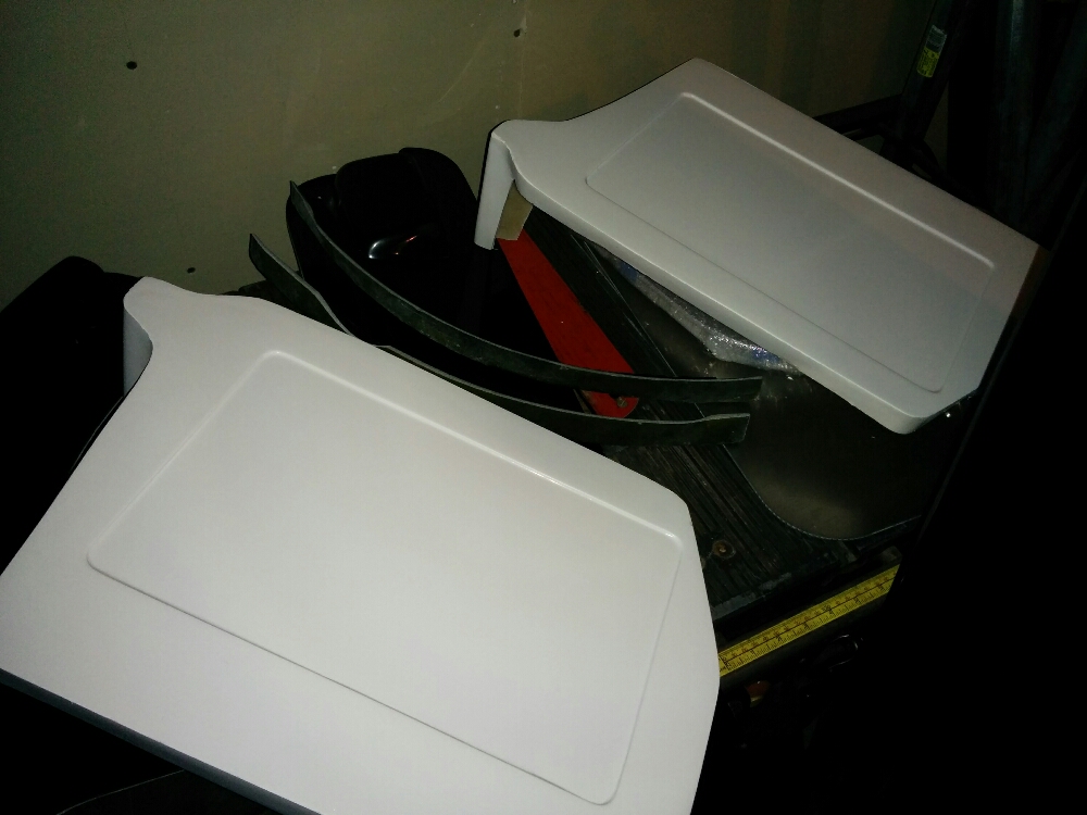

Also... Haven't figured out exactly what these pieces are for. Does anyone have a pic of the head liner?
I'm not sure I got one. Need to make sure before I bug RCR :)
Those panels go behind the rear tires as a tail light close out. You will have to cut out an access panel in them and make a panel to cover the hole.

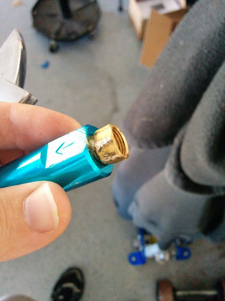

Never underestimate the amount of stupidity I have because this happened.
Ugh.. the one end is epoxied in and now it's smashed all to hell from me trying to get it off. Any suggestions would be nice. Tried heating up the epoxy with no luck.
