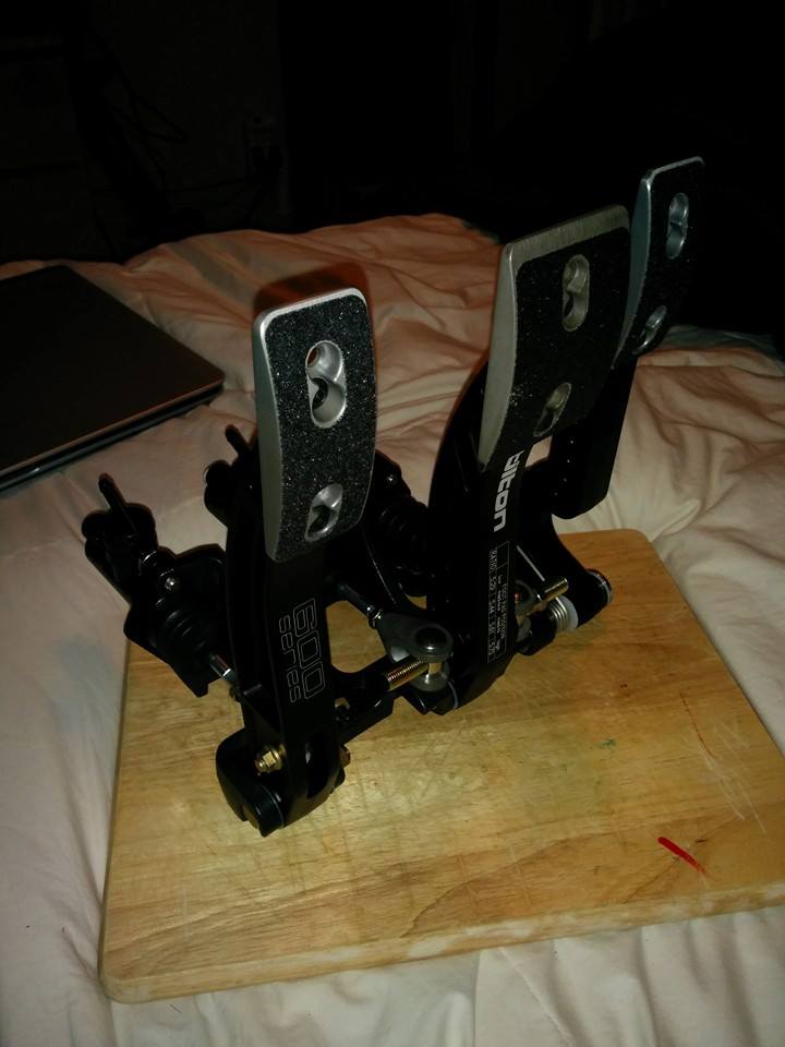

I had to have a 'win' last night so I put together the pedals and master cylinders according to Allan's description of the 3/4 to the front and clutch and the 7/8th MC to the rear brakes. Cut the rods down to a comfortable position for each pedal, assuming I'll be blip-shifting, hence the brake pedal higher than the gas pedal.
