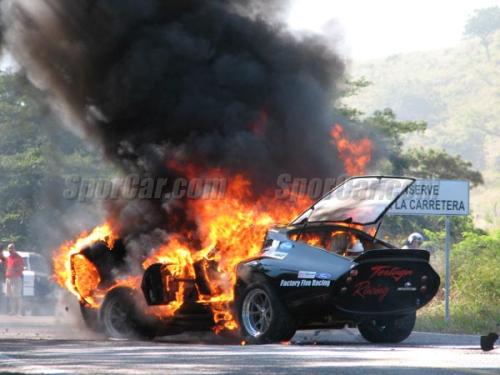

The guy who bought my last car sent me this picture last night..... it kinda got me thinkin....
So, wanted to throw some Q's out to the group.

(Fortunately this wasn't his car, but got him thinking too.)

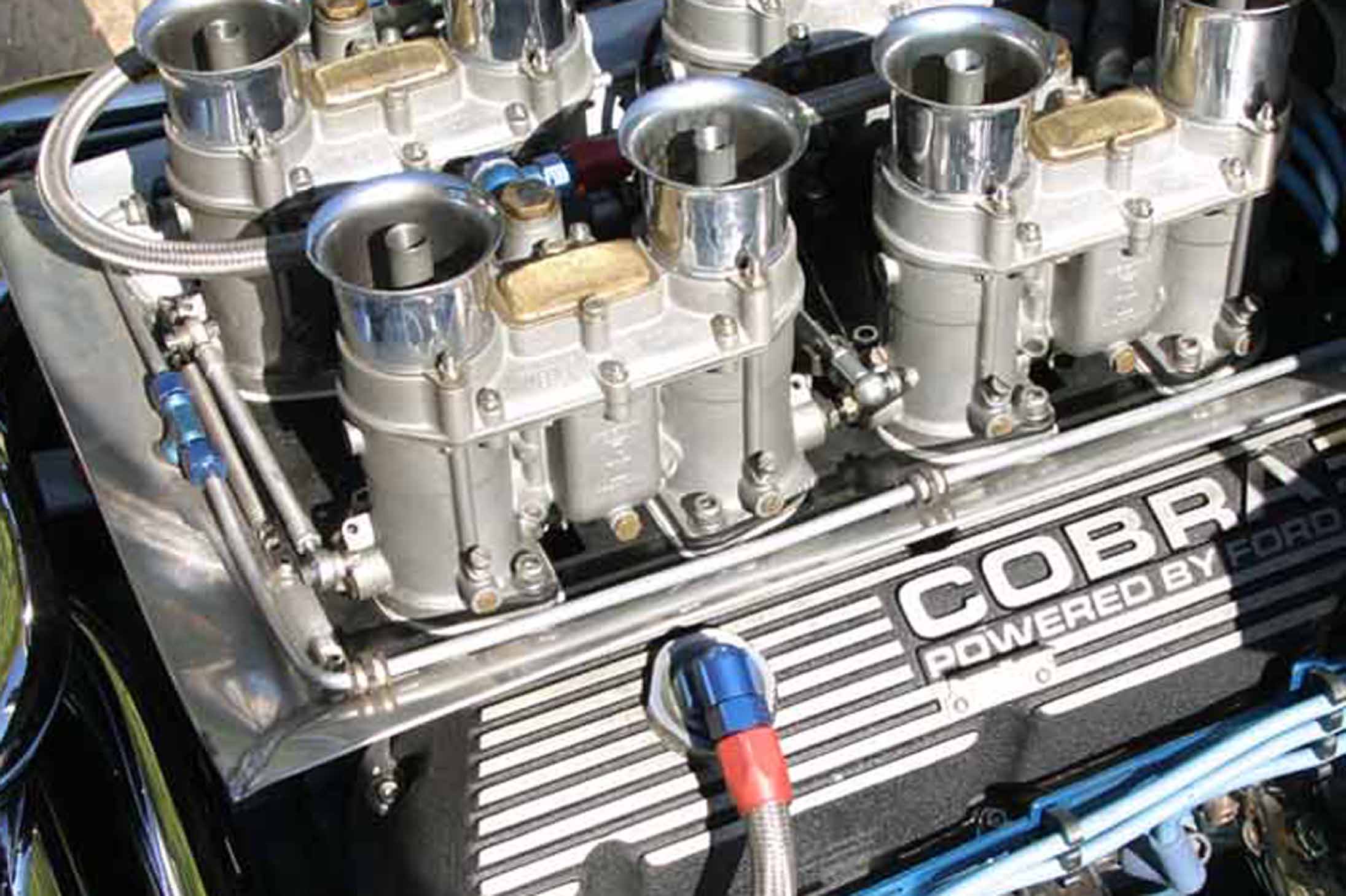

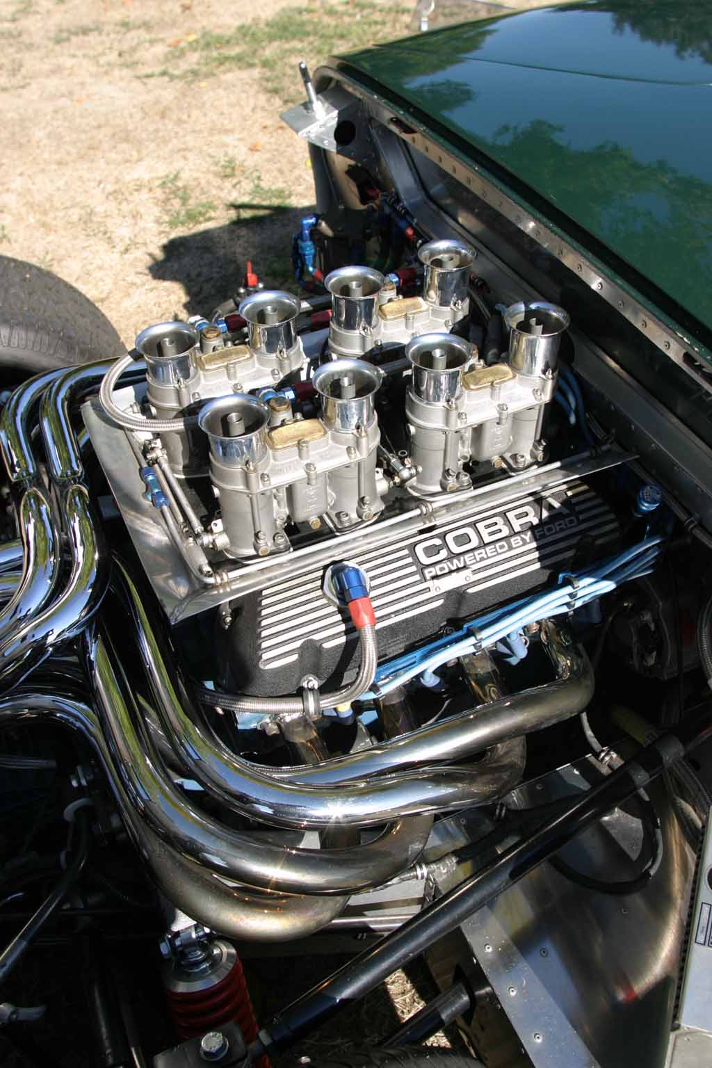

I have 5kg halon for the engine bay and 2.5kg for the cabin. The engine bay nozzles are in fact a long aluminium tube centally arranged around the Webers with holes drilled and the ends of the tube stopped up with weld. On the picture below you can see this arrangement just behind the rearmost Webers with a Blue coloured Earls fitting leading to it and a braided hose on the other side. Both squibs currently fire togeteher though I may seperate them to operate independantly. Additionally, I have a dry powder in the door pocket. Pete - as yet there is still nothing to match HALON (bromodifluoromethane). What suprises me is that nobody has thought about a fire wire detection system.

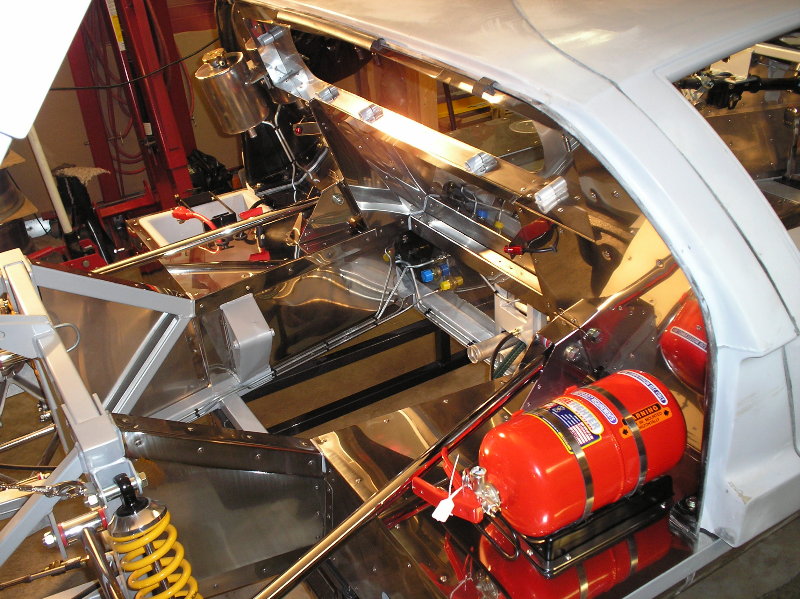

The SPA 4 ltr. foam units are available at a good price from bimmerworld
It is the same unit that RF supplies as an option. I have installed one in my kit in progress and it was easy to work with.Includes bracket, bottle, lines, and six nozzles, and two pull handles. They also have the electrically fired models too. Dan
