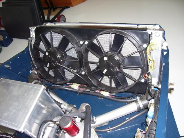

Hi Trevor
As per your diagram the fans should sit on the shroud not on the core so that the air flow from all parts of the radiator can be drawn and not just the area in front of the fans.
Not only does the shroud give you something to mount the fans onto but it also forces airflow through all the core and through the fans.

Trev, I've seen many fans mounted in the manner your doing and it certainly works so it could come down to personal preference. I'm in the camp with Dimi and if room allows why not elevate the fan away from the radiator, as Ben's 3D drawing shows, thereby taking advantage of pulling (you are using "pullers"?)from the total surface area of the core, not just directly in front of the fans?

Thanks guys, that actually makes things easier by mounting the fans onto the shroud. I wasn't sure which way would be more effective but once again the community comes to the rescue. Does this look better?

I like that Trevor.. Much like the way I did my own.

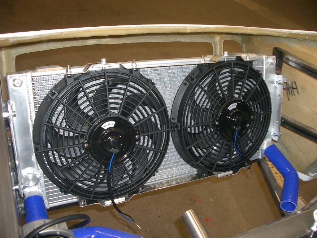

I have just done exactly this to my Lotus Esprit. The factory shroud was cracked, broken and rusty. I mounted some 'L' brackets to the radiator frame and, well you can see the rest. It originally had 3 fans but had been running on 2 for years, so decided to replace the old Ford Escort fitted ones with the 2 you see in the picture.

Looks really nice Bruce. I like the idea of fitting L shape rails to the inside of the Radiator, how did you fit them? Looks like you have rivetted them into place
Trev - I did rivit them on. The "L" brackets are aluminium 3mm by 30x30. But ...
I cut one side of the aluminium so it would fit nicely against the frame, so its like about 30 x 25 or so now. The fans were, as you probably guessed, a bit shorter than the size of the core, so I had to overhang the L bracket into the core area, but its only like around 7mm or so, so wont affect air flow. The fans sit about 3mm off the core and narrow strip of 'door sealing' foam was placed around the circumference of the fan housing between the fan and core so the blades wont suck air from the sides. The foam is about 6mm wide and sticky on one side - found at the local hardware store. The radiator is actually brass (bless Lotus cotton socks!) and the frame is steel. Had no problems with cooling with only the two fans.
