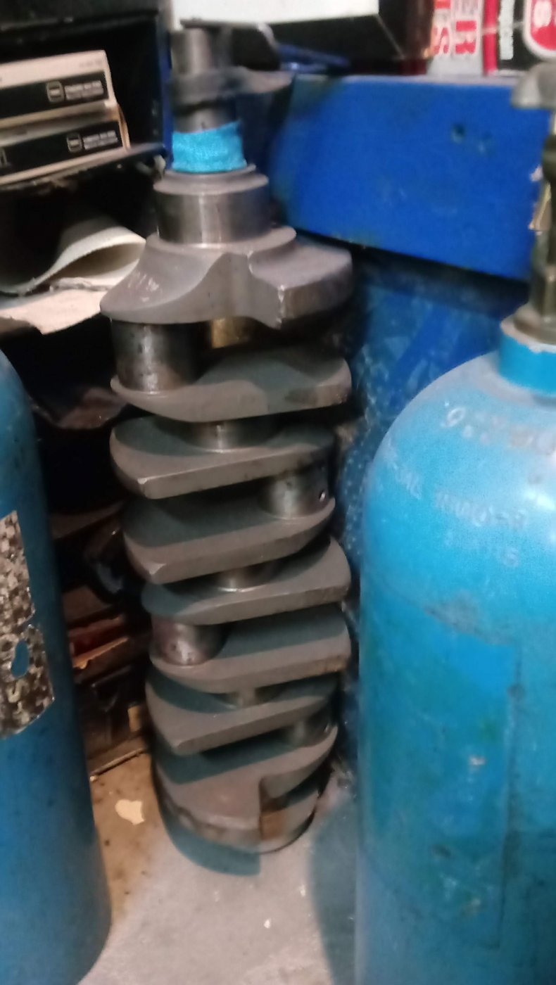

I have a flat plane °180 351C xe....080 bore
I cant find more info on the stuff i got..also Gapp-Roush hiports..

Ive got a flatplane 180 ..351c

XE 351C .080 bore.venolia slugs..6" crower sbc journal..Flatplane 180...with matching 680 billit roller..looking for info if i got a nascar..or pro stock engine..or gt40 erra..?
I noticed your crankshaft follows the layout of the 'NEW' flat plane crank fitted to latest Mustang.. eg throws are placed one up, one down along the crank, if that is the case the cam lobe layout will be totally different to a std 351c cam.. You mention the 'Gapp-Roush' connection, that was a long time ago when Wayne Gapp & Jack Roush were a team and into Drag Racing/Pro Stock. I doubt very much that it would be Nascar and even more so from a GT40 . @ 4.080" bore it could be one of the siamese cast blocks, but since its more likely a Pro-Stock setup it could be a 'filled block ' to support the cyl walls.... have a look for support studs in valley etc.
If this is what you have it wont really be suitable or any endurance type racing or road use. However thanks to time & progress there are plenty of suitable aftermarket blocks now available that you could use to do so.
I had a stock crank turned down & radiest to accomodate the 6" chevy journal...w/ lunnati 700 lift.roller..14.1 compress...and a 175 hp nitrous systm....i figure im pushing the block a lil over its capacity..
And jacmac thank you for that info.
