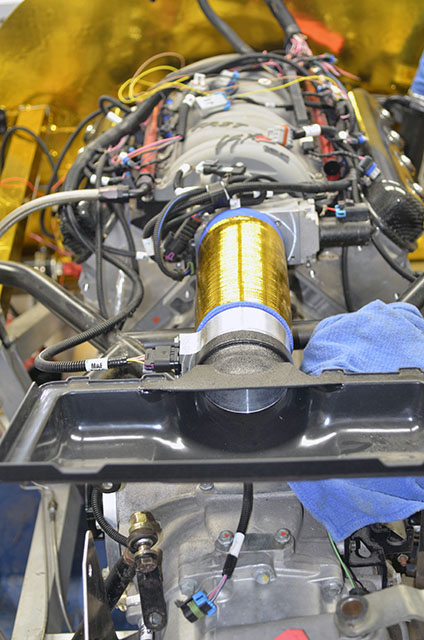

I used a custom stainless 90 bend that was machined to fit into the WP, and with a welded lip at the hose end.
Fits perfectly, and has a smooth bore instead of a sharp bend which induces turbulence.
You can see it in this picture, pointing up at a 45.
But there are many possible solutions, as looking at other builds will show.

Also completed the Reflect-A-Gold. Special thanks to YOS for the input.

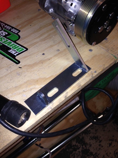

The rear of the compressor is not supported and adjustement is limited. So here is my second question: I have seen a mounting bracket and adjustable arm that supports the front and rear portion of the compressor. Does that come with the kit if you ordered the front dress?
whoops....Ken beat me to it....
As all of these brackets are laser cut and plated there is no way it was 'CUT" at the shop but it certainly looks like its been hacked....it actually looks like the bracket has been cut in half and the rear leg used to bolt to the tab....certainly not as supplied by us.
It is the latest from Penski. Dual non adjustable.
I did not get an upper bracket from RCR. That is why I was concerned about the bracket that was used. This upper bracket was not from RCR. Does RCR supply the upper bracket and the adjustable arm???? That was exactly what I was wondering as I purchased the front dress option.
That bracket certainly looks like the we supplied you but its been cut in half
I will have Dean forward you the picture from your shipping list showing the AC mounting bracket that we shipped to you.
The AC brackets are supplied regardless of the front dress purchase...
TY. I have hunted high and low without any luck for the bracket and adjustable arm. That upper bracket was fabled by a gentleman helping me with the build- not from RCR. I will touch base with Dean tomorrow. Thanks again...
Michael, the gold foil looks great! I'll be interested to hear if you experience any tearing issues when you drill and tap.

You would not want to drill into the foil without removing the area where you are going to drill. No doubt the nylon fibers would be a problem. I will use the trusty scalpel before any drilling.

That was the RCR bracket that was cut. My bad. Vicki is sending another one. I think I will use a spacer to keep it flush with the block. I also have a 90 degree elbow with thermostat coming for the water pump just to make the connection a little easier.

The picture of the compressor bracket in Michael's post above has a pivot point on the bracket near the mount. The one I received does not and I cannot figure out how to mount it. I see Dean put a block to clear the engine block bump out but the arm is still facing in the wrong direction and I can't see how you can pivot the compression to tighten the belt without a swivel. What am I missing?

The Gold foil will decrease surface temperature of the material to which it is applied, saving your skin somewhat when touched, decreasing intake air temp if applied to the intake, decreasing heat transfer to the cabin, etc.
