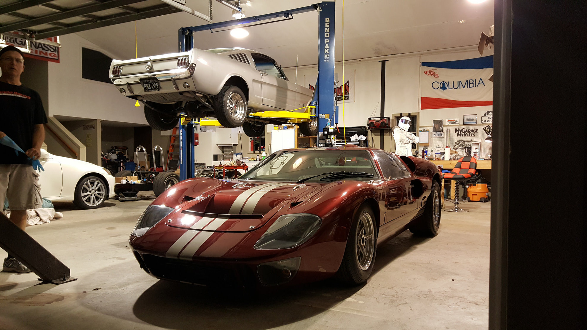

Tim, how do you drive your GT40 over the arms? I was thinking about a two poster but my SLC is so low it might not clear the arms to load it. Do they swing out of the way? I would need a minimum of 3 inch clearance.
I have a Bendpak HD9 as well in a space so tight that the floor pads touch the wall baseboards fore and aft. It is a great piece. No issues in years of ownership.
Howard Jones
Thanks Tim, I will need to really look at my SLC to see if I can use that even with the low profile arms. I sent them a email for more info, thanks again Tim, Howard
I have a All-Car-Park-8 four post 8000lb. lift in my home garage. This became a necessity due to the fact I had four cars and the community I moved to only had three car garages max. The ceiling is just over nine feet high. The garage door tracks and the opener had to changed to accommodate the lift. I have the C5 Corvette residing on the bottom and my CAV 40 residing on the top. Unless you have a really high ceiling, I strongly recommend that the shortest vehicle park on the top. If I reverse the order, it would be impossible to get into the 40. Those who own a 40 understand the entry issue. Note the aircraft style doors on the GT. All 4 cars are in the garage, but it's crowded.
