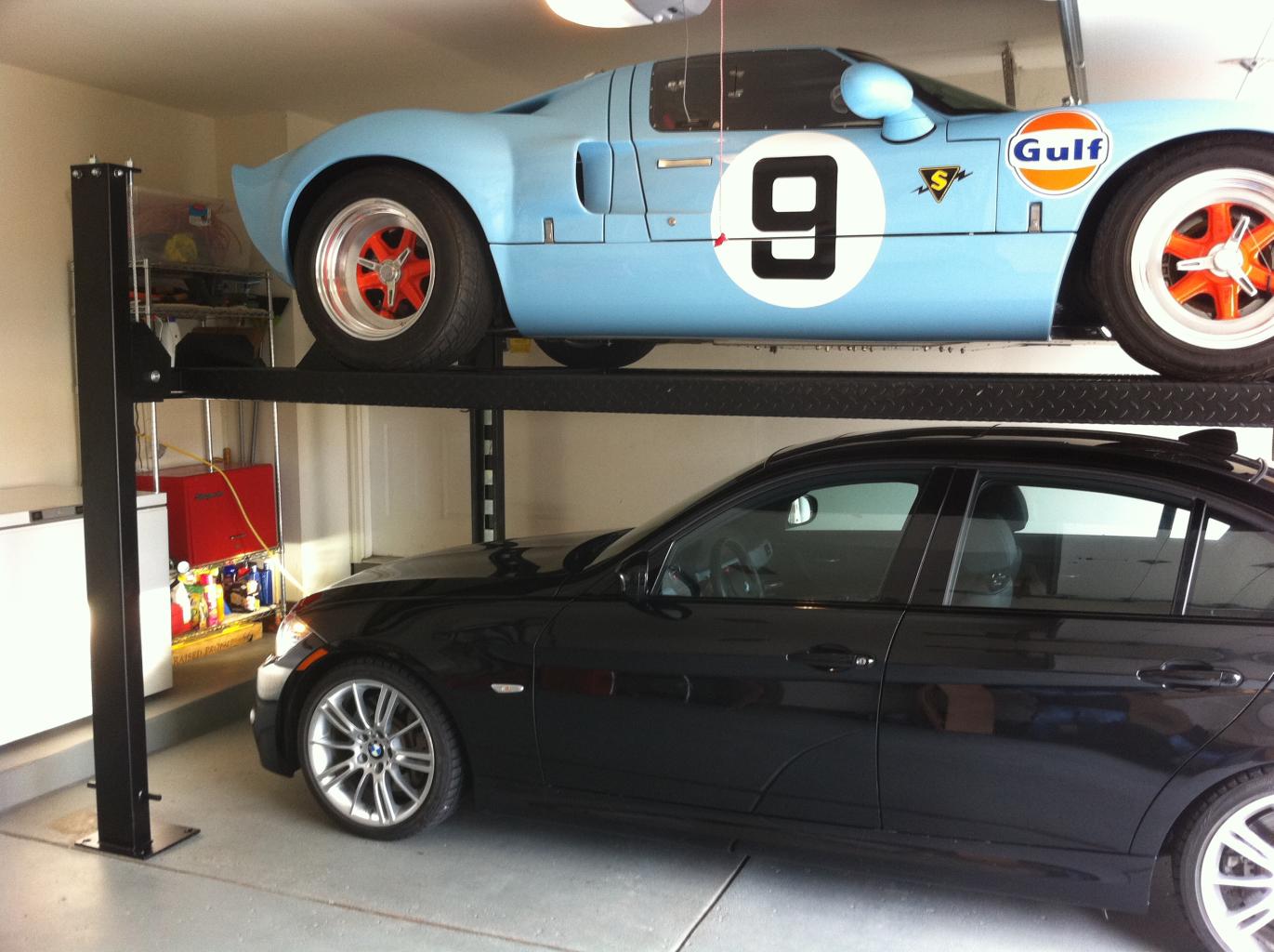

Had a 4 post lift from Aresco (Lift & equipment dealer) out of Pontiac, MI intalled just last week. Goes against the grain of many of the posts here, but is a Chinese made lift. Only the first week but very pleased with this 4 poster which was the right solution for me. Used primarily for parking but can already advise it will certainly be great for servicing & working on the GT40 & other vehicles. Have adequate room for the daily driver underneath and my wife's F-150 supercrew beside it. Only wish I had made the leap sooner.

it looks really good, a nice fit, can i ask the make and model of the lift, also out of interest the height from floor to ceiling? I have a double garage but with shelves on one side, bench on the other, it's a real tight squeeze to get two cars side by side. I have 116" floor to ceiling.
Oh, by the way, I hope you have a big red button on the ceiling above the '40, just in case the lift forgets to stop!

Keith, I have a model name from Aresco which is EPF8 (8000lb.), paper work also shows the maker's item/model number as FP8K-DS. No brand detail though. In doing my research early on, many dealers referred to a company called Atlas Auto Equipment Distributors Worldwide (Likely the distributor to the dealers). Not a perfect answer to your question but what I have. Price was just under $2k USD ex-works. My ceiling height is 115 inches and clearance to garage door is 98 inches. In my personal set up , I have 2 inches of clearance for the car below, and for the GT40 above 7-8 inches of clearance to the garage door & 13 inches to ceiling respectively. Not as scary as it might appear as I can go up a full locking position before contact becomes an issue. Basic formula I was given was: Height of the car below + Height of the car above + 6 inches (4 inches for the lift platform + 2 inches to raise/lower into locking position). I then added 2 inches to the car below and made sure clearance above was ok. Everyone's scenario will be a bit different. Attached another photo for reference (This was the first time to raise the car and posts self-leveled as designed after 3 or 4 lift cycles). Hope this helps a little.
