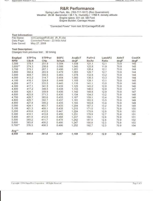

Chuck,
Attached is one of my dyno sheets which showed my max fuel consumption at roughly 192# per hour. At 6# per gallon, that works out to 32 GPH.
The Facet Gerotor pumps are great pumps, although rather scarce...
BTW, the engine is a 331 with Weber 48 IDAs and produces 414HP / 430TQ

Chuck,
Interesting Randy. Looks like that Facet pump may be sufficient, although marginally so.
Our engine set ups are virtually identical.
I have some ideas I am going to explore before I replace the pumps, but glad to see that the Facet is a potential option.
