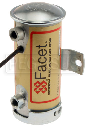

Facet´s are pretty common and popular in UK, never understood why, imho they don´t belong in a car like hours with this fuel demand. THey may be good in some 4 banger lotus and ford escorts are cars like that, but as soon you face serious fuel demands they are just not up to the job.
I would always try to dimension teh volume rate of a fuel pump at least 20% higher than the max fuel demand of your engine
