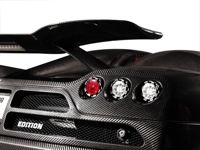

I agree it can be...bit only if the tooling is designed to be carbon compatible...
The carbon wing we have is really nice but show guys dont only want shiny...they want perfectly laid weave with superb symmetry...such as this $1,400,000 Koenigsegg
