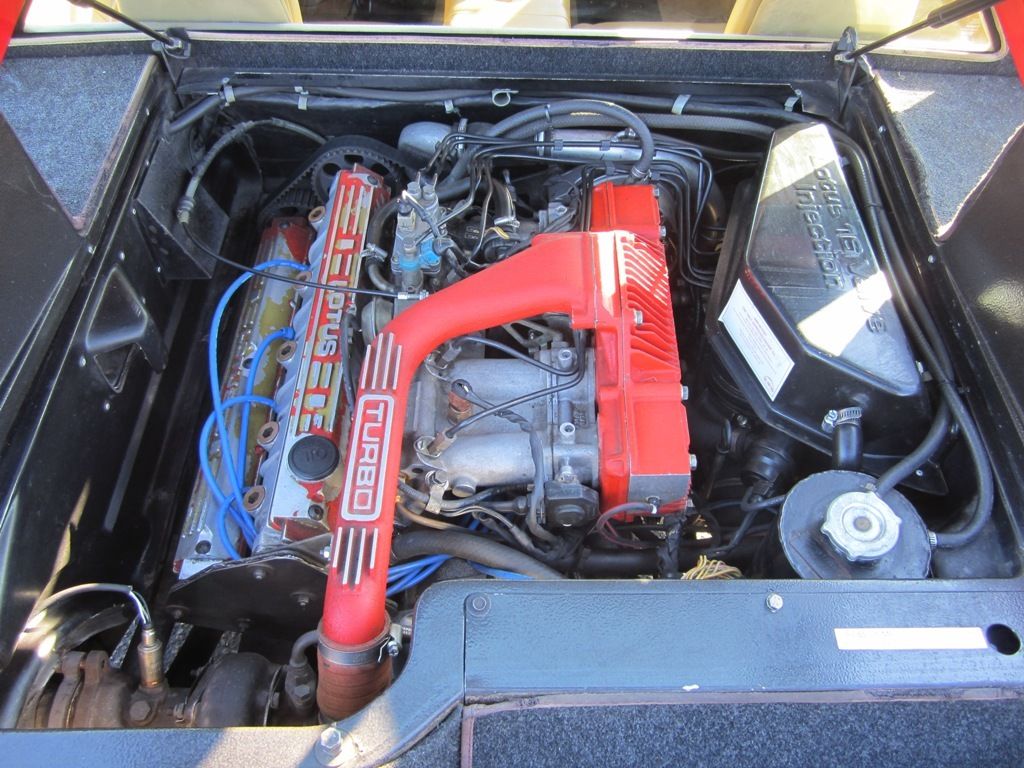

I was driving my 1988 Lotus Esprit this past weekend and the transaxle pretty much gave up the ghost. The transaxle is a Citroen C35 transaxle....normally goes in a Citroen delivery van. Not a good transaxle for anything that will do over 60mph on the freeway.
I was contemplating engineering an Audi transaxle adapter plate but then got to thinking....why am I sticking with the turbo four banger? And, having to deal with all the trouble of engineering an adapter plate (Audi to Lotus)...
Screw it. I'll put in a SBF with an 016. It looks like there's plenty of room in there for a SBF. Probably would be best to go with injection....although, 4 IDAs sticking up through the engine cover (visible under the rear hatch glass) would raise a few eyebrows.
I'm thinking a basic 331 stroker with good alloy heads and forged internals would do it nicely. I have a stillborn flat crank SBF project on the shelf but that's likely Phase 2 of the project.
I can get an 016 configured with an LSD and strengthening kit for about $1,000 bucks. The 331 should be around $5K, with injection another 2K. My '88 has inboard rear brakes so I'll have to get some later rear uprights with the brake ears...another $1K with all necessary bits....Kennedy kit. So I guess the budget for this is about $10,000.

Related, I was researching weights a bit. As far as I can tell, a 331 with alloy heads and intake and all accessories should be about 425-450lbs. The Lotus engine with accessories looks to be about 225-250lbs, plus perhaps another 40lbs for turbo-related stuff. So am I looking at about an extra 150-175lbs for the SBF when everything is done? Roughly? Sound right?

Cliff - If you are dead set on sticking a V8 in an Esprit I would suggest you do a trial fit with an inexpensive engine first. The Lotus V8 is 3.5L (compact), all aluminum, and designed for the car and its a REALLY tight fit. While it is true there is a history between Lotus and Ford, I don't think a Ford V8 was ever intended to fit in the Esprit chassis.
