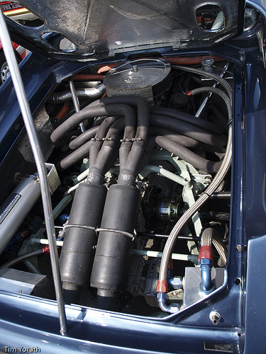

There must be some rednecks also here in Europe... Ford ? (well, at least a V8 with a ford labelled air filter !... and ZF gearbox.)
