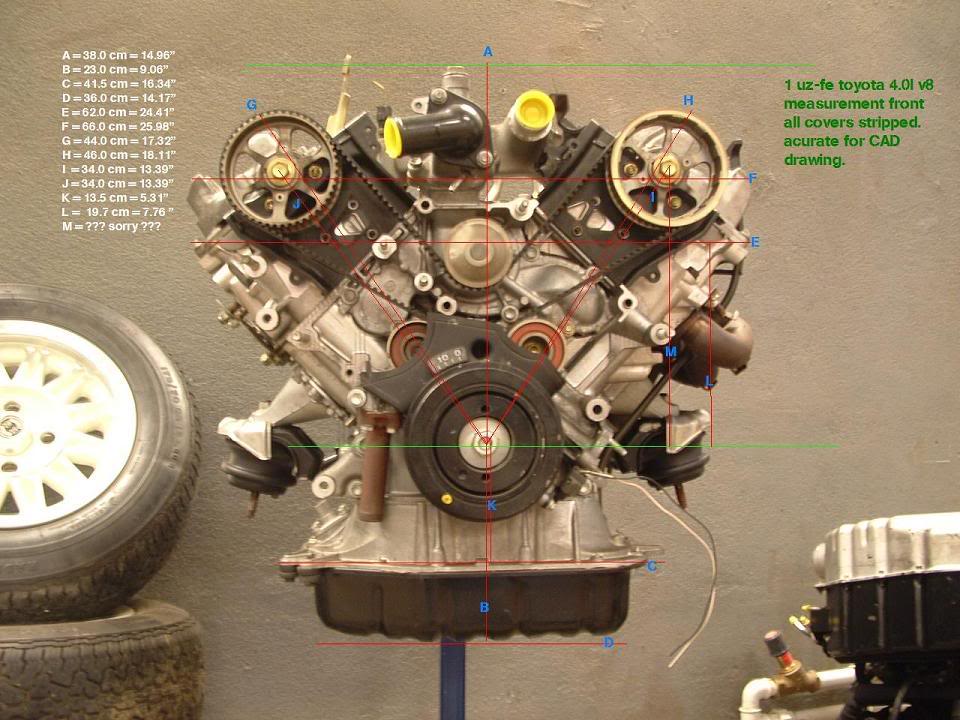

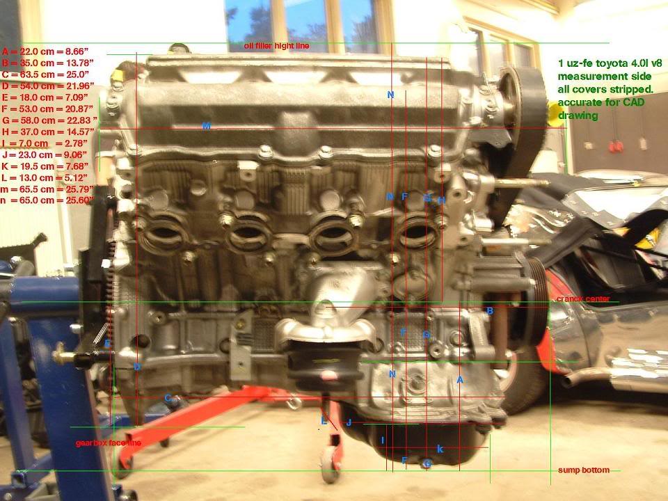

Hey Cliff, Looks like time to break out the tape measure just hang a un1 or 016 behind it and your done
Er hate to rain on your parade but this is what I was saying, the photos do not show the distributors on the front of the cams, or the inlet manifold, or the oil filter.
You've also got problems with Lexus/Toyota not making a manual version so you'll need a custom flywheel.
Still if you want to do it see here for adapter details:
Toyota 1UZ-FE Engine to Audi 012 Transmission (Porsche G86) Adapter Drawings. | 1TG - Design & Build of the One Tonne Guerilla
