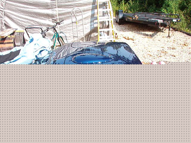

My CAV 40 was ordered with Audi Lemans Blue. Any good paint shop with a computor match system should be able to get the colour right.
Vic

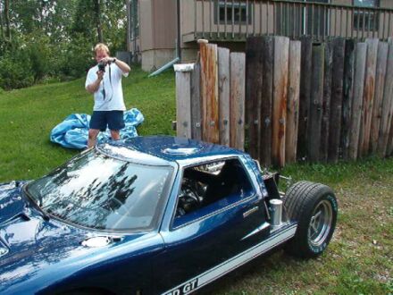

Post another shoot of your Gurney bubble so we can see the whole thing. I still have not decided if I want to put one on my car. I fit o.k. now, but a helmet may require the bubble.
Hi Pat, hreres another view. Sorry about the first shot I don't know what went on there, and sorry about the dude in the pic (Fran Hall), you know what they say about H**** S***, It's everywhere and so is he.
Vic

Correction , had a Senior Moment / Brain Fade. The colour of my CAV is BMW Indy Blue not Audi. I stand corrected.
Vic
