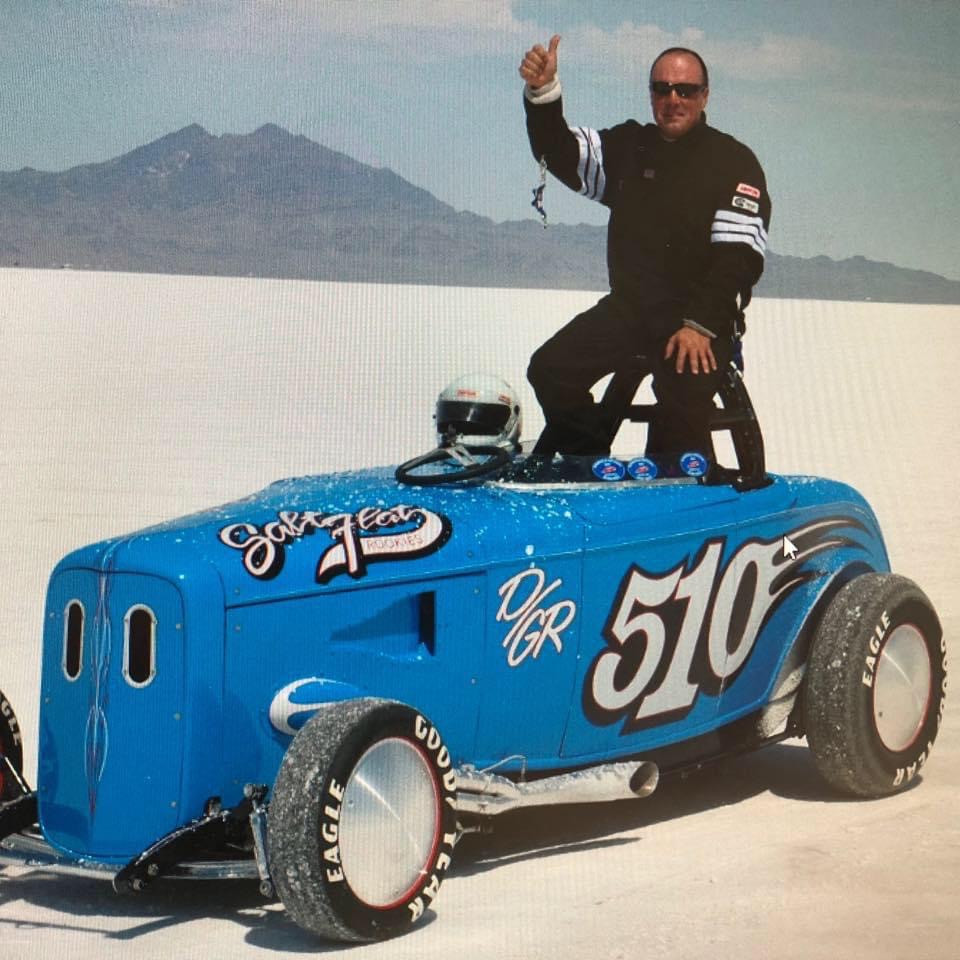

My best friend Kenny and a car that he did a lot of work on - was a Poteet car later I believe...
I wonder if it’s still around...
Neil
Do you know the year that photo was taken? The record in that class, D Gas Roadster is currently:
engine size D name Hot Rod Hoodlums driver D. Jones date 8 /12 219.831 mph
I'll try to find him in the SCTA files.
That was 2005. I would be amazed if the car still had the same engine in it. It was a Cadillac Northstar engine.

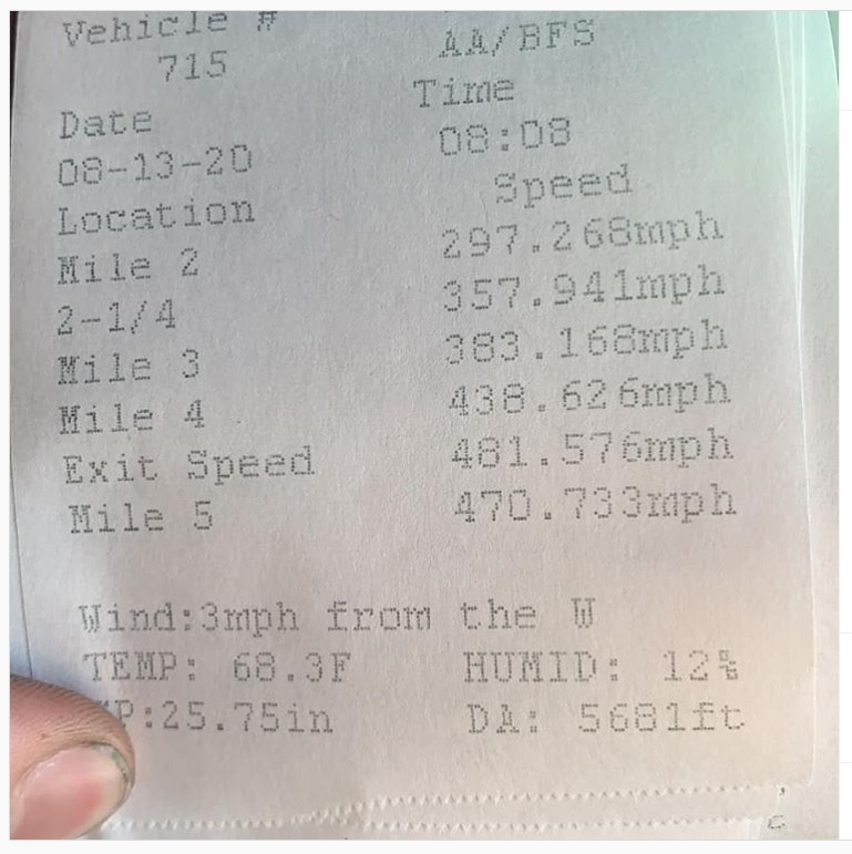

This morning Speed Demon made another run on the long course at Bonneville. 470.733 mph average in mile 5. WOW!

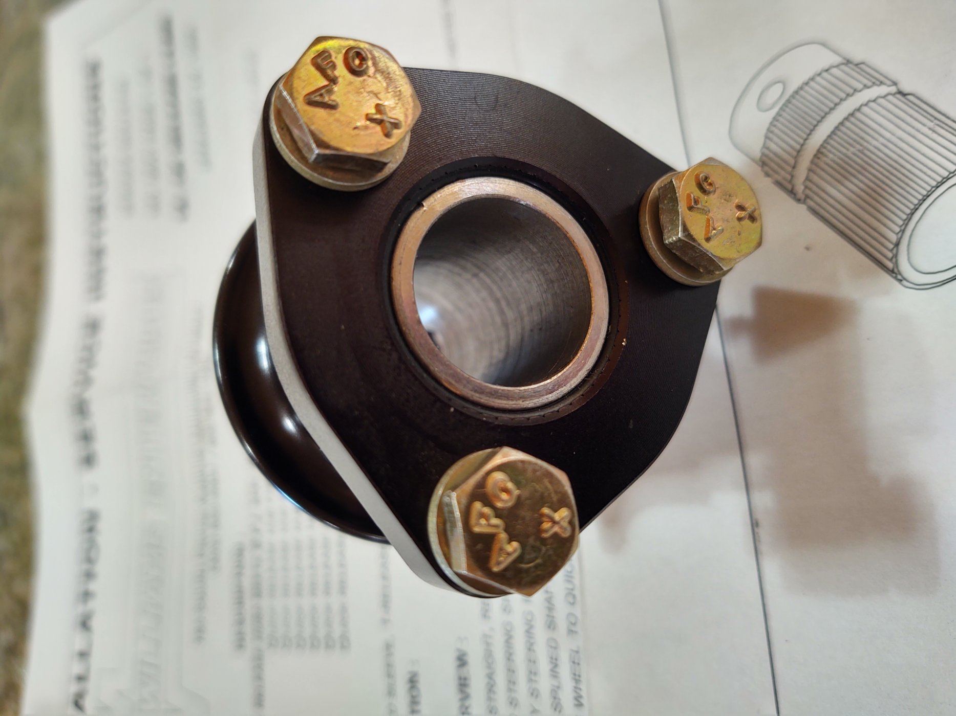

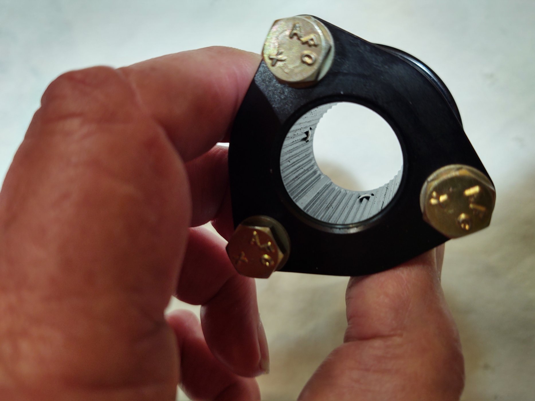

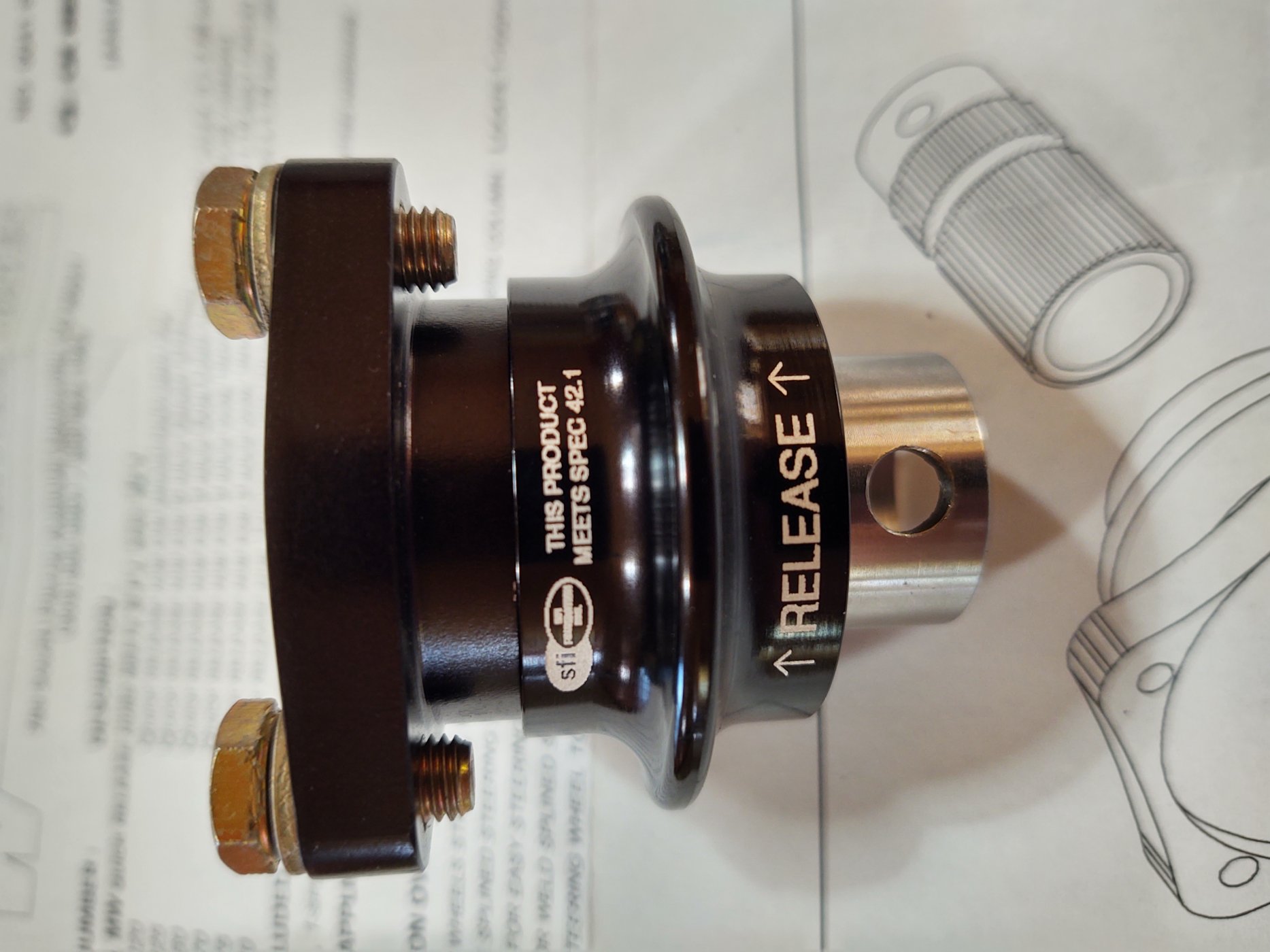

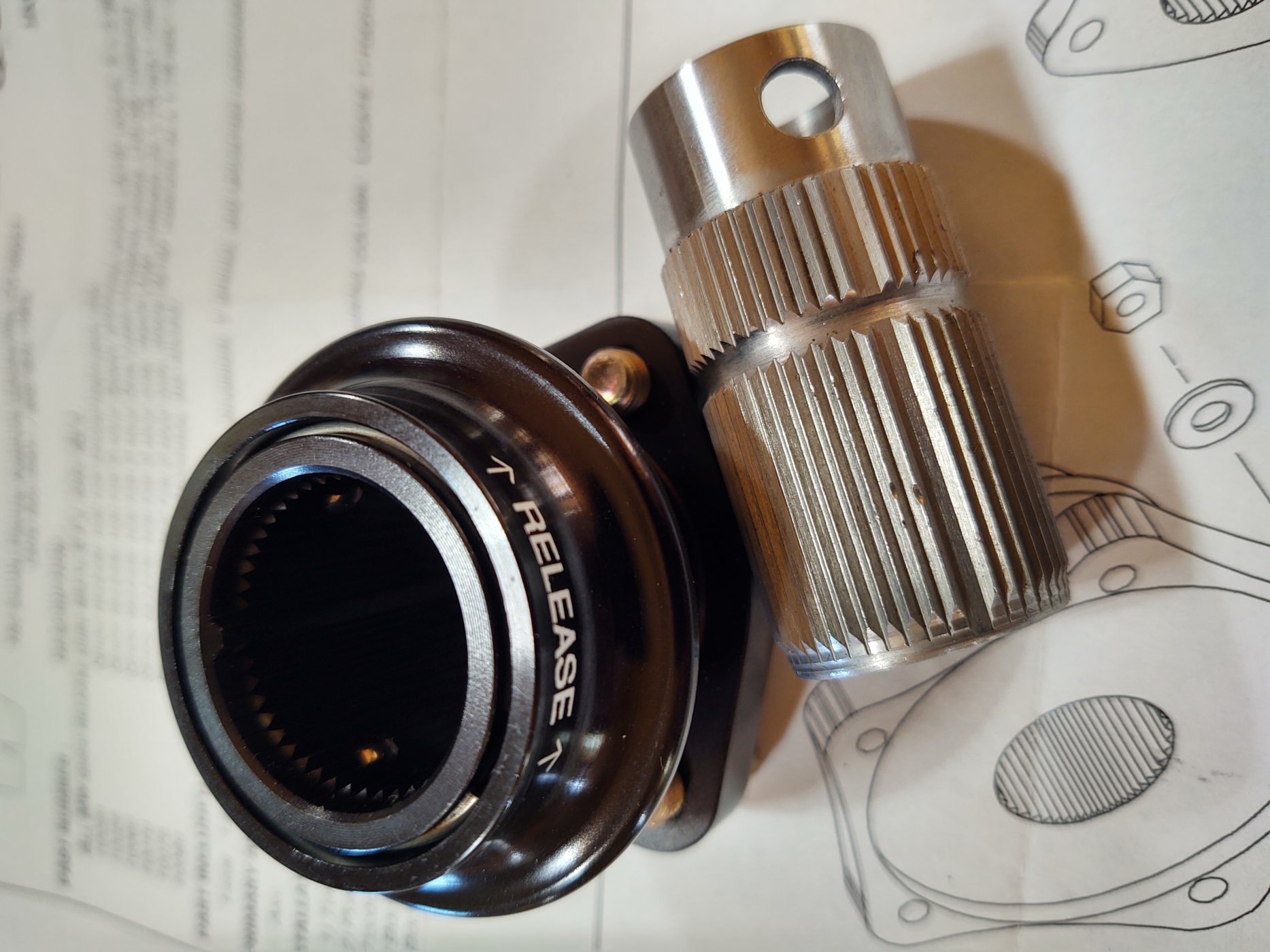

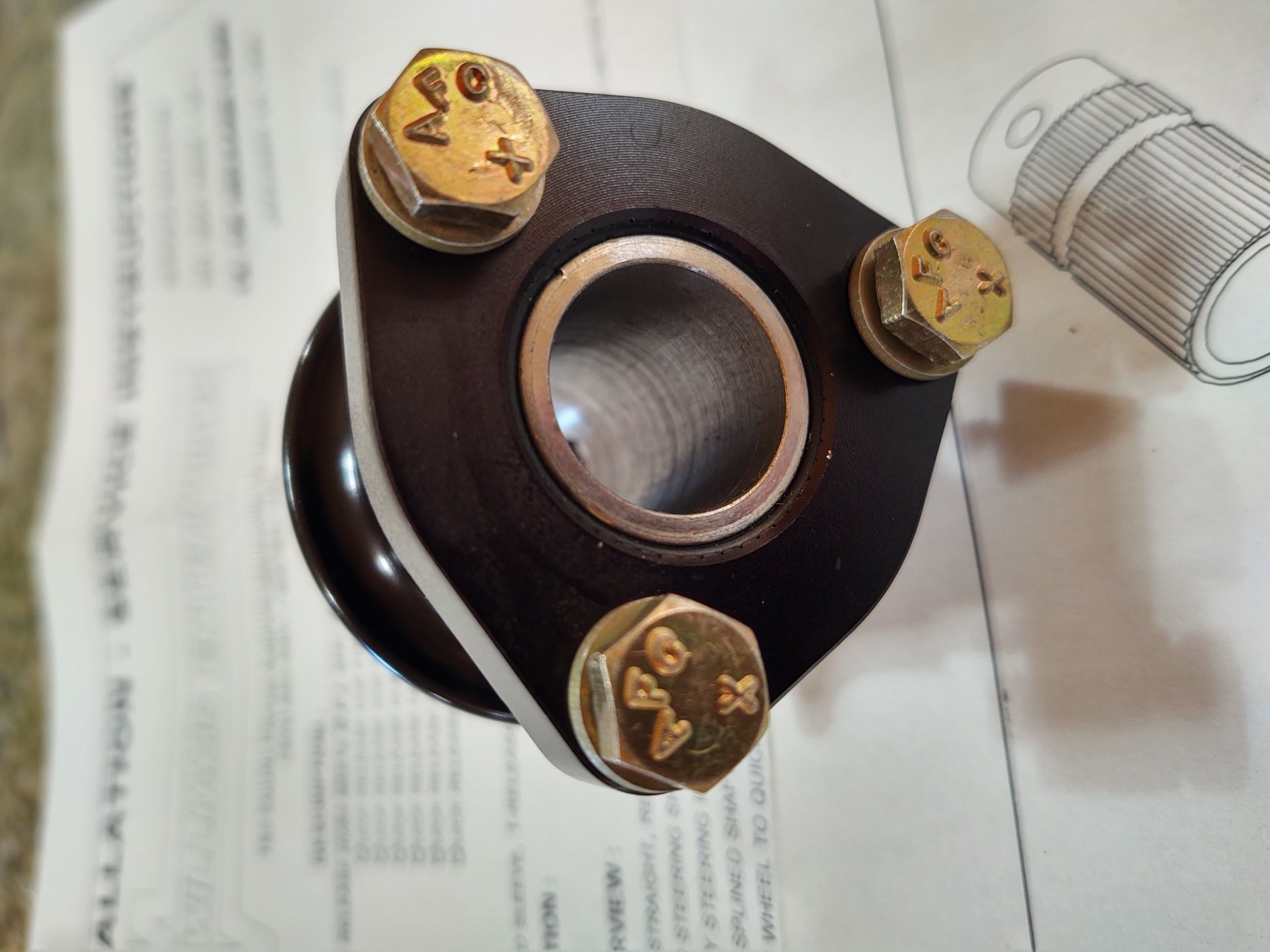

I noticed that my quick-release steering wheel seemed a bit loose on its hub so I decided to replace it. On another car I had used a hex shaped quick-release hub but it had more play than I thought it should have. I drilled and tapped a hole in the aluminum hub for a screw with a knob on the end. I tightened the screw just enough to remove all the play. This was similar to a "gib" screw on a milling machine, etc. This worked but made it more difficult to slide the steering wheel off.
After looking at many quick-release steering wheel hubs, I decided on a splined hub from Mark Williams. The splined shaft slips over 3/4" dia tubing and either bolts in place or is welded. The other piece is internally splined with one tooth missing for indexing. This slides on and off easily but has virtually no play. If you are looking for a nice quick-release steering wheel hub I recommend you look at the ones from Mark Williams.

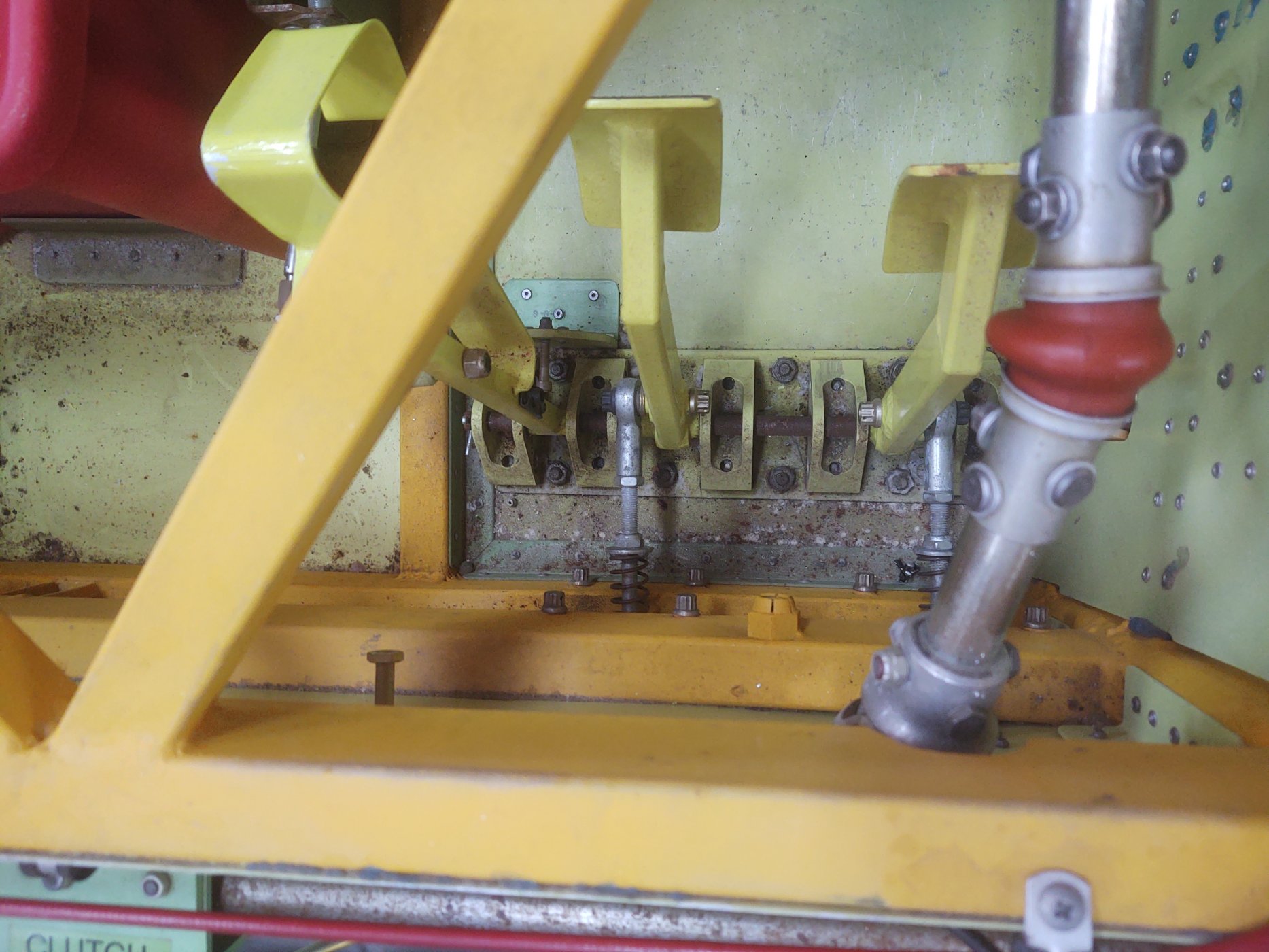

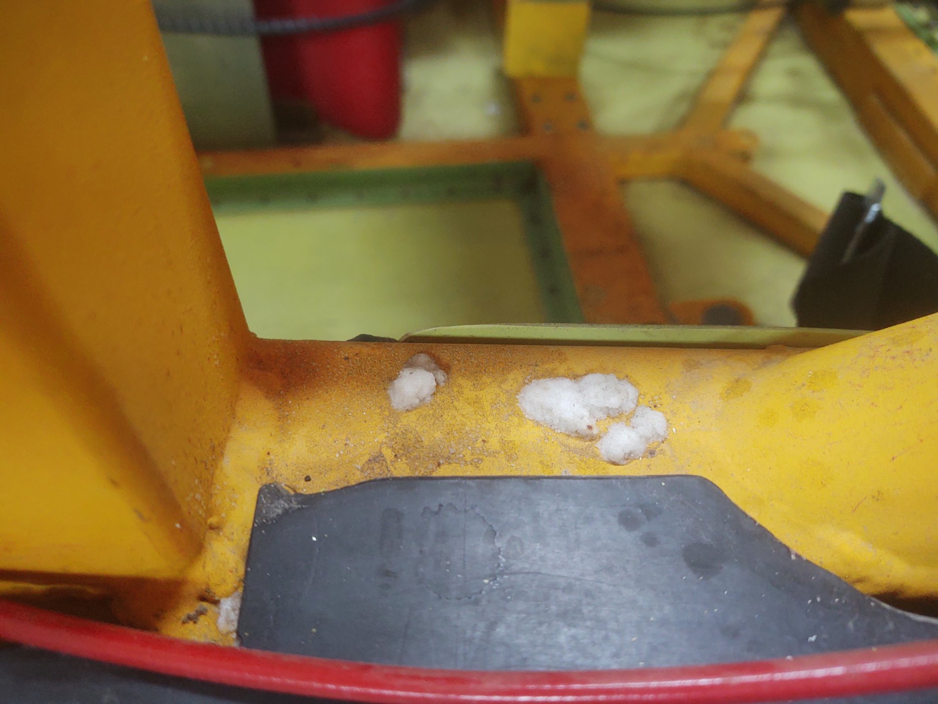

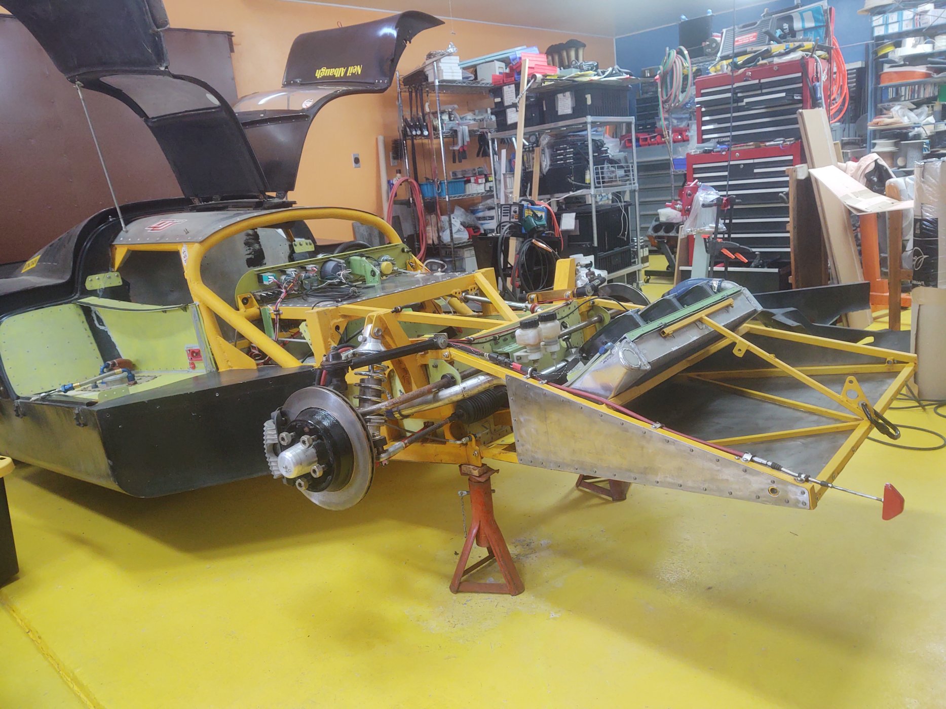

I've been working on my car, getting it ready for Bonneville in September. I decided to take off the front fiberglass bodywork so that I had easier access to a few things under there. Arrrggghhh... dirt and salt everywhere. The salt I can understand but the dirt? I've never been to Elmo. :confused: (slang for El Mirage, a dry lake in California notorious for its dust).
Cleaning everything up is a PITA but it needs to be done. It is a good thing I live here in the dry desert (8% humidity here yesterday) or the salt corrosion would be far worse. It's a good thing I don't drive this on the street. If I got stopped by the police I'd probably be taken away in handcuffs- the salt crystals look just like crack cocaine that I've seen on TV.
If any GT40 owners ever have the urge to try a high speed run on the salt flats in their GT40 etc, my advice is- don't.

While you're in there could you take a good picture of the toe loop on the throttle peddle? That looks like something I might want to copy.
