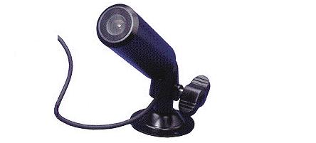

Just to add a quick post on DIY video on the cheap. This was taken with my $125 solid state system recording directly to a 2 gig SD card:
YouTube - VIR ECR1 Goblin's Go Earp/Young
The You Tube Compression really reduces resolution, the native 640x480 is actually nice. It uses a bullet cam with built in mike (needs a foam piece over mic input), $35, and the Neuros MPEG-4 solid state recorder that despite the picture it little bigger than a pack of cigarettes.
Amazon.com: Neuros MPEG-4 Recorder 2 Digital Video Recorder: Cell Phones & Service
That slot in the front is for the SD card which is tiny. $90. About $125 will get the entire setup, you'll need to make a 5V supply to power the Neuros but that can be done with 5V solid state chip supplies for about $1.50 each. I used three in parallel to provide the necessary current draw for the Neuros.

You finally go it going! The video doesn't look all that bad, the compression of yahoo, youTube, etc kills most of any resolution video of any duration. One thing that does look really good is your camera stability. How is it mounted? I have used the I/O port Roll bar camcorder mount for the bullet cams and seems a bit wobbley when you see the video, yours looks really stable. The make one without the vibration dampner for bullet cams which might be a better way to go.
Also how did you trigger the recorder? I think that and the powersupply were the only things that needed to be hacked up a bit to make this a good low cost set up. The audio is a pain to get good, I got some old airline head phone foam and put it over the mic and it helped a huge amount with the wind noise.

Sandy, you'll laugh, but it is mounted to the roll bar using the swivel mount that came with the camera. No high dollar tricks there. It works. The base has holes in it, I bent the based and screwed it directly to the rollbar. Tighened up the ball swivel and it did the trick. Here is a picture of essentially the same camera.
I still have to fix triggering. Right now I have to push two buttons on the remote. The remote is velcroed to the tranny hump, and it stays put. There is a hack though you can do on the remote so that it becomes a one button record, one button stop.
The native resolution I've attached and it is not 640x480 like I thought eariler. The recording was doing 320x200 I think, or close to that. Whatever it is I've shown it here. The max it can do is 640x480, I need to change the settings in the Neuros.
But, it works and the price is right.

I have to get the urethane mount removed. The video from the solid mount is much better. I have a couple of the same mounts that came with the camera, might make some use of them.
