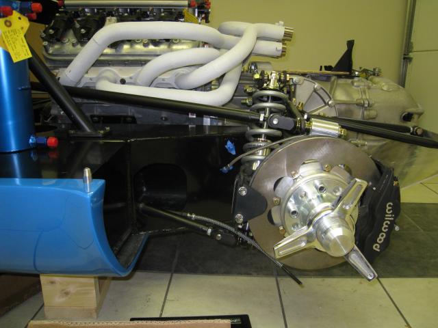

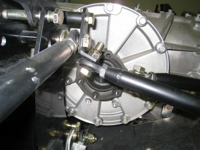

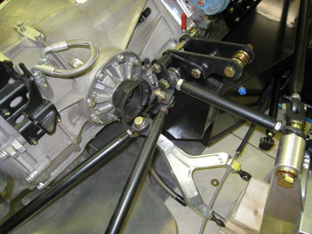

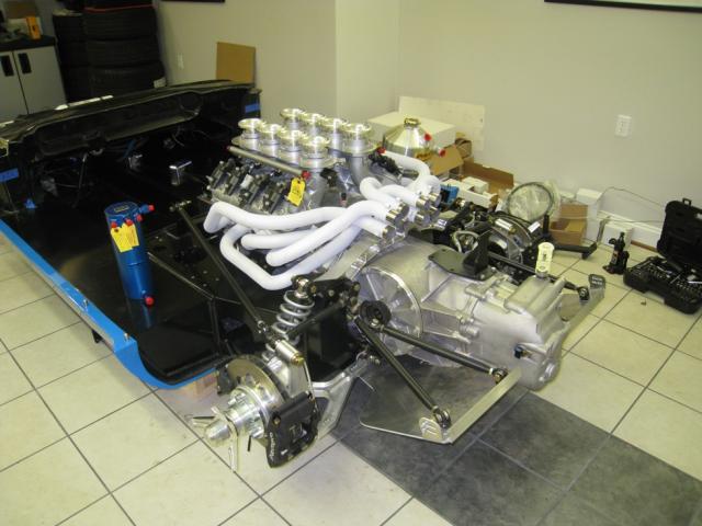

Well, looks like I may need Fran to help me dig out of this one. Now that I am beginning to look at clearances, I can see that the axles are not going to clear the heim joints that support the rear aluminum panel and locate the rear clip. The bracket will need to be redone so that they attach above instead of below the bolts that hold the cross brace in place.

More pictures as I bolt up a few goodies.

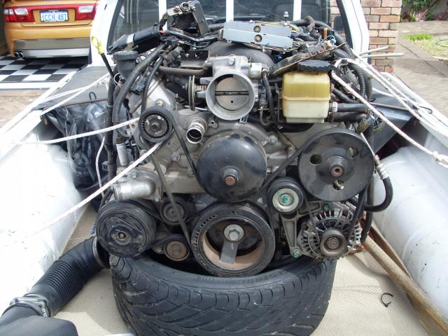

Anyway I love the build ,can i ask you if the LS7 is going to be dry sumped ,and if so would you mind putting up a pic of the pully set up with the pump.Im after a set up that dosnt include the power steering pully.And if the pump replaces the PS pully.
Suggestions!!!

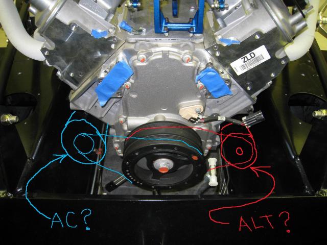

The AC compressor will JUST fit on the passenger side. It will not fit on the driver's side.
I need an alternator or a really really big battery. Any suggestions here? I think Dean has a really small one (well, that's what I heard). It's going to have to be tiny to wedge in there.
John the ls1 and 2 has the alt and Compressor the way you want it on our Commador in Aus ,I think its the same as the G8 in the US.On my GT40 i had to change the fitting on the compressor to fit the pipes on , A minor problem.
Im also fitting a Ls2 with a dry sump the advantage with the Ls is also it sits even lower in the car,with the dry sump on the engine is the same level as the chassis.

K. Thanks for the picture. I am pretty sure a standard alternator will not fit there, but it's not like I am the first one to bolt up an LS, so there has to be a way.

Sorry about that but really that is what happened. The little Denso race alternator from Powermaster will only give you about 65amps at the peak. That just wasn't enough. I went down to an alternator shop here locally and he let me barrow a few different cores that he had lying around. I found one that almost worked then I took my grinder and cut the unnecessary tabs off. It is a 100 amp Denso but it was really changed around to get it to fit where I needed it. He even made the one wire terminal come out the side instead of the back.

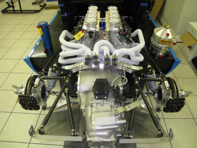

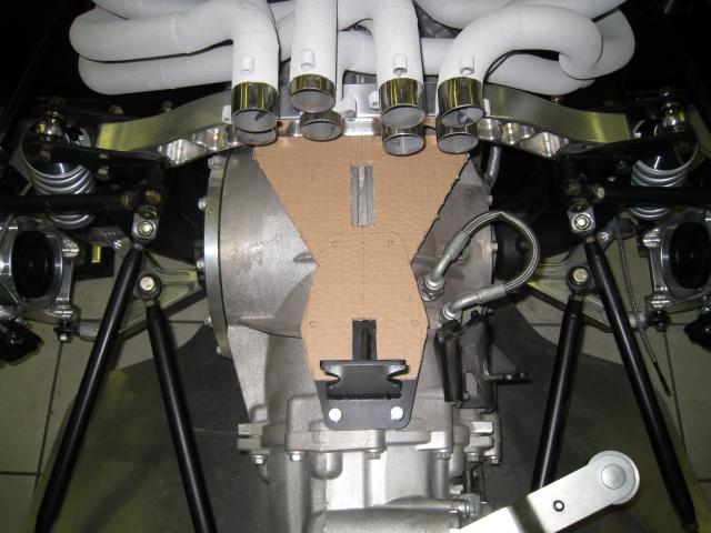

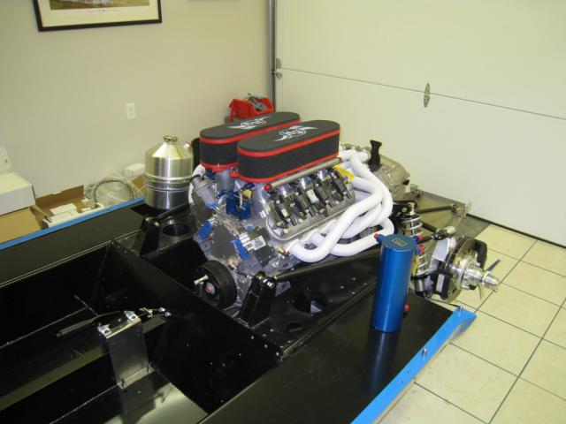

that tranny is big, and I am wondering where to run the rear swy bar. Dean and Ron, you are using them I assume? Any suggestions?
I am going to make a bracket to serve as a secondary transmission mount.
-J.

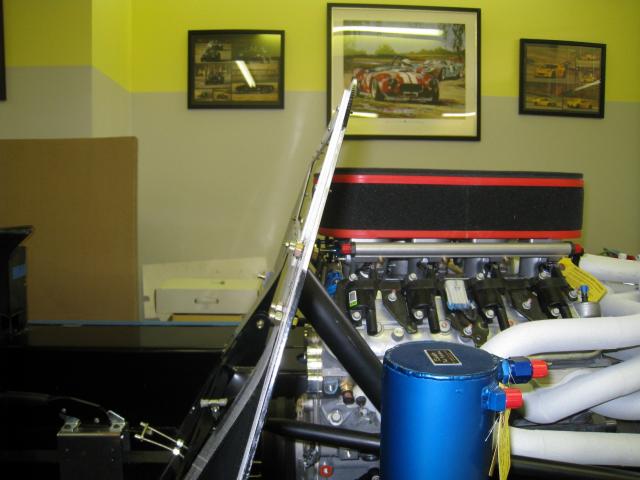

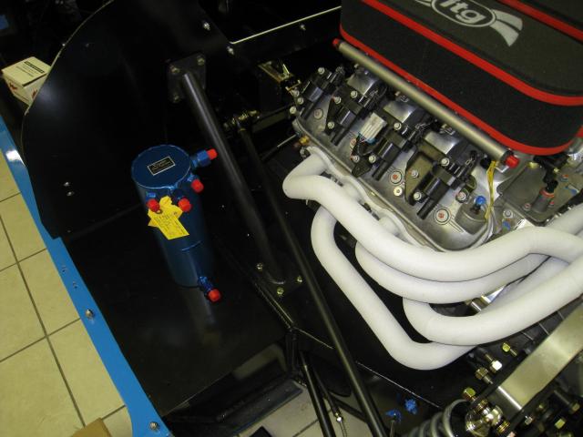

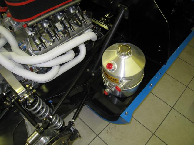

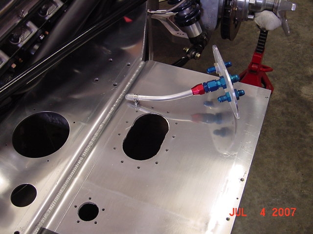

More ideas appreciated. Planning to put the VST (swirl tank) on the driver side (LHD). Oil tank on the passenger side. With the swirl tank, would you cut a hole in the bulkhead behind the tank and try to mount it down in a hole, or would you just mount it to the back of the firewall? I plan on cutting out the battery box space and sinking the oil tank into the hole there. So far, I plan to put the battery in the passenger footwell.

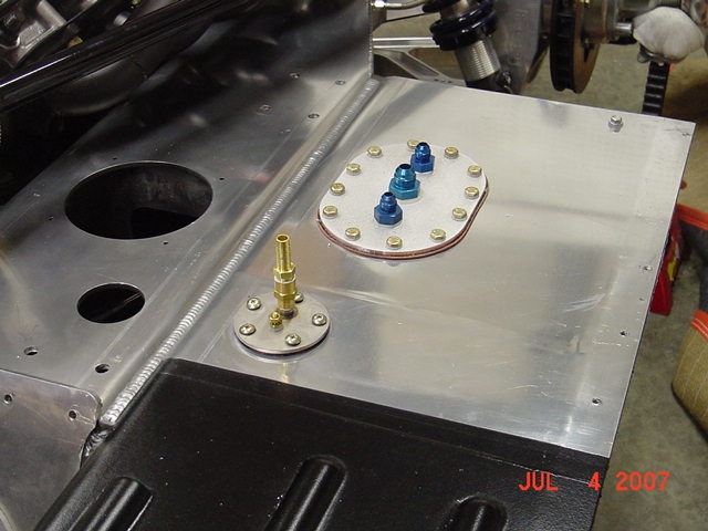

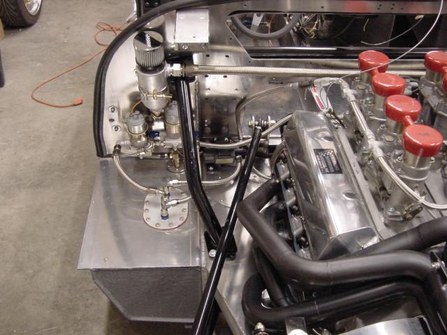

Ron and I are running the ZF box. It is tight but it fits nicely. I am using the rear sponson as my swirl pot. The main tank pumps into the back tank with an overflow back to the front tank. driversidelines2.jpg
