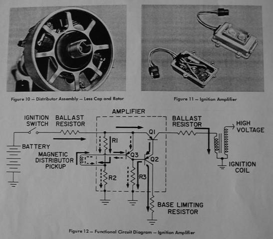

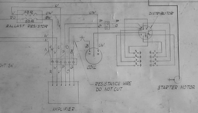

Attached is some of the info that I have on my transistorized version of the system.
I still need to find someone who can interpret the amplifier diagram and in turn construct a functional unit.
Most other have suggested that I should stick with a more contempory unit to avoid the hassles. I now have the option of both the transistorized and points distributors but it would be nice to have a functional transistorized unit.

The diagram is not difficult to interpret; the problem is that you do not have the resistor values nor the specs for the transistors. Was this unit used on any other Ford products, or was it supplied from a subcontractor who might have the specs for it? That might help. You would also need the specs for the magnetic pickup and the reluctor which drives the system.

Thanks Jim,
I am not right up on this type of tech but as you suggest the answers will be out there and it will just be a matter of finding them.

I believe that the two twin ballast resistors have different resistance values for each pair of poles.

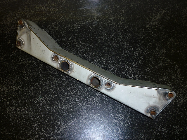

Help would be appreciated as I have lost my notes and I am in a hurry.
I am looking for some ready made bushes in modern material to fit this rear hoop support.
The part number is GT40P/1/2529 (OEM ~ Silentblock E21026)
Has anyone any contacts for starters ?

Dave,
O/d would be > 1.100" and Length is < 2.75"
I lost some data transferring stuff to my new Mac and I have the drawings with my notes somewhere in this morasse of my study.
It's just that I thought to broach the inner bores to fit the o/d of new silent blocks before I get this part electrodipped. So I have about four weeks lead time.
Supplier catalogue data would be a good start.
