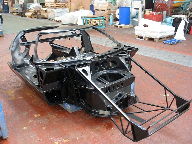

Dave,
You have got me thinking.

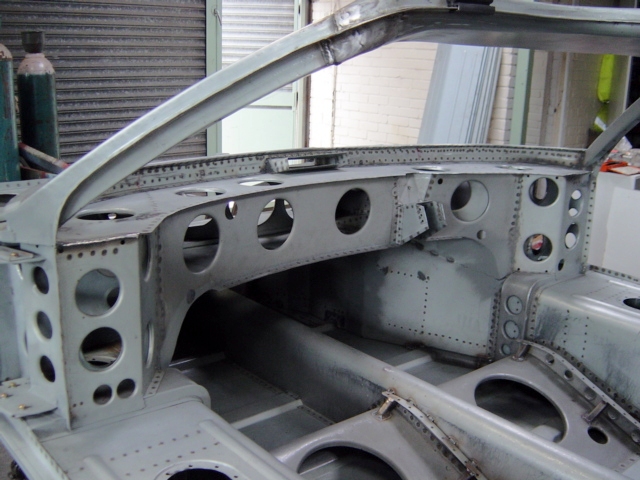

I have now decided to prime my chassis by electrophoresis here in the UK.
Shortly, the chassis will be chemically cleaned, etched then dip coated with zinc phosphate and a subsequent primer coat.
He is an original chassis recently done at the works.

Jim Rosenthal

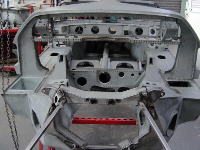

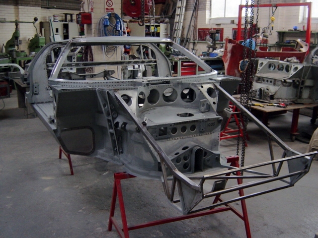

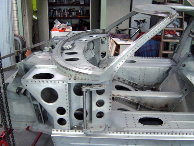

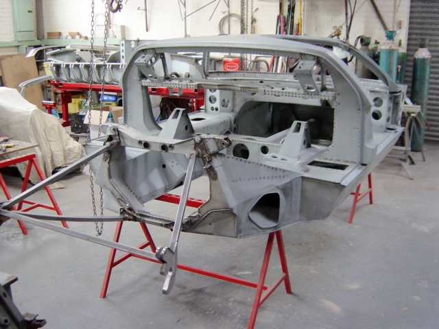

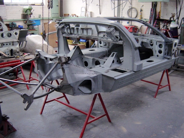

My chassis complete and ready for shipping to the electro-finishing plant.

re: Jimmymac & Alistair's Cars
Aye Jim,
A wee bit of fine work there. Pm me after the dip. I will be your process Engineer. I will give you a few tips to use to save you from various problems that can arise before you start painting. Sealer, mocaps etc.
Dave

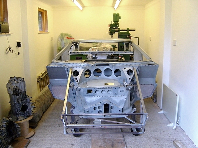

Well the chassis was delivered this morning fitted to an excellent build table which greatly assisted in the RO-RO from the low loader.
I have decided to drill all the fixing holes and fit self clinching nuts before it goes for coating. Hopefully I will get the majority of them. I am checking off my list of parts and making a hole schedule along with a fastener MTO from the JW Automotive parts list and the drawings.
The wiring and plumbing layouts might take a while to coordinate but I won't be rushing in for the sake of it.
