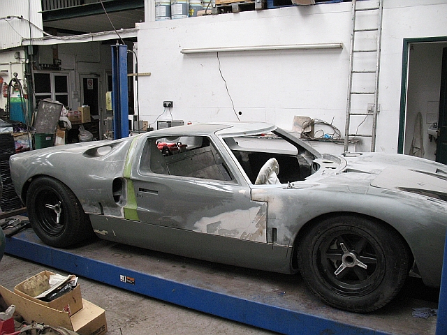

Not long now for us.

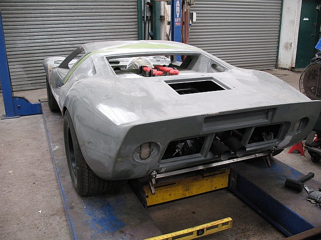

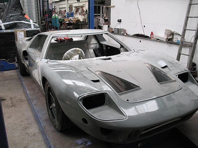

Alistair's car is on the ground for the first time after trial fitting everything.

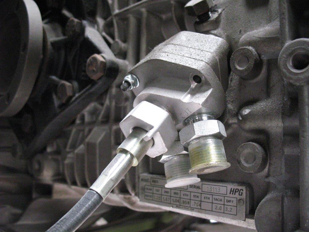

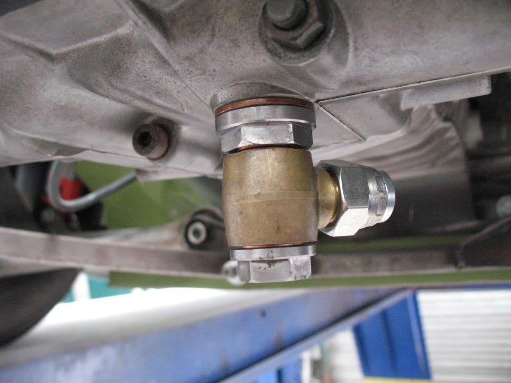

Fitted one of the transaxle oil pumps which we made and the oil line banjo coupling today.
re: Jimmymac & Alistair's Cars
James:
Very nice job as usual, do I see a 3.20 final drive on that gearbox ?, in 5th thats gotta put you at around 2.4 final drive ....that car will have some long legs.
Phil
JimmyMac
Phil,
Correct - that is Alistair's racing box.
We also have a few more ZF0/1/2s with Pantera style ratios and spare CWPs and gears which we had custom made a while ago.
The project has taken such a long time that we kept buying bits when they came available but Alistair had decided on day one that he wanted this one to try out his "long legs" :)
The tri-lobal drive shafts and donuts will be going onto this box pretty soon.

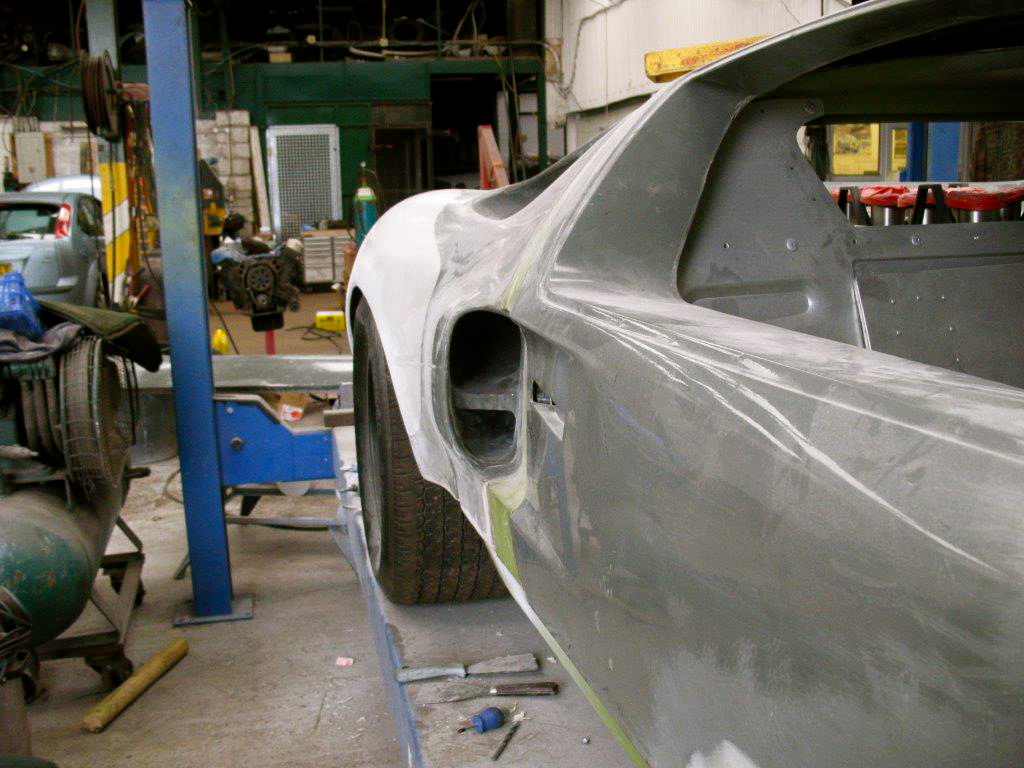

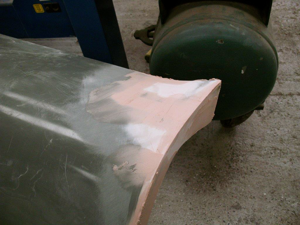

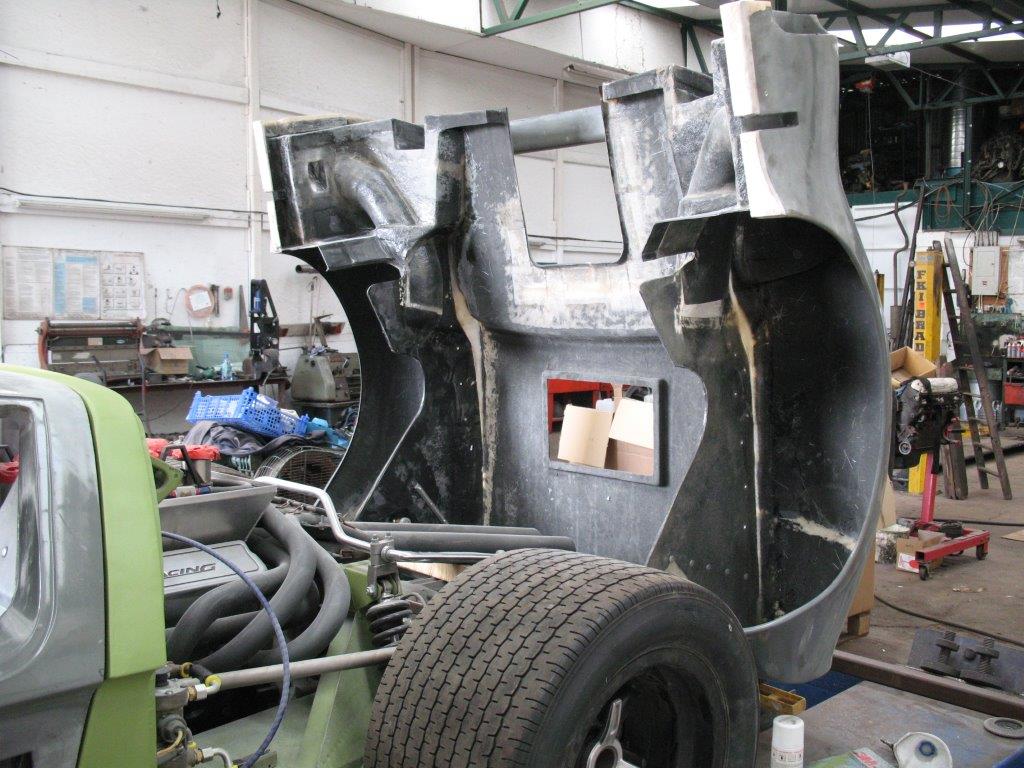

Work was almost finished on Alistair's rear inner shell but he has decided to add a wee bit more flaring to the arches for those 12" wheels.

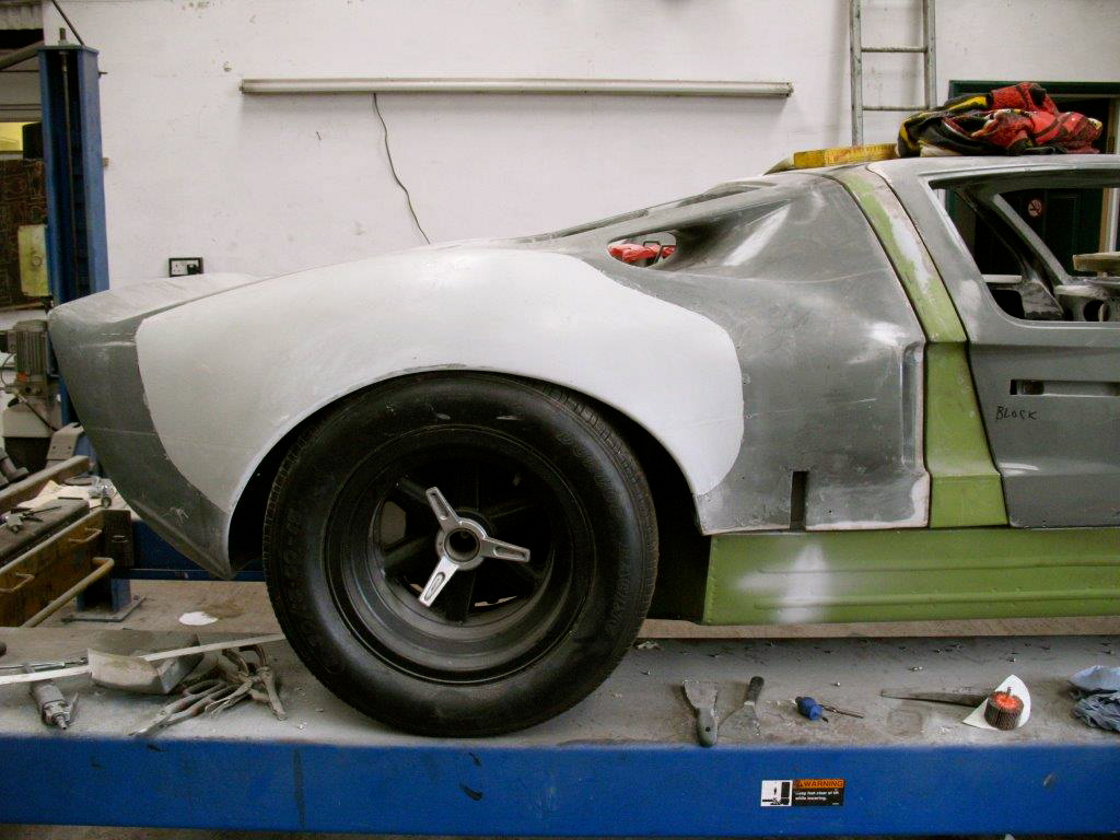

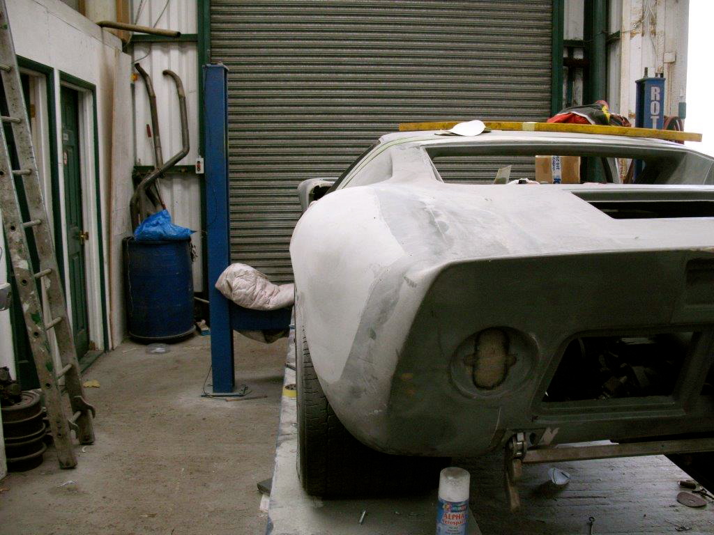

The rear flares almost complete so now the long boarding begins.

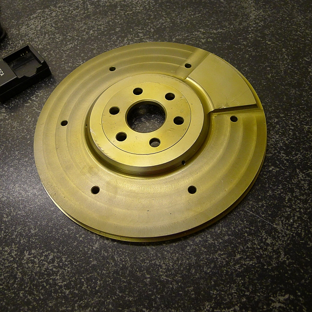

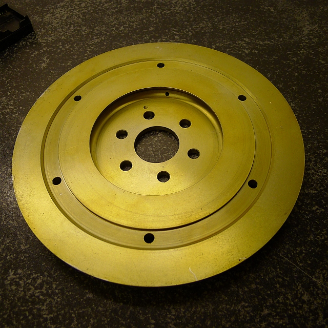

This afternoon I was waiting for my wife to pick up some more flamed maple from Michigan at the post office and she came back with this and the guitar wood.
My new 289 race flywheel all the way from a good mate of mine - it went around the world twice :laugh: so many thanks Peter for your persistance.
I owe you big time pal.
This steel billet is machined to an original FAV shop drawing for a small 10+" 117 teeth ring gear which I have.
The yellow cast is Cosmoline.
The wood also looks fantastic !

James, what oil pan are you using? I dimly remember a lot of conversations about flywheels, ring gears, starters, and oil pans. I think the original ones were made by Aviaid- is that what you have? I found it was hard to get the pan rails to seal, if I recall right.
JimmyMac
Jim,
We have the Aviaids on and I remember the same conversation.
Some time ago, a couple of guys had issues with their crank ring seals fitting properly on them but I have not heard any more on it.
There is another proprietor out there who makes the pan, and they were good but I can't remember his name.
