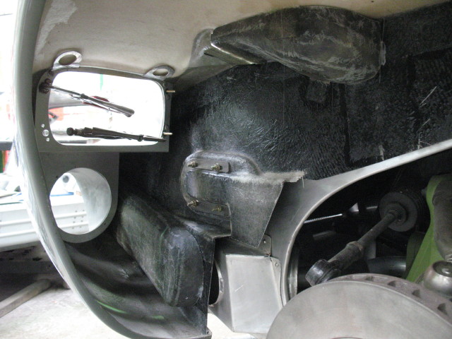

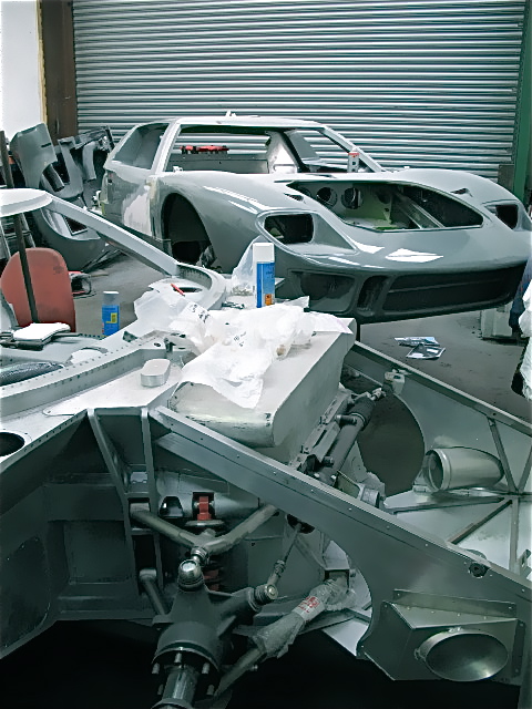

Very nice work...
Interesting on the duct work for the cabin air and brake cooler.. I have never seen those from this angle before! All to original specs?
JimmyMac
re: Jimmymac & Alistair's Cars
Randy,
The heater plenum is an original from an FAV road car and the brake duct cowlings are new fabrications made from Alistair's originals.
The two air duct inlets on the plenum were blocked off during it's previous service but I will be opening the up again :)
Apologies for my redacted previous post but my comment was how well the Zintec coating has preserved my chassis given the time it has been lying bare.

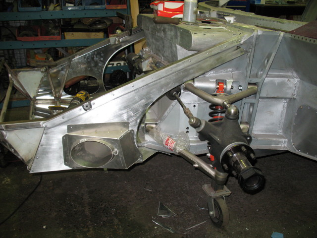

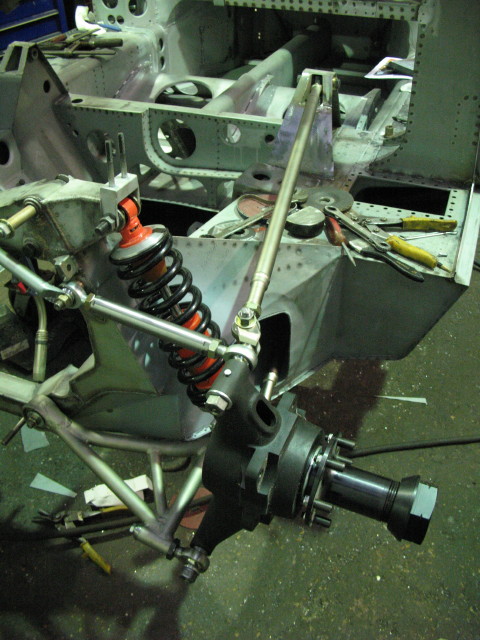

My original Konis and suspension parts were fitted to my chassis by Scott and Alistair this afternoon.
hm, indeed...just saw a video about that process...
if you have to drill holes maybe it needs not to many, depends how they dip the car I guess? maybe you can come to a great solution, such nice car with such lot details and work needs to be conserved well but also be driven.

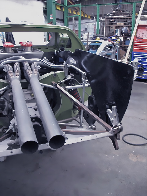

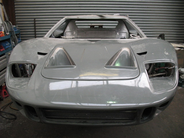

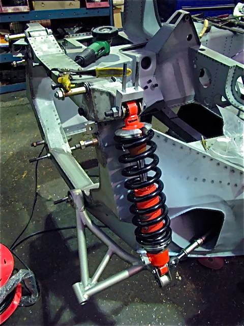

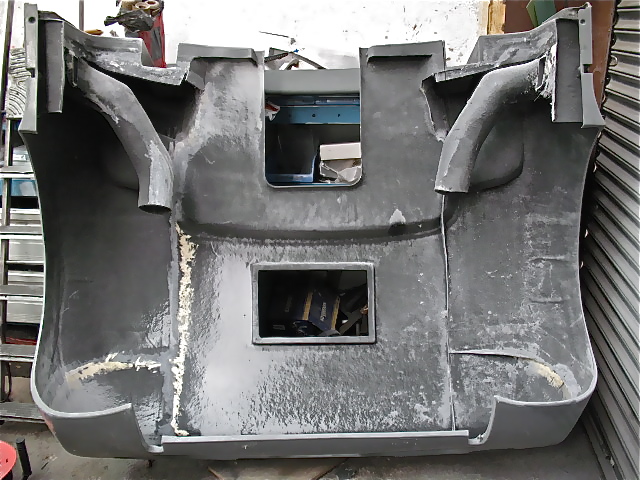

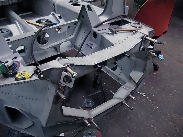

This week's work down on the farm.
Fitting the inner flitch panels to Alistair's rear cradle prior to dropping on the shell for bonding to an exact fit. The inner vent ducts are also being modified to fit our new brake coolers.
A photo of the rear end of my chassis showing the scallops for wider shock springs and one detailing the front complete.

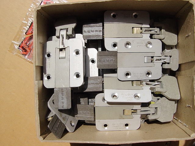

I am still hunting parts and found another batch of Hartwell latches recently, I can't remember exactly how many but quite a lot. Need someone to supply the steel outer shells and new posts now.
JimmyMac
More Hartwell latches for modifying

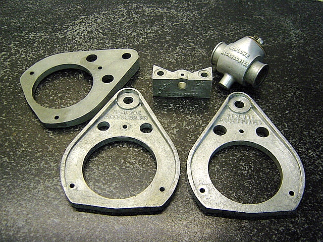

Did you get the gear shift thingy ?
Here is the result of this morning's graft.

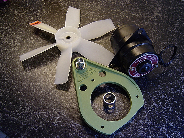

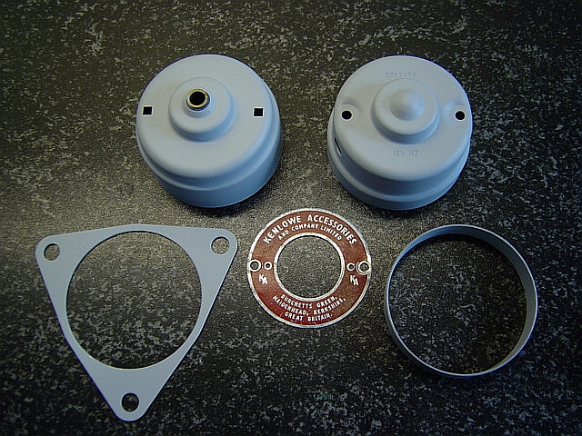

An old Kenlowe fan fully re-built with a new fan, lube washers and carbon brushes. I have also added some insurance by weatherproofing it and fitting some Kapton insulation tape.
These were pretty useless in the day but it needs to go in.
