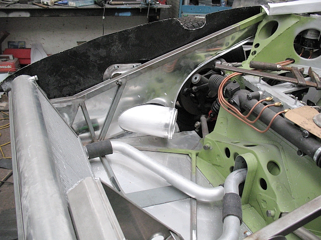

A couple of pictures showing latest progress.

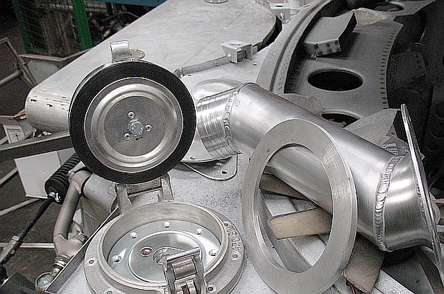

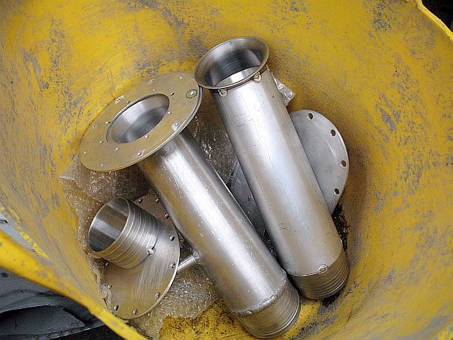

My fuel inlets are being welded up today. These are not to the drawings as we thought that the original adhesive/sealant joint arrangement far less safer than good old hose connections (we won't need to inspect glue joints every time we go out !). The tops are also machined for locking caps.
The second shot shows the fit up between the front inner flitch panels to the bobbin roller and also their relationship to the brake duct vents in the clip and in a mock-up of the alloy side panel.
We wanted to get the fit accurate so the flitch panels will be bonded to the clip this week when everything pairs up nicely.

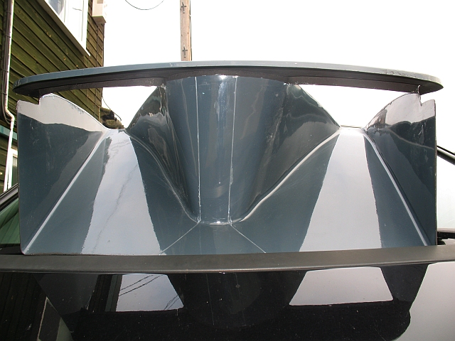

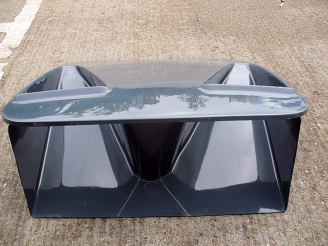

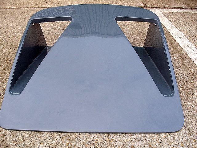

Front Nostril Panel - vents are deeper than usual to move more air.

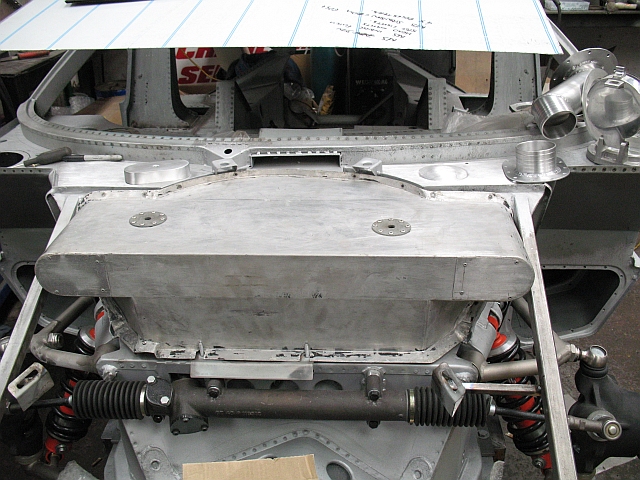

Locking caps fitted and the fuel inlets welded and ready to go in.
Front valence covers for hydraulics also made up.

We did the fuel inlets in a similar way, with locking caps inside.

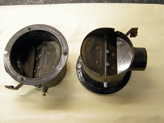

JimmyMac
re: Jimmymac & Alistair's Cars

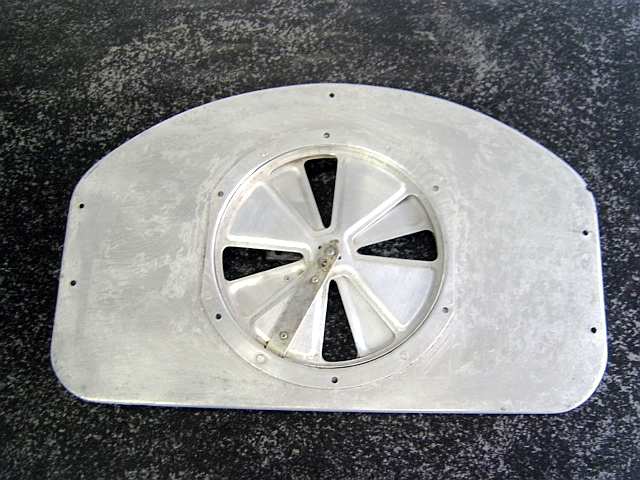

Richard,
There is a damper inside the oblong vent which is operated via a lever which protrudes through the top of demister grille.
I am also fitting cable operated butterflies to the two side dash vent entries on the chassis. These are two Fomoco parts bin pieces.
There is also another cable operated iris vent on the bottom of the heater box.
Did you get your gear shift thingies ?

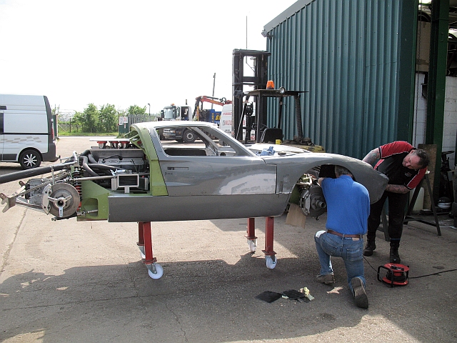

Body-shell fitting today

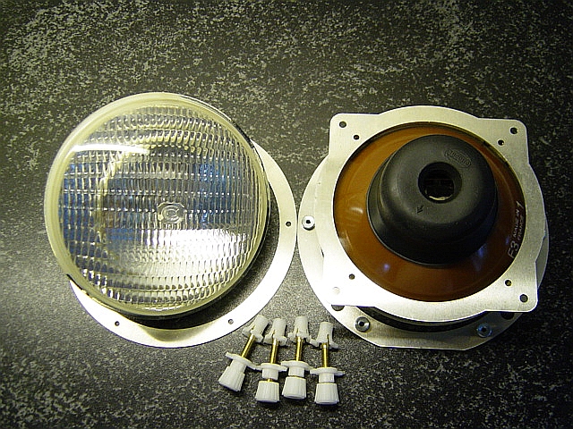

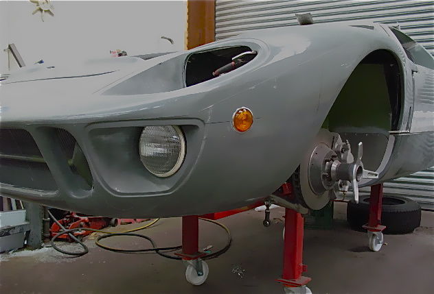

We are both going with period Cibies in the lower light pods

Won't be long now. I used the round lights in the lower recesses as well, they look a lot better.
They do look better in my opinion but they are a bugger to fit as there is not much fibreglass left after cutting the holes.
Did your flasher switch fit OK Jim ?
+++ for the round lights, 5" lights fit quite nice, if you use high beam lights they make a great light at night ( used H1 Cabellos)

"Rear adjust" fittings for the Cibies.
Richard,
Car is looking great Jim. I like your butterfly vents, I have them on my Ford Anglia :)
JimmyMac
Trev,
Not spec for a 40 but I am using them as templates to make smaller ones.
The lever fittings will be re-used.
