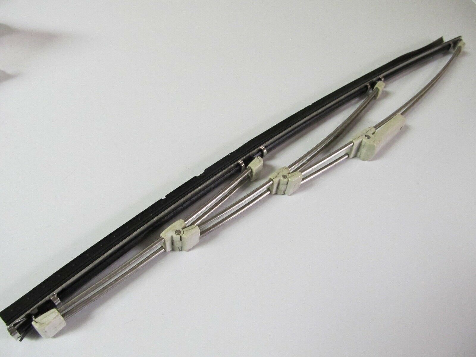

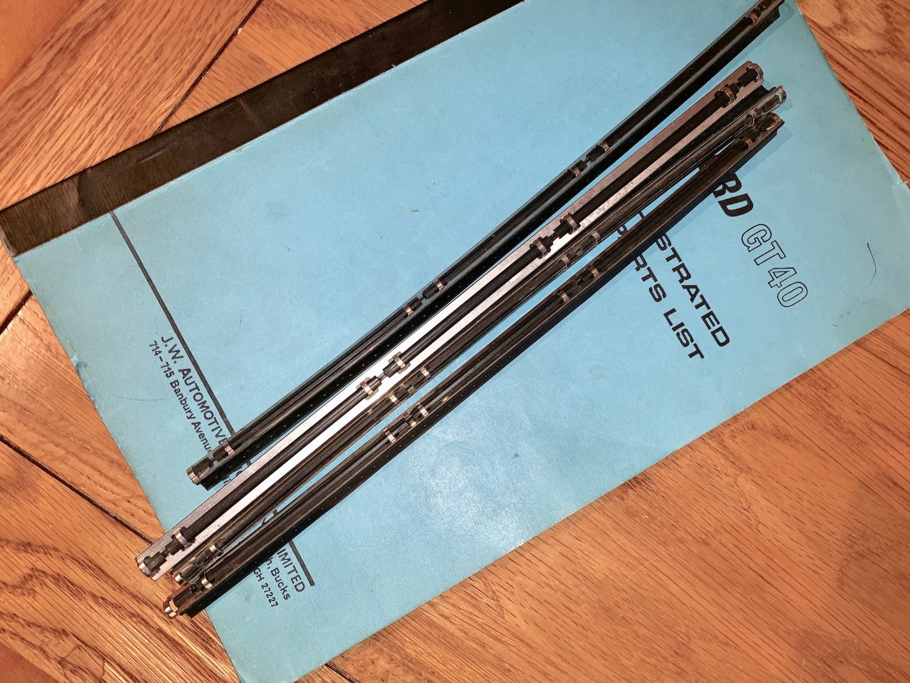

GT/109 is on the block at Mecum and for some reason the write ups on the sale specifically mentioned the original Trico wiper in the restoration.
Here is one of ours.
I have sourced the replacement blades so there is no problem replicating the whole shebang.
GT40 GOLD PARTS
GT40 GOLD PARTS.COM
GT40s Sponsor
Hello Jimmy,
I too came across a rather large quantity of the dimpled blade rubbers, some time ago. I had the white nylon mounting components injection moulded, stainless rods machined and assembled around 6 so far. All gone to original chassis restorations.
Can i help ?
JimmyMac
No thanks Andrew, presently we are happy with what we have.
I am thinking of doing these later in bar stock alloy as the grey plastic ones crack and don't last long.

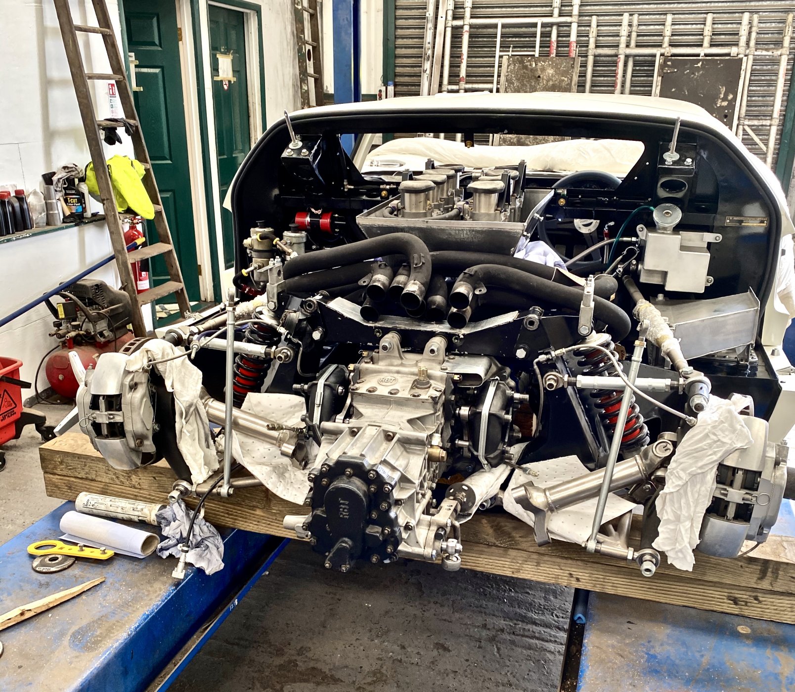

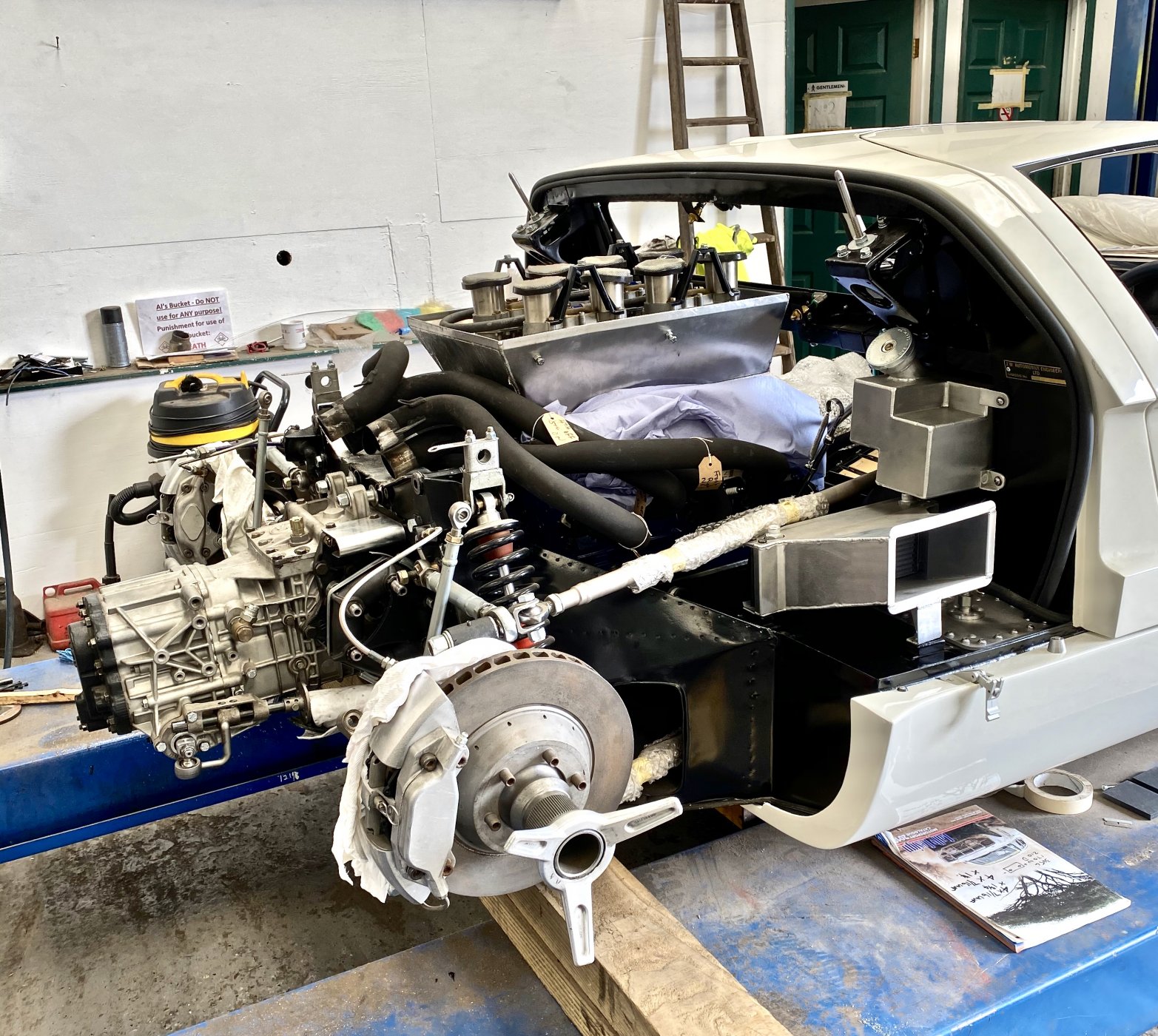

James,
Are you going for a internal hydraulic release bearing?
May I ask why?
1. Was that ever original?
2. Leak issues with that setup?
Maybe I'm misinterpretating the braided hose coming out of the bell housing.....
Markus
JimmyMac

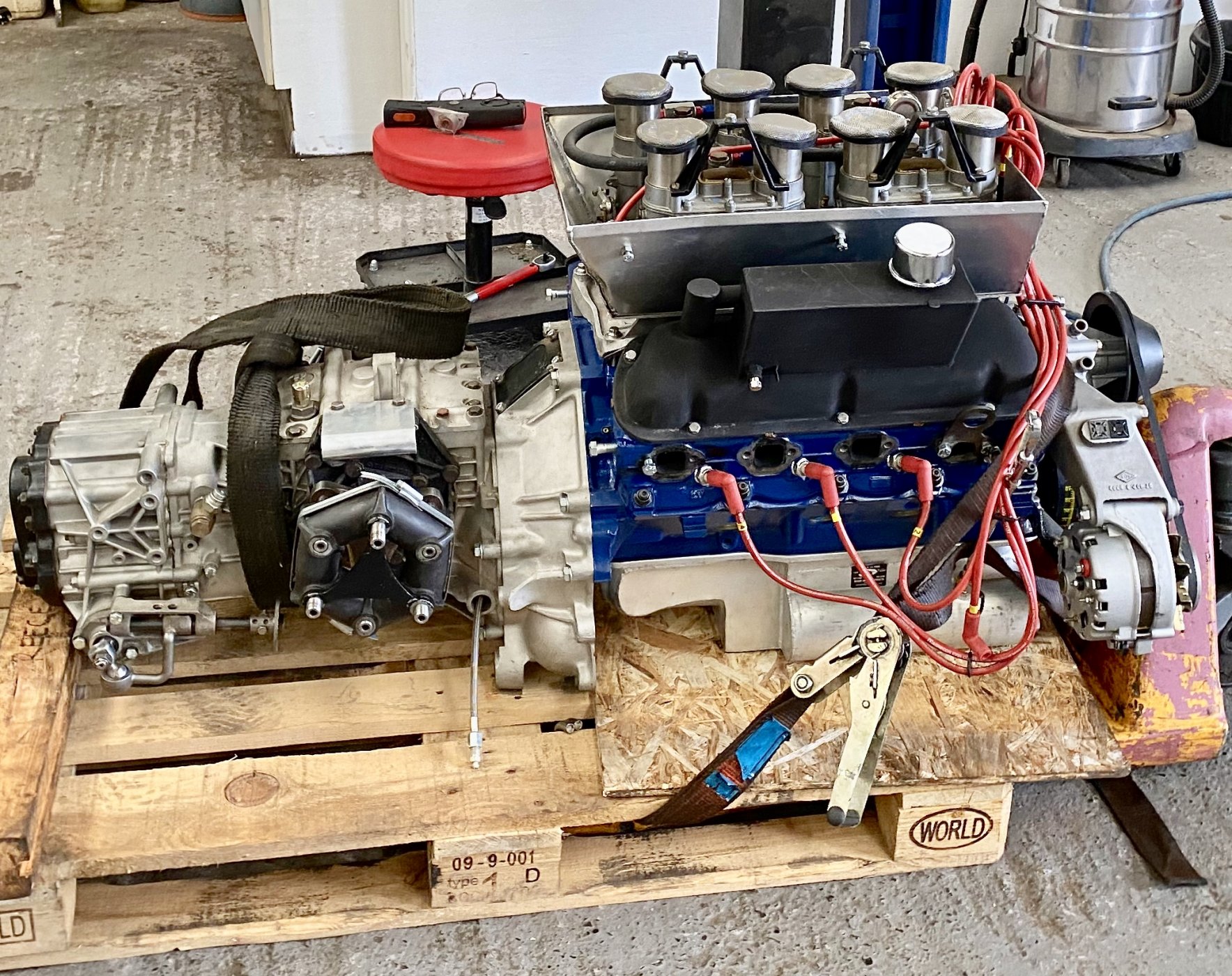

Hallo Markus,
Yes indeed, we are using custom made HRBs.
I don't believe that they were used originally.
The car is a racer with a spare gearbox so the box will have regular changeovers and the original external slave / lever / rod / pin system is a bit too temperamental to setup and frankly we didn't really like the look of it.
I have all those original slave parts and will fit them as dummies on my own bellhousing.

Markus,
No worries.
We started with a modified Tilton 6000 HRB for the ZF then added an extra oil seal groove to the inner face of the threaded mounting sleeve to improve the seal on the gearbox outer casing.
This is what we started with :
It worked really well on the first engine set up..

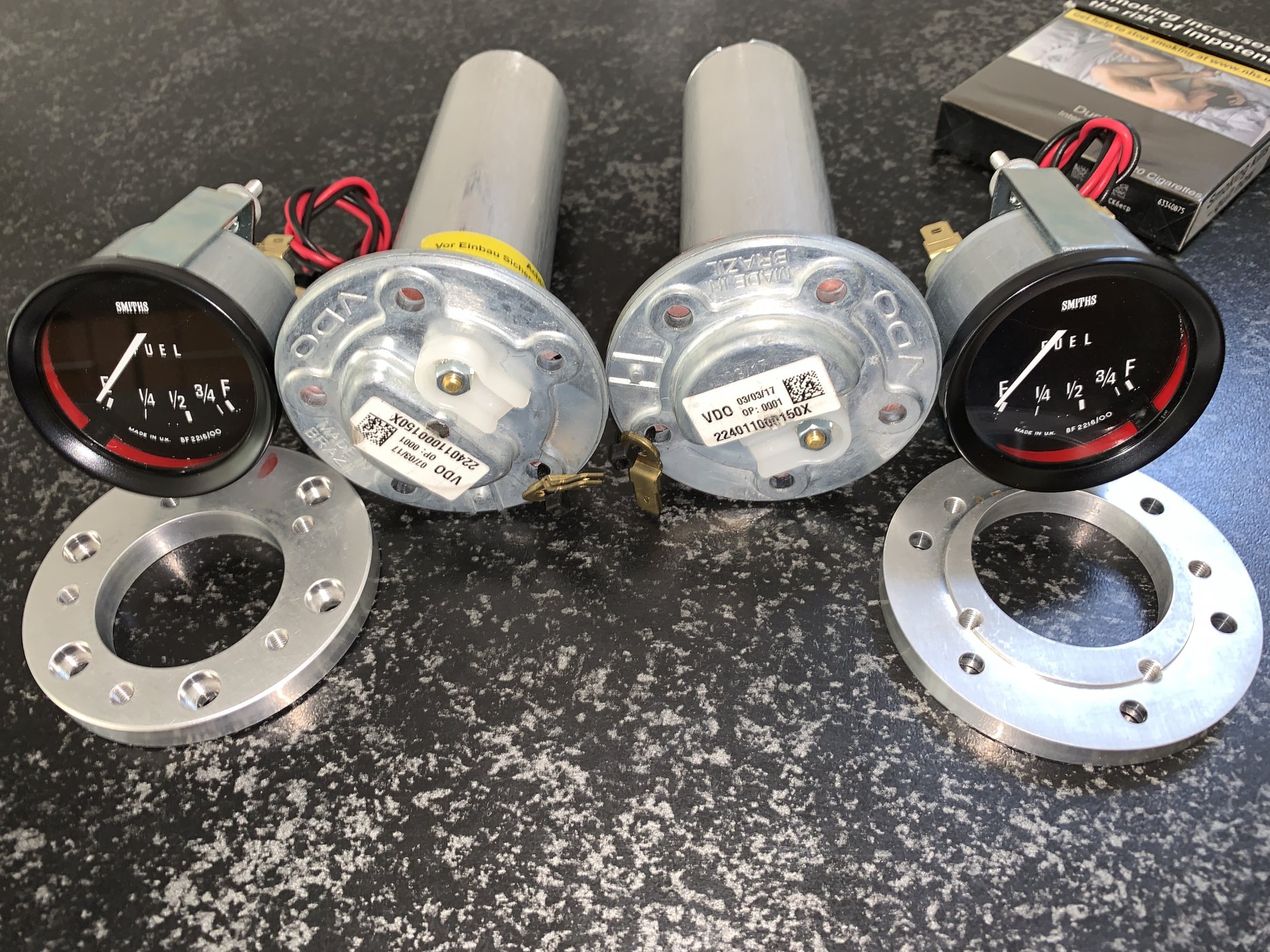

When we installed alloy fuel tanks and we wanted small footprint senders in the fuel safe foam so decided to try modern VDO senders.
The shortest VDO dip tube sender is sold at 150mm and we had to shorten these a little to fit the sloping bottom of the tanks.
Then we got new artwork done for the dials and had the low ohm gauges custom made with VDO electronics and calibrated to the dip tubes.
Another issue is to make adapters for VDO 5 bolt to original Smiths 6 bolt fitting.
They were tested and work perfectly.
The gauges don't have the red plastic shrouds in yet. A little job for tonight.

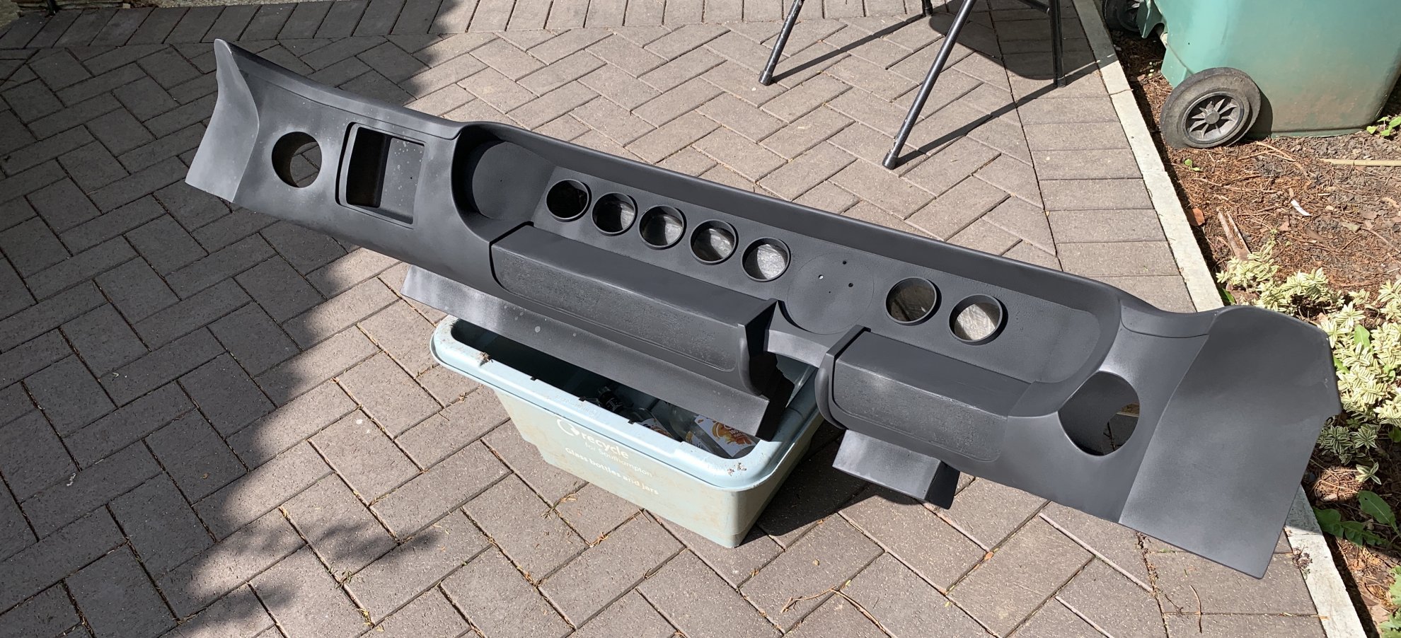

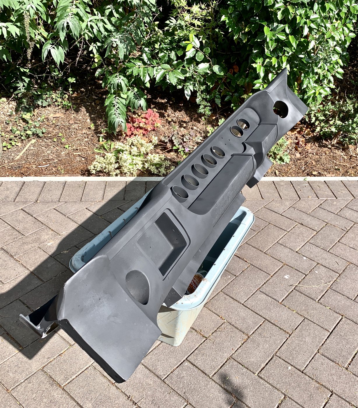

The new dash for the road car which has taken me ages. It's finally in primer and ready for painting and trimming.
After the Grady Davis first Gulf car P1049 with the two additional gauge pods and the fuse box.
I won't be fitting a clock but using an original fuel pressure gauge instead.
I’m hoping that you will be fitting a remote fuel pressure isolator rather than running a pressure line into the cockpit. Granted 3-4 PSI is not a lot, but enough....
Two things I would sacrifice in regard to originality are directly fed Fuel Pressure and Amp Gauges...
JimmyMac
Hi Randy,
Absolutely agree with you.
I will fit the fuel isolator at the engine side of the firewall and run a pressure line with glycerine or glycol to the instrument.
As regards the CAV ammeter, I intend to use a rare CAV 0-25v volt meter which is almost identical.
