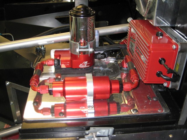

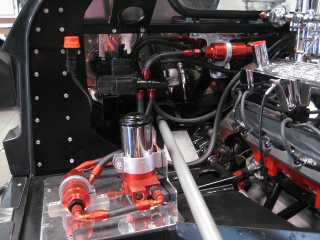

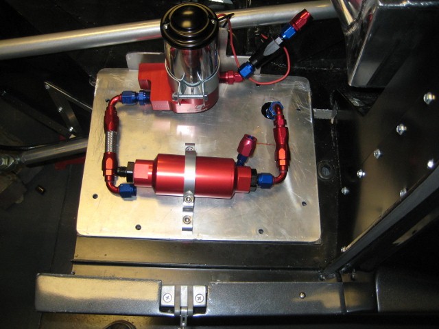

Continuing on to the fuel system. I used an Aeromotive fuel pump with a pre and post fuel filter. the first photo was before I reanodized the fittings to the same color. The next photo is the final polished set up. This is a twin system with one on each side of the car. Since the car is so hard to get in and out of I got to thinking about how quick I could get out of the car if it got hit. The thought of two electric fuel pumps behind my head continuing to pump fuel was a little concerning. So I wired in an inertia switch to shut off all the electrcal if the car had a significant impact. Sort of an electical air bag.

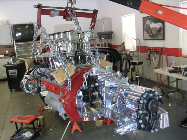

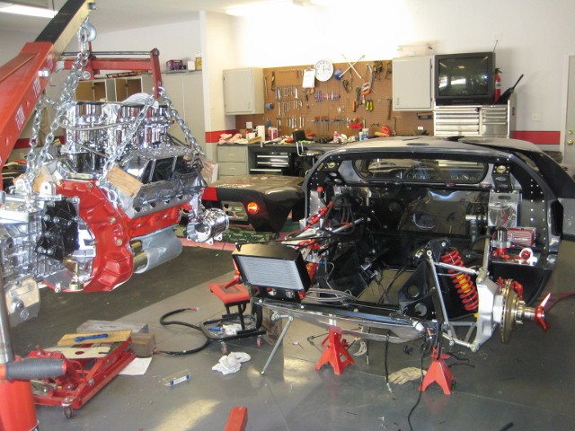

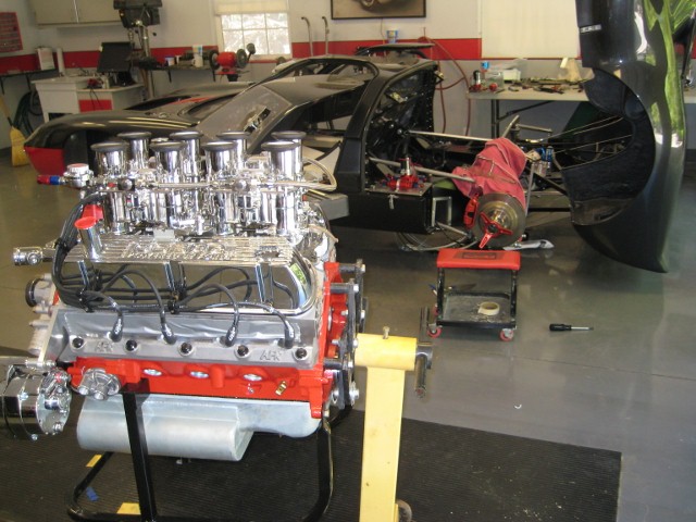

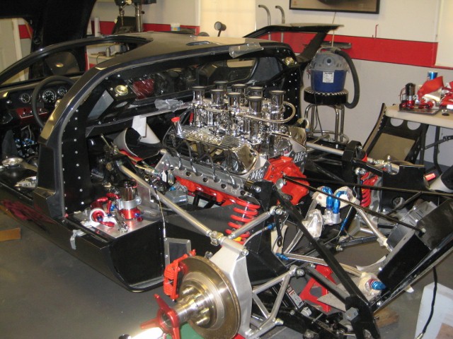

gt 6-23-10 003 (640x480).jpgAfter reading a post the other day that stated there were no complete ERA build threads I thought I should take the time and complete mine. At my last post I was just starting to put in the engine. There is a photo of the engine in without the transaxle.

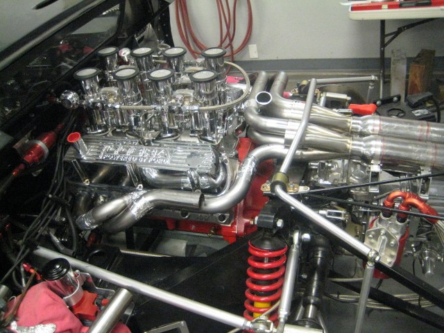

After getting the engine in I embarked on the exhaust system. I wanted it to be a piece of art rather than pipes going in different directions. Since I couldn't find anybody to do it the way I wanted I decided to do it myself. After I brushed up on my tig welding I started cutting up and welding the mandrel bends. In this photo you can see the beginning of the project. Note you can see some of the pipes taped together. I wanted all of the tubes to come off the heads of the same angle.

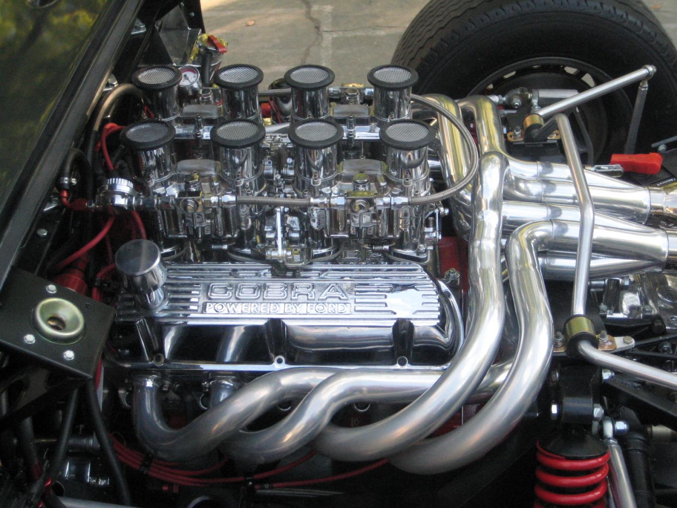

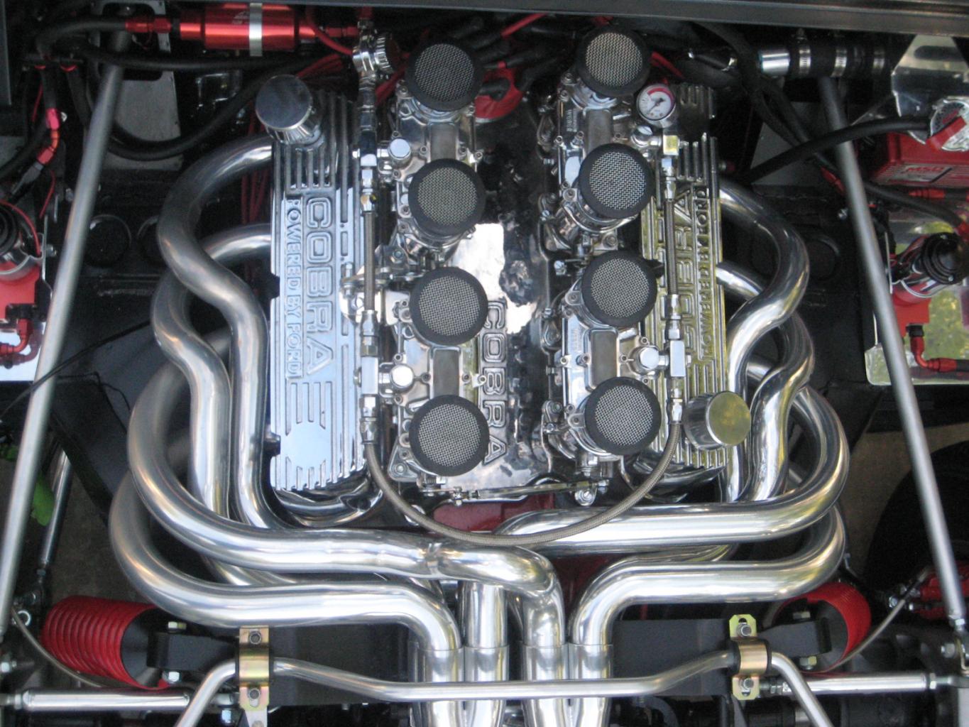

It has become more and more difficult to produce a top-quality product at a reasonable price. I really enjoy the fabrication and putting together cars. It has been a real pleasure to build the ERA car. All the pieces fit like it should and no shortcuts have been taken. Truly the best of the industry. That said here is a photo of the completed header project.

Mission accomplished!!! What a work of art those headers are, so fluid in their form!
SO looking forward to the rest of this thread....thanks for posting :thumbsup:

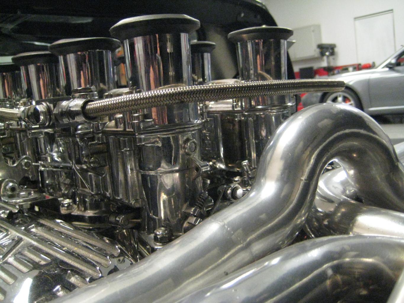

That really is a nice build. There is only one flaw that happened to just jump out at me. The fuel lines. They are sitting almost right on the exhaust header. It was looking like it on the first post of the exhast build. There is a way out however. You will need to consider one of the following. A turkey pan, a shield at the rear only or swap sides with the webbers and shorten the fuel lines to keep the fuel from boiling. Otherwise a great build.
When I first started looking at GT 40s ERA was first on my list. I traveled to Conneticutt to see their factory and was very impressedd. I also visited Tornado, which was just down the road from them at the time.
Bill, thank you for your observations. I believe the previous photos presents an optical illusion that the fuel line is closer to the pipe then it is. There is at least 1 inch between the line and pipe. Two other factors which will help reduce the fuel boiling are the headers are ceramic coated and the fuel system is a circulating system. At a later date if there seems to be a problem I will probably wrap the pipe or the fuel line.

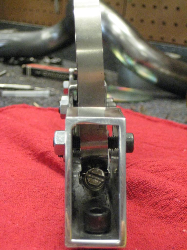

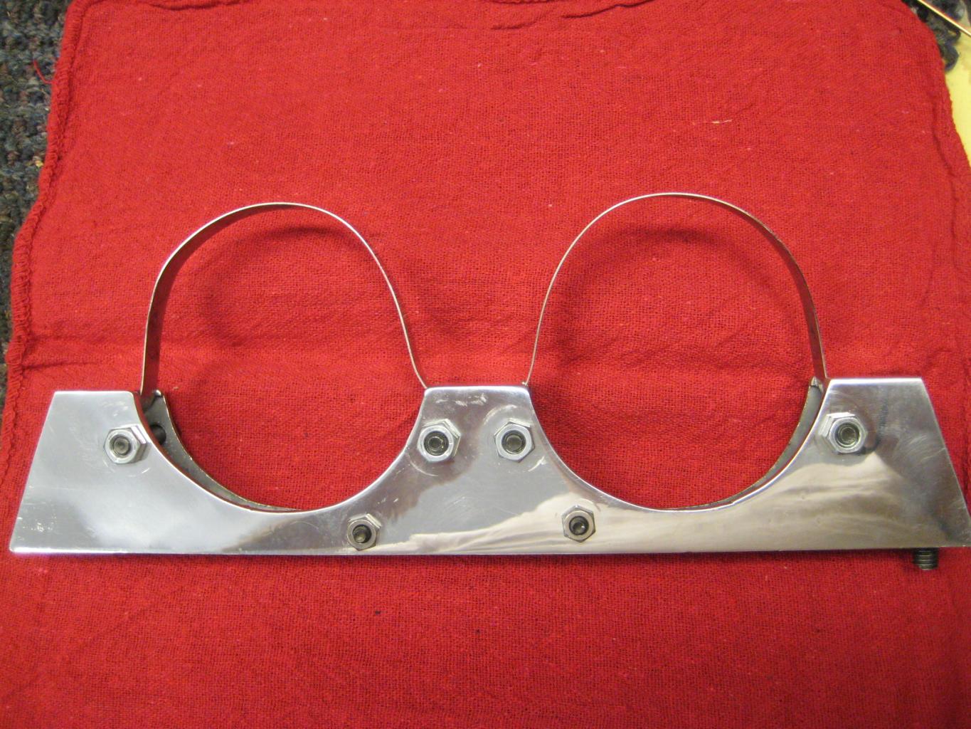

Hi Jim, absolutely incredible job on the exhaust system!!!!, could you tell me whose mufflers they are or did you make those also, I would like to put a pair like that on my CAV, thanks and all the best, Neville Nesbitt on Long Island, NY.
Neville, thank you for your kind comments. I did not make the mufflers. I bought this item from Stainless Works item number ST252425P. They have a 2 1/2 inch inlet, 3 1/2 inch body and 24 inches long. Enclosed are a couple of photos of how I made the brackets to keep them stabilized. This was just made out of some aluminum channel material and some clamps.
