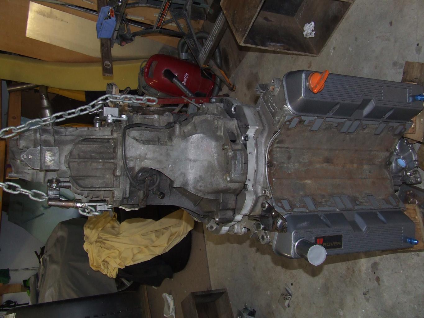

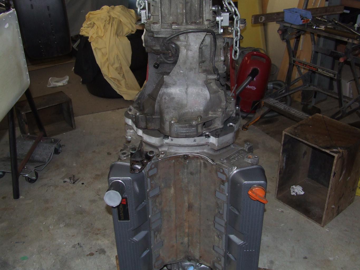

Great to hear your on top of things, now for the easy question, That Audi gearbox that I am using, I think you said that rod out was 1st 3rd and 5th, it kind of feels that way without being able to turn it over at the moment.
