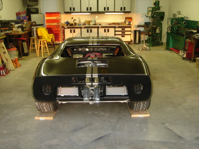

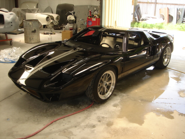

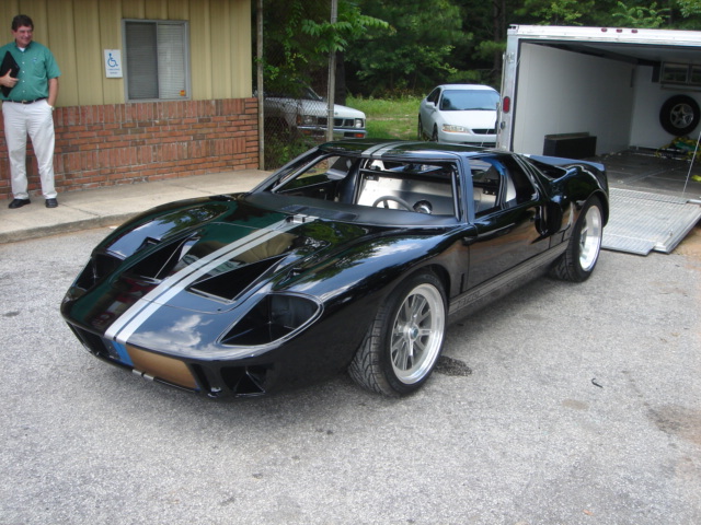

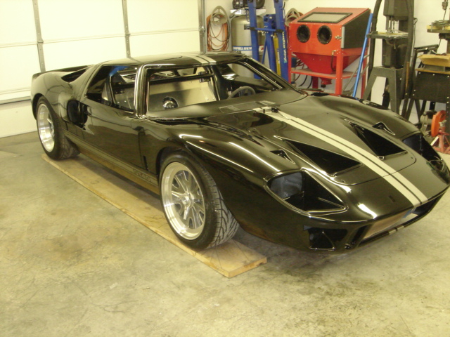

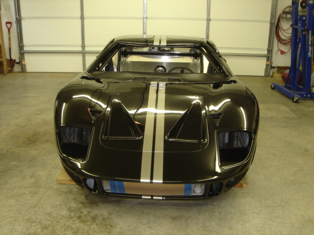

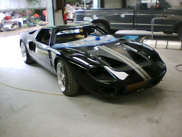

IT'S HOME!
I was not able sleep at all Sunday night in anticipation of picking up my car Monday. It was a very long drive over but well worth the wait! The first photo is of the car in their shop the first time I laid eyes on it. The second photo is of the car out in the sunlight before we rolled it up onto the truck. The remainder of the photos are of the car back in my shop at the end of a long day.
I am very pleased with the way the paint came out and the way the car looks and I could not be any happier with the outcome. Bruce Bunn and his employees were very proud of the way it turned out. They were also very quick to point out that the body pannels were very straight to start with which made their job easier.
The finish line is now in sight.................

Keith - as our father Roy would say, "she's a beaut!". Just stunning!
You should be SO proud......let me know finishing plans soonest.....
It's gonna be a stunner Keith.. That's for sure!!!
The contrast between the stripes and the base color is very pleasing to the eyes - Not too sharp, but a very "down to business" look...
Rob
Fantastic Keith. She looks fabulous. I love the black. AWESOME.
Take the week off..!!! :D
Awesome. The GT looks good in black.
100 hours to finish? Hope springs eternal . . . . .
Keep the progress posts coming!
Keith, you really should have waited until the paint was dry before bringing it home. Seriously, does it need any color sanding or polishing? Can't see how from the pics.

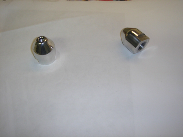

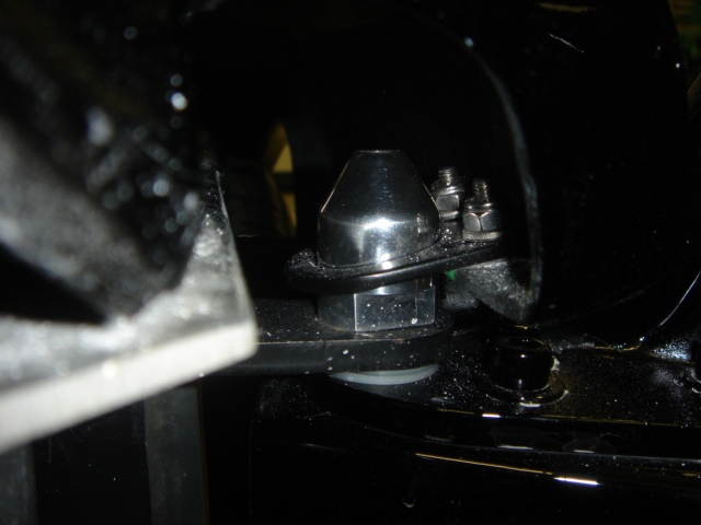

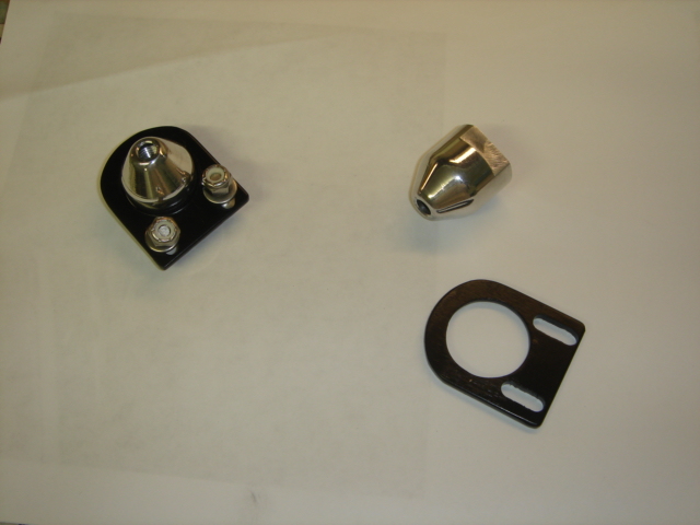

Guide pins:
One of the body fitting issues that I had not been able to resolve was a "shift" of the rear portion of the front clip that favored the right side of the car. I had used a spacer shim during the body fitting to get the gap between the forward edge of the spider and the rear of the front clip so that the gaps were correct but this was not an acceptable fix for the final product.
The final solution; the locator nuts and guides shown in the photos below. I machined locator pins that replace the top nut for the door hinge bolt. It is one inch in diameter, an inch and a quarter long with a sixty degree taper on the top. I machined two flats on the bottom so it could be tightened with a 3/4 inch wrench and drilled and tapped it 1/2 NF to match the bolt. The guide plate is 1/8 aluminum plate with a one inch hole to match the pin. I slotted the plate so that it was adjustable.
I am very pleased with the result.
