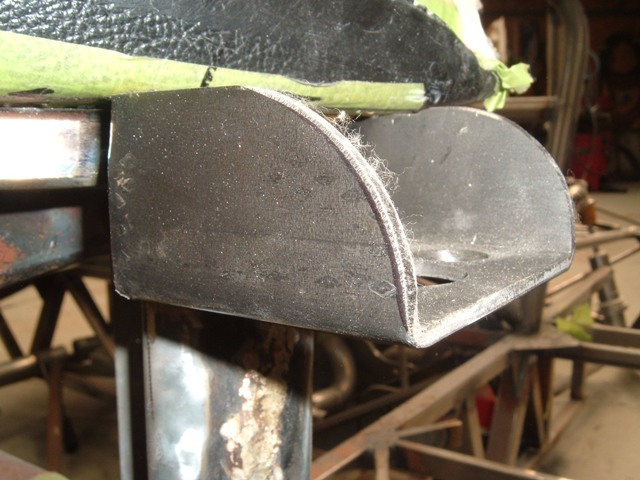

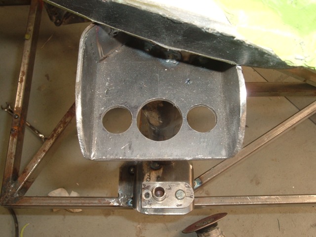

Interesting baffles in the fuel cells!
A number of years ago I met up with another racer that created his own cells and he had one of the most ingenious ideas for baffling..
Wiffle balls.. I thought that he might have some trouble with the composition of the balls and the interaction with the 110 octane racing gas, but he said that he'd been doing it that way for years and never a problem.

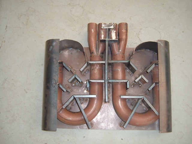

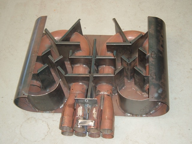

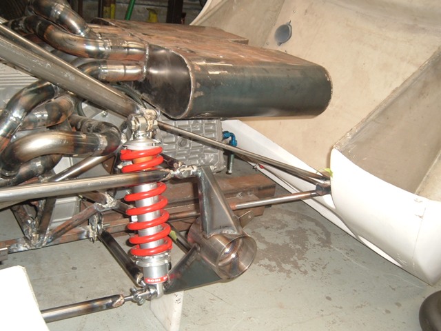

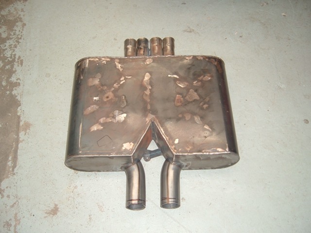

Well the muffler has been sitting around partially finished for months. Just waiting for the next time the body/engine/trans were all fitted up together so I could build the tailpipes to align with the hole in the rear clip. I've now done that and the muffler is finished.
The muffler design is broadly the result of a discussion I had with Jac Mac on the subject. The object is to be under the 95 decibel maximum noise level that is enforced at some tracks in NZ, and to do that without reducing the available horsepower. Mind you it weighs a ton and all that extra weight is up high.
Maybe I would have been better to take a horsepower hit and go for lighter and simpler. Time will tell. Just as well I've got 800 lb springs in the back.....

Randy, thanks for the kind words. Although "interesting" is one of those non committal words....A bit like "different"....;).
Russ - Nothing derogatory implied or meant.. Your fuel cell baffling is just not consistent with what I've seen in the past for fuel cells.. The trap door baffling is more in line with what I've seen used (successfully) in oil pans. Typical baffling in Fuel tanks / cells are bulkheads with offset holes in them to spoil the momentum of the moving mass of fuel, yet not pose such restriction that the the fuel pickup be left uncovered.
I'm believe that you'll be happy with the results of your work..

Randy, I’m too thick skinned to ever be offended. I was just making a tongue in cheek comment….Hence the wink! ;) With the baffles and trapdoor I want to be able to get two hours endurance racing out of both tanks so I need to suck them almost dry without any fuel starvation issues. Hence the “interesting” design and trapdoor. As always, I am confident that what I have done will work as intended…..

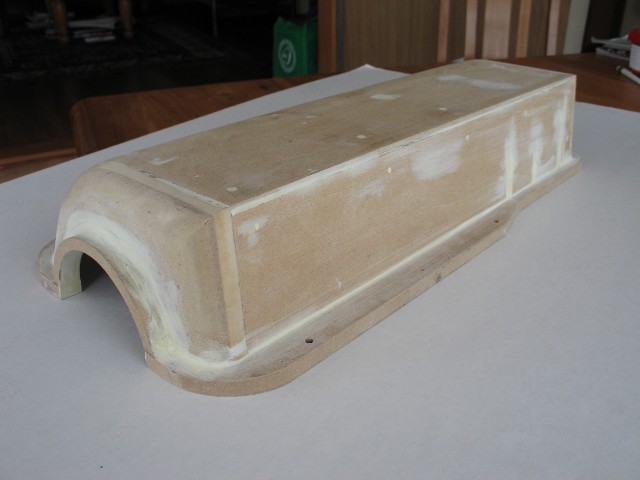

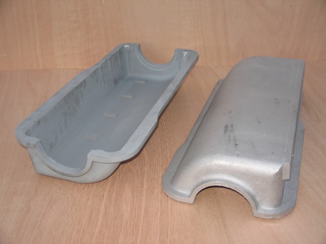

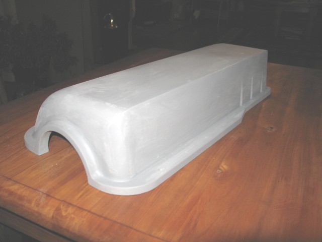

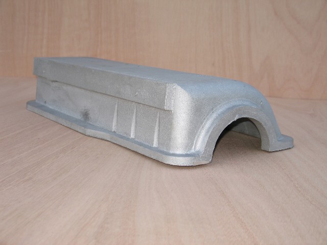

Well the protracted dry sump saga is coming to a close with the casting of our own sump!
Lim has put a lot of time and research into this and we are confident that we can turn out something of a much higher accuracy and quality than I was able to buy. That's what it comes down to in the end for a race car, everything has to be perfect! And, if you do your homework and put in the hard yards, you don't have to spend the earth to do that. That of course is why we try to build as much of the components of the car ourselves, particularly if it restrains costs :thumbsup: But doing so tends to add to the build time :mad:. Secondly, and more importantly, we then have total control over the quality :pepper:.
Because I am running low ground clearance, low motor position and a Porsche size ring gear and a front mounted starter and a four bolt block and tight clearances to the chassis, the clearances on everything are really close so Lim decided to build a partial perspex mock up so we could see what is going on. This was covered earlier in post #110.
The intention was to build a steel pattern but in the end custom wood was opted for as it was easier to work with. Lim had some secondhand stuff lying round, so he used that. What we didn't realise was that it comes in different densities! Some of it machined nicely, some of it not so and that stuff also tended to split. In the end though, a very nice pattern emerged.
The first pic shows the pattern smoothed off ready for painting and in the second pic, finally undercoated and about to go to the foundry.

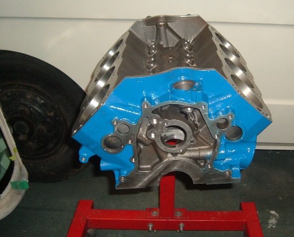

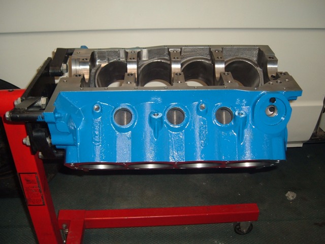

I have just started final assembly of the motor after cleaning up the block to get rid of any unwanted residues from the manufacturing and block prep processes.
For one of my grunty waterblasters from work, I made up a small diameter wand that I jetted to spray in all directions and stuffed it all the way up every orifice that I could find... In the block that is! Oilways, waterways, threaded holes, I got absolutely totally bloody soaked!! But I can guarantee there's nothing lurking in the block that shouldn't be. Then I dried everything off with a duster gun and gave it a couple of coats of paint.
The first item to be painted with its final coat. Bit of a milestone!
I was just in the process of fitting the cam bearings when I noticed the threaded holes for the head studs were not counterbored/countersunk . Bit of a wakeup call, how I could have got this far with the motor prep and not picked that up before, I’ll never know…..When I think of all the silly little details I have been concentrating on to achieve good reliability with reasonable power; to almost miss something as basic as that, is a case of not being able to see the wood for the trees. Sometimes I have doubts about my ability……
Anyway, photos of the first item of the build to get it’s final coat of paint.

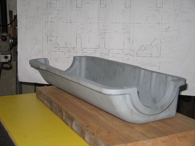

The sump casting is back from the foundry and looks good. We had to build in a boss to take the scavenge unions as they need to angle up slightly to clear my chassis. That was added in after the photos in the earlier post were taken.
The boss will be milled off to the angle required and drilled for the outlets.
First pic shows the as cast sump on the right sitting beside the pattern.
Last pic of the sump shows in the background one of the drawings Lim did for working out the adjusted measurements required for the pattern, placement of flutes etc.

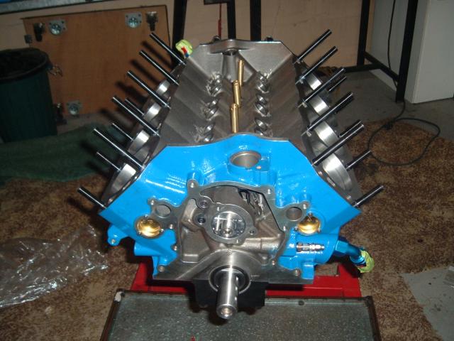

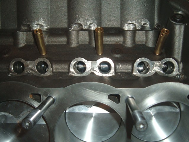

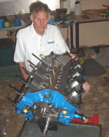

Well Christmas Day wasn't the writeoff that I had expected. Managed to get my shortblock assembled. Family commitments were limited to late afternoon/evening.
Boxing Day seemed to be a good time to start on doing door hinges and mounting and aligning doors. I always knew this was going to be a mission, but it's turned out not too bad. Details and pics shortly.
Scott, sometime ago, wanted photos of the standpipes, so here they are, along with the just assembled shortblock. Specially for you ....

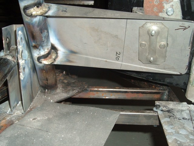

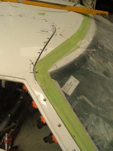

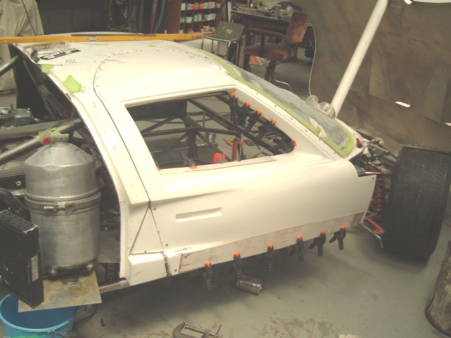

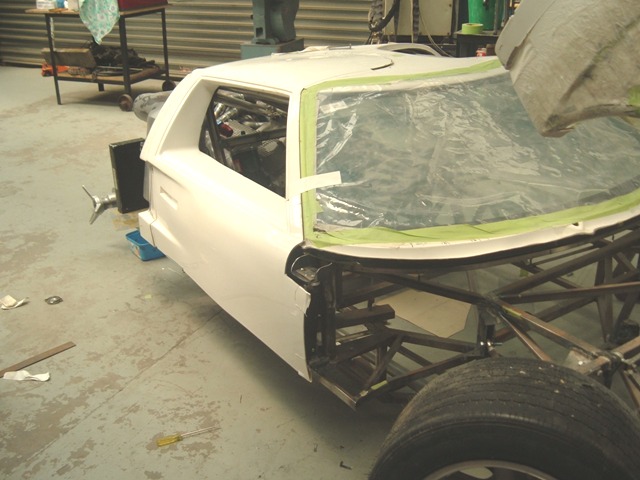

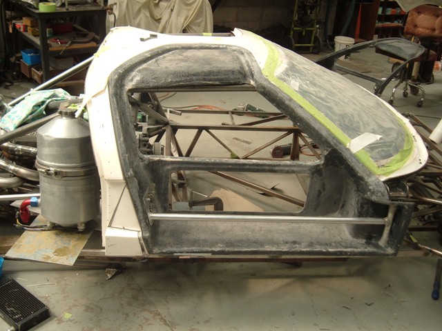

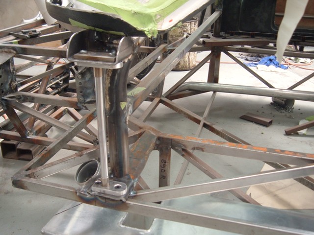

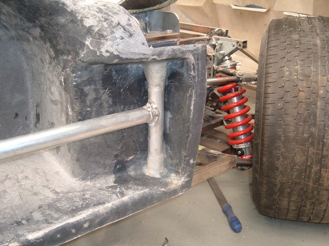

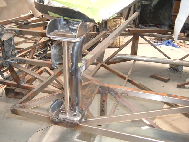

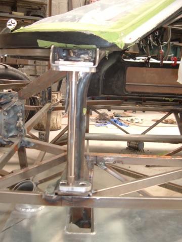

Well, as indicated earlier,I made a start on the doors Boxing Day. Because I intend to road register the car and because I am not using approved hinges from an existing roadgoing production car they have to be designed and certified by an engineer to withstand specified loads. A engineer mate of mine, Neil Whitaker, came to the party and did the several pages of calcs and specs for my setup. Thanks Neil.
However because of the specified loads, the hinges have to be built like the proverbial brick shithouse, regardless of the fact that the actual fibreglass doors will be destroyed and torn off long before those loads are reached!!! Reassuring to know that if the hinges can be found amongst the wreckage that they will still work. Sometimes I despair this this car is turning into a fat pig!
Anyway, to the hinges.... Mounting brackets from 3mm MS plate. Pivot pins 16mm stainless welded to 30x6 stainless flat. Clamp plate 30x8 alloy tooling plate (7075). Pivot bush nylatron. Hinge tube 25x2 alloy
Of course building from scratch you don't really know where or how things are going to fit so I had to position the door inner in place where it needed to fit, then drill holes in the fibreglass where I thought the door hinge tube should go and then use that to determine where the chassis mounts should go. These initially wound up not being in a vertical plane so then the chassis mounts had to be lined up vertically and the pivot tube in the door altered to suit. Now I had a pretty good idea where things would go it was just a matter of welding on the mounting brackets and making and glassing in the hinge tube and internal door brace. Door brace from 25x 2.0 alloy tube and the reinforcement plate for the door latches 2.0 thick alloy plate. Without this brace there is no torsional stiffness in the door inner.
Then it was time to slip the outer skin on and cut to size and check the fit.
I had intended to glue the door skins together sitting in the outer mold but because I had to alter the shape by spreading the front lower corners of the spider to get a good fit for the RF supplied front screen, it meant the existing profile of the doormolds was no longer correct. So on to plan B, glue them up in place. This meant that for the most part I could no longer use G clamps, butterfly clamps etc to hold the inner and outer skins together during the gluing process and instead had to drill and screw them together. Never a dull moment, but got a good fit..... Glue, as before, was Plexus MA 425, which I also intend to use on the alloy panels.

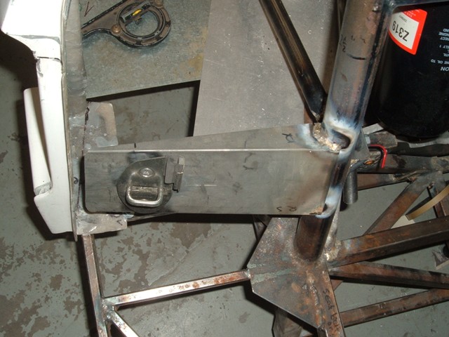

New Years Day yesterday saw more good progress. I released all the clamps and screws on the doors and everything is a nice fit. Gaps are good and the doors swing nice and straight.

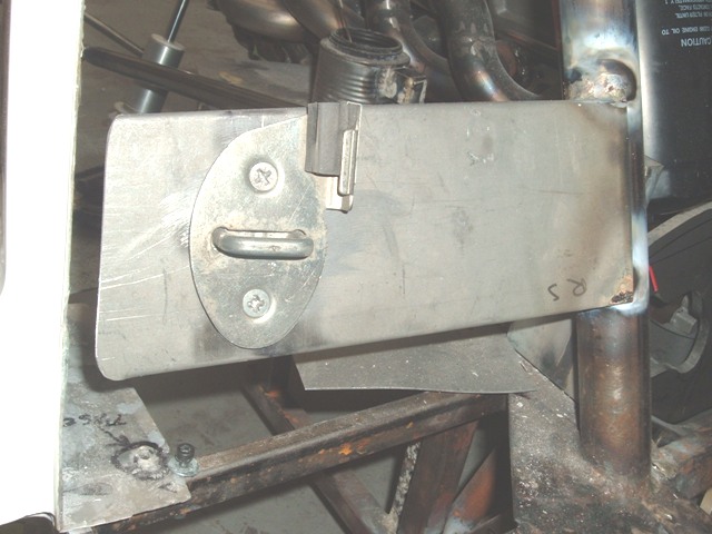

I made the door latch mounts and fitted the latches. These are off an 80's Mini and as such I don't need engineering certification, so no 3mm plate! In fact I folded the mounts from 0.8mm sheet and they are really solid.
Lim has been putting in almost as much time as me the last week or two and, amongst other things, has just finished final machining of the uprights. They were a bit awkward to mount in the lathe but the end result is spot on. My lathe is smaller than his, but he is replacing bearings on his so here he is using mine. A picture of concentration and a man who enjoys his work!
Leon (haroo) has also been helping out one night a week too so it's all looking good.
