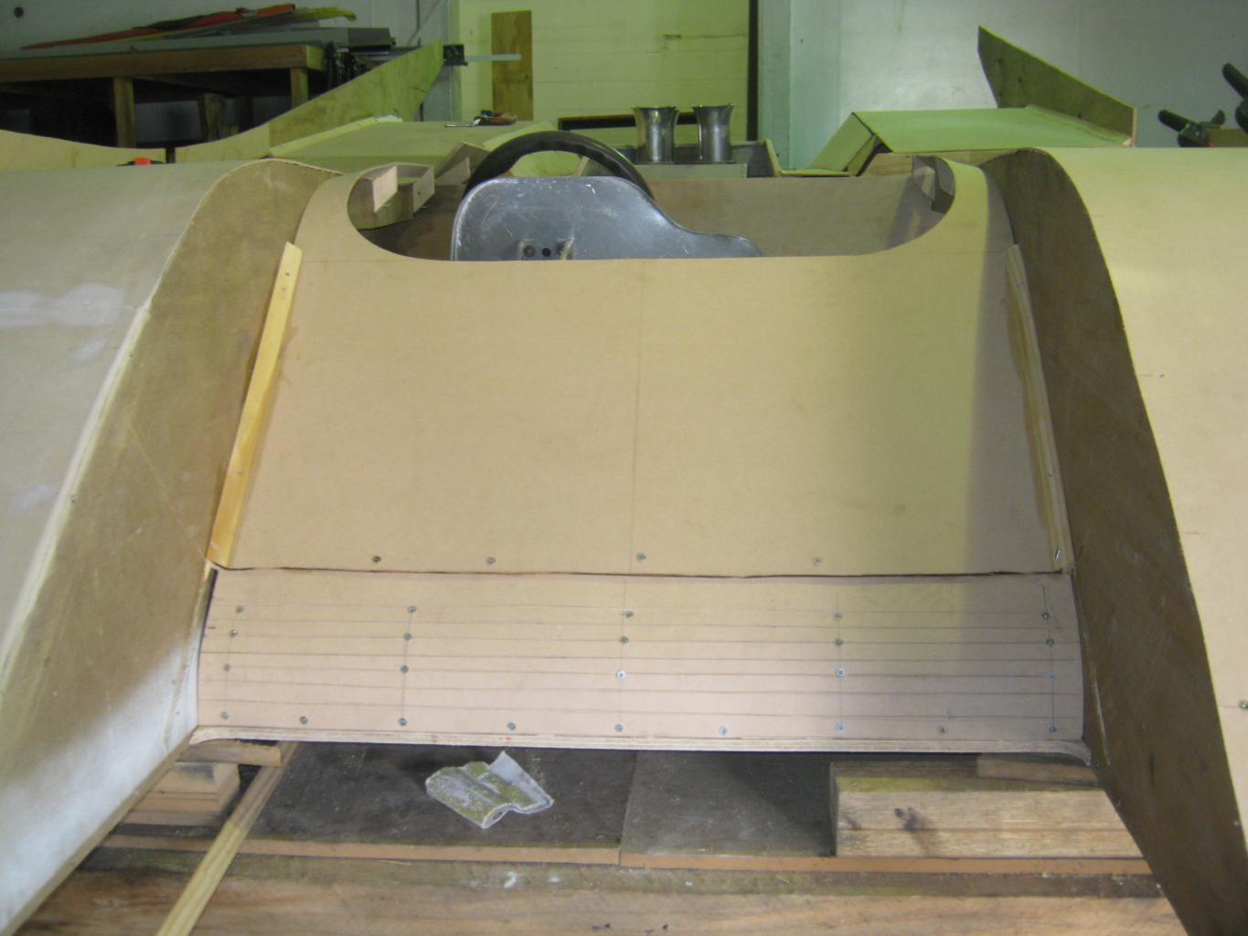

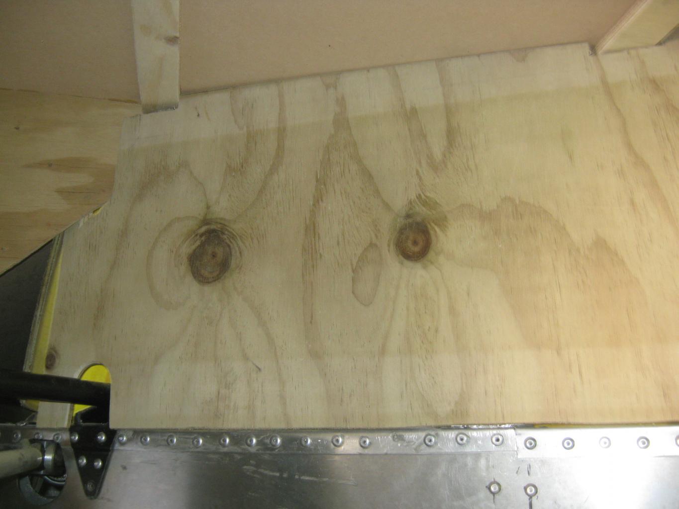

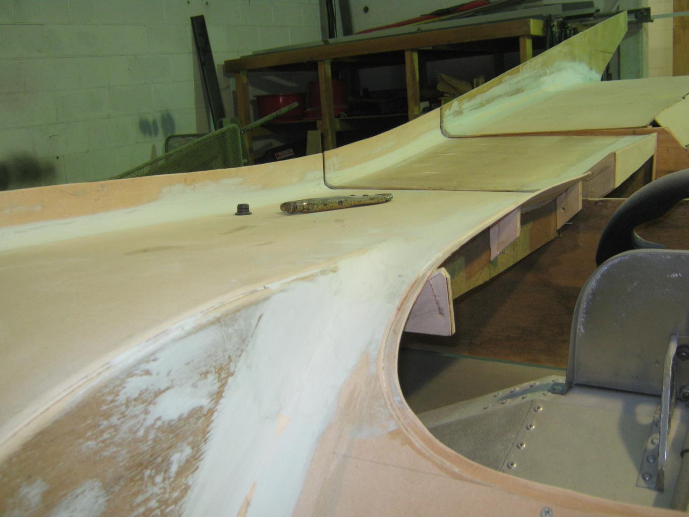

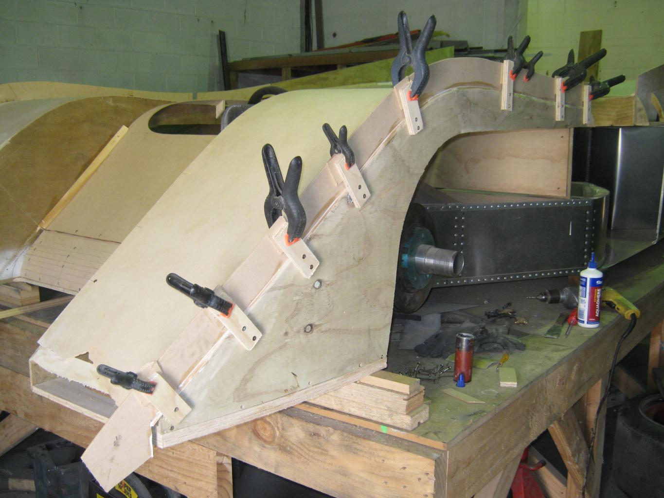

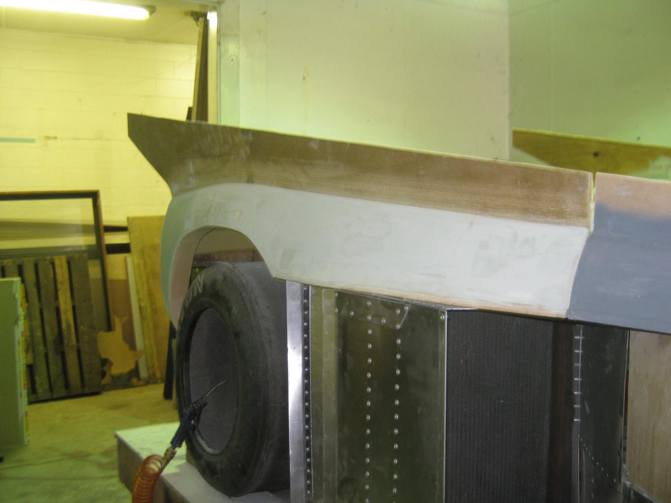

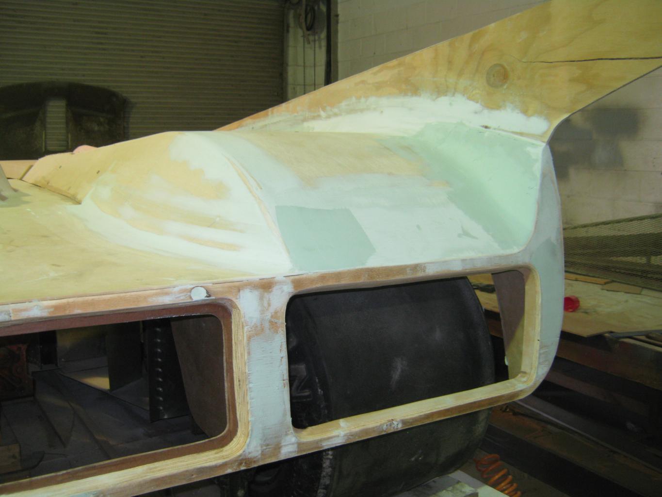

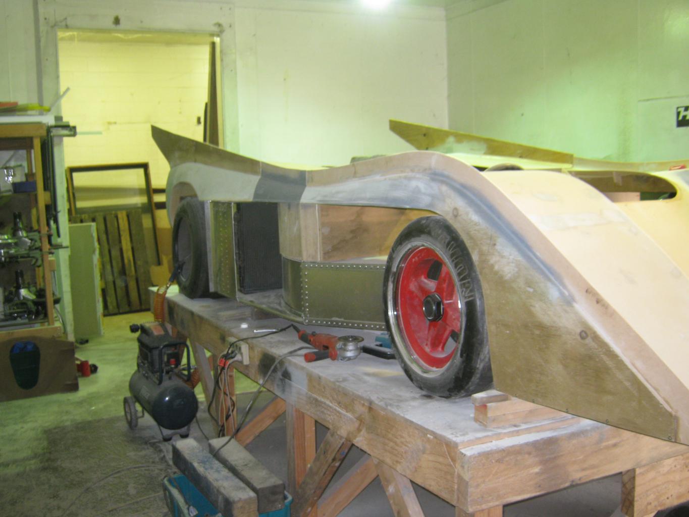

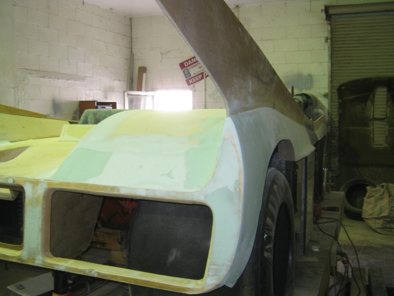

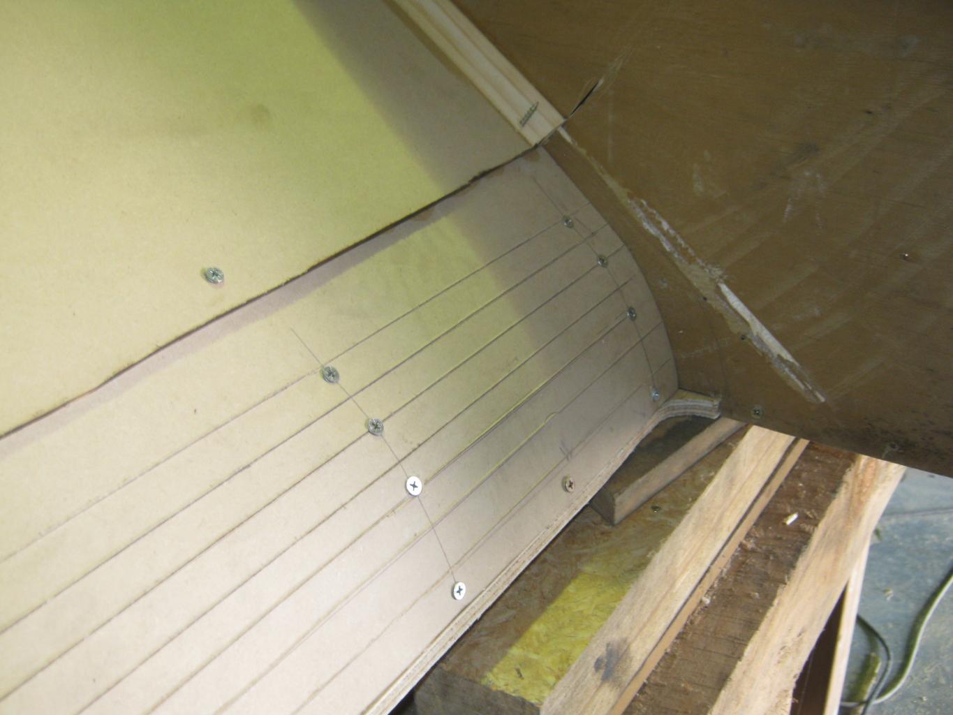

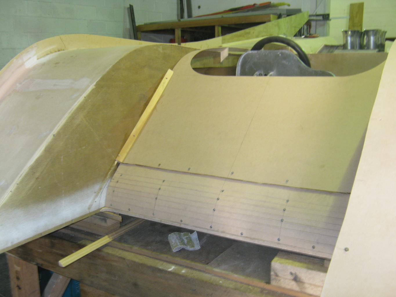

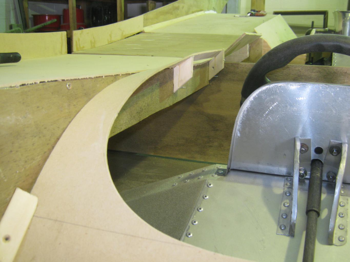

Well the work continues on. I have moved my focus to the front clip for a while (I have a small issue on the back so I'm doing the Ostrich thing) I have started the fence on the left side now and the front panel/wind screen surround. The fence is pretty simple, just cut it to the right shape glue the edge with PVA and support it while it dries once that is done radius the inside with some bog. The front panel is a little more complex, it has to have the bottom rounded to drop at the bottom. I did this by making ribs inside then scouring deep lines in the sheet so it would bend easier and glued it in place. then the wind screen surround has to be shaped as it goes back to match the door which has a 45 angle side so I made some ribs and curved it back and attached it so it would hold the shape then there is a second piece on the inside where the actual screen will screw to. This will create a lip so the screen will be flush with the outside panels. The next step is the panel that goes down the sides and across the front where the clip will rest on the alloy tub. I have done the front and left side which is quite a bit of work as it has to fit the shape of the fender and the ribs inside as well as over the top rear link. The pictures should show what I've tried to explain.

Hey Guys back on the body again today, Started the shaping work down the sides, I have pretty much done both doors I will put a couple of coats of sealer on them and prime them this week. The r/rear guard is also coming along well using the surf board foam and finishing with a skim of bog.

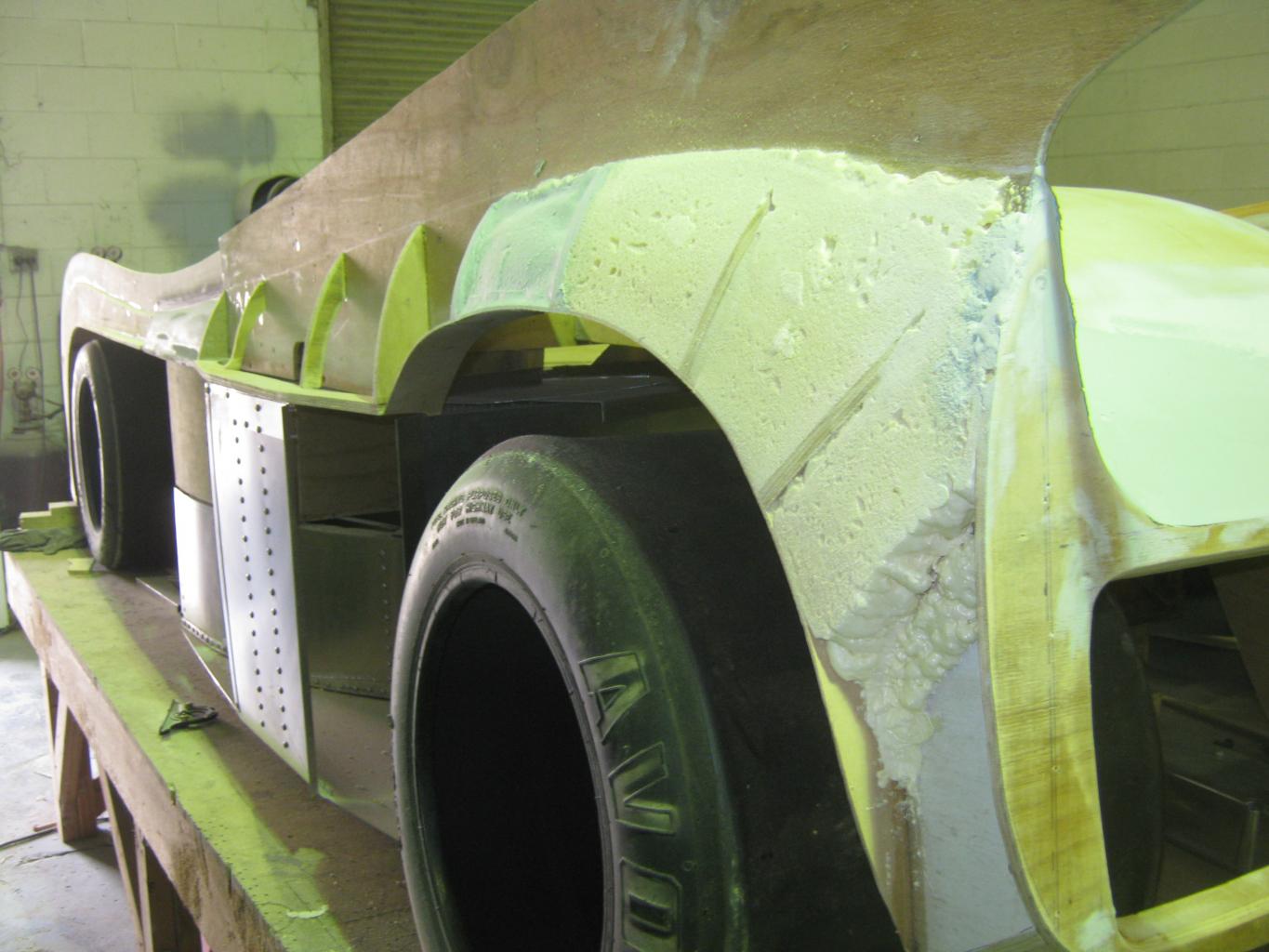

Well the dust continues to cover everything in my workshop one of the things I hate about making bodies from timber and fiberglass but the progress is steady.
The body is complete as far as the surface structure is concerned, now I'm doing all the shaping and contouring all the corners and blending the surfaces to each other.
The rounded surface along the right side is done and I'm quite happy with the shape. The front clip is getting close to finished and I will be putting primer on it soon so I can get final shaping done. Once this is done I will put the first layers of F/Glass on it and get a finished surface before I pull the wood from the inside.
I have attached some Photos of the progress so far. Hope you enjoy and as always your comments and ideas are welcome.
Cheers Leon.

Continuing to look good Leon. Once it is all primed, you'll be amazed at how it will finally look like a car. This is the point where you may be skimming filler over the same place half a dozen times simply to get it right. Unlike mechanical stuff where it is either right or wrong, bodywork has a million shades of gray. Even though the eye is useful in building the bodywork, a closed eye, and sensitive hands and fingers will tell you more about the quality of the curves, filler, and shape.
X2 on everything Terry said...
Oh, and as I have verified - Oddly enough - a Gloved Hand is actually more sensitive when it comes to picking up on the variations in surfaces...
I use the blue nitryl gloves and they work rather well..
Funny you say about the gloved hand Randy, When first came out of my time (apprentiship, not prison) I got a job in the Nissan Assembly plant as a metal finisher, the guys were wearing cotton gloves and I made the comment, How can you feel the panel and then I used them and wow what a difference, 5 years in a body shop and nobody had ever used gloves.
Terry, your right about the multi layers of filler and the touch of a hand but its the eye that's needed for the lines and I noticed in photo #4 the round over the wheel arc where it meets the tail fin has a wee flat spot at the back which makes it look sharpish but from the side and front it looks fine, I will correct this.
