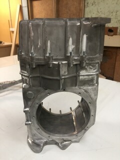

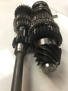

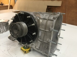

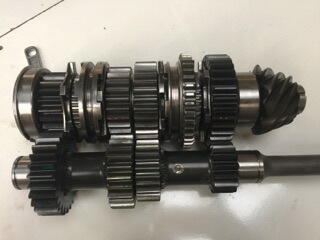

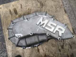

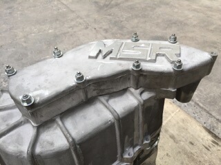

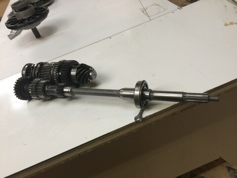

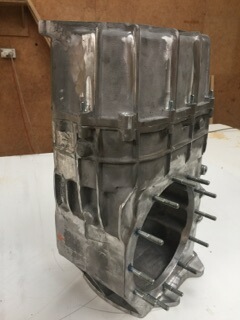

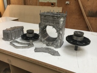

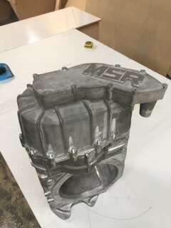

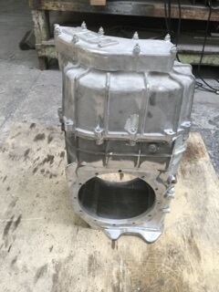

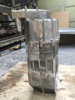

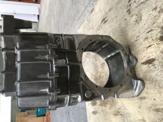

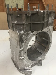

Thought I would bring you up to date with the MK3 trans axle, I am just doing the selector shafts this weekend and hope to have it all but finished by the end of the Easter break. I have attached some photos and will do some of the selector system when its finished. I have changed to a 4.1 C&P as this is now driven trough the Lay shaft which gives it a .78 overdrive. This is a Jerico so you can change the ratios to what ever you want. I'm pretty happy with this version but I will still have the Q/C option available. I'm currently doing some more Uprights and once I'm on top of these jobs I will be back to working on the car, Hoping to get some F/glass work done next. Cheers Leon

Transaxle is looking fantastic, looks just like an LG, excellent work ! Really looking forward to seeing how it performs when you get one finished off. Is this something you are planning to market once its all finalised ?? Would be interested to hear proper specs and any prices if you do. I found another M20 body off shot that I put to one side for you to, will see if I can find it again !
Rick
Hi Rick
There are plans to build to order the same as I'm doing with my uprights of which I'm now doing a set for a chap in the US. They are easy the longest part is getting them cast and waiting for bearings to come from Australia. Pricing the Trans is harder because it totally depends on what gear set is used, the diff, shafts and case are the same so those costs are relatively set. As for the M20 Body that sounds interesting keep me posted, it would save me a heap of work and give me real dimensions to compare and adjust the chassis to.
