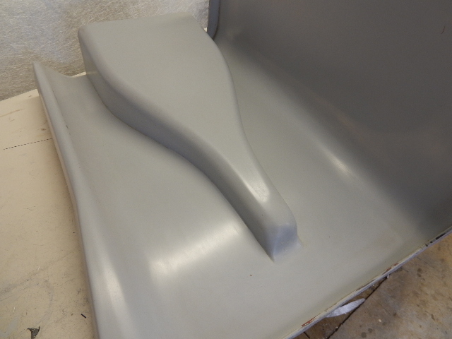

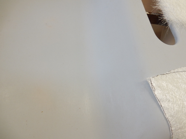

Leon, the more work you put into your finish now means that much less come mold time. I am waxing my molds again now ready to pull body number two and the surface is still almost perfect if I can say. I did give it 5 coats of wax which is still very much intact so I will only re coat 3 times before I use them again.
Leon
The first picture is my Rear clip mold as last used, not clean and been stored for 2 years and the second one is the door mold polished ready for molding.

Don't get me wrong Russell, I'm still going to make sure I have a nice finish on the plug so the mold is good. I have painted the doors and they have a great shine on them will fine sand and polish them up then take molds of them first, then I will do the sides and last the top surfaces. I'm away for 8 days on Sunday, taking my youngest to settle into University in Christchurch. Cheers Leon

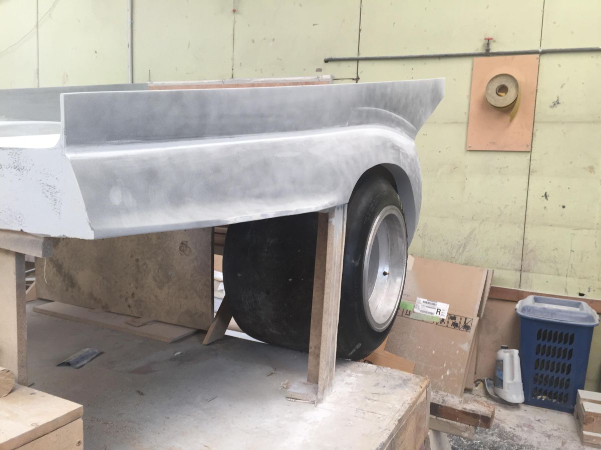

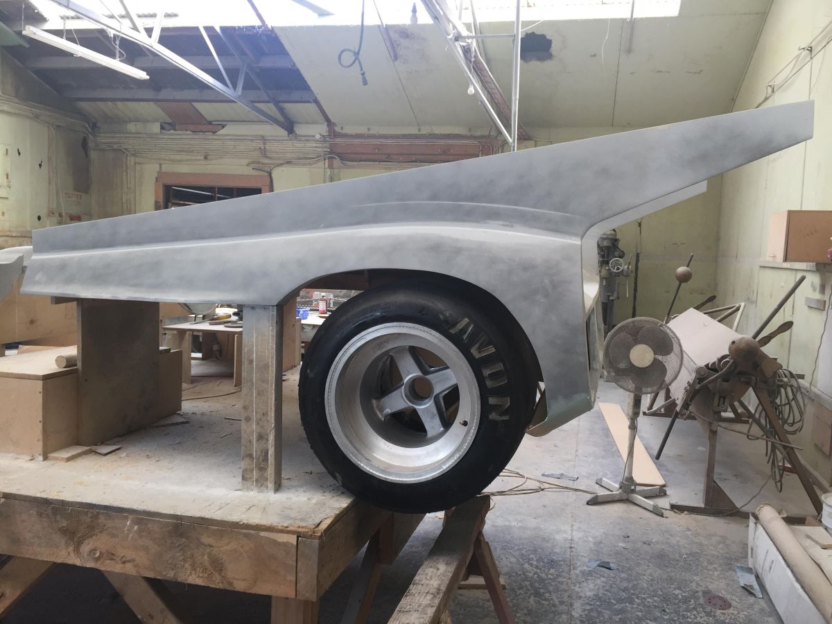

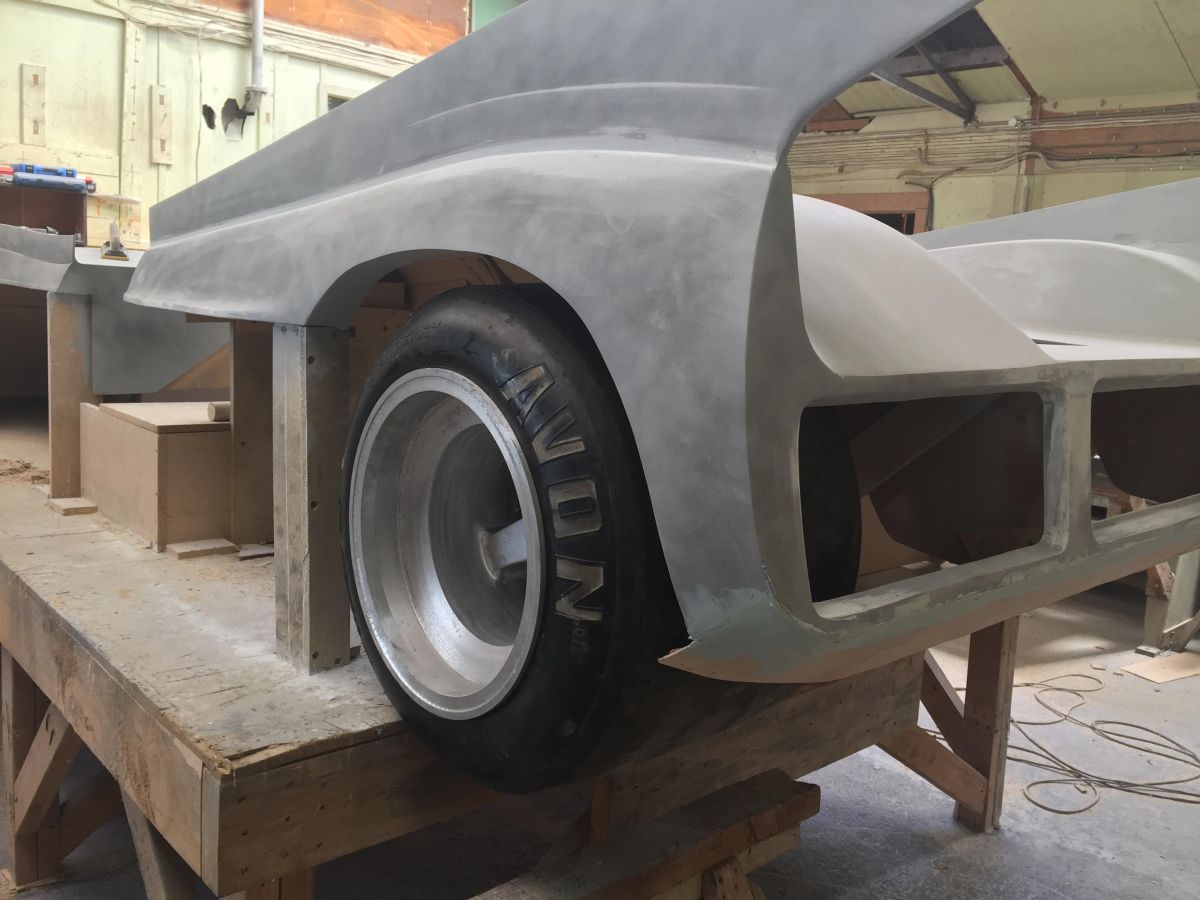

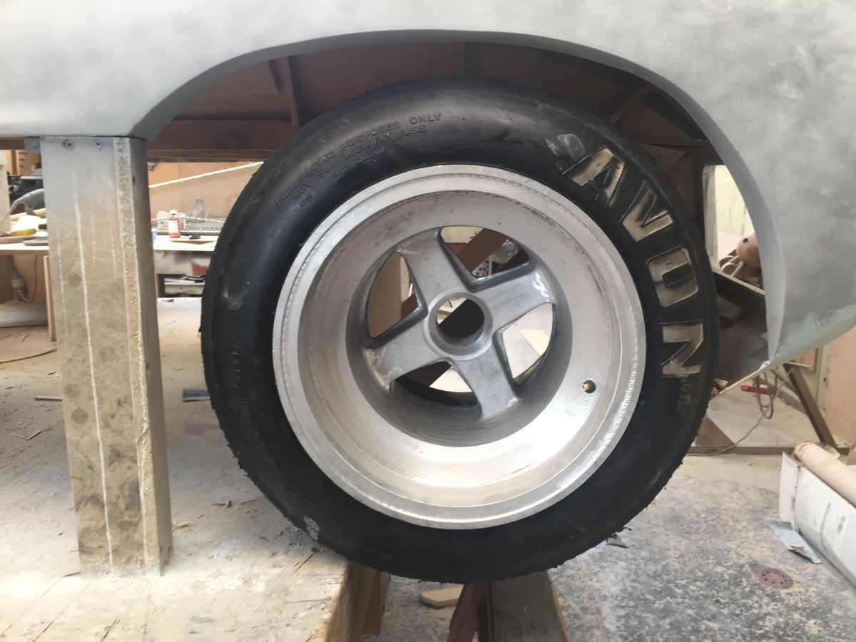

Finally!!! some wheels I have the wheels cast and tyres on 1 front and 1 rear will have the other two mounted tomorrow and get the fronts on the tub. The body has progressed a bit more while I was away, my mate Kelvin put in a few hours of sanding, fabbed up the bottom of the rear panel and redid the windscreen edge after I decided it wasn't quite the right shape. He didn't thank me for that!!

Now THAT is a BIG moment right there. :)
I think those are 19" wide .... if I remember the few wheels I am jealous of correctly.
You are correct Rob, 19" wide with a 26/15/15 Tyre. the fronts are 11" with 23/10.5/15 Tyre's. I have made these wheels 2 peice, the main reason was the casting cost and it gives me the ability to easily make them in different widths. These ones have a steel inner because of the bell needed for my Brakes but spun alloy shells are also available. I better get back to the workshop. Cheers Leon

4" of side wall stretch... Ouch. You may not be aware but, Hoosier makes a 17" wide 15" Dia Super Modified paved oval rear TIRE that may be of use to you. I think Canepa's uses them on their 917/30KL
