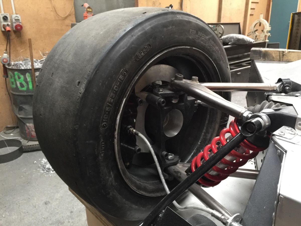

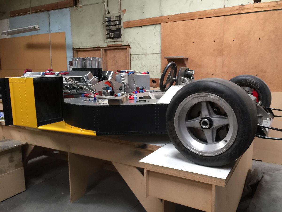

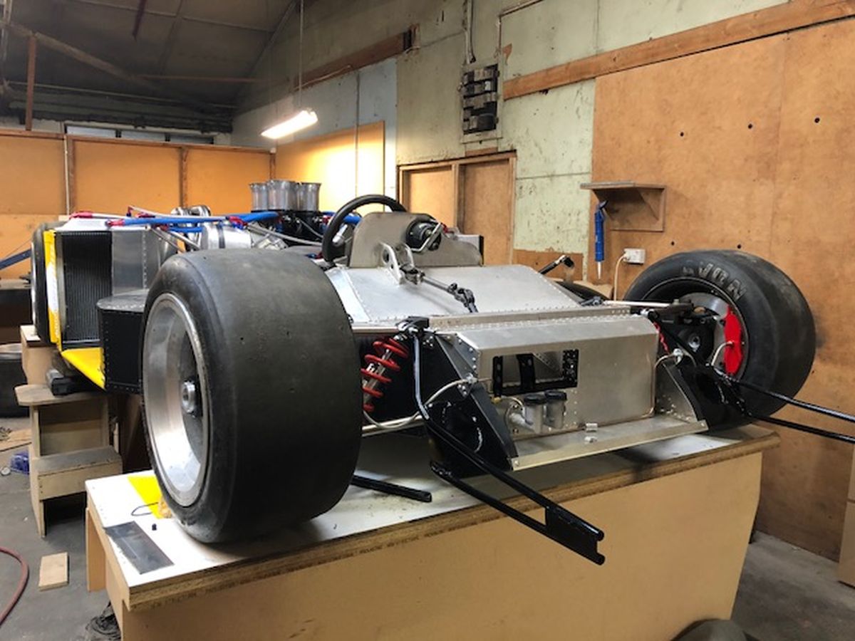

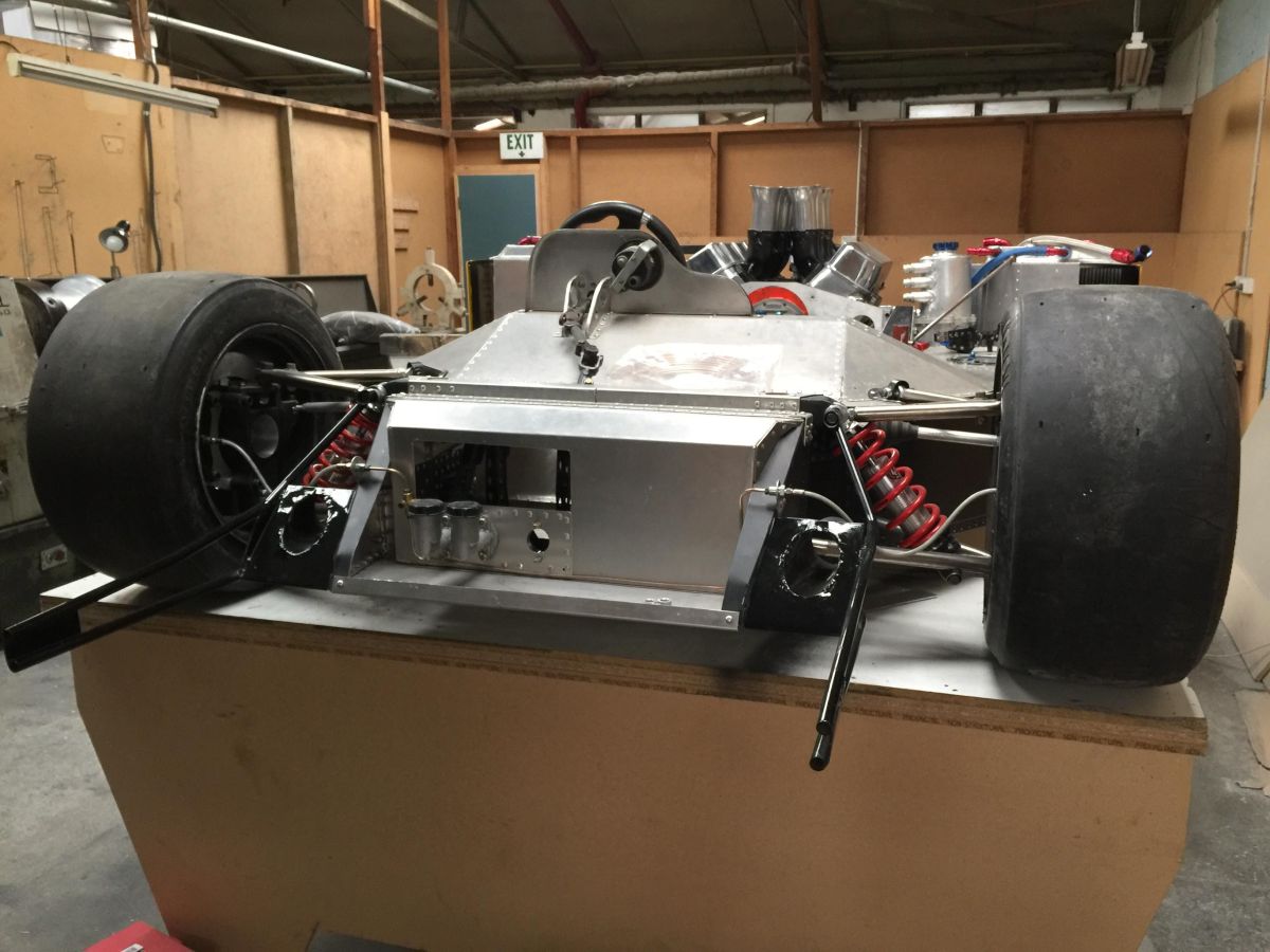

Hi Rod, Fronts are 11" wide with 23/10.5/15 Avons, The steering stops are at the bottom arm spherical joint and I have not looked for a sway bar yet but it will mount in the same way as the original and connect to the back of the bottom shock mount bolt. i'll put some photos of the front wheels mounted on the tub tomorrow.
Cheers Leon

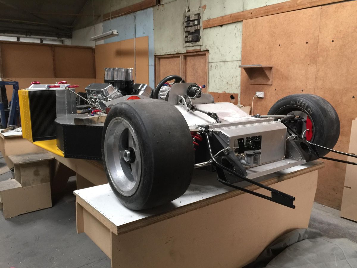

I have some photos of the front wheels so I have attached them.
Cheers Leon.

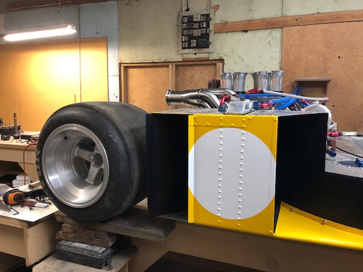

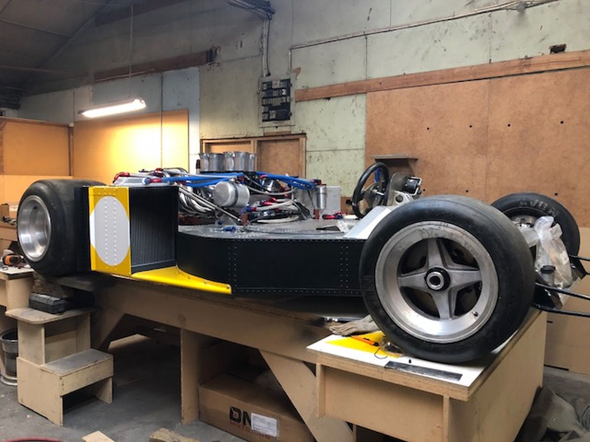

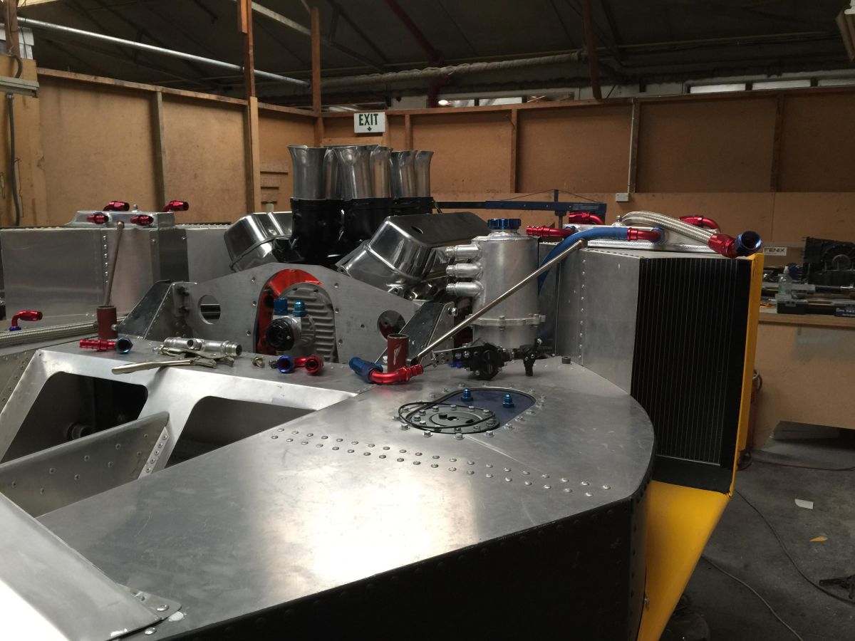

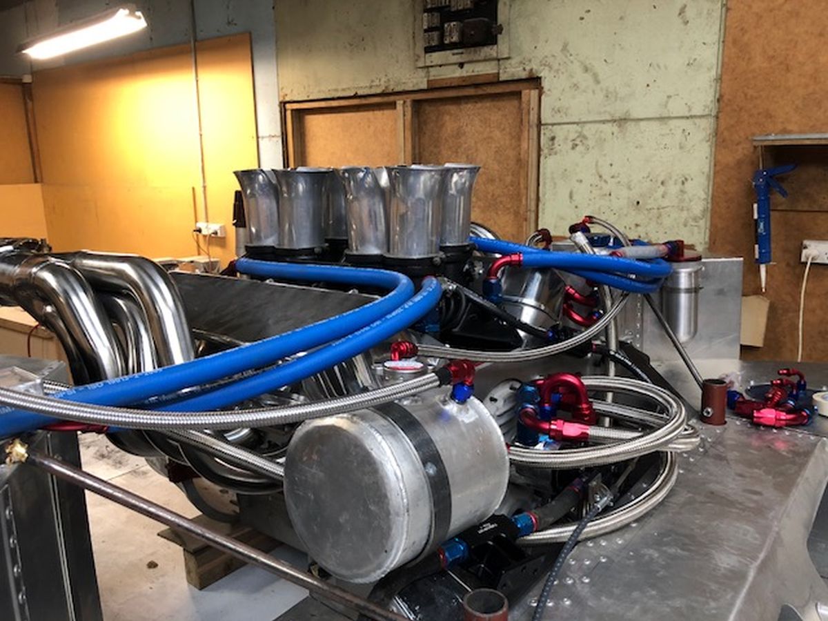

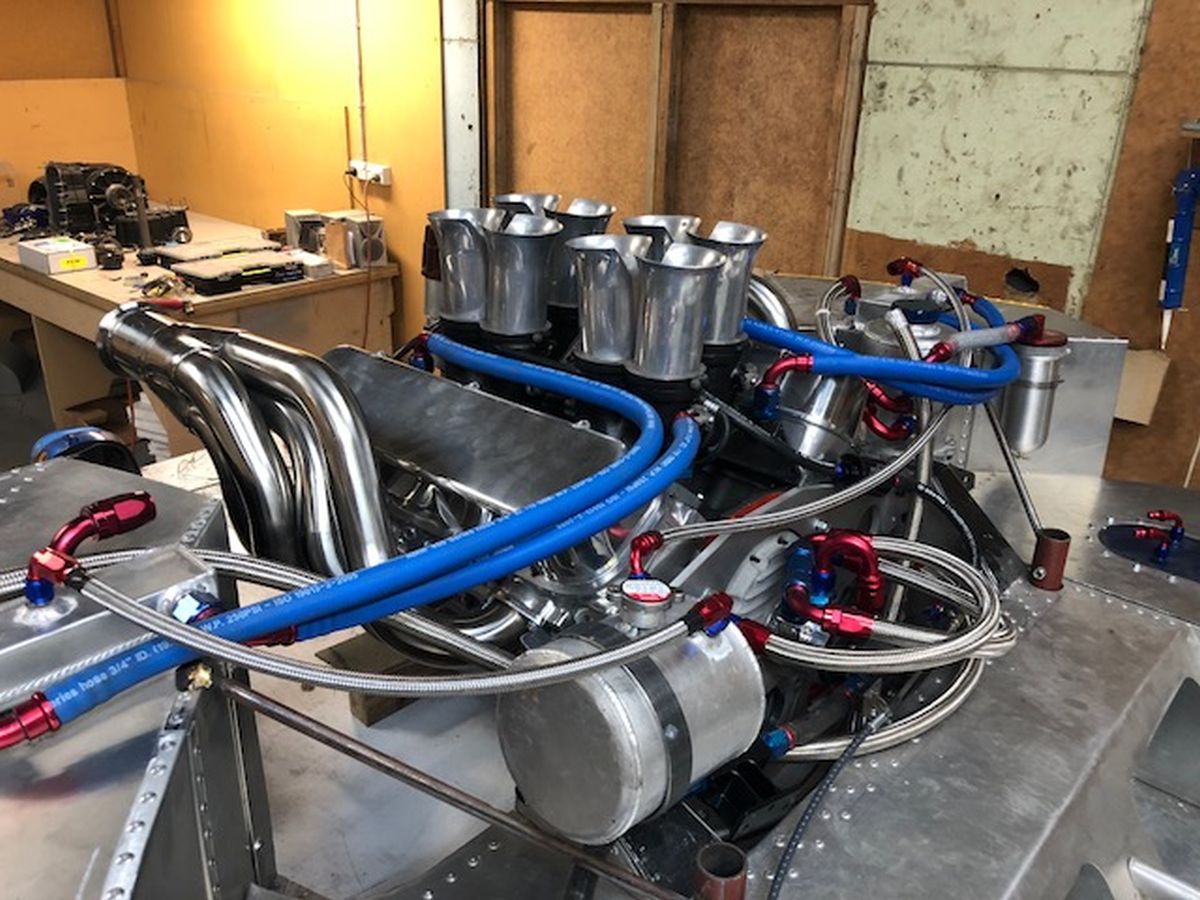

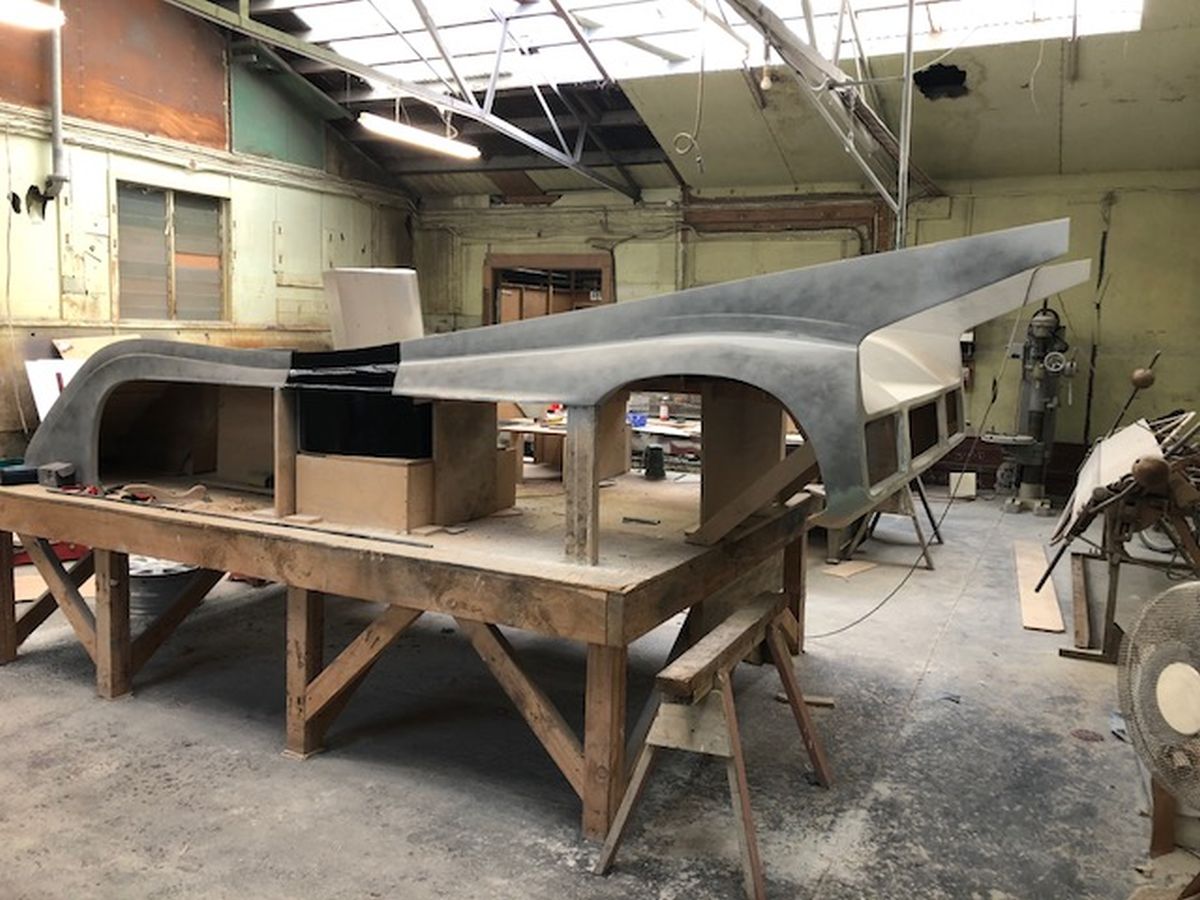

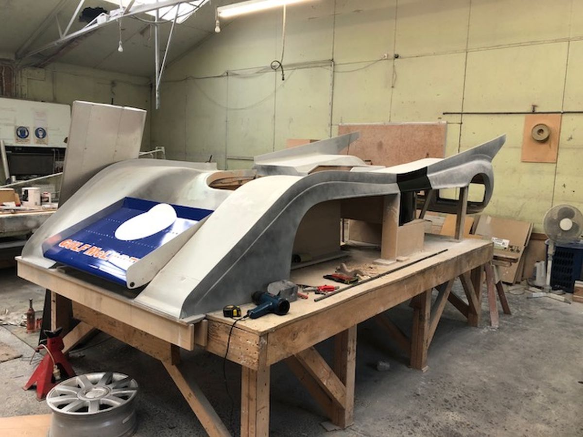

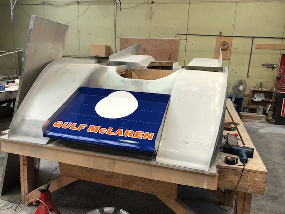

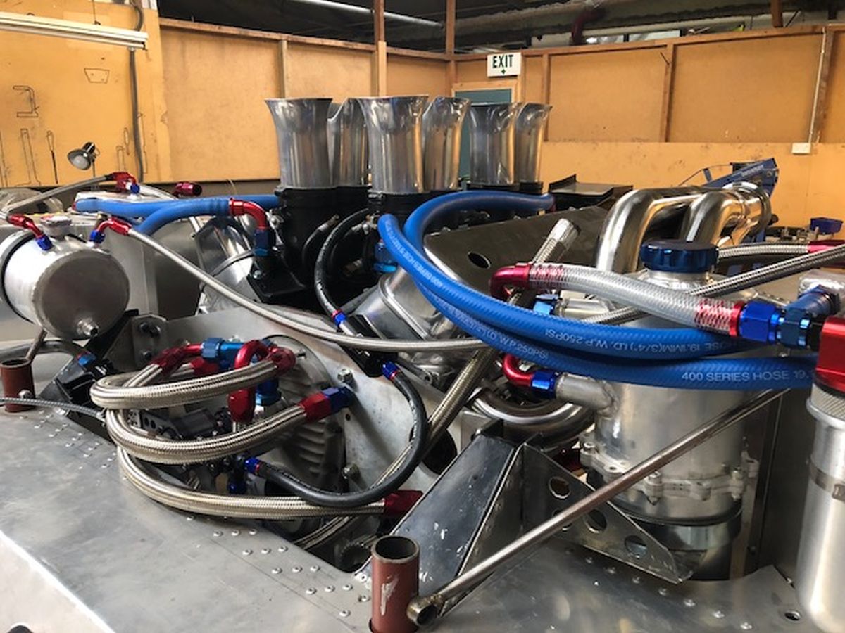

Hey guys, Some more progress has been made, this week all the plumbing has been done some headers have been purchased but will need some mods the front wing was coloured and graffic's added. I now have the paint and the buck is ready for F/glass so hoping to do that next week, Tyres were all fitted to the wheels and its really looking like a car now.
I have attached some photos hope you guys like it.
Cheers Leon

Hi Rod, yes the clear tube is hi temp. I know I'm going to get slammed for the headers as the original one go under and exit under the rear panel. Mine go up and will exit through the opening in the rear panel. the reason I have gone this way is the ease of installation as it is very busy down low with the tri-pods and the oil pump etc,I may turn them into a 180 system. Continue to work on the body as it is the main priority at this point, will have photos of the body sitting on the car soon (I hope)
Cheers Leon
