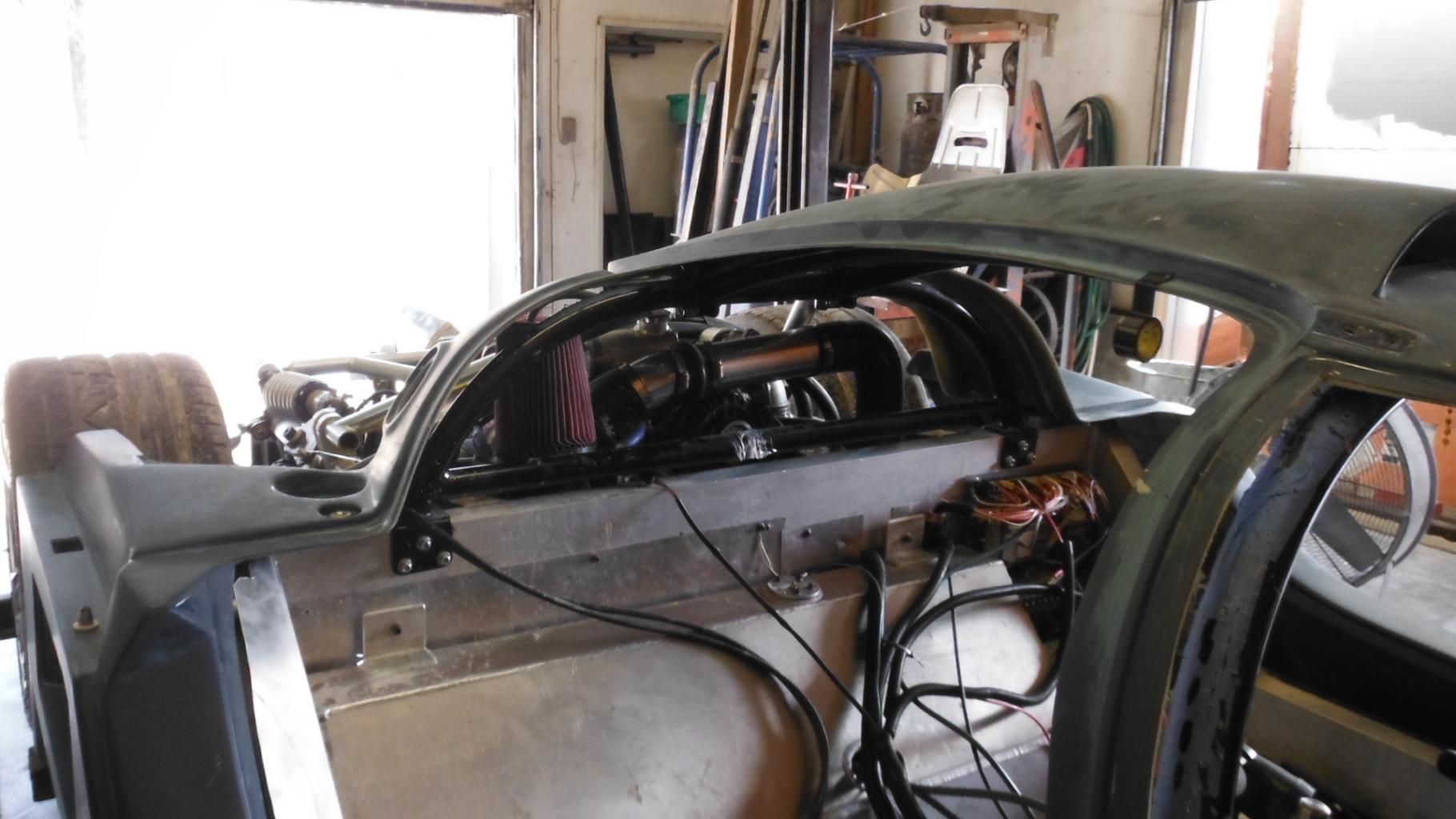

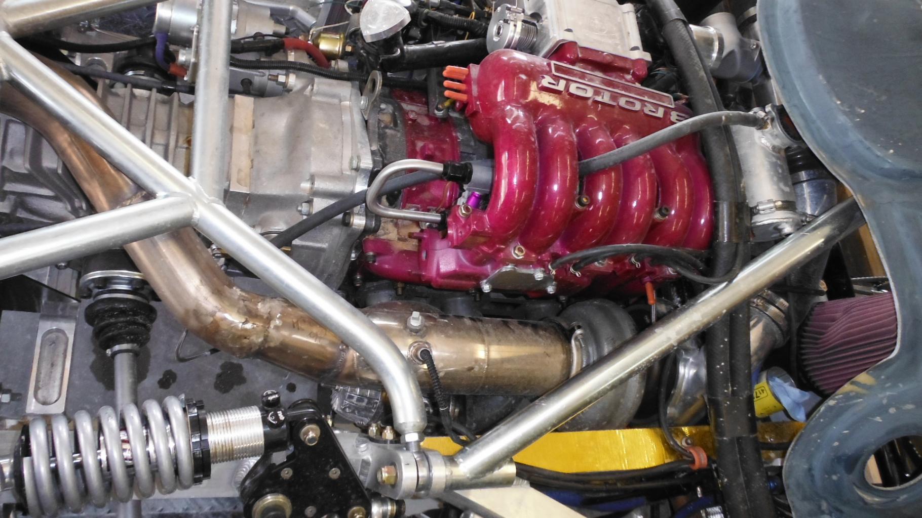

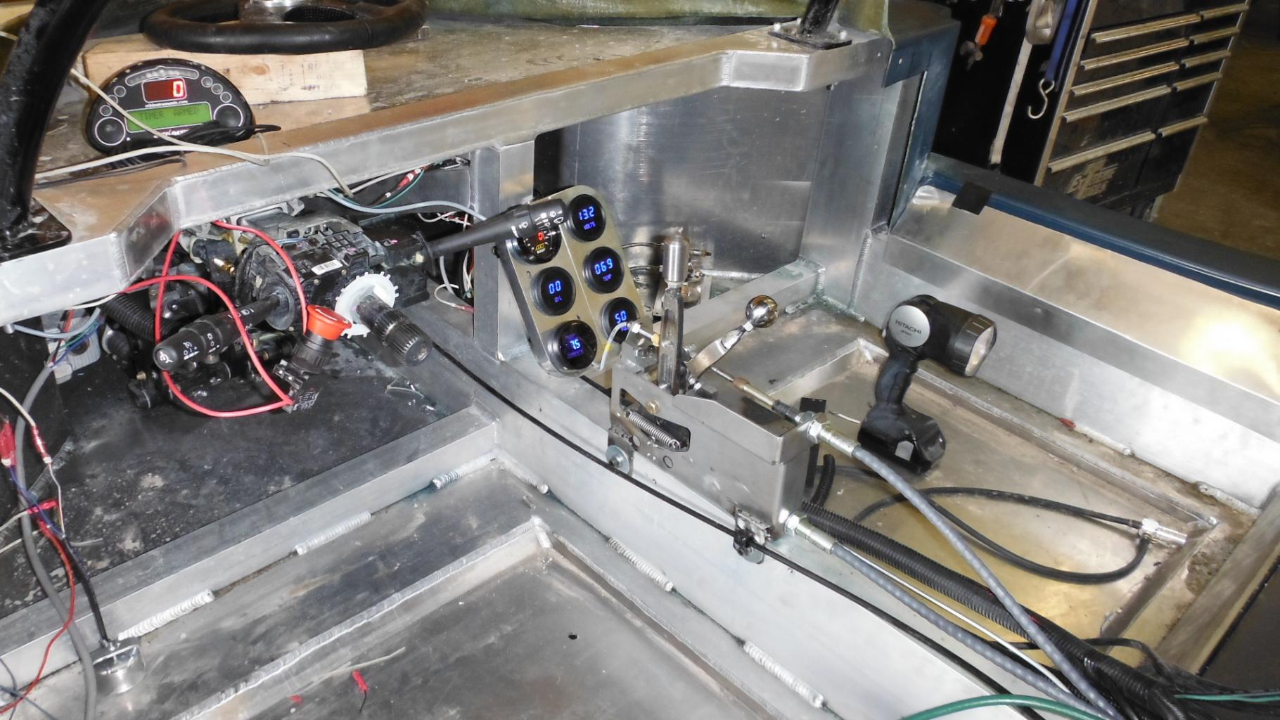

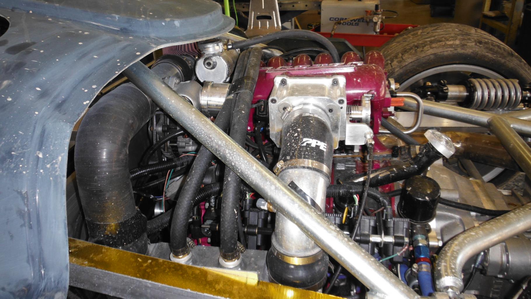

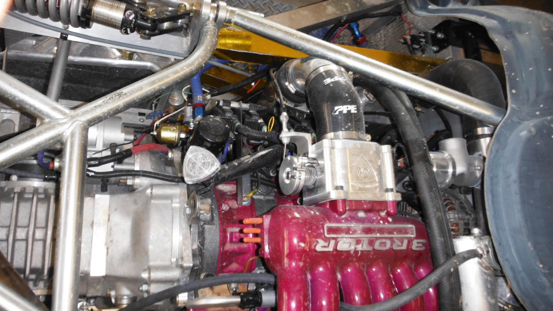

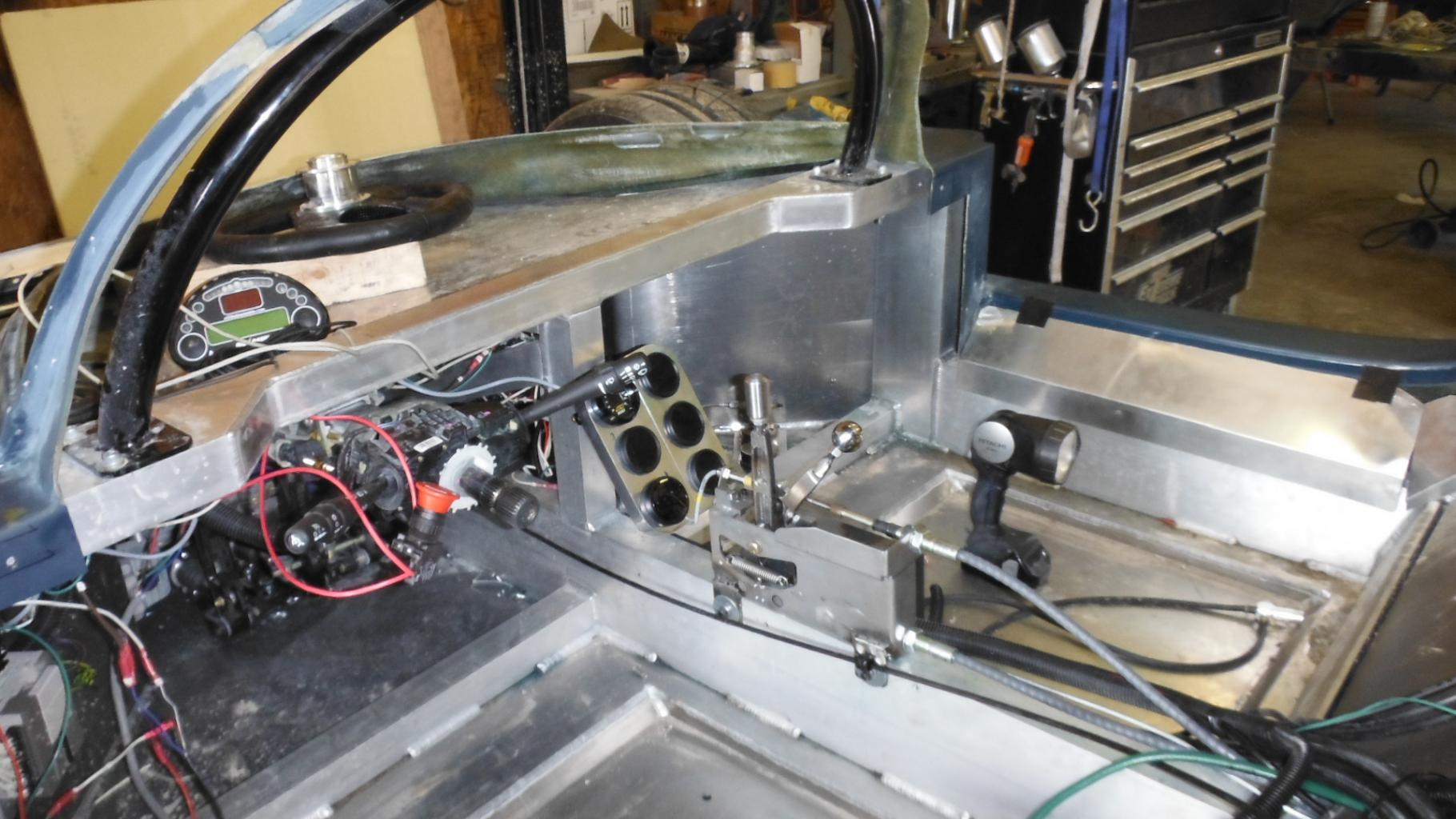

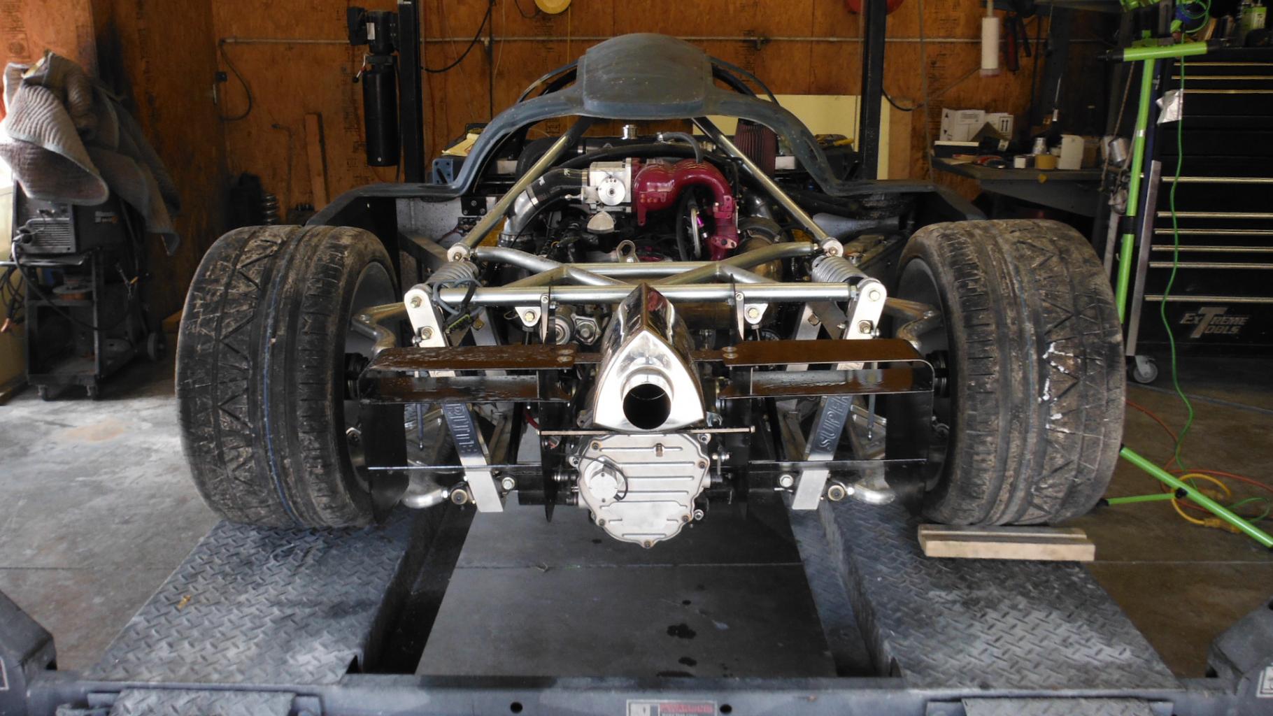

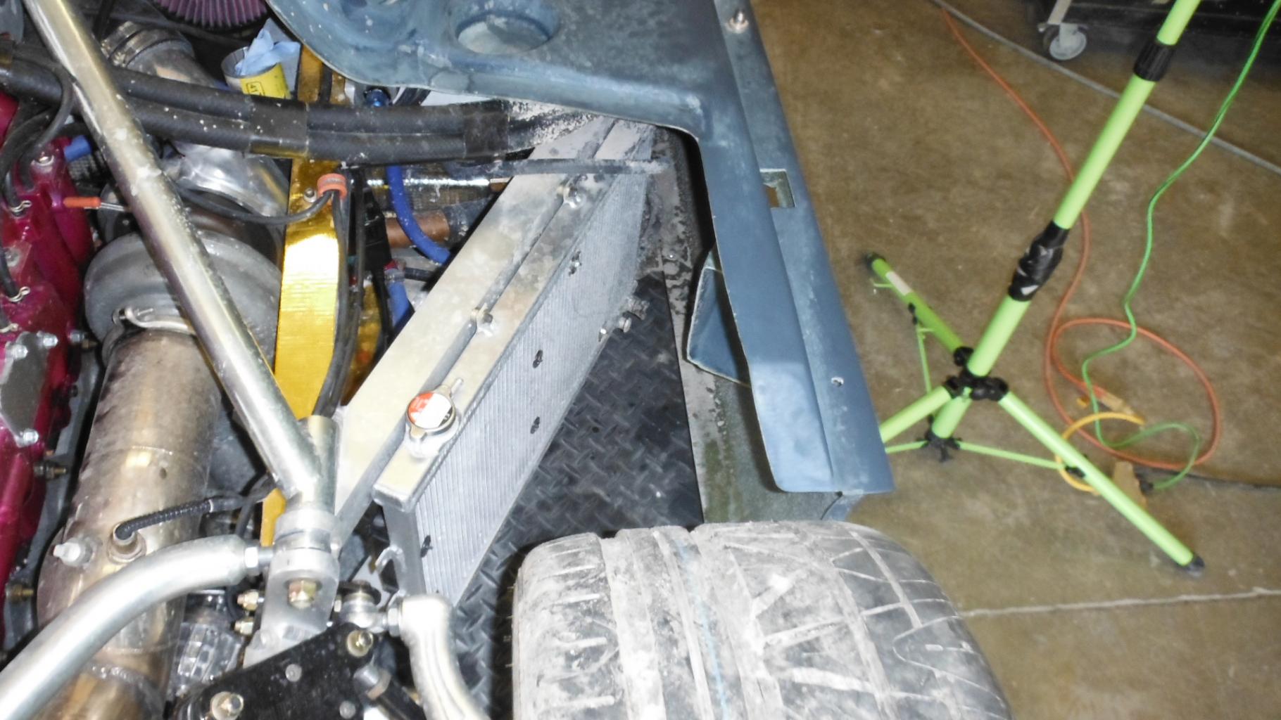

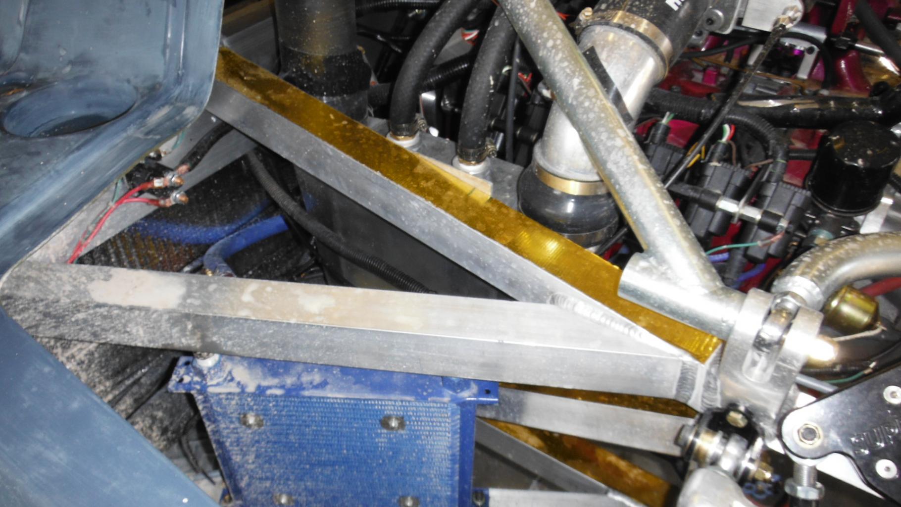

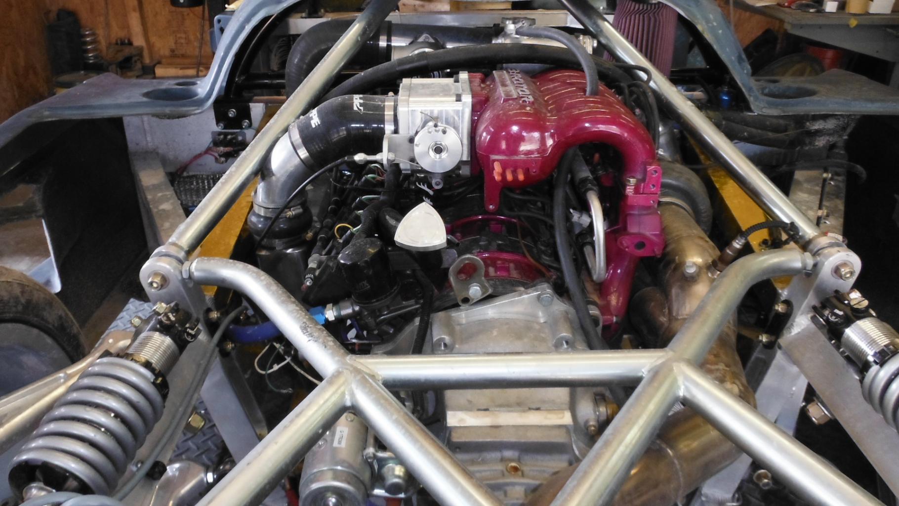

People are talking about engines, supercharge, turbo, here are some more pictures of mine, tho the Mazda engine is small, the compartment fills up quick, one side the turbo, the other side a water cooled intercooler, intercooler radiator on passenger side, oil cooler on driver side and the radiator up front. I have a Digi Dash, but elected to also have digital gauges to look at in the center, so there are a few double senders.
I take water temp at the motor and the input to the radiator on the other gauge. Brake pressure gauges, oil temp, pressure, volts, O2, boost, fuel, lots of wire, 2 Idec plc's.
Primer this weekend, paint next weekend if all goes well. Building the close out panels, wheel tubs, air deflectors for the back air pockets stuff like that.
